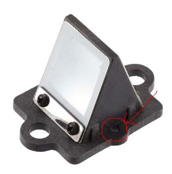

Pulse hole is on both side so you can flip the carb either way
