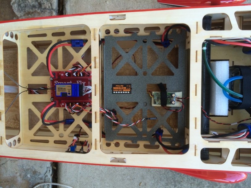

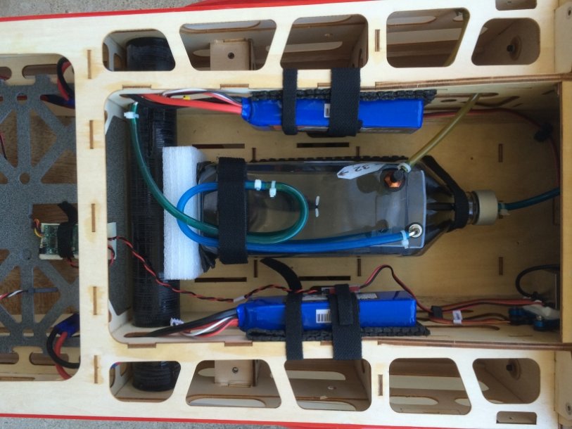

Finally got around to resetting my CG this weekend. With rope around the wing tube and lifted off the ground the plane will hang level without any fuel. With 32 ounces of fuel on board the plane does drop the nose. I would say at this point more than my liking but won't really know until I can get it in the air. Weather forecast for Saturday looks decent for a maiden.
Pics show component placement with room to move Fiji back against the wing tube sleeve as well as being able to move the two batteries forward or aft several inches each way.
It looks good and I'm sure it will fly well. I doubt you will see much if any difference moving the fuel tank and batteries back to the wing tube. My batts are as close to the wing tube as possible. I used a piece of the fuzzy size Velcro stuck to the wing tube to keep it from rubbing on the fuel tank. I'd say you are good to go and if you want to a more aft CG make that change after you fly it. I've never checked the CG with fuel always without.
