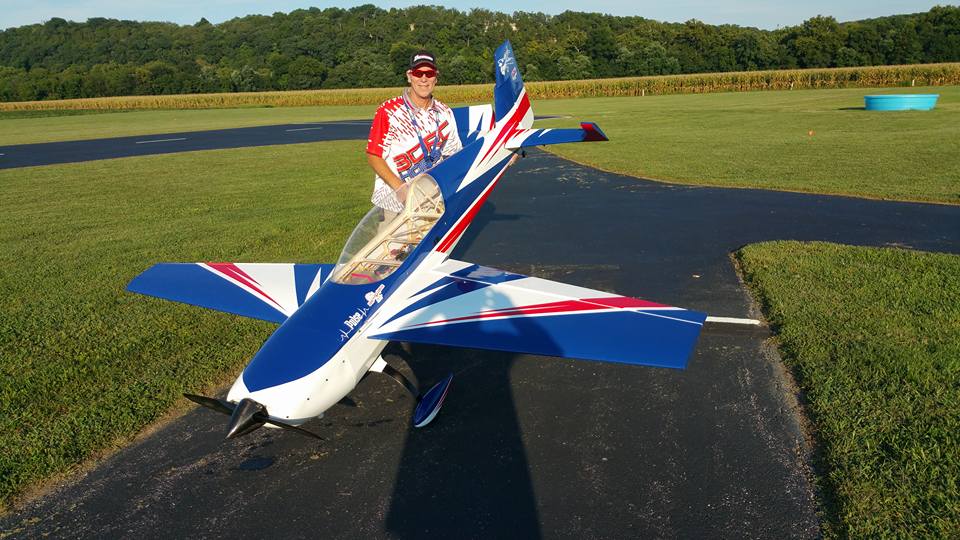

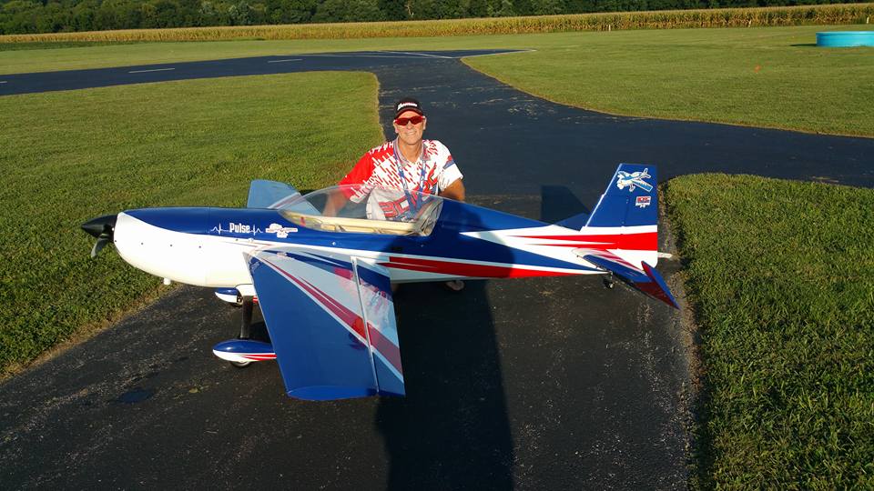

She finally flew, and what a great airplane.
