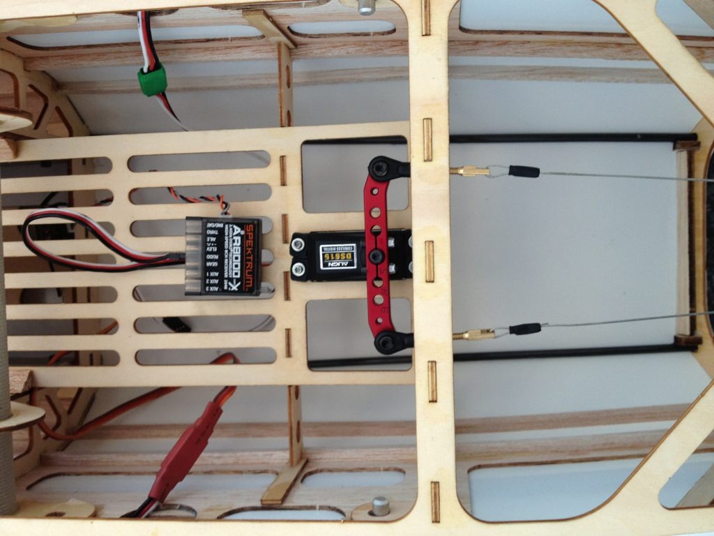

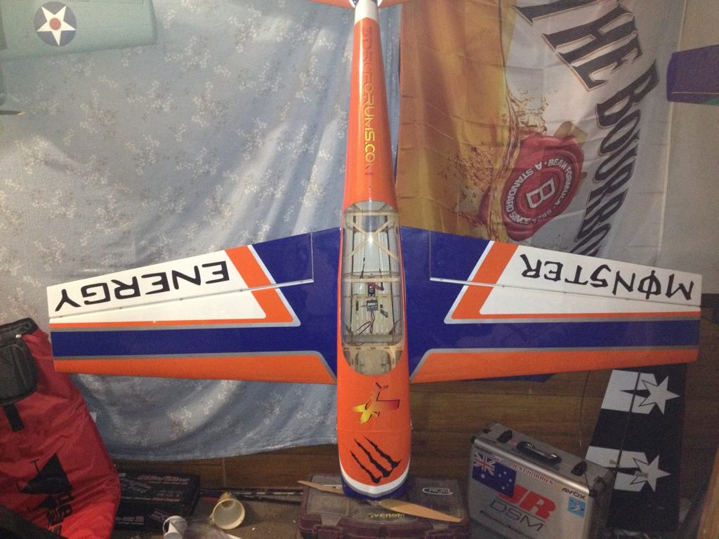

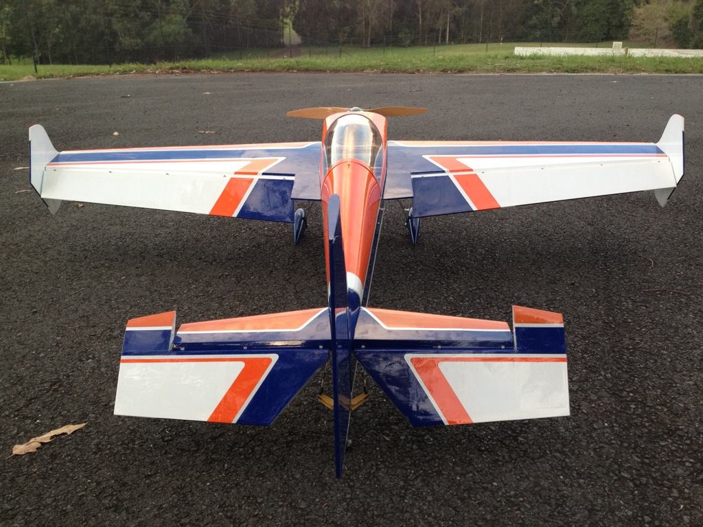

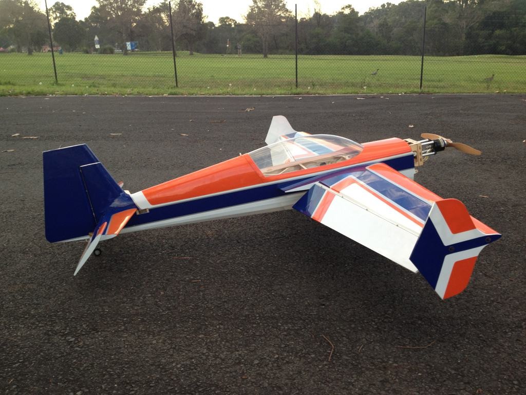

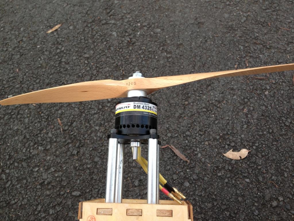

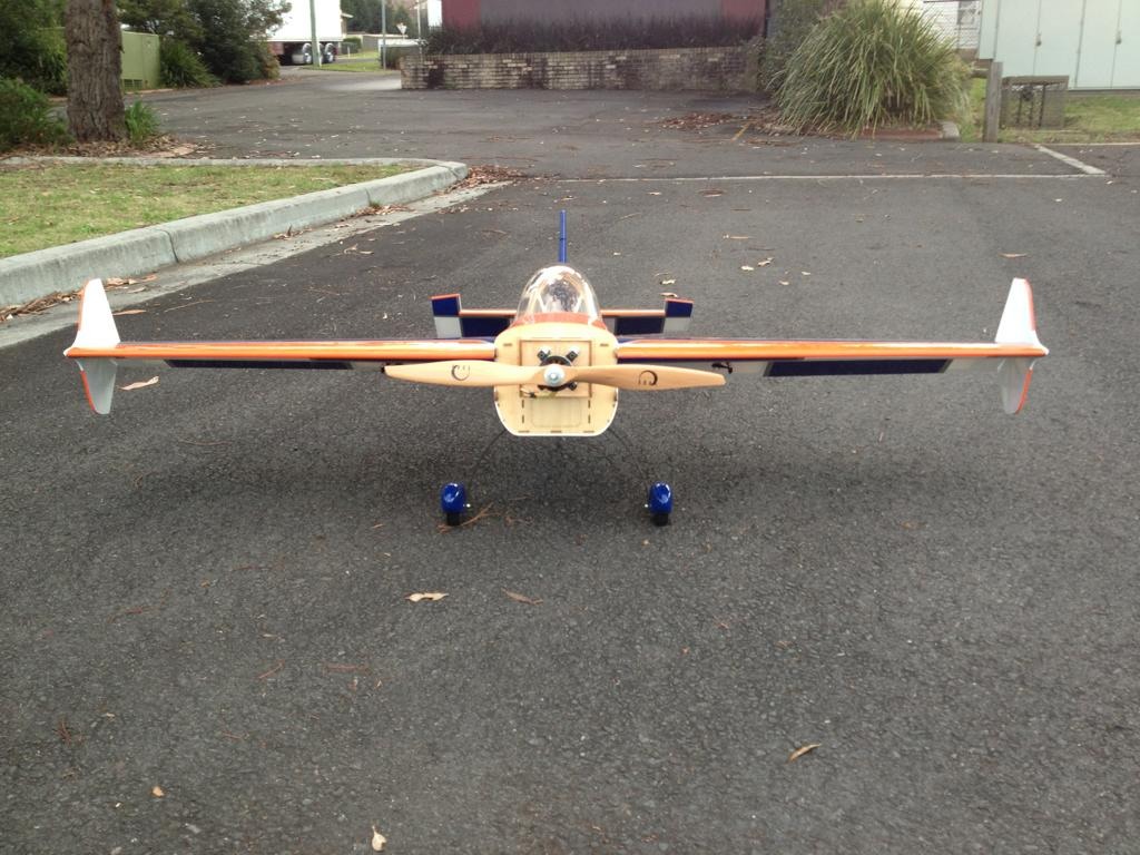

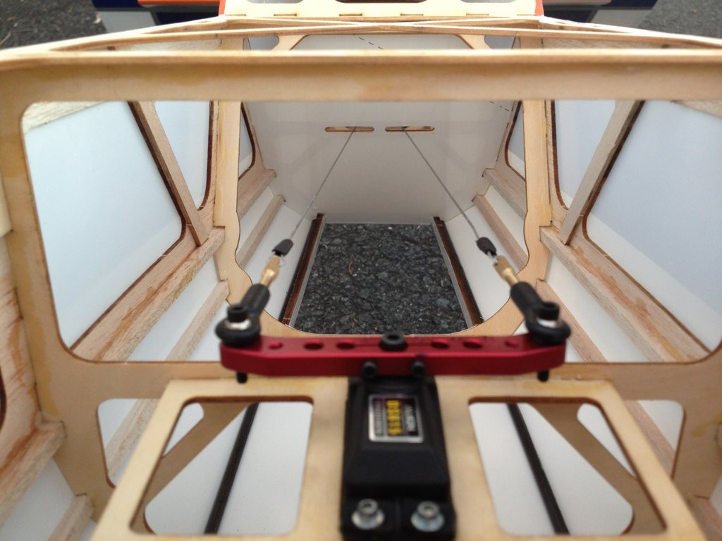

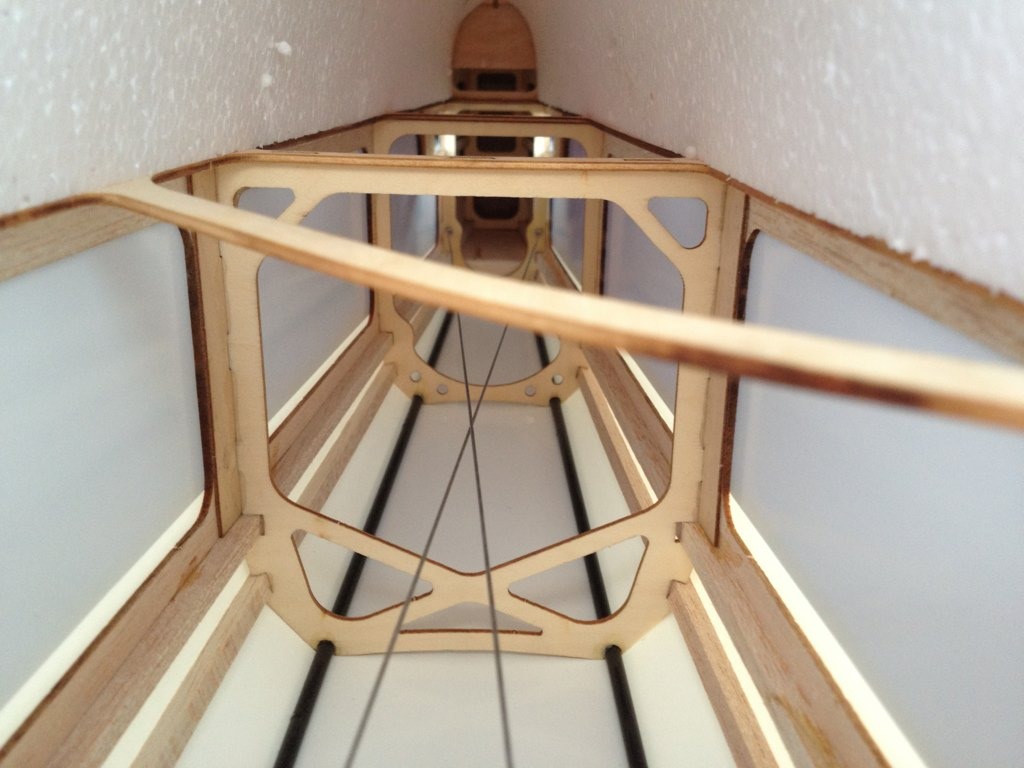

I got a bit more done today she's all hinged up Tail wheel is on, rudder servo and cables hooked up, aileron servos and linkages connected and most importantly the donk is semi bolted up. Ive used some 3" alloy standoffs I had laying around and needed another 15mm set of standoffs to get the spinner gap right the bolts I had to mount the standoffs were too short once the additional spacers were on so it's off to the bolt shop tommorow.
![ImageUploadedByTapatalk1370934144.945302.jpg ImageUploadedByTapatalk1370934144.945302.jpg](https://www.giantscalenews.com/data/attachments/60/60800-75e616c0ee0acd3642fa3420f8774a4a.jpg)
![ImageUploadedByTapatalk1370934160.558411.jpg ImageUploadedByTapatalk1370934160.558411.jpg](https://www.giantscalenews.com/data/attachments/60/60801-0f0860d905f80fd5249af78bb24b2e45.jpg)
![ImageUploadedByTapatalk1370934175.874567.jpg ImageUploadedByTapatalk1370934175.874567.jpg](https://www.giantscalenews.com/data/attachments/60/60802-10201431b7e6cc0a23ccd82ce362b466.jpg)
![ImageUploadedByTapatalk1370934190.981519.jpg ImageUploadedByTapatalk1370934190.981519.jpg](https://www.giantscalenews.com/data/attachments/60/60803-c85b2c5a5c5bd0d0e31273f33bca7850.jpg)
![ImageUploadedByTapatalk1370934204.034129.jpg ImageUploadedByTapatalk1370934204.034129.jpg](https://www.giantscalenews.com/data/attachments/60/60804-765a39615a44a1f23e2422b2e312c020.jpg)
![ImageUploadedByTapatalk1370934221.438008.jpg ImageUploadedByTapatalk1370934221.438008.jpg](https://www.giantscalenews.com/data/attachments/60/60805-69cb02b119c782a3b03b31b9600a5eac.jpg)
. This is the gear I'm using Motrolfly DM4325 280kv and castle ice 120hv or ZTW 120hv on 8s swinging a 20x8 Xoar. Castle bec pro
Align DS615's on rudder and ailerons. Align DS515's on elevator. Precision Aerobatics 1.5" carbon servo horns on ail and elev and SWB 3" offset servo horn on the rudder.
