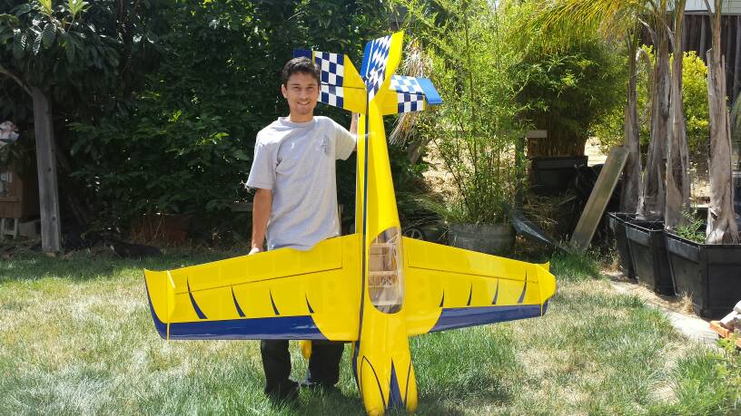

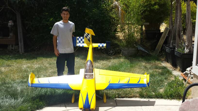

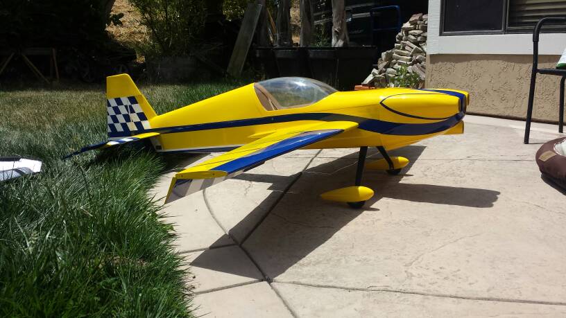

Got mine today. The blue and yellow is beautiful! Got it all mocked up so I could take a pic real quick. Can't wait to get it flying.

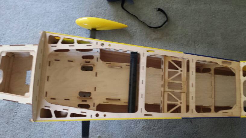

I did some measurements of the E version.
980 grams on the fuse no canopy. 1176 with it.
155 grams on the hardware with baggies.
I did the cowl, wings, and stabs and I am pretty close to Ryan, so just go with his extensive measures.
Cowl to back of rudder is 74.5". [MENTION=95]Aeroplayin[/MENTION] is figuring out the wing area from some measures I made of the wing.
Motrolfly needs 55mm of standoff.
Here are some photos.

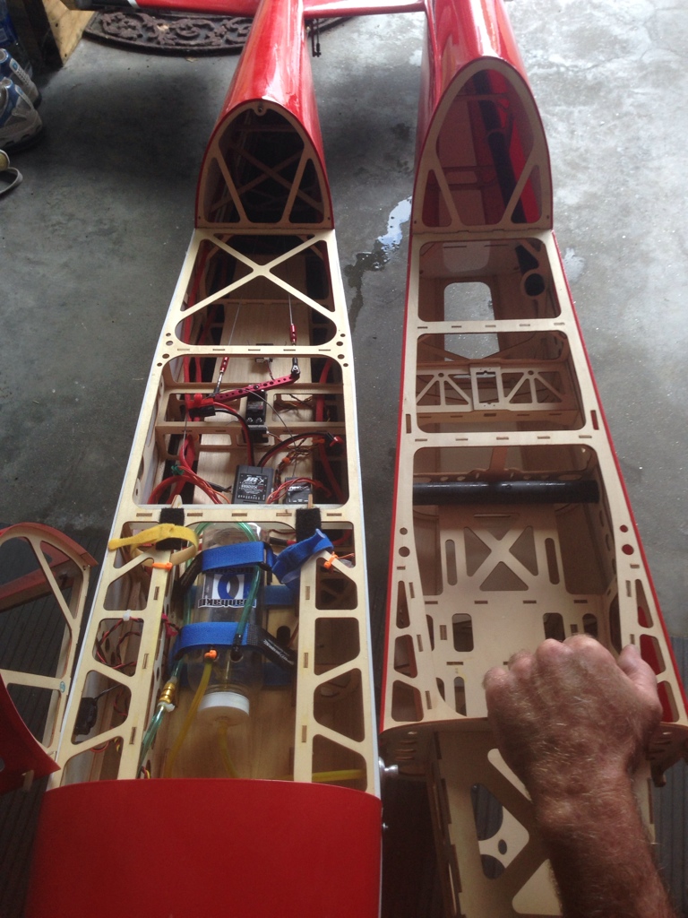

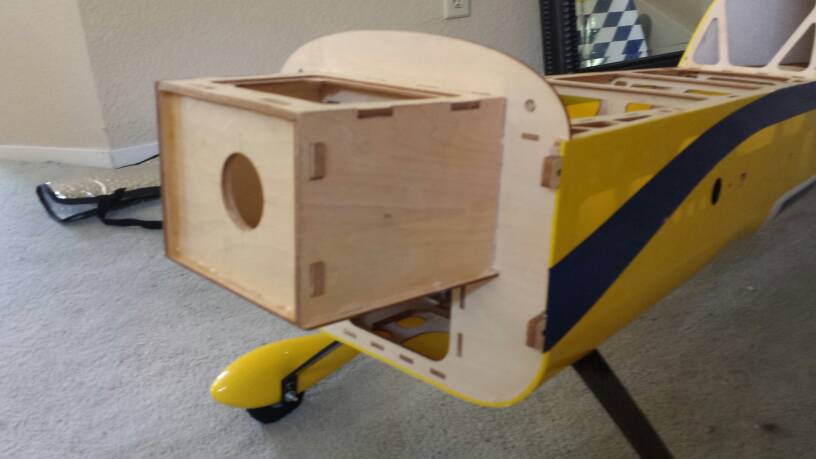

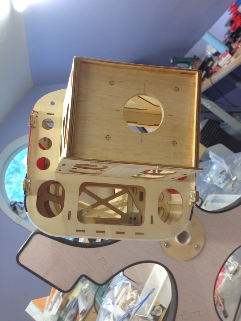

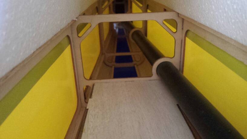

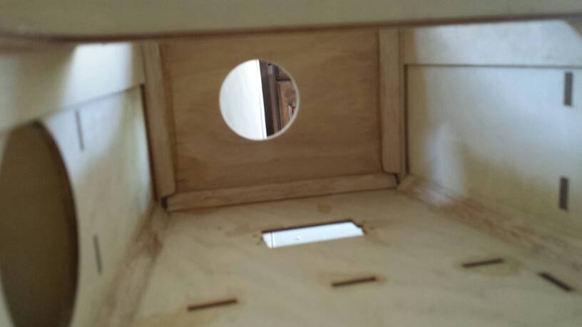

Here are some pics of the gas version. Wings are reinforced with CF similar to the 91 and 104 Extras. It comes with LG fairings but I left those off for now.
I should be picking up everything I need to get it RTF from Aztech Aeromodels when I go up to Washington in a few days. Maybe I'll grab some bling for it too :)
uploadfromtaptalk1406594487553.jpguploadfromtaptalk1406594524555.jpg uploadfromtaptalk1406594397317.jpguploadfromtaptalk1406594403935.jpguploadfromtaptalk1406594410171.jpguploadfromtaptalk1406594416994.jpguploadfromtaptalk1406594422708.jpg
