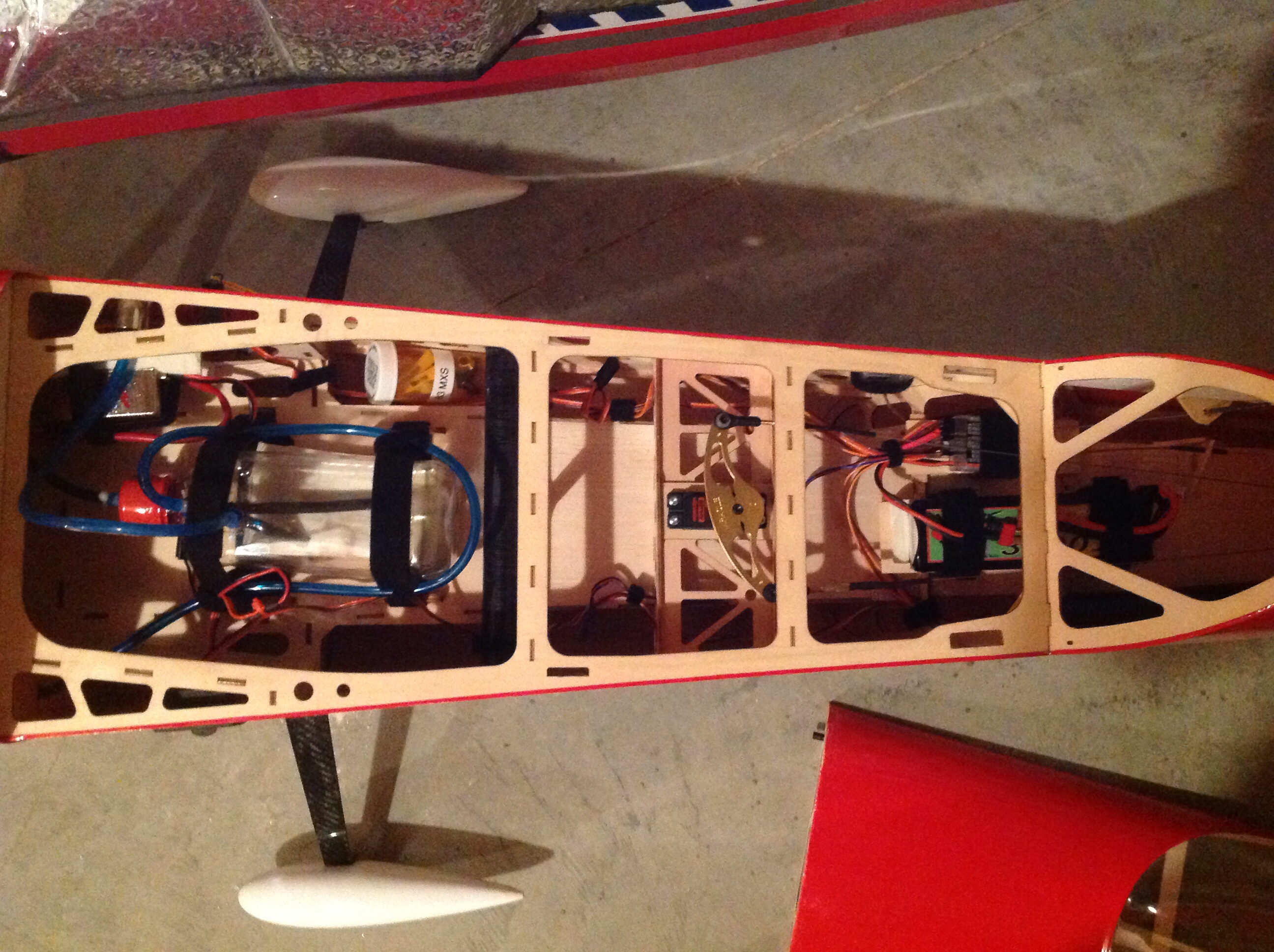

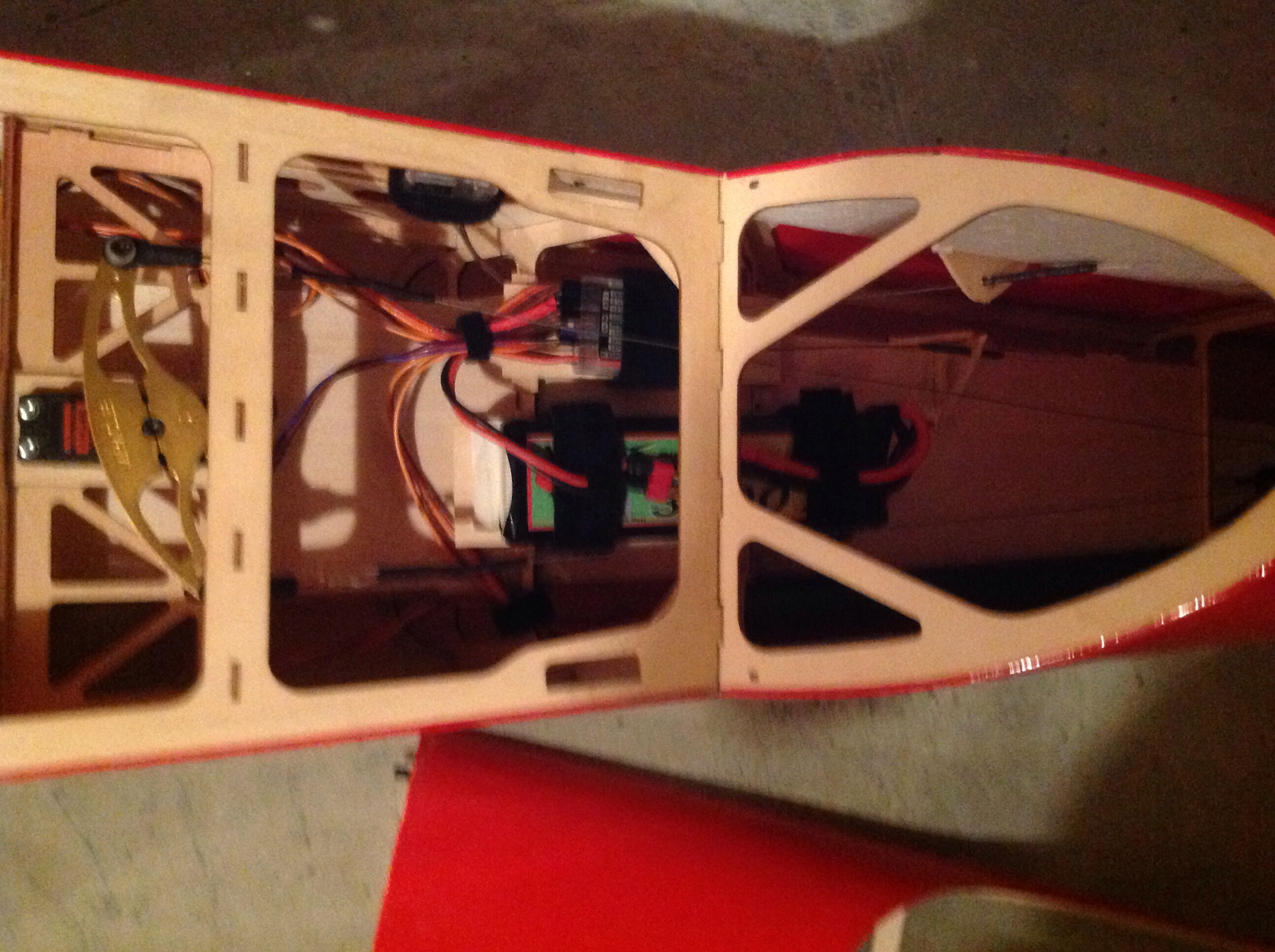

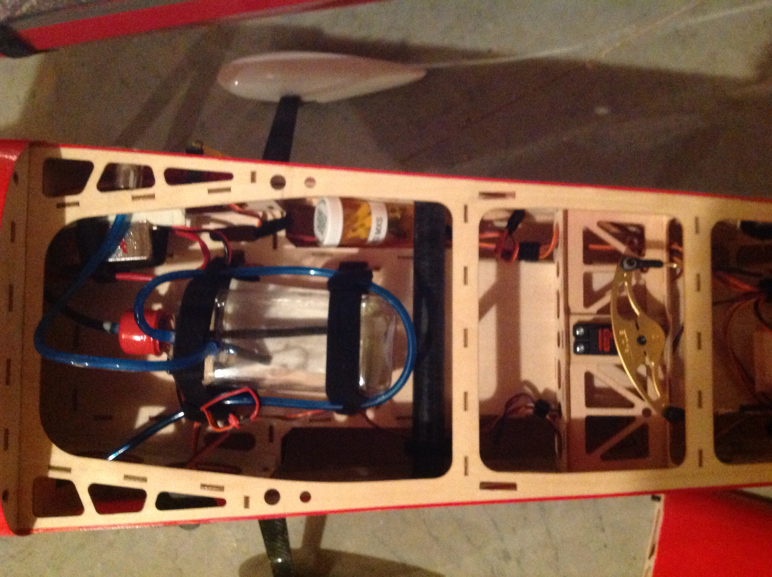

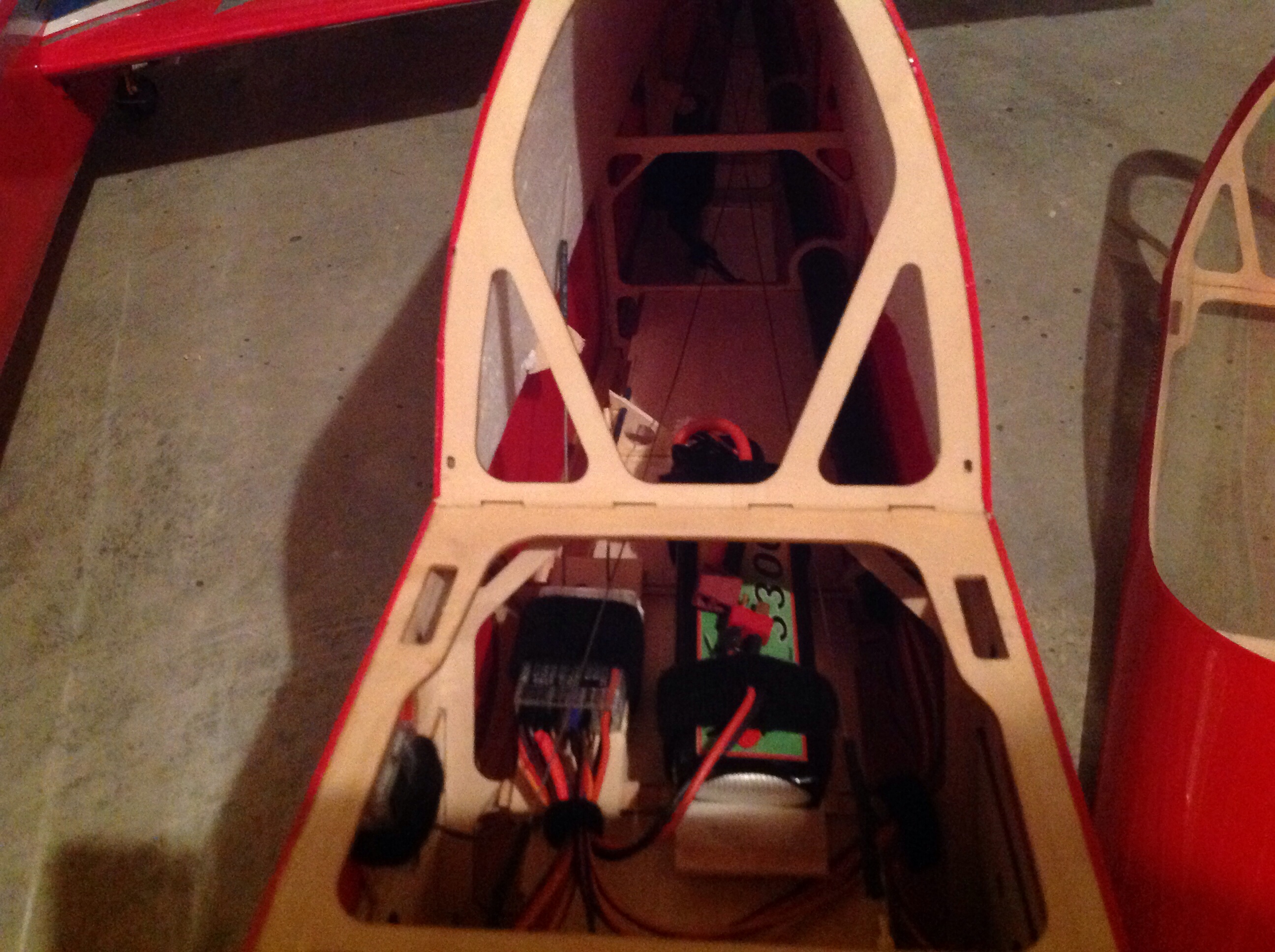

I got a request to show where I put stuff inside my plane so here are some shots.
Jeff

Patrick reminded me his is 14.1 pounds with a piped DLE-35. I weighed it with my 5300s and it was hovering between 14.3 and 14.4 pounds. I will go through a lot of different combos before I find what I like. The CG is bothering me as even with the 3700s against the tube, it was too nosey for my tastes. I am not sure I can engineer the rudder servo into the tail. Only thing I can think of to save nose weight is to do wood dowel standoffs over the metal ones I have. It is not horribly nose heavy, just enough off to make certain moves not work out right like waterfalls and knife edge spins. I spent most of the day flying with "heavy" gas props, but I had ditched the spinner.

The CG with all the sets of batteries against the tube is a bit on the nose heavy side. Nothing ridiculous, but enough to make waterfalls not great and a few other pitch moves I like. I will try my 3300s also and see if I can get a little better.
Cant you move one pack behind the tube, and slide the other forward to even the load. As to the prop, those heavy gas props have to be hard on the motor right. I love the Falcon Beech wood props for electrics. They are nice and light, and make tons of thrust. Remember if you go over the 20X8 props, you need to pick up a Falcon spacer kit as they drill a large diameter hole on the bigger props. I have a 21x10 Falcon on my Electric 30cc Extra, and it is the perfect prop for me.
