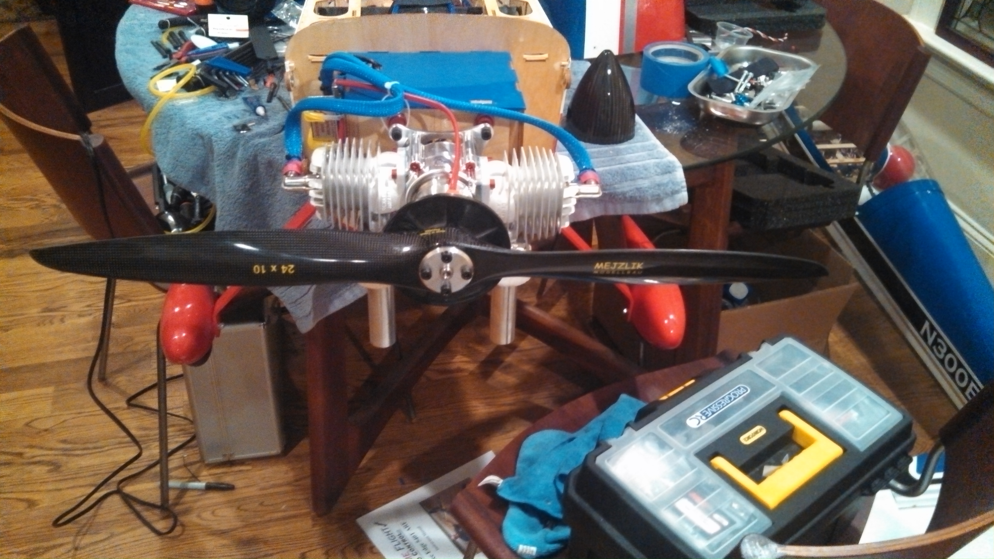

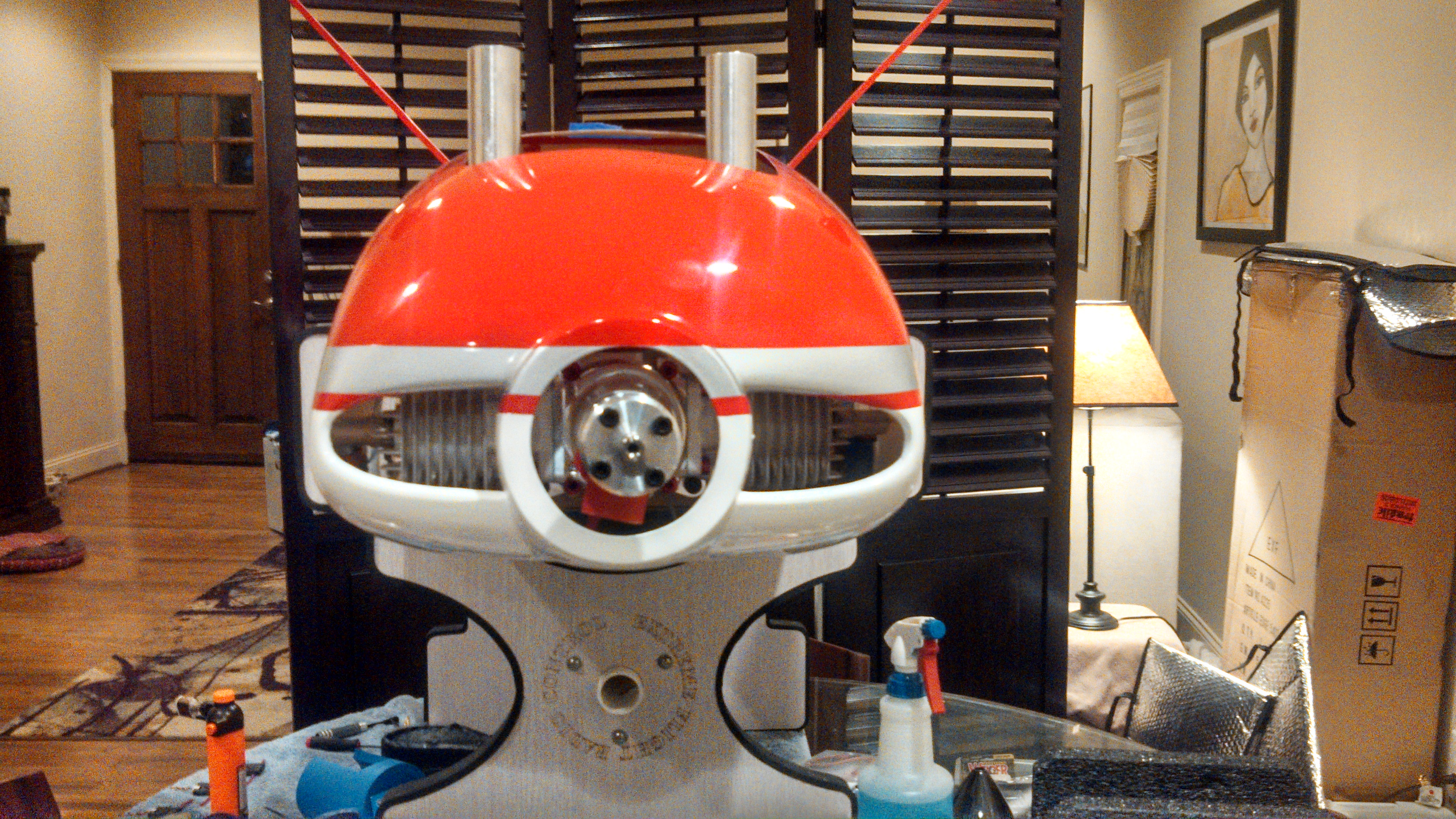

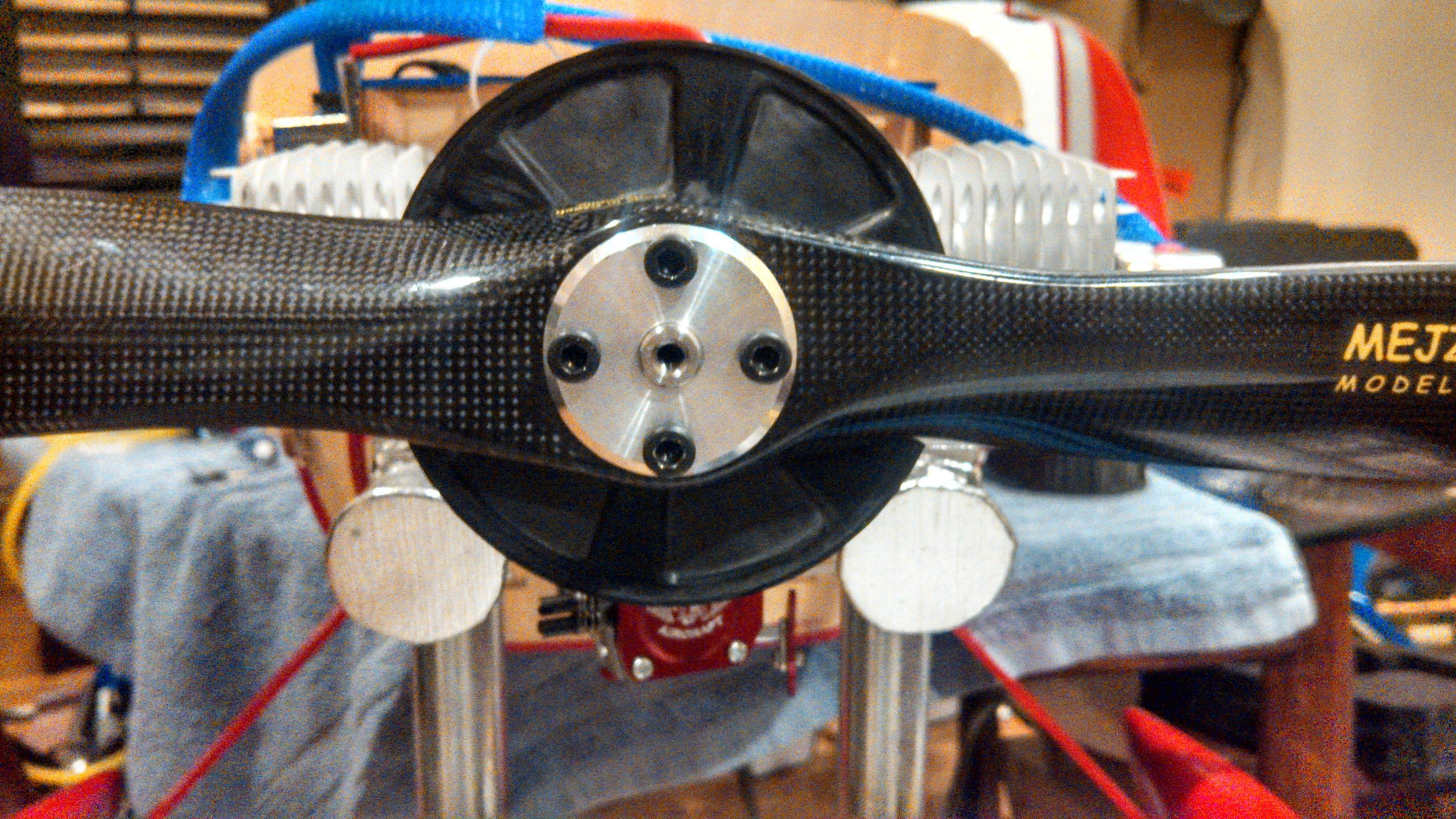

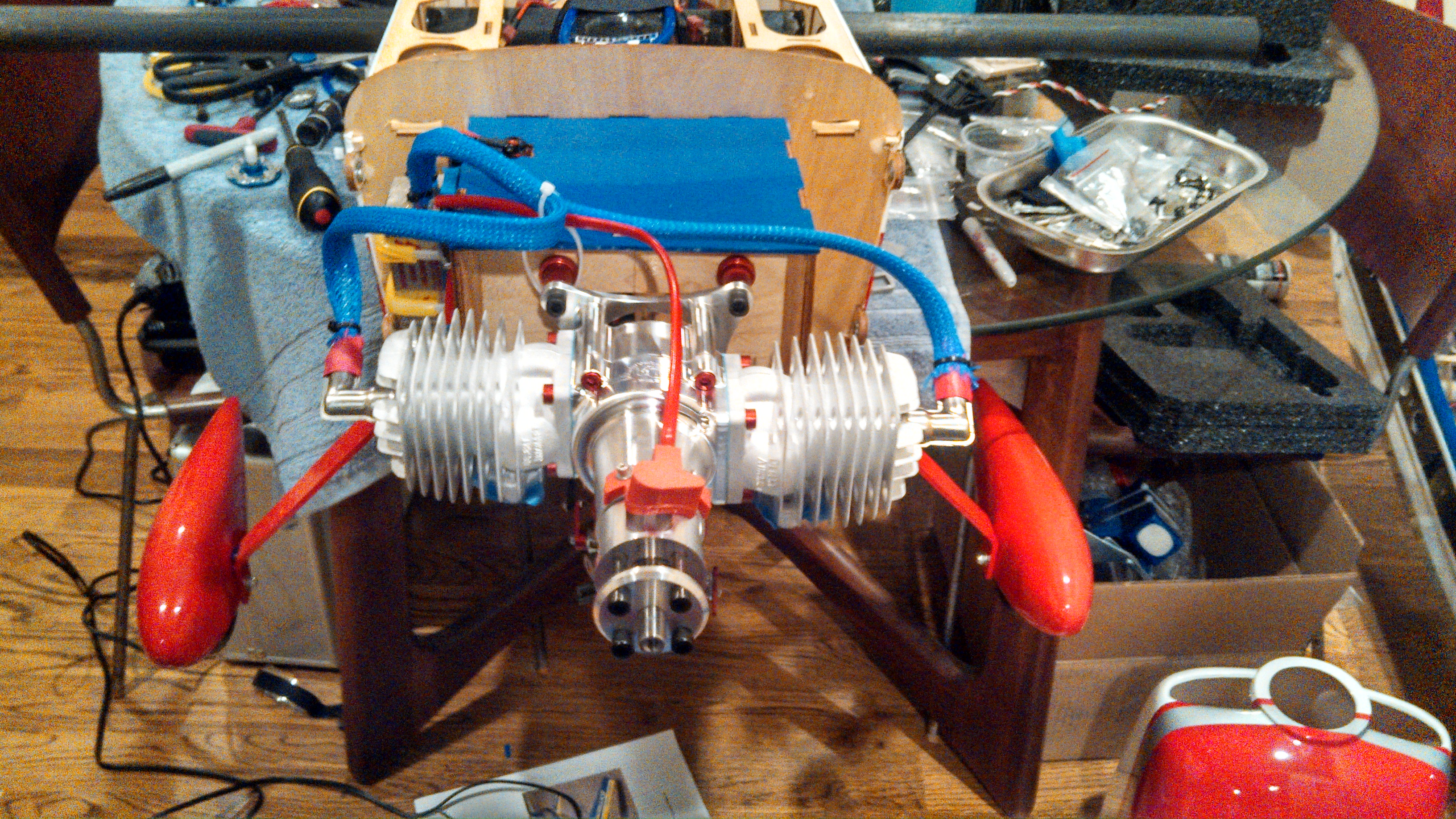

Mine is done. Fired her up today and after fighting with my small twin to get it to start the first time it was a pleasure to flip it three times to pop and two to run! What a sweet running engine. If the weather cooperates this weekend should be a blast! Mejz 24X10 standard. Da-70 on stock mufflers. It should be a 3D beast!

I learned from your experience and did cut the carb hole like you did. These pics were taken before the cowl was finished.

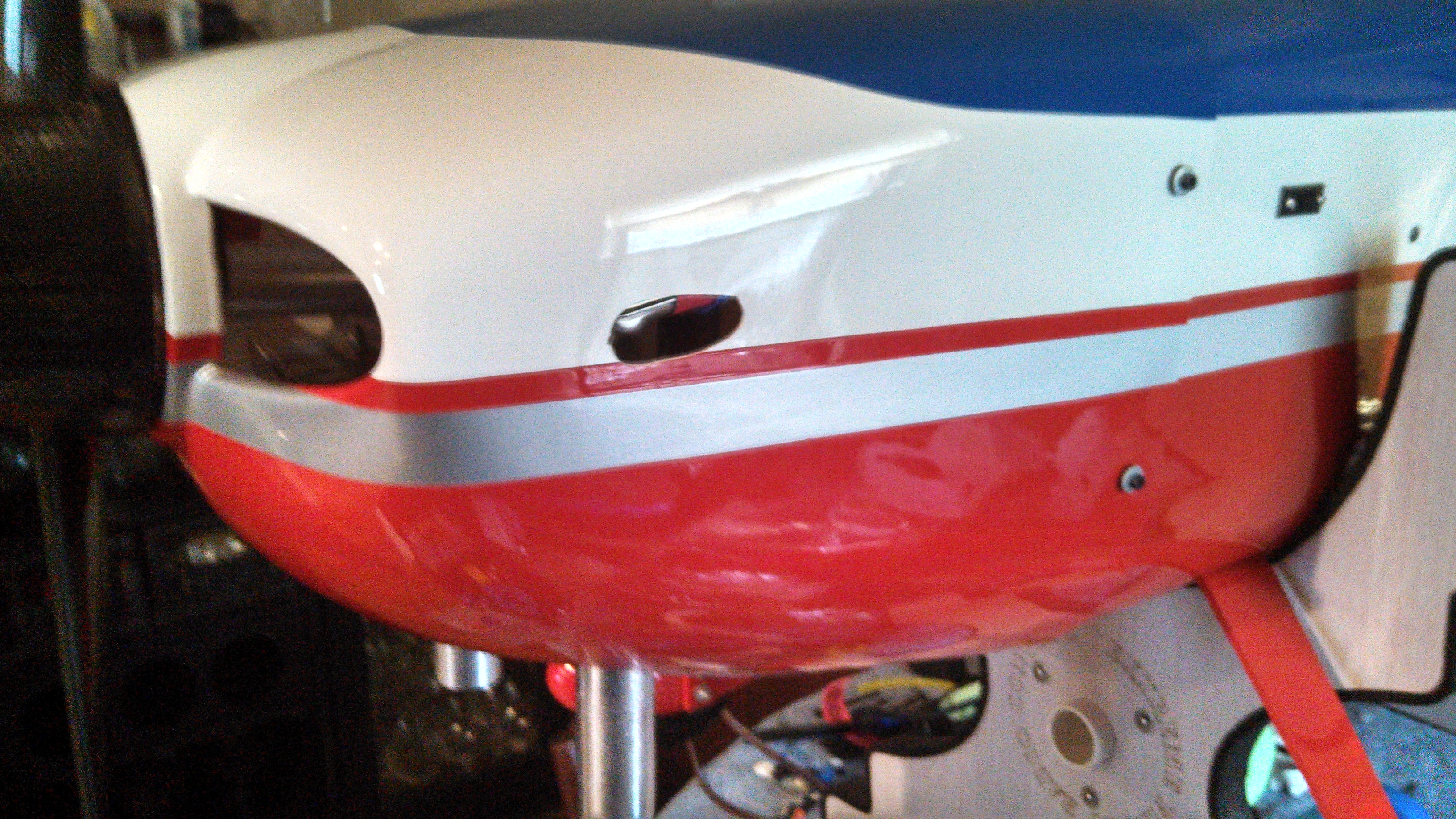

I was not happy with the slit that I cut on the left side of the cowl. It was not nearly as clean as yours. Actually it looked like a 4th grader cut it! :facepalm:

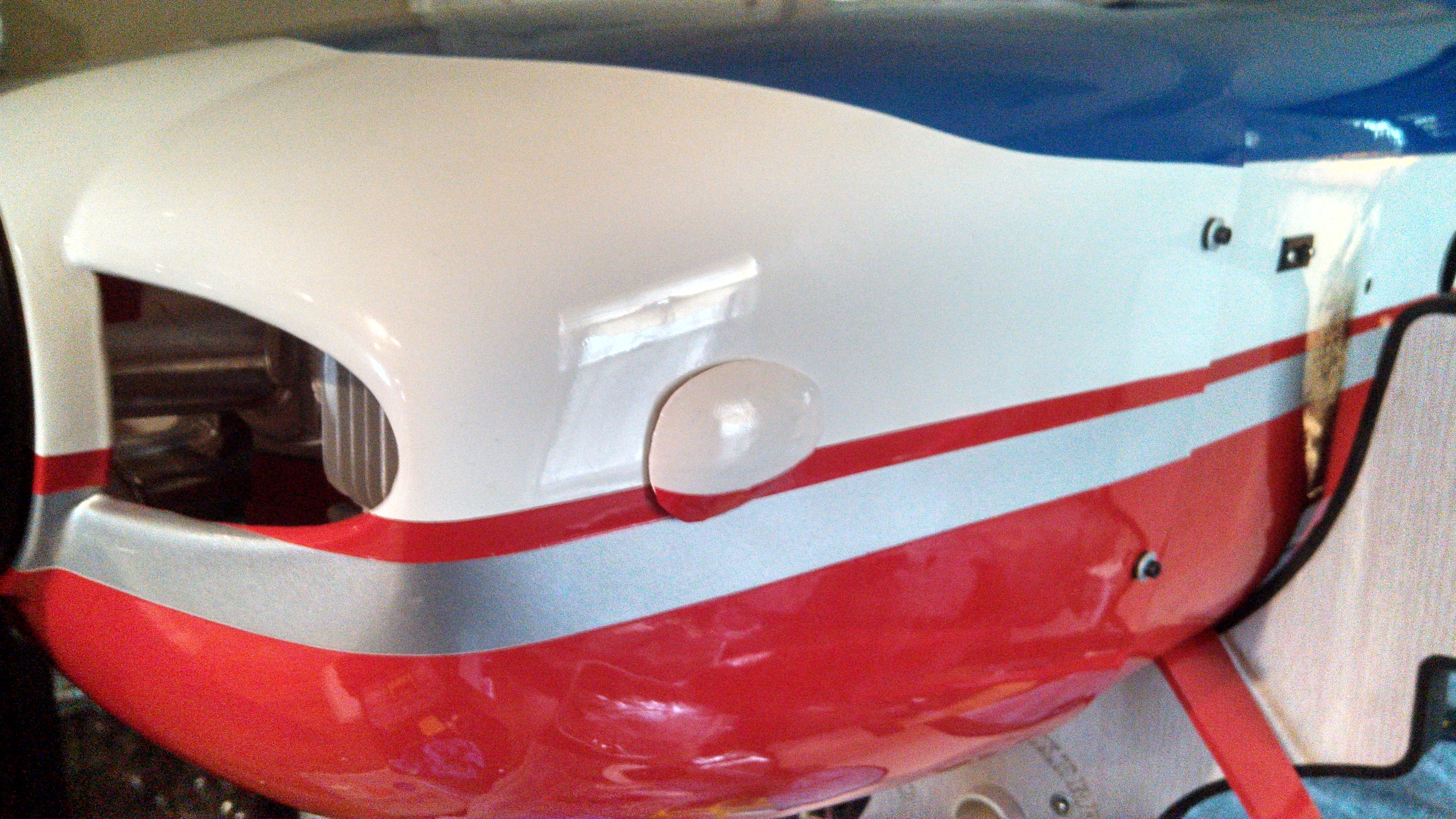

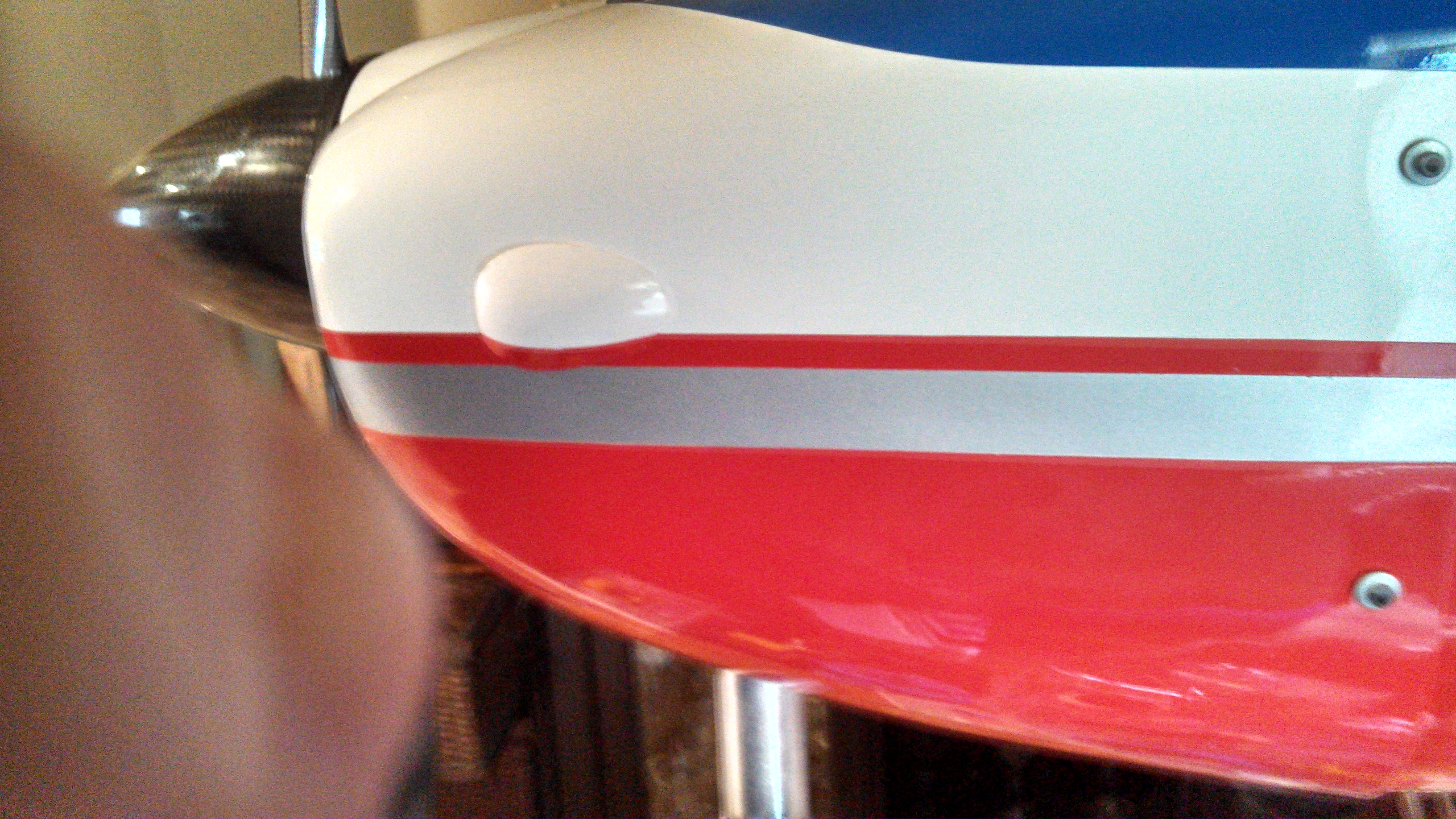

I have fashioned a blister. Just waiting for the paint to dry. I will post pics. It looks much better to me.
RKEstes
Here is the embarrassing cut for my plug cap. :thumbsdown:
Here is the blister that I fashioned from part of a plastic spoon. It is just taped in place here. I'm going to glue it on with some Welders adhesive. Not perfect but looks much better to me than the gaping maw!
