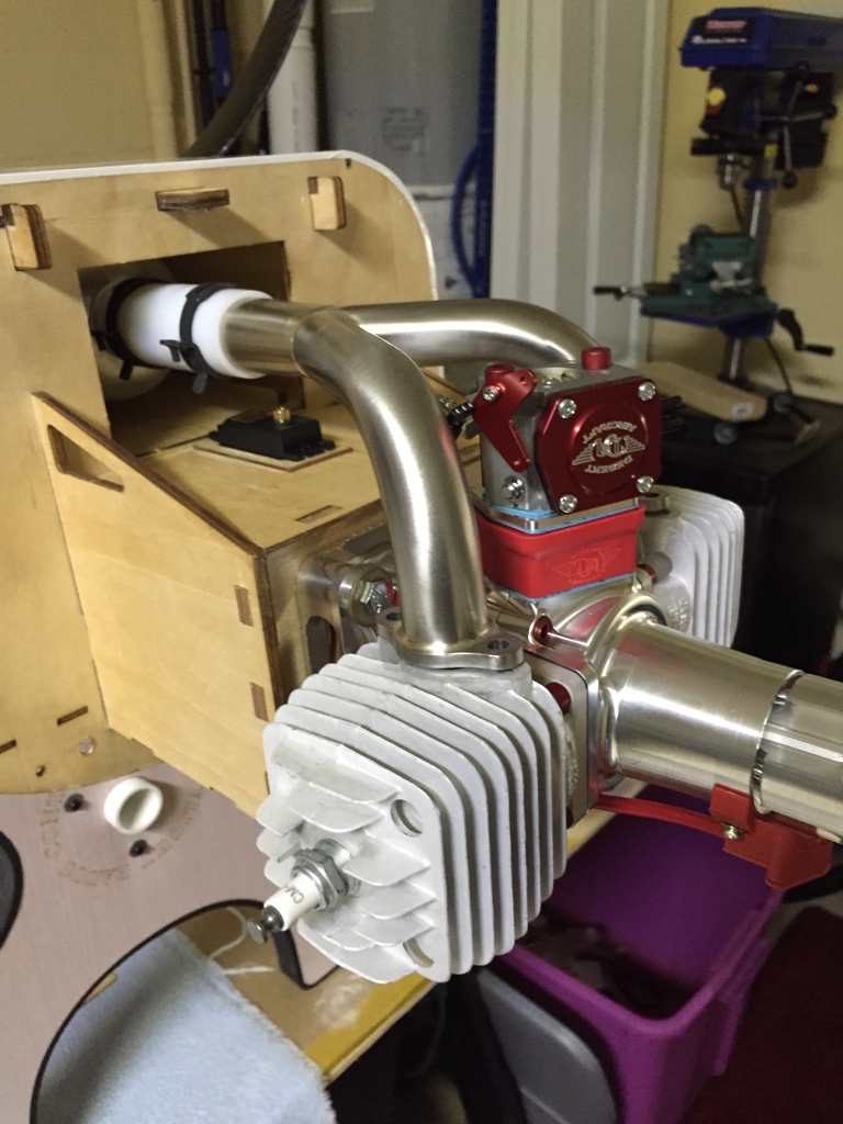

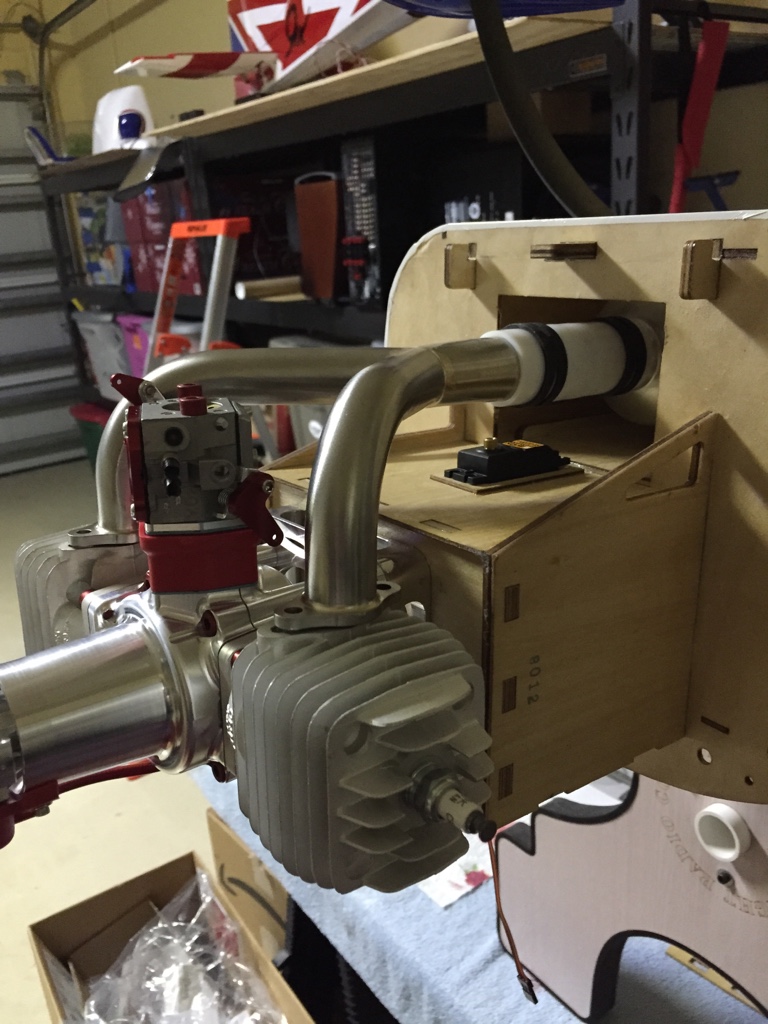

			Finally at the stage to balance the 300. I did a balance today and found out I need t place the batteries up front by the engine box for it to balance on the wing tube. I should have them installed before the weekend.
More done tonight. It's actually beginning to look like an Extra. I sealed the hindge gap for the rudder. Then installed the rudder servo and linkage. After that I installed the stabs. I double checked the throw on the stabs to make sure they were even and they were not. I checked this by using two carbon fiber rods and taping one to each of the stabs. As the stabs move up and down you can easily see if the rod stay aligned.
I have low, medium and high rate set up for the stabs and the rudder. Whelp. that's it for tonight.
