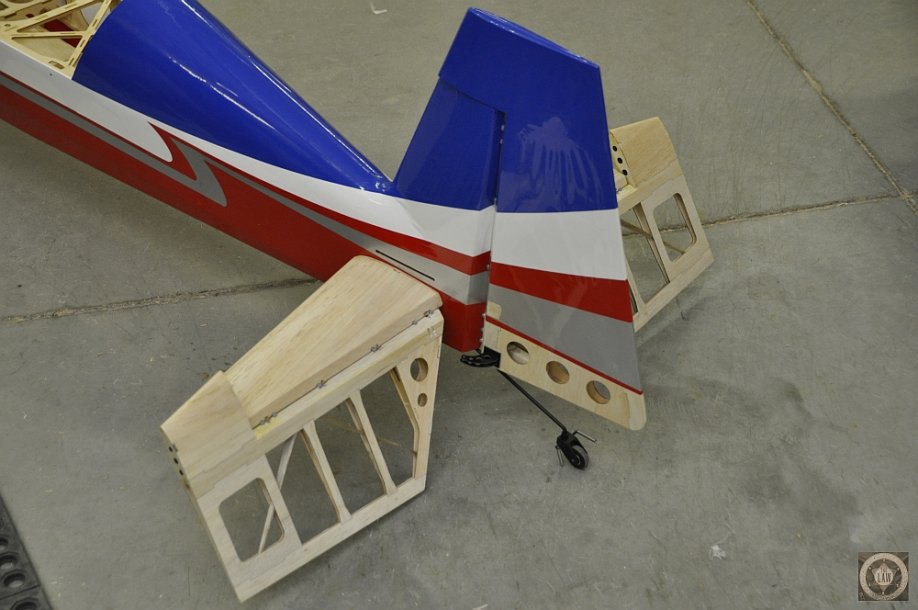

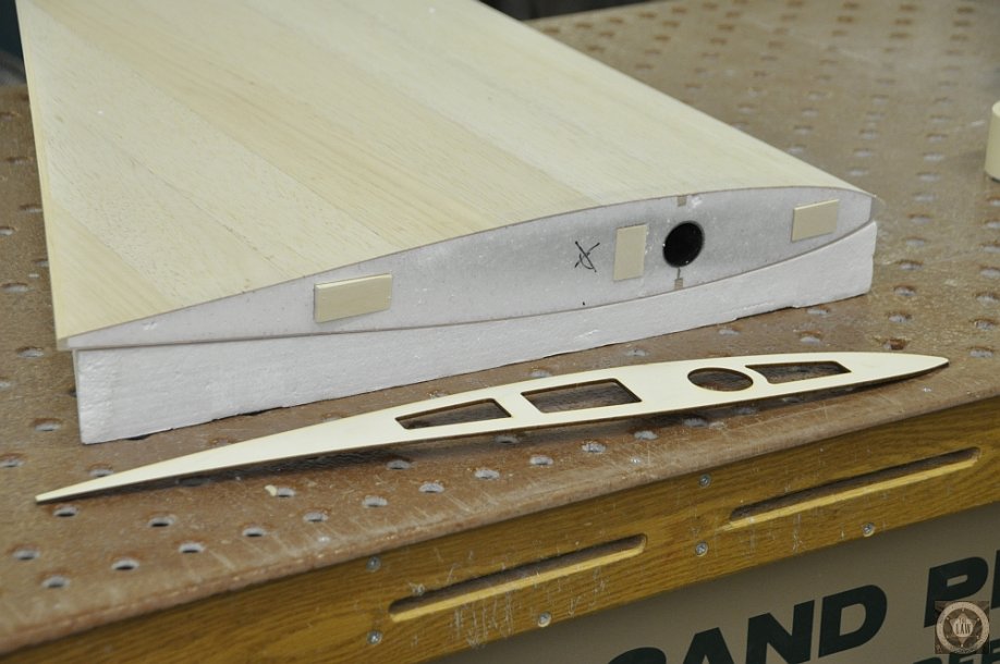

It helps keep them nice and straight over time. It also does add some strength and durability. I also will be doing some coring on these so I want to make sure the TE is going to hold up.
Terryscustom

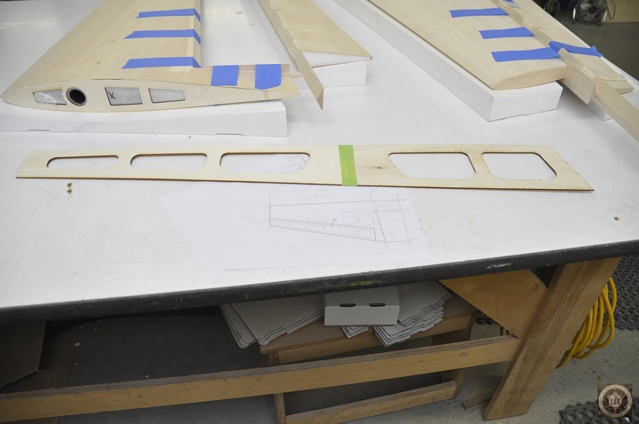

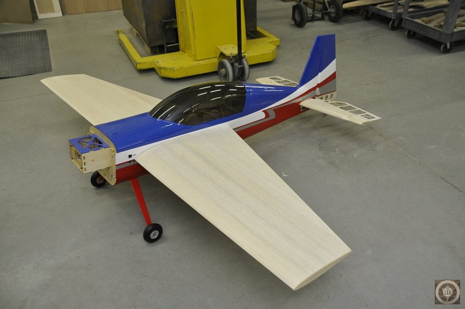

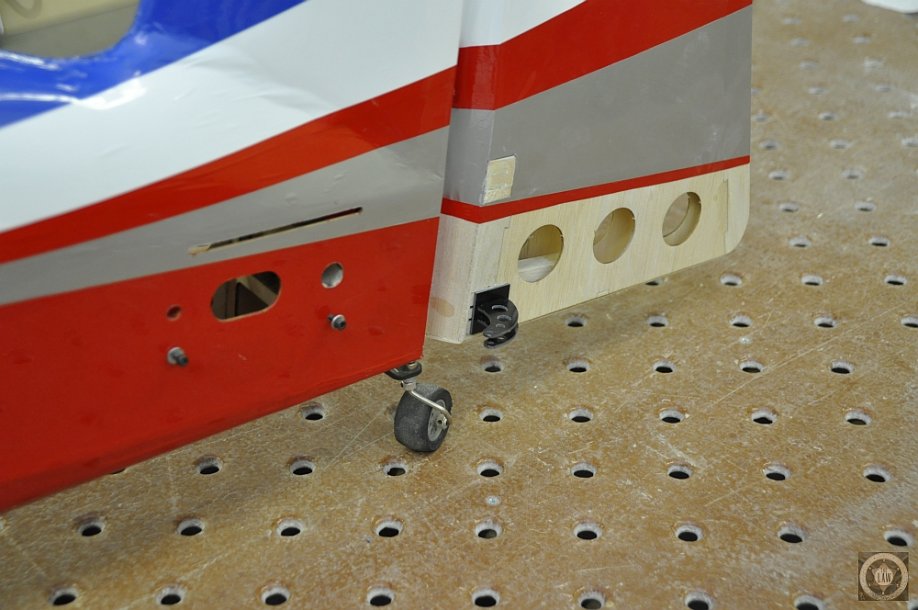

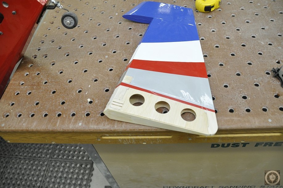

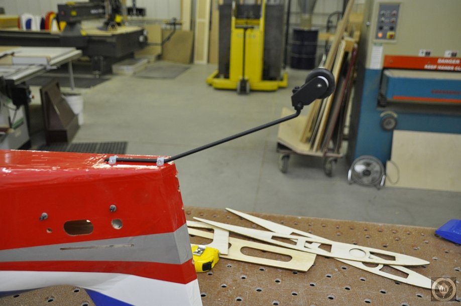

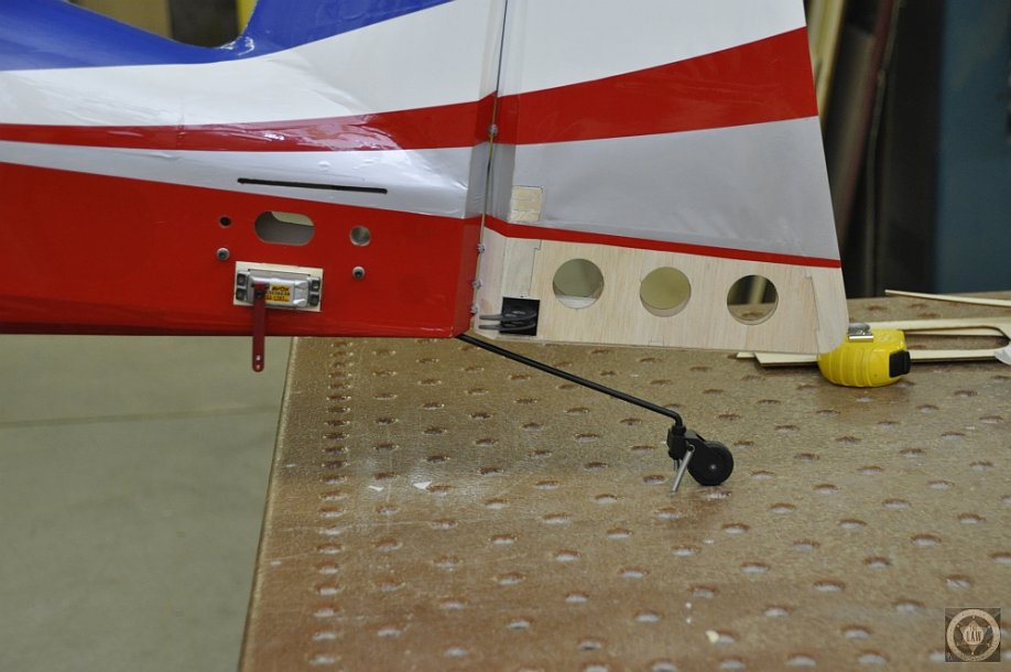

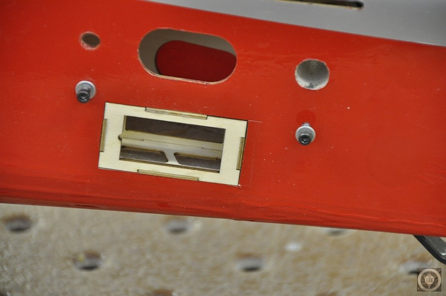

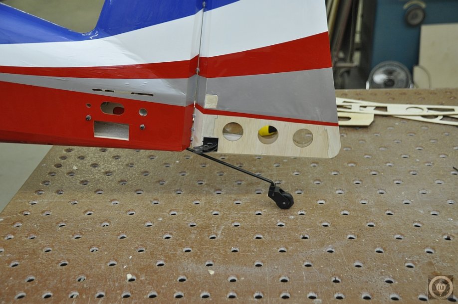

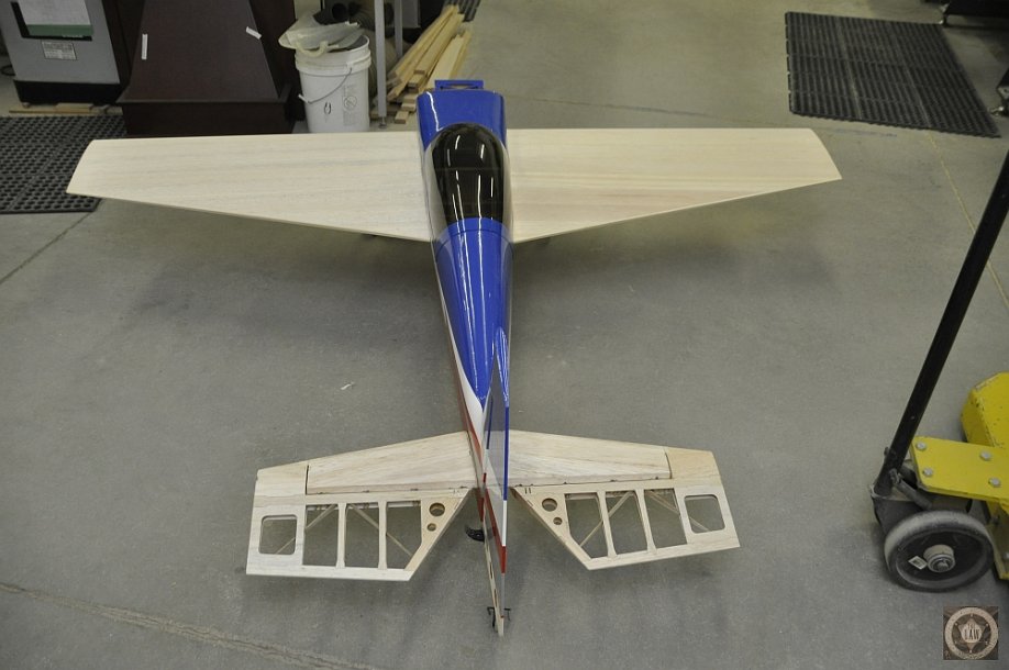

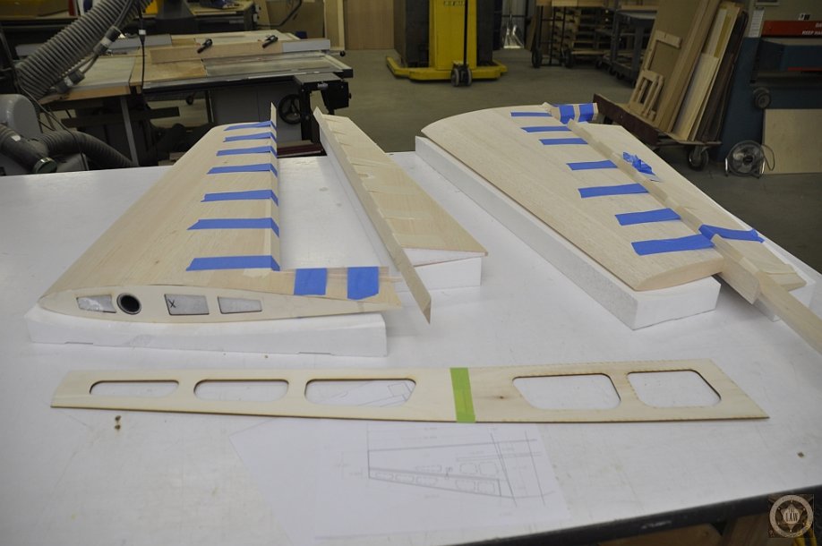

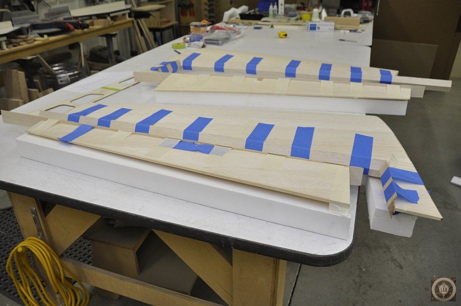

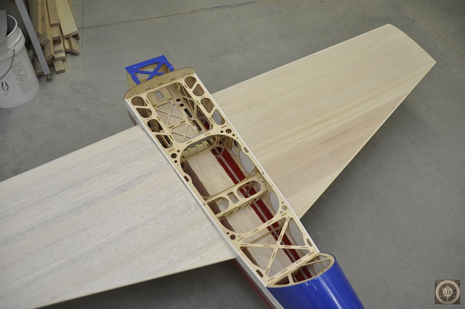

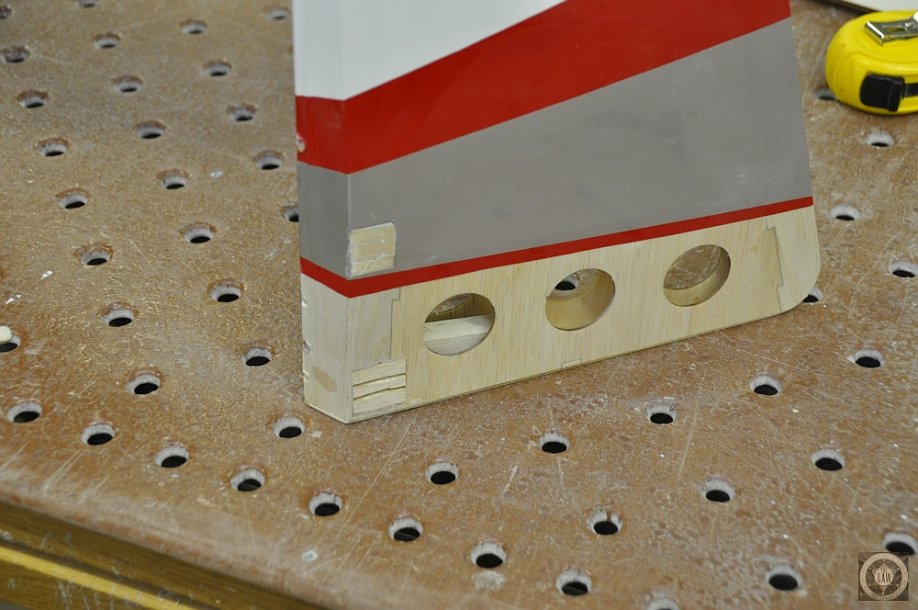

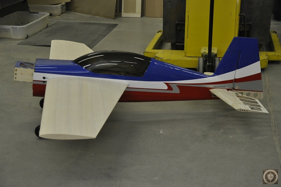

Had a few hours today so I got the wings almost done. Just need to trim the hinge stock, install servo boxes and drill for hinges:dancing-chicken:
Rudder modified for push-pull, ailerons stripped and strengthened, re-hinged (or ready to glue anyway), push-pull servo box installed in tail, fixed landing gear (was installed backwards by other owner), replaced wheels and axles, ditched the stubby little tail-wheel, and a few other fix up things.
