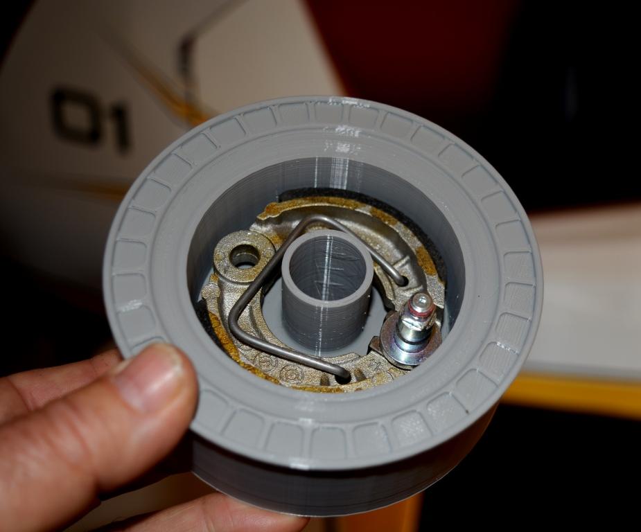

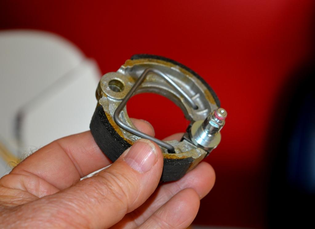

this is the drum brakes I will use on the tigercat, here fitted to a 3D printed proof of concept inner wheel part
