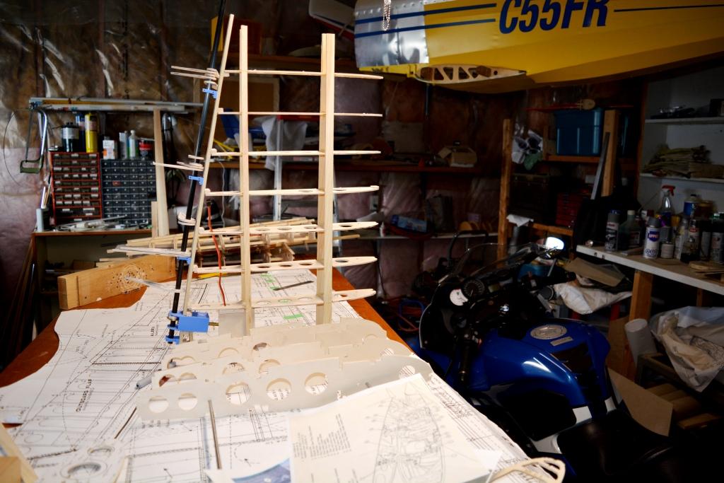

Scale F7F Tigercat 1/4 scale

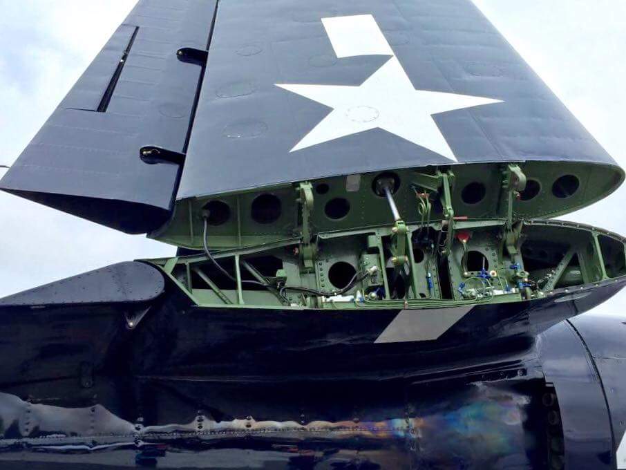

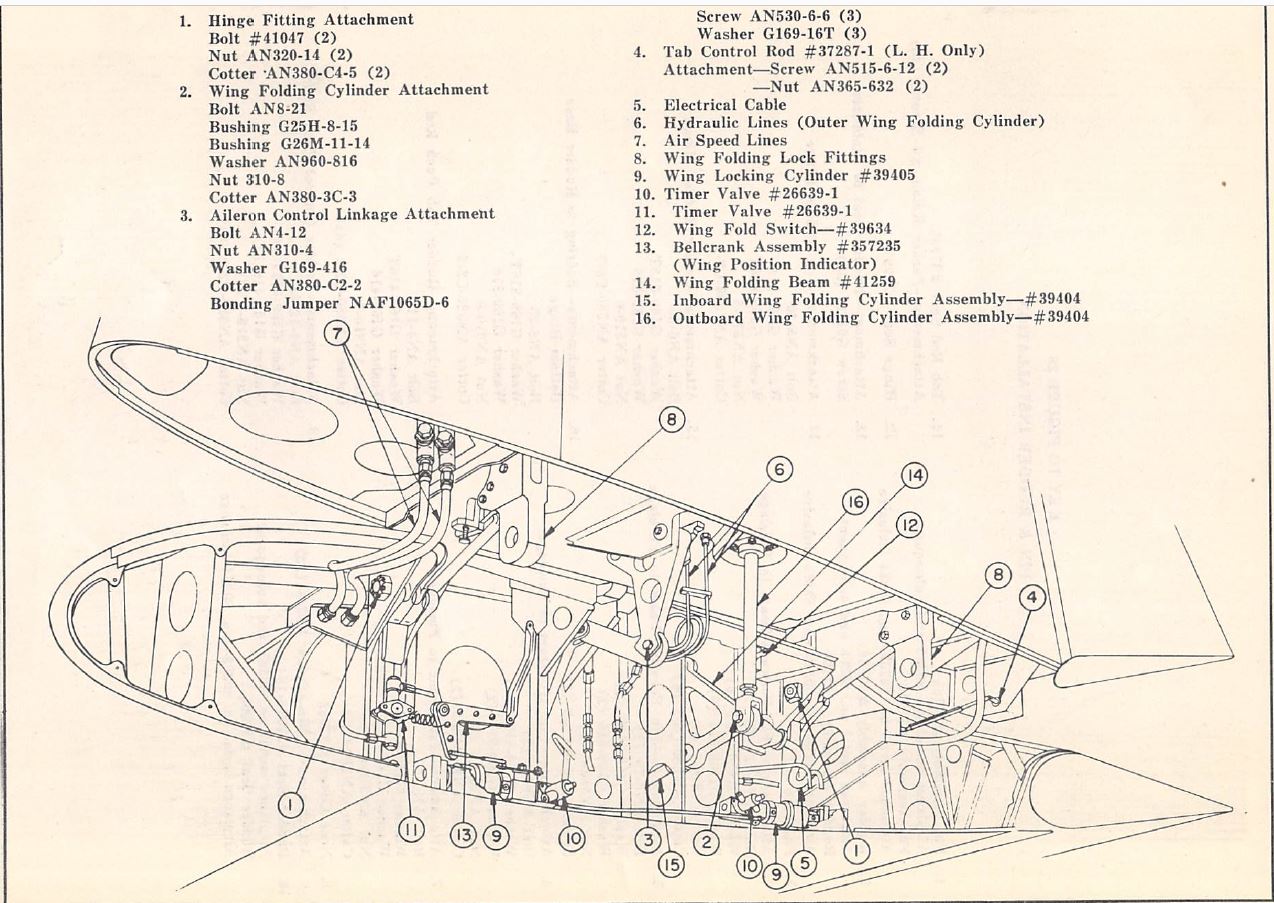

very complex part of this build, but I move on

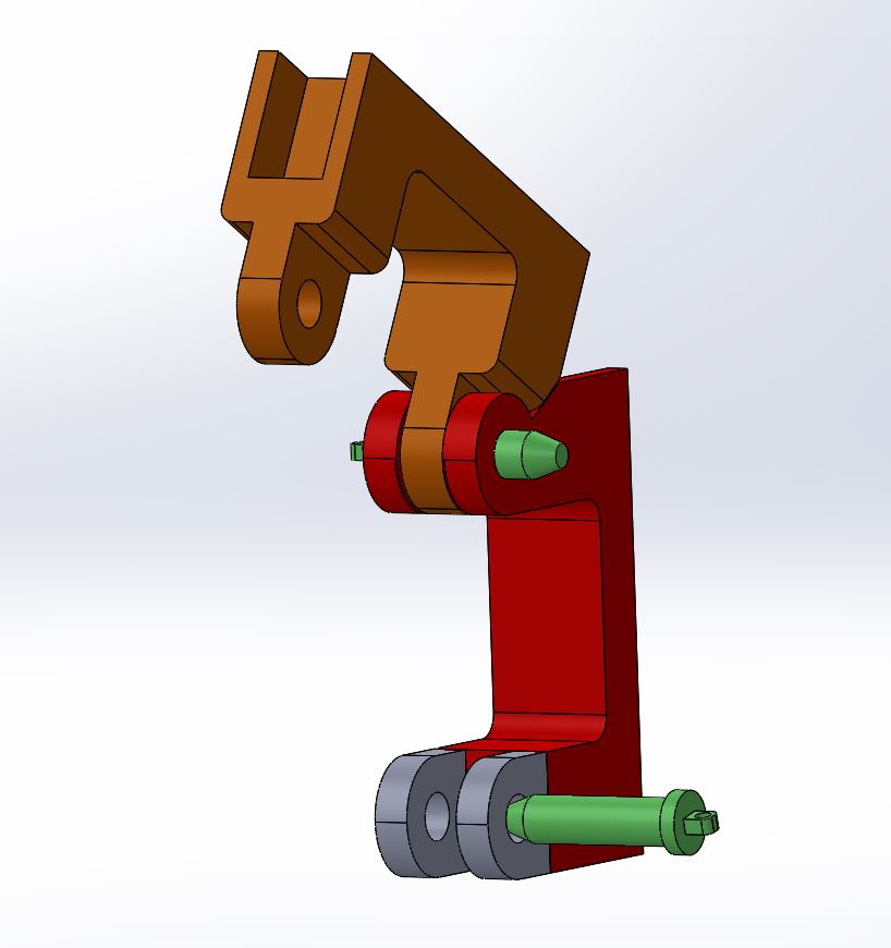

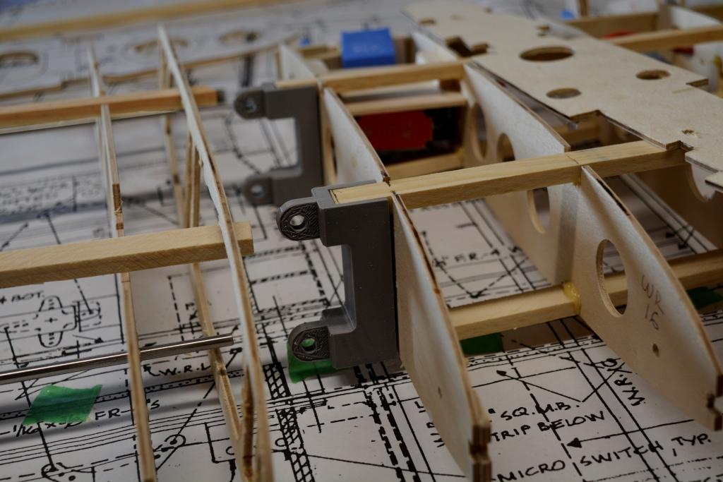

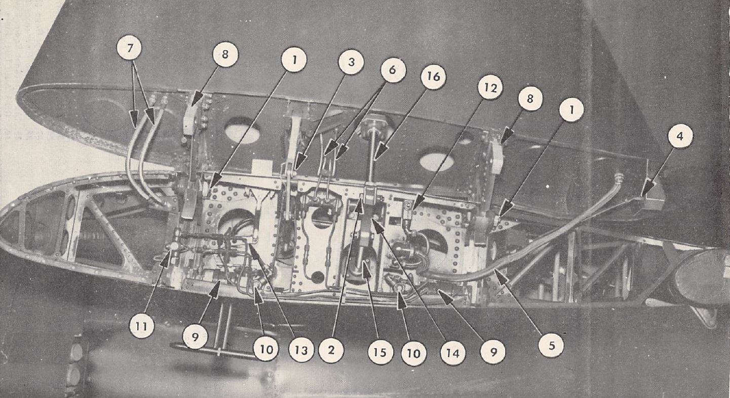

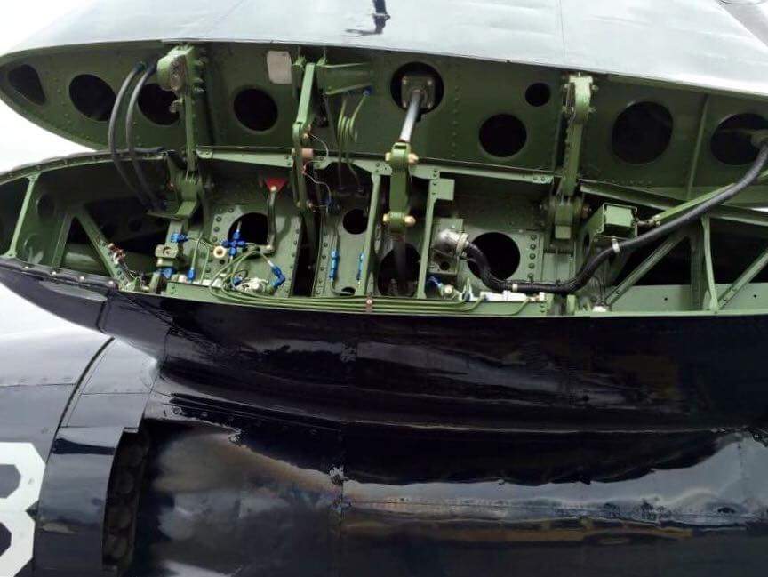

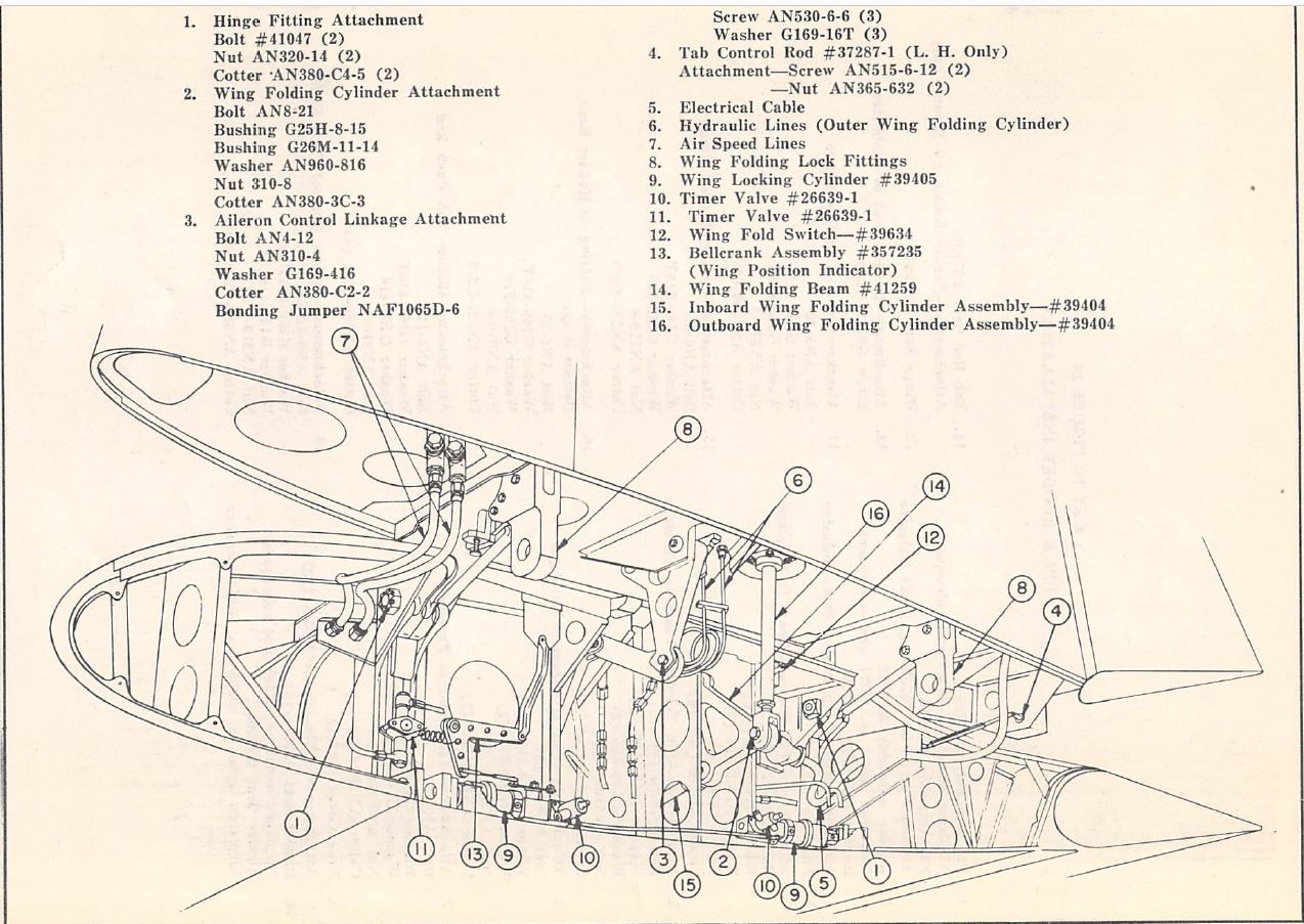

Well its scale so I have to LOL I just hope I didn't bite more then I can chew, it is quite complicated , but hey , isolation, retired, living alone, I have the time, a lot of the important parts for the folding mechanism I am designing and 3D printing for proof of concept, once I am satisfied, then on the the metal

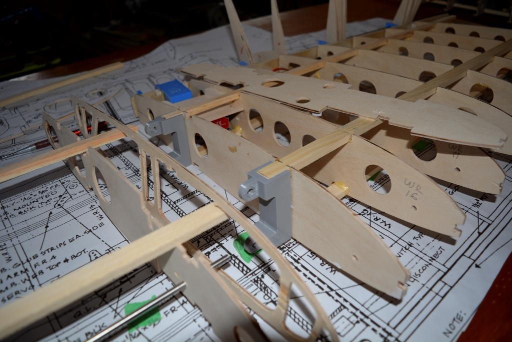

first part printed and temporarily installed , these are only for proof of concept, they will lightly screwed in place , once the other wing part is done, it will also have the receptor for this hinge , also 3D printed, and temporarily screwed in place then the other part is the actuator cylinder . Once I happy , only then I will make these parts out of plywood and aluminum , so far its looking good but I can see where the plastic part might be extending a bit too much, will see

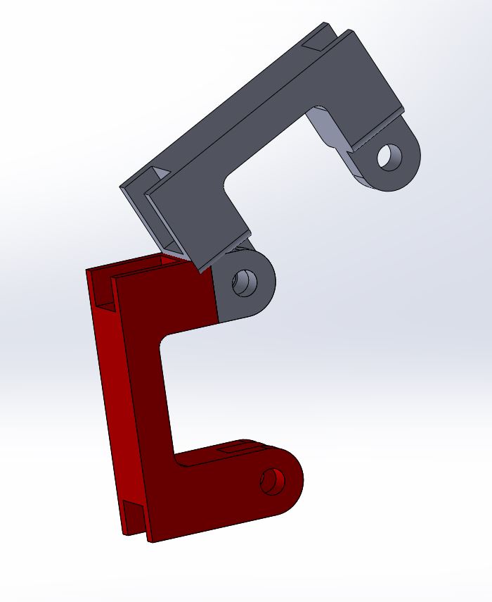

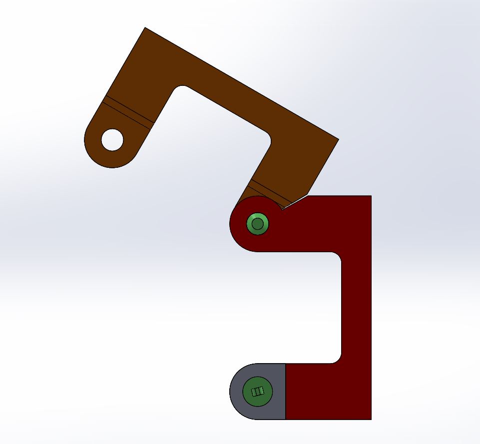

and this is why I do these things on cad first , as you can see in the cad photo , big problem, easy fix then print for proof of concept,
