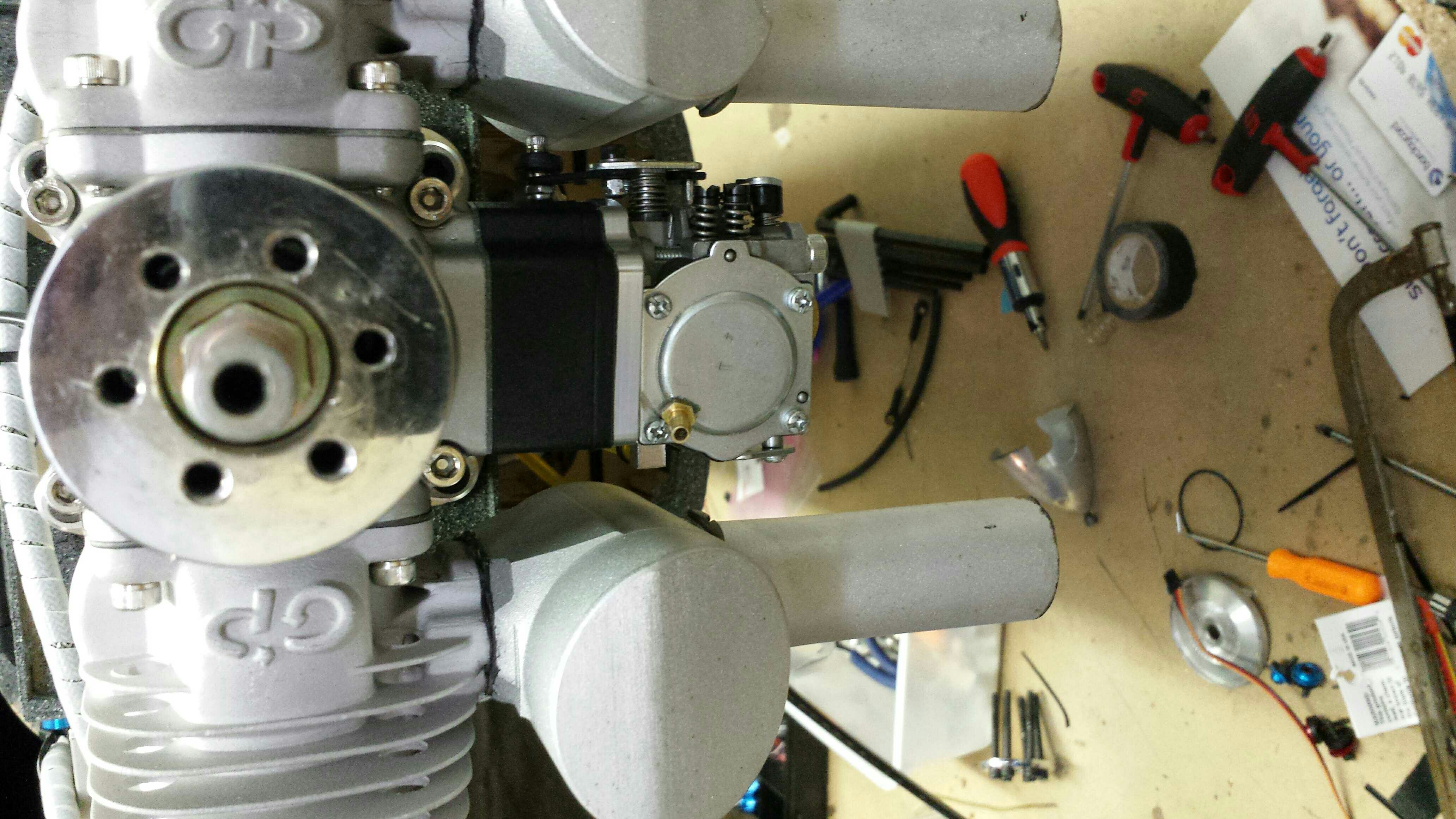

Yeah.. I Baffle all of my 100cc planes and all of my air exits out of the Pipe tunnel.. and im at at good 1 in to 3 out
uploadfromtaptalk1399698209442.jpgputting a static pressure pine on my carb it was going rich on knife edge building pressure in the cowl
View attachment 23121putting a static pressure pine on my carb it was going rich on knife edge building pressure in the cowl
