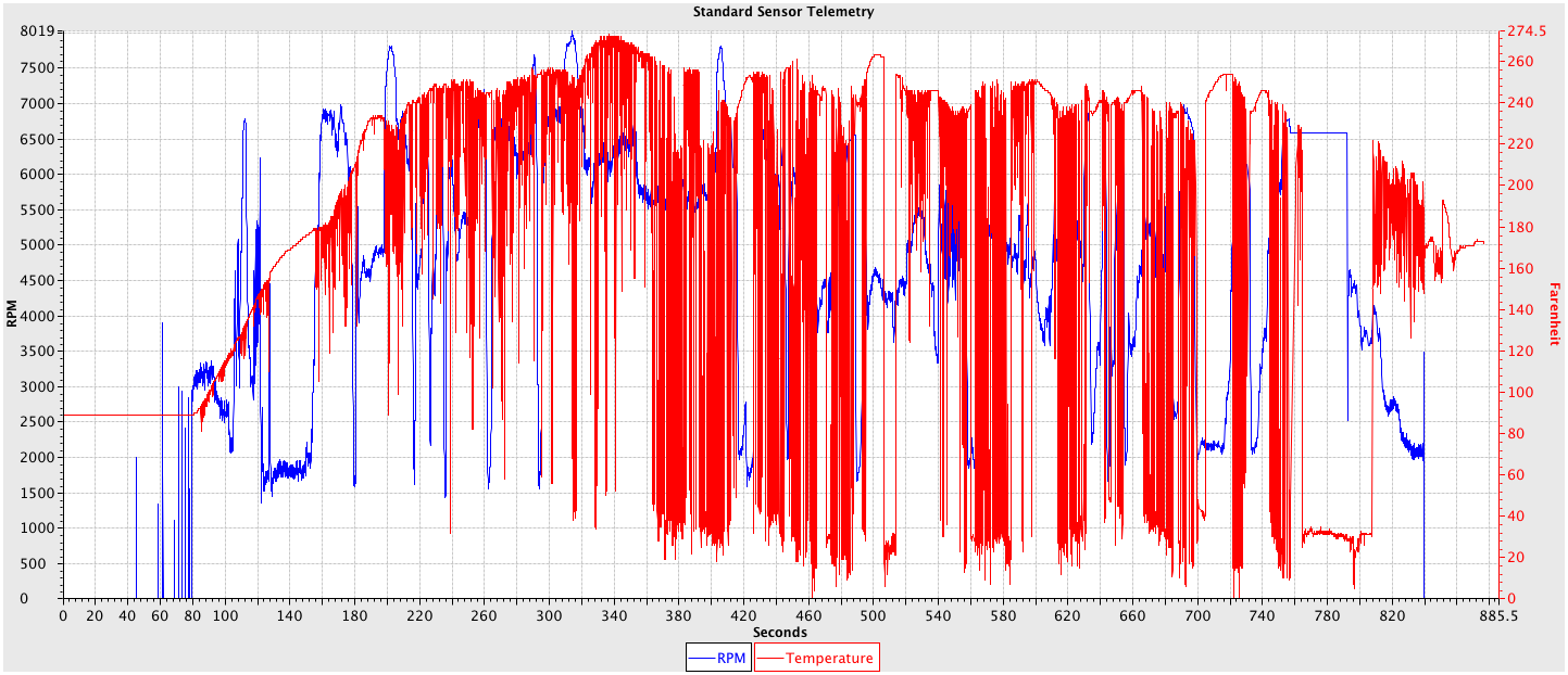

I was amazed how the GP61 performed yesterday. Below is the movie of the first start of the day with a 1 flop start!!! I simply rocked the prop 5 times to prime because I had not flown in a week.
Falcon 24x9, 90 degree ambient, 6600 on ground and 8020 in air after 5 gallons.
Thanks to Gary and Kole for the kick in the right direction.
