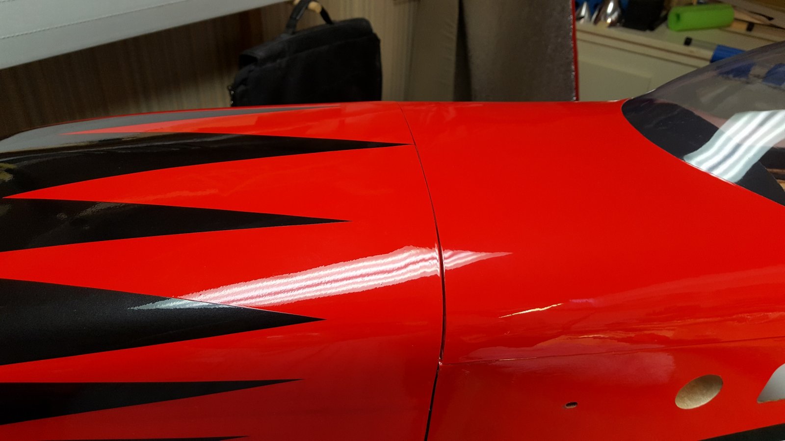

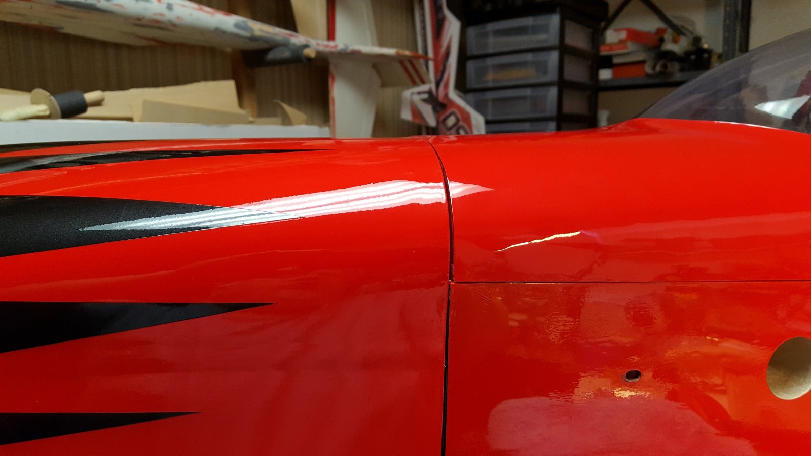

I've looked at the new hatch they sent me quite a bit and I'm have a hard time figuring out how you could make it look this bad. It's laser cut formers with stringers and then balsa sheeting. From the bottom it looks great, but somehow they managed to turn the top into a wavy, dented, gouged up mess. In my old club we had this super arrogant old guy that used to build scale airplanes from plans. Being the arrogant a$$ that he was he thought they were Topgun quality, but in reality they were awful. We used to say he measured with a yard stick, marked it with chalk, cut it with a chainsaw, sanded it with a rasp and painted it with a mop. His bodywork was better than this hatch. The paint is slick and shiny, but that just makes the bodywork look worse.
I actually made some forward progress. I started by going to my shop today and unpacking my original the hatch and rudder that I had ready to go back to Horizon. I brought them home and tried the old hatch with the new cowl. Believe it or not it actually fits! My original hatch is WAY nicer than the one they just sent me, but it had a big gap against the original cowl. I'm happy with the gap now, and my hatch has a lot less dents, waves, and gouges.

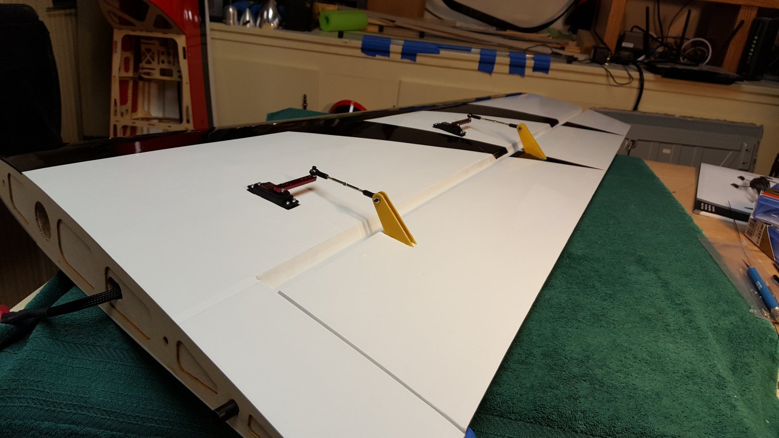

Tonight I started by ironing the covering on the new wings. These are much nicer than my originals. The covering is better, the sheeting is better, and they have a few things the others don't have like gap sealing tape and strings to pull the wiring through. Next I installed the Taildragger aileron harness in the left wing. They sure make nice stuff!
I worked on the wings more today. I used my Hitec servo programer to setup the center and end points. I may need some help from @stangflyer and @Xpress when I get a little farther and need to match them.
Hangar 9 did a good job with the horns. I think the geometry will work out pretty good. The stock 4-40 bolts are not very good they're too small. They wiggle around in a 4-40 tapped hole. The ball links are decent, but a true 4-40 bolt won't fit through some of the balls, so I'll need to work on that. I'm going replace all of the stock bolts.

Your servo set up on your ailerons looks awesome. Hangar 9 really does do a good job with at least this part of the assembly. The steps I make in tuning in Hitec servos: Just like you, set your E.P.A's. on each servo with your programmer first and foremost. With your radio tuned to give 150% travel. If using the same channel for both servos, then you simply tune "down" your "E.P.A's" in your radio I rarely if ever touch my "travel volumn". From this point you can "fine" tune each servo at the turnbuckle to remove any minor servo noise. If using separate channels for each aileron servo, (My ultimate favorite setup) you can adjust each servo individually and with a ton more precision. Same process as before except when you get to the programming in your radio, you can increase or decrease incrementally each setting that you want to change. Trim step is also a very nice feature. My A9X has adjustable "subtrim" step trim programming. Which means I can change the value of the "trim step" for each individual servo. Once the total throw of each aileron servo is set...(Works great for dual elevator servos and push/pull rudder servos as well) you simply go to your trim step and increase or decrease the value so that when you set your end point adjustments, the fine tuning of the trim step takes over and almost never do you have to keep turning turn buckles.
Hope this helps a little. Hang in there. I know you well enough from what I have seen that you are not going to be doing anything half assed. It will be perfect as possible, as you always do.

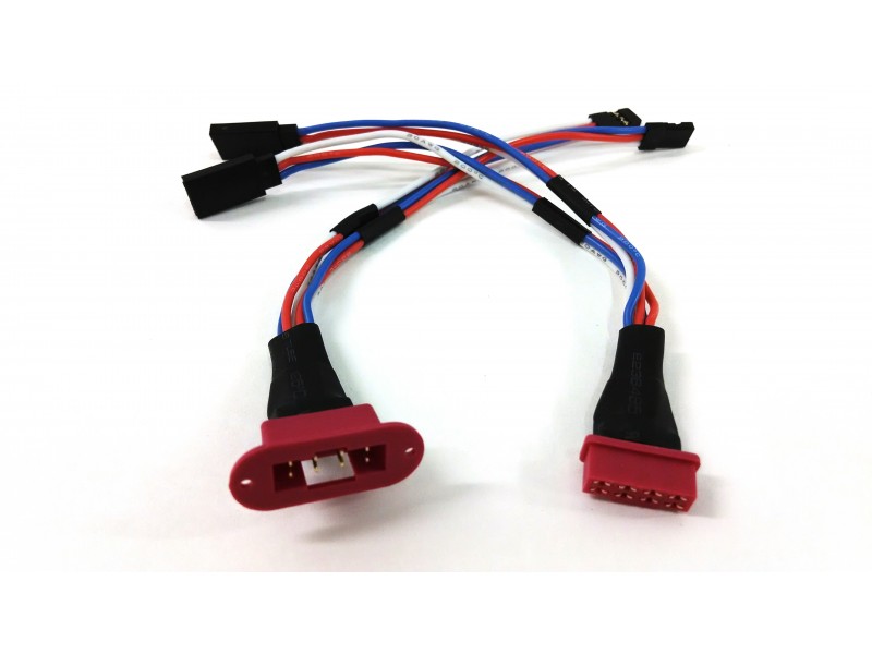

The best thing is you are making progress. The wing set up looks good. Nice to hear about Taildragger never used their stuff but from your comments it looks like I have to look into them. Can let us know what you liked and a picture if you can. Thanks.
They're dual servo wiring harness is what I used. Well made, and they use some really nice wire.
Here is a picture of one I grabbed off the Internet. Mine have different length wires.
