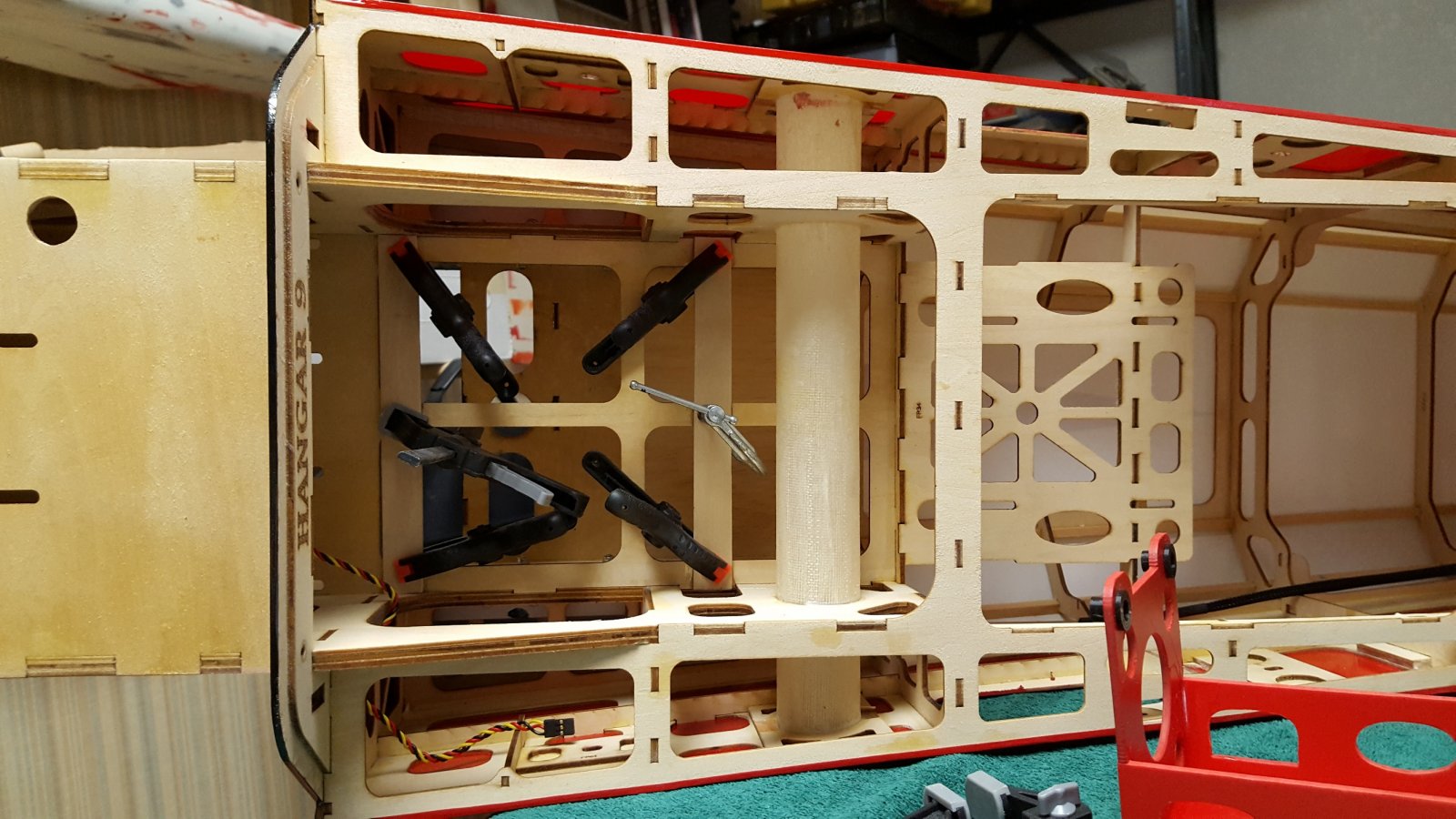

Tonight I set the Extra aside to check over my scratch build after it's maiden Sunday, but here are a few pictures of some of the work I did to it over the weekend.

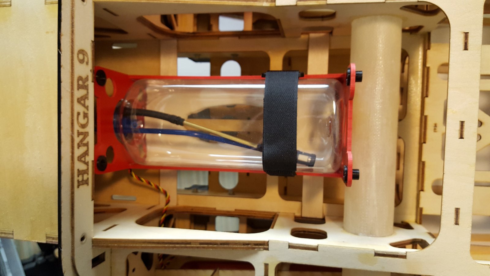

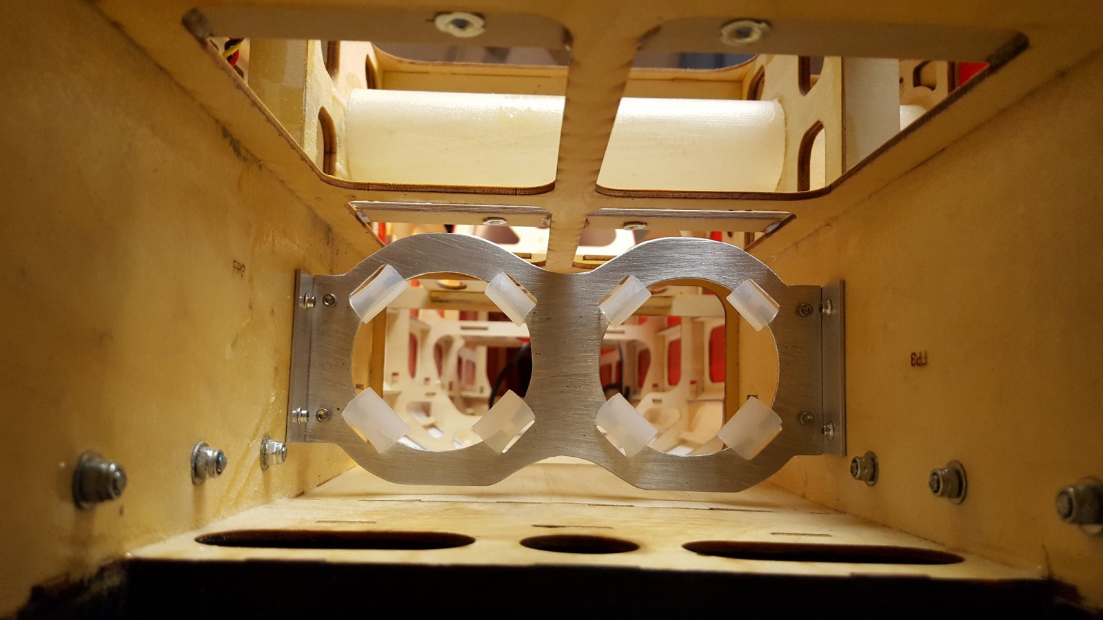

Hangar 9 mounted the tank behind the wingtube, but with my tank the outlets point directly into the tube, so I decided to move it to the front, like every other airplane. I needed to make a mount, but I saw one for sale online, and I thought I'd give it a try. I'm not sure it's going to stay, but for now I'll use it.

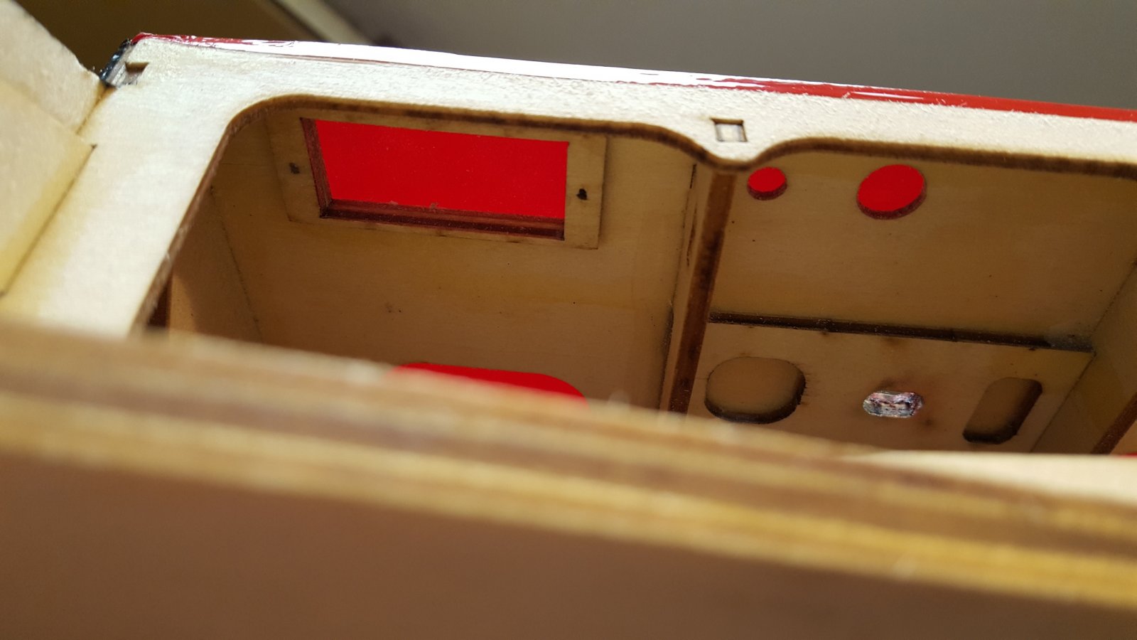

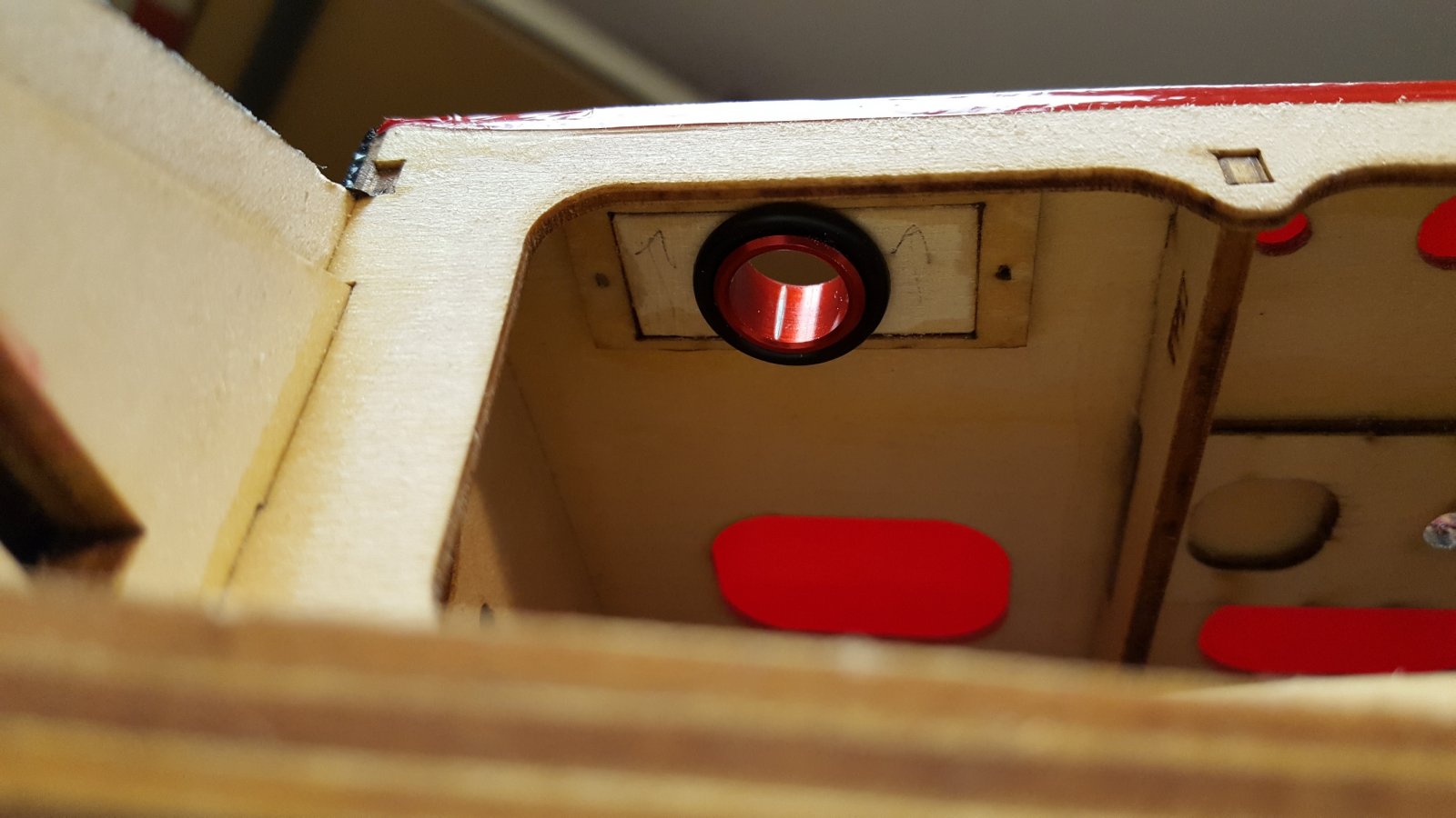

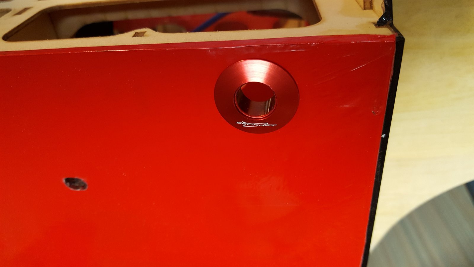

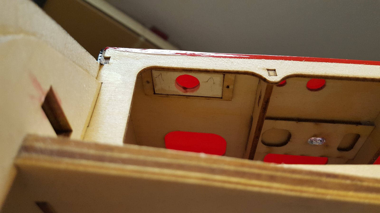

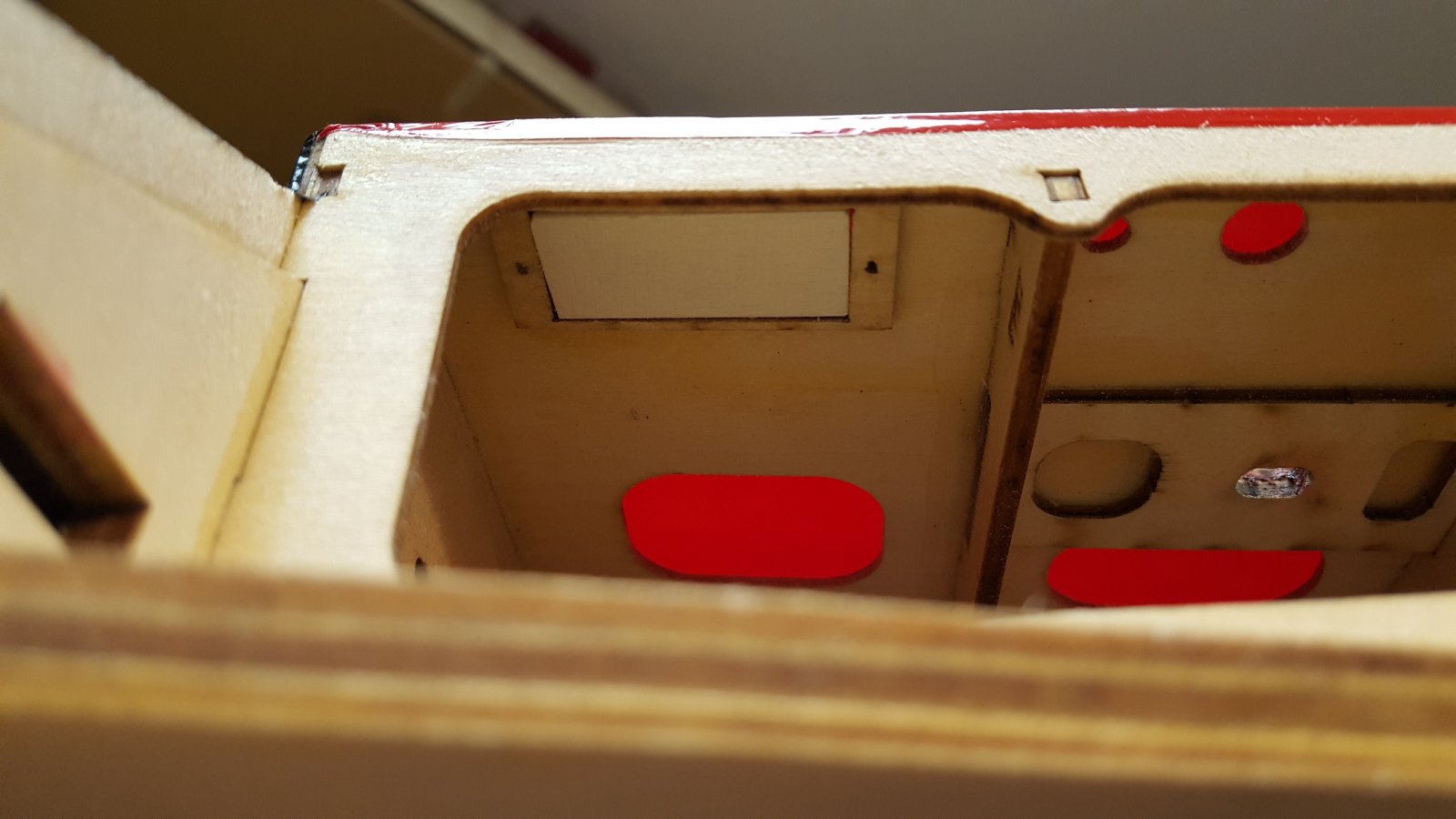

Since nothing seems to be easy on this project, why should installing a fuel dot. They have a spot above the wing in the front, but there isn't enough room for the fuel dot I'm using. The only way to do it was to fill in one of the switch holes, and put it there.

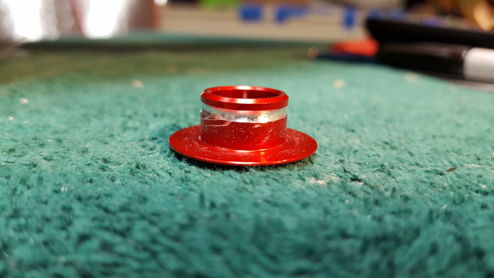

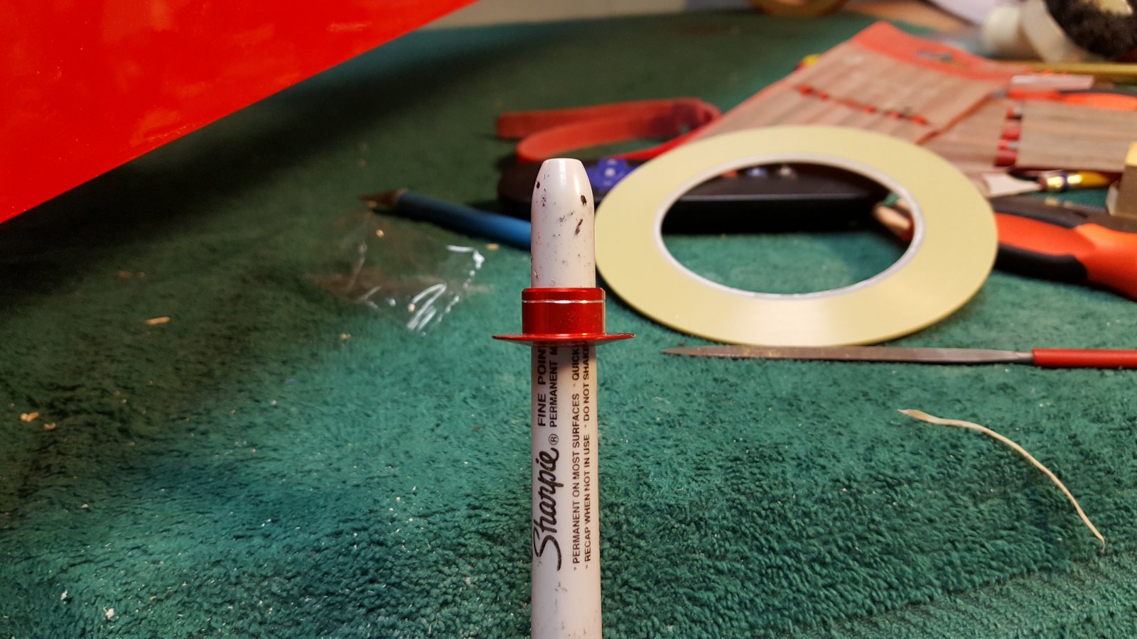

The Secraft fuel dots just use an O ring to hold them in, but this one barely had room for the O ring so I had to cut a grove in it to hold the O ring. I did it by hand with small files.
Interesting tank holder. Not sure I have ever seen one of those. I really..."REALLY" wanted one of these when they were released not all that long ago. Now? Ha...! Not sure you could give me one. Dang, sure a lot of goofy things they did with that in my opinion. Question: What about the second larger hole next to the smaller hole in the side of the fuse behind the second former? For what it is worth, I have done what you did also. Made a plate to glue in and then drilled the hole for my fuel dot.

Unfortunately the dot I wanted to use was too big in diameter on the outside to fit between the wing and hatch in that spot.

I see the tank holder but do not understand how it works or I am looking at it wrong. I guess I will find out when it is installed then it will make sense.

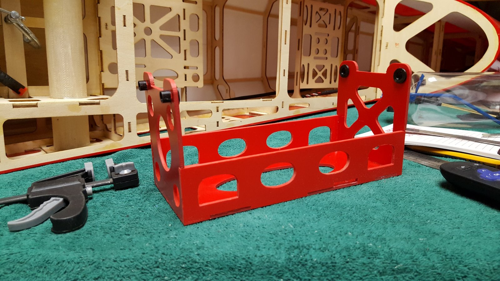

Before I can install the fuel system I need to finish off my canister mount. I test mounted it last night and it worked out great. I still need to do a few finishing touches on the mount itself before it's installed for good.
I also included a picture of the tank mount when I was test fitting it. The black bushings you see at the top of the front and rear of the mount are for making the vent tube loop.
