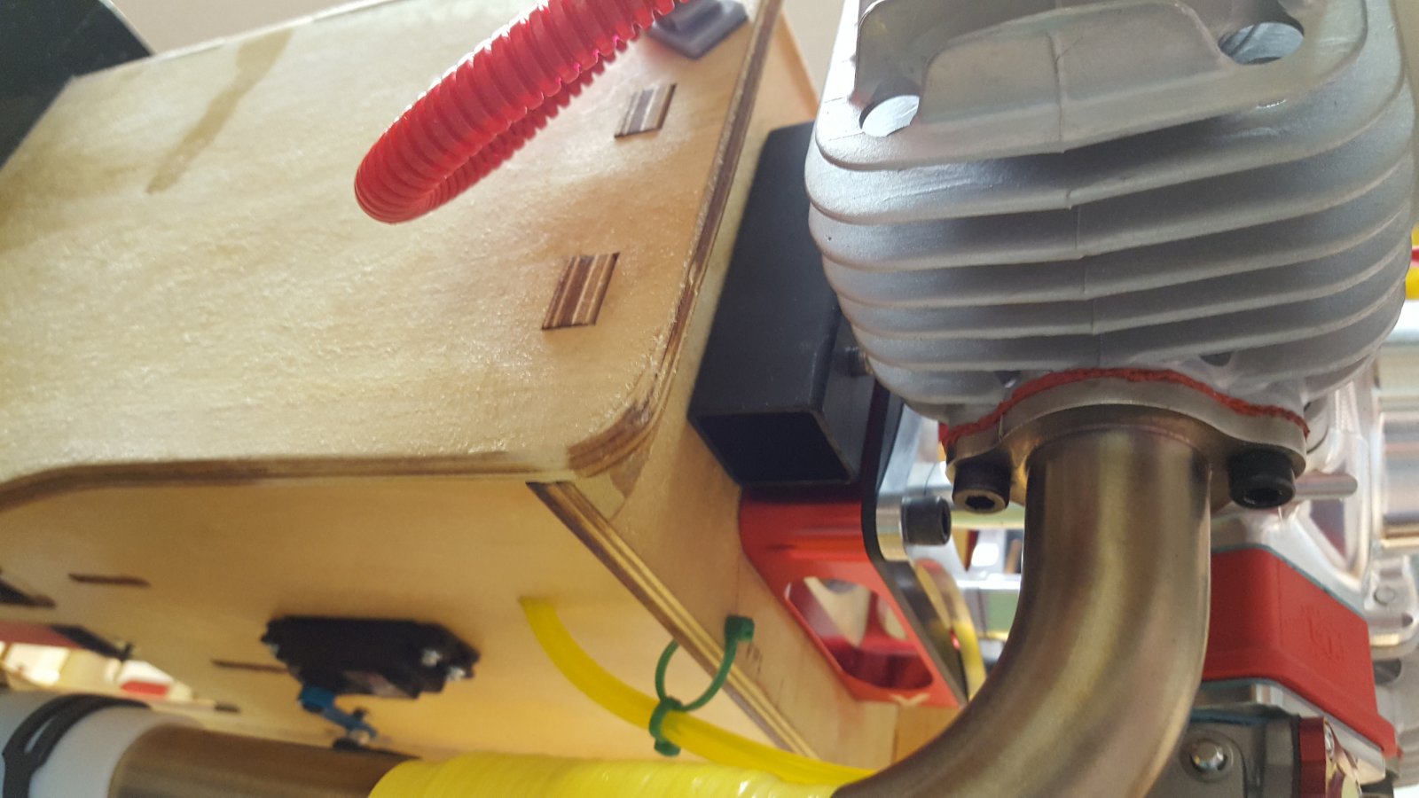

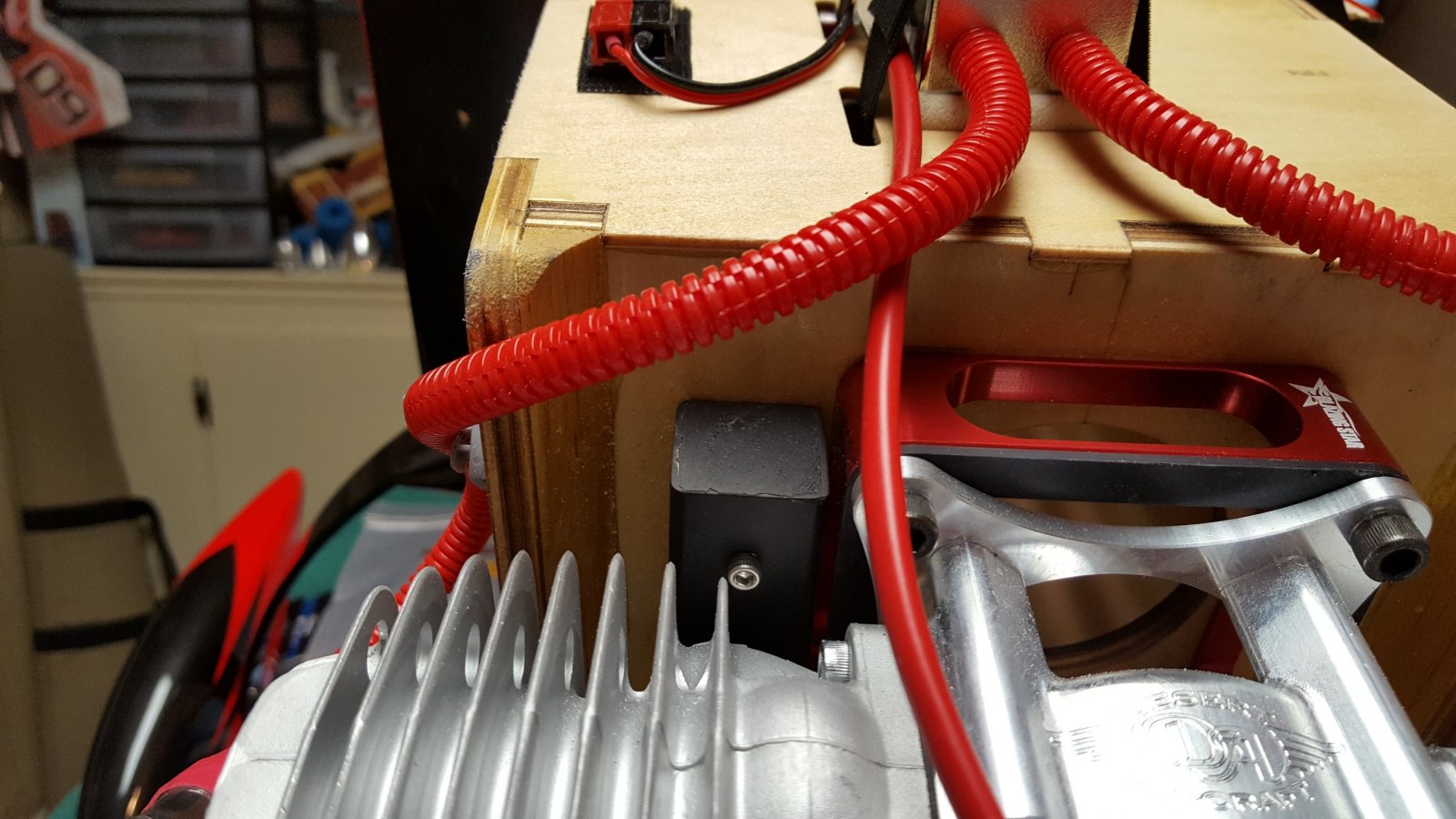

Last night I bolted my 12 pound weight to the firewall. Okay it's 12 ounces, but in my mind it may as well be pounds. I had to take the motor and cans off to do it, but luckily the cans slide right out of the mount while still bolted too the motor. I noticed the Chinese plywood firewall was already compressing from bolting the motor on and the bolts that were tight and Loctited were somewhat loose already. So, they're getting Ny-Lock nuts on the back of the blind nuts.

If I may suggest a way to help prevent the compressing the wood.
Let's assume that the bolt you are using is 1/4 inch. What I do then is I drill and tap the holes in the firewall with 3/8nc. Take a aluminum 3/8 bolt and then cut a piece of the threaded end 0.020 less than the firewall thickness. Drill the 3/8 aluminum bolt out with a 1/4 drill. (The threaded part.) now take this small threaded sleeve and coat it in epoxy and thread it in to the firewall. Center it. Now when you mount your motor you can tighten the bolts up and only compress the wood 0.020 inches and then you will hard against the aluminum tube and with that amount of compression the motor is sold. Done it a few times and it has worked for me hope this helps.

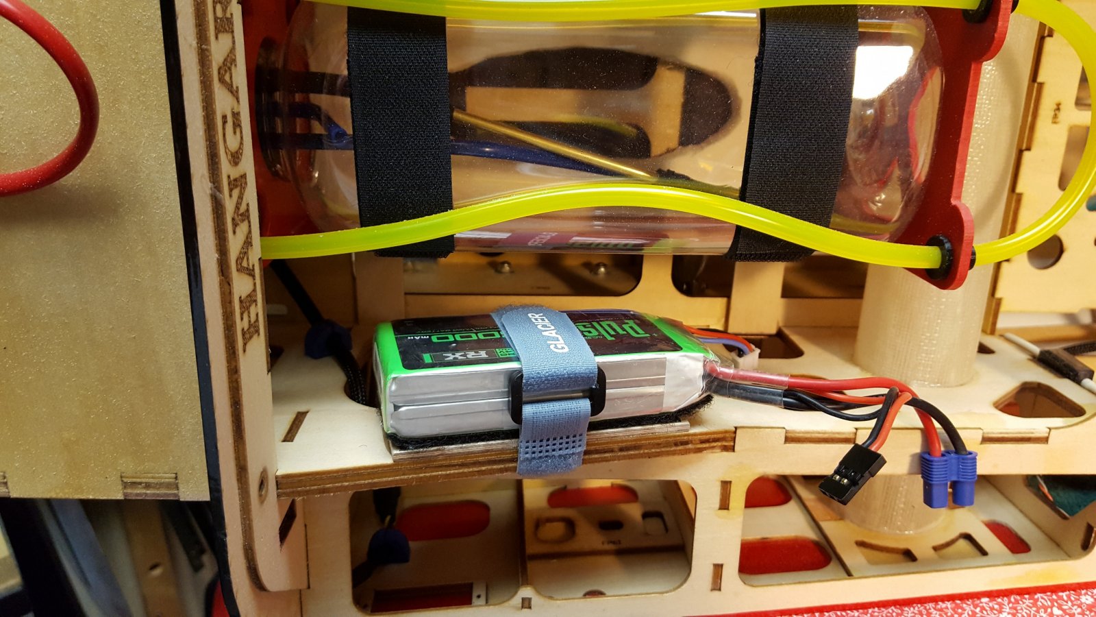

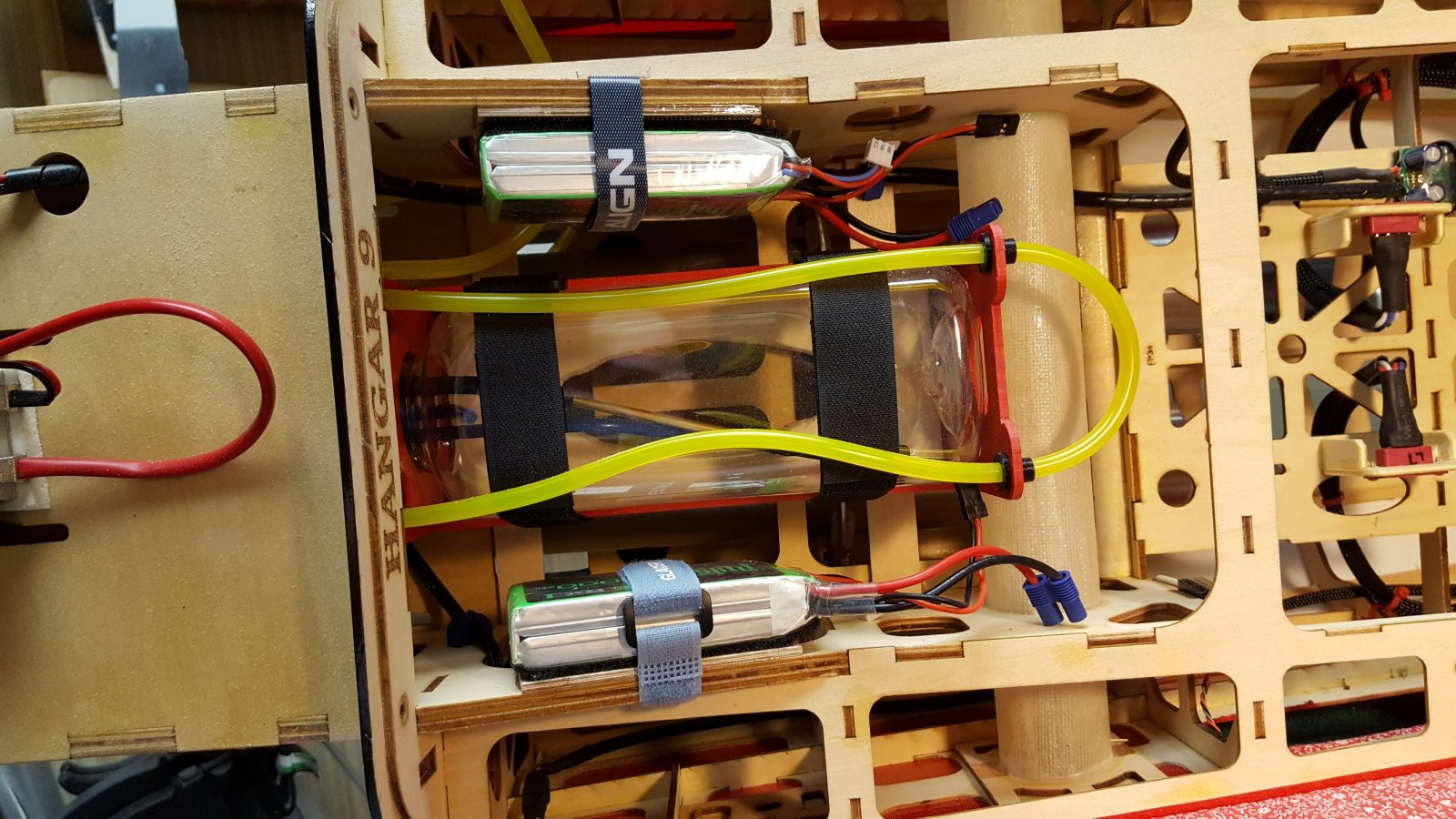

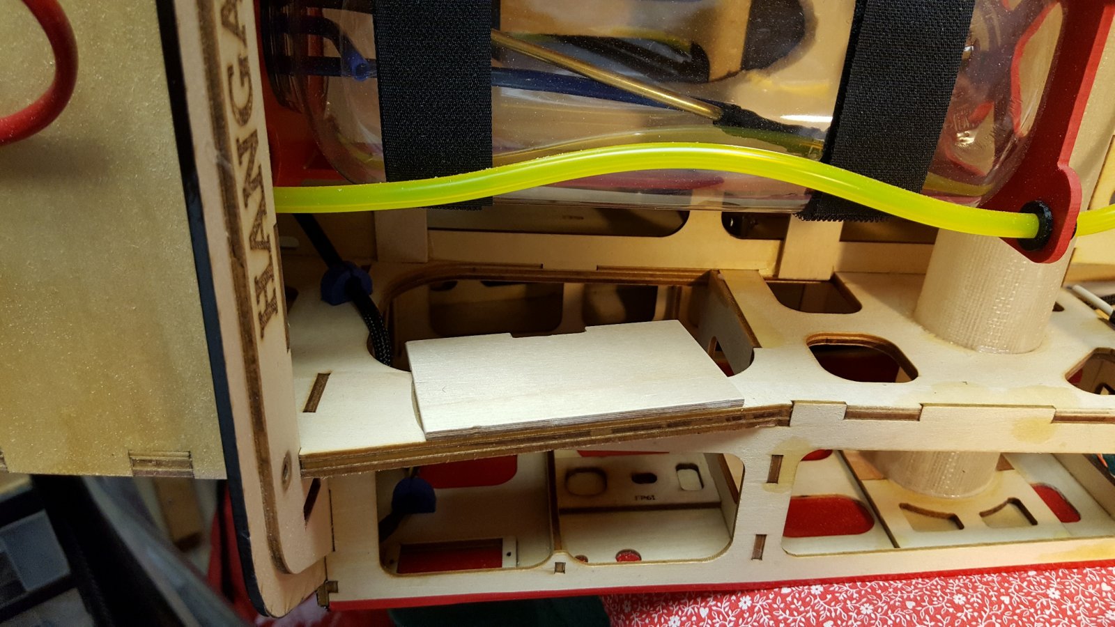

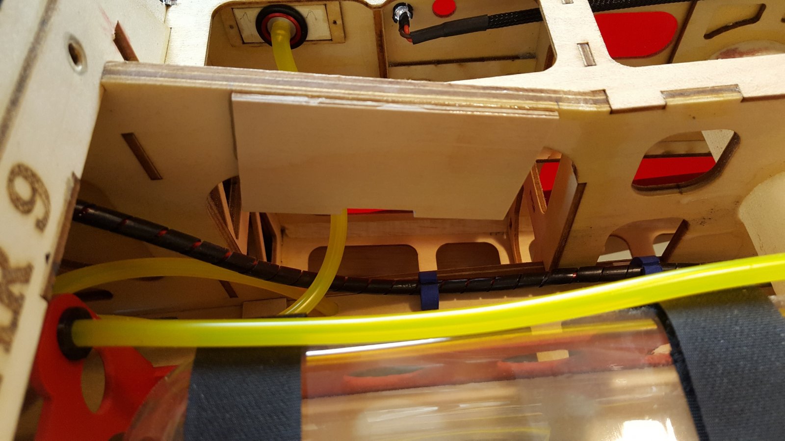

Tonight I added some Nylock nuts behind the blind nuts on the engine mount bolts. I also made the battery mounts and epoxied them in. I ordered some battery straps that were supposed to be 200mm long, but are 280mm long. :( I have one strap that is the right length, but I'll need to rig something up for the other side to fly it Sunday with what I have until I can get some others.
