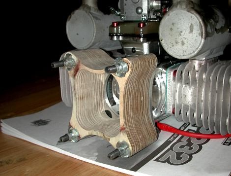

Love this thread, brings back great old memories. I have some torque roll videos with it from 2001, pretty embarrassing to watch. haha The H9 Cap was my first real plane and my first DA engine. I loved it, and it occurs to me lately that H9 has been making great planes all along. Anyway, I was really new to model planes and also excited to be flying all the time, not assembling! I didn't want to wait to have some standoffs made so I made a standoff out of plywood like you did. I bought a drum sander and sanded it down pretty thin. It held up great with a lot less vibration than standoffs. :)
first cut, was in a hurry to go fly!

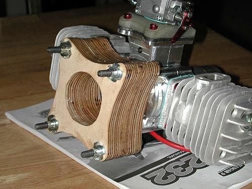

Then, I took it off and sanded it down pretty good:

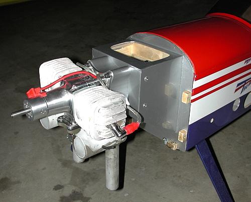

That was also the first time I thought to cover the motorbox:
