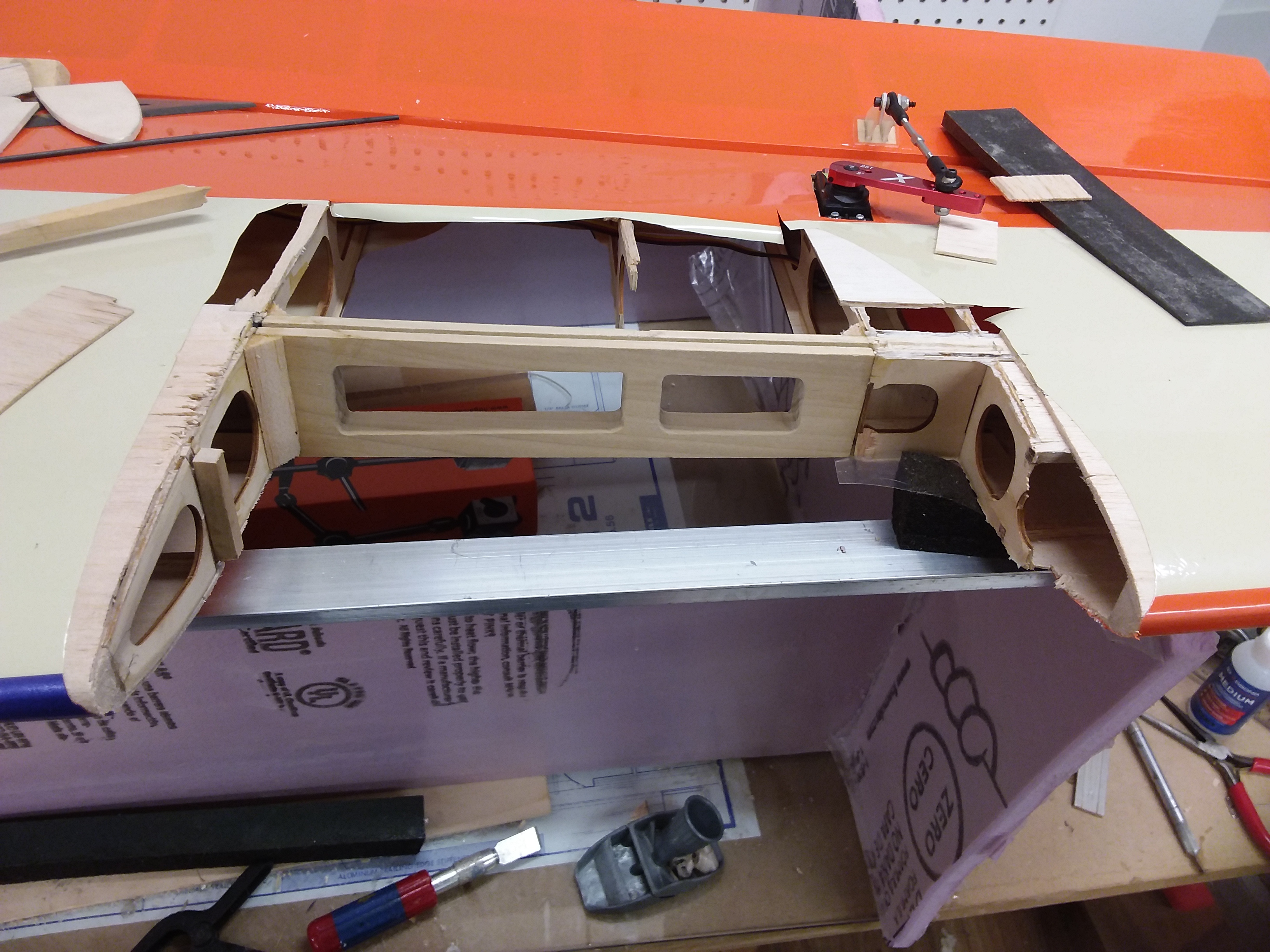

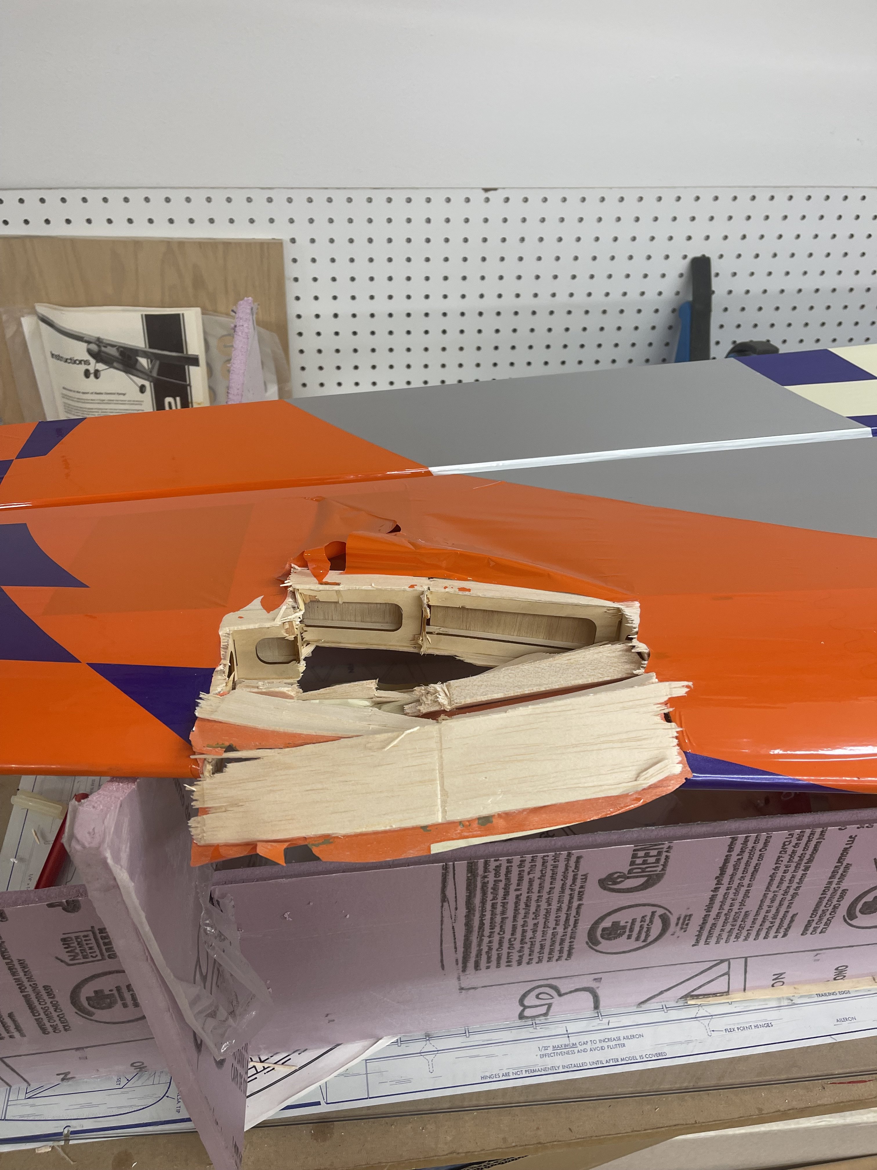

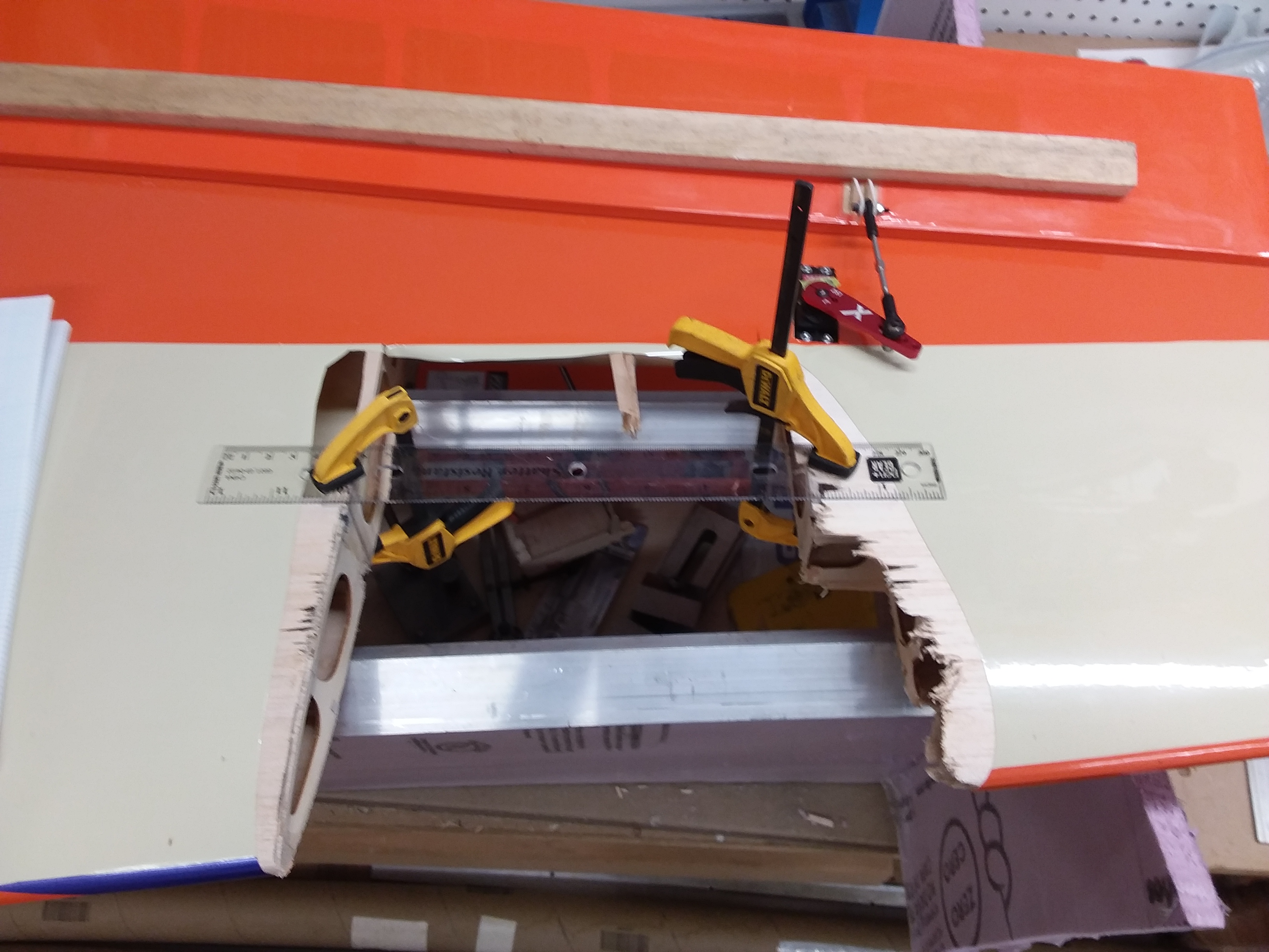

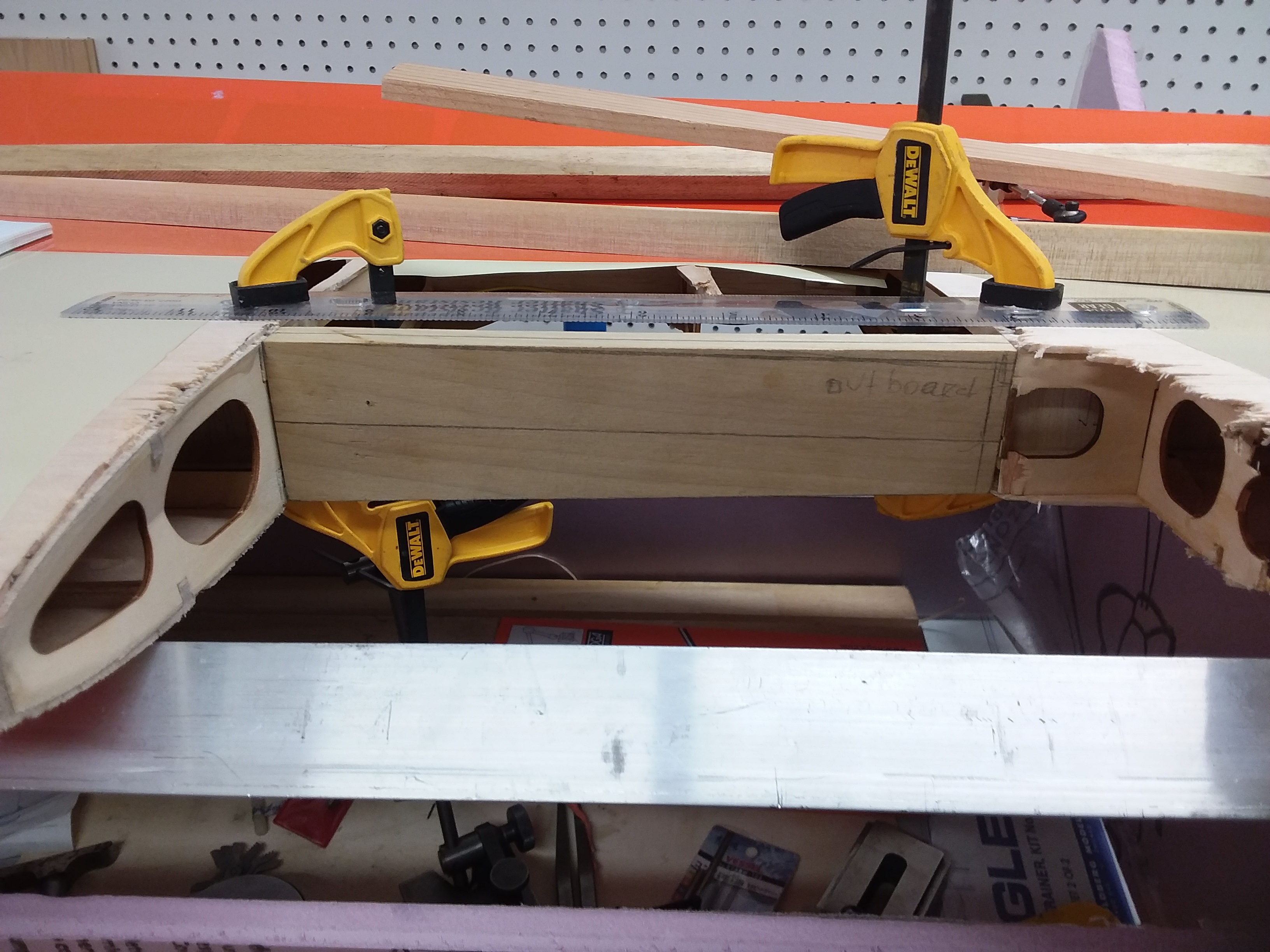

Might as well spill the details. Landing drifted left and I went right. I thought. Except I didn't.

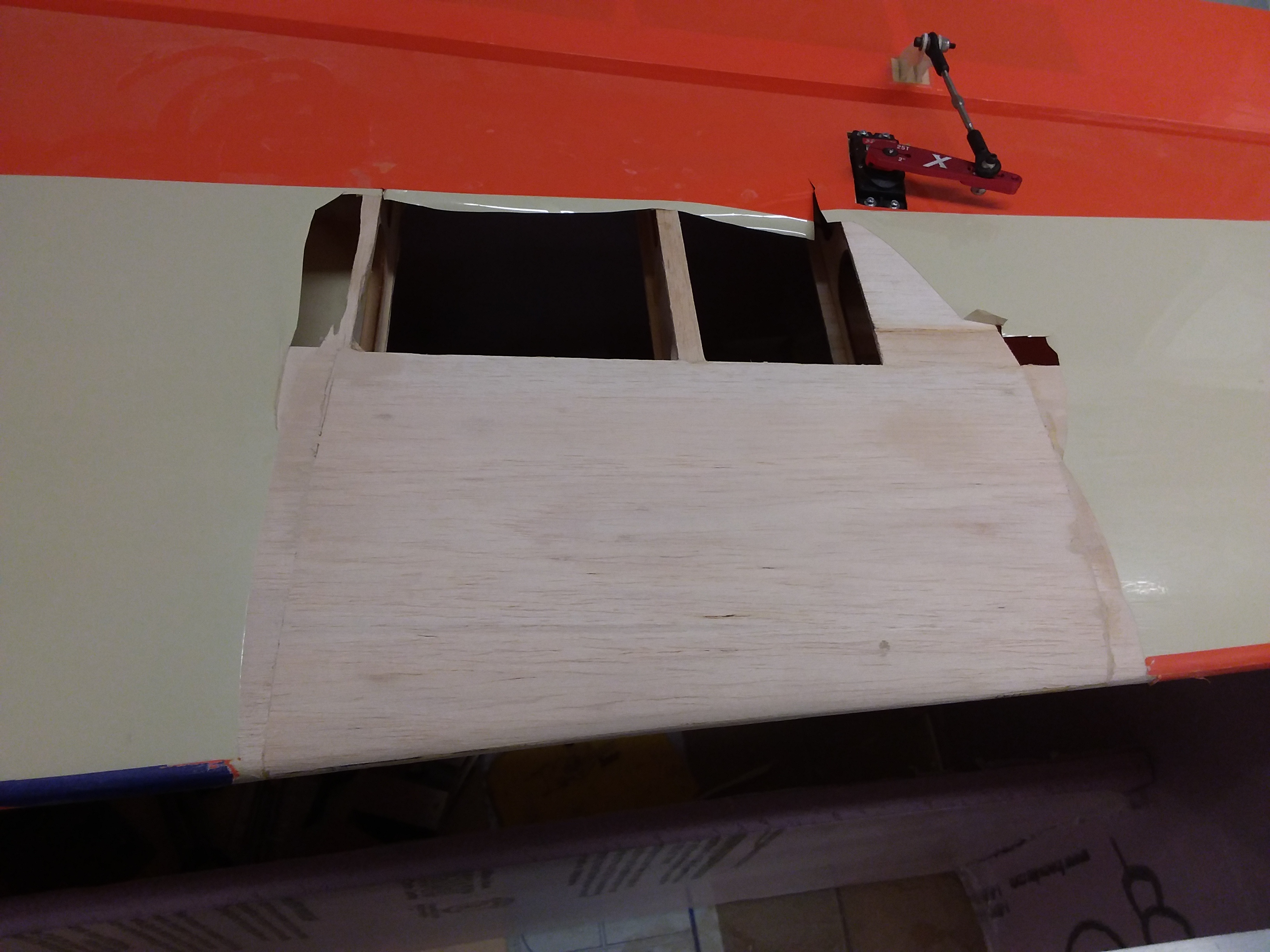

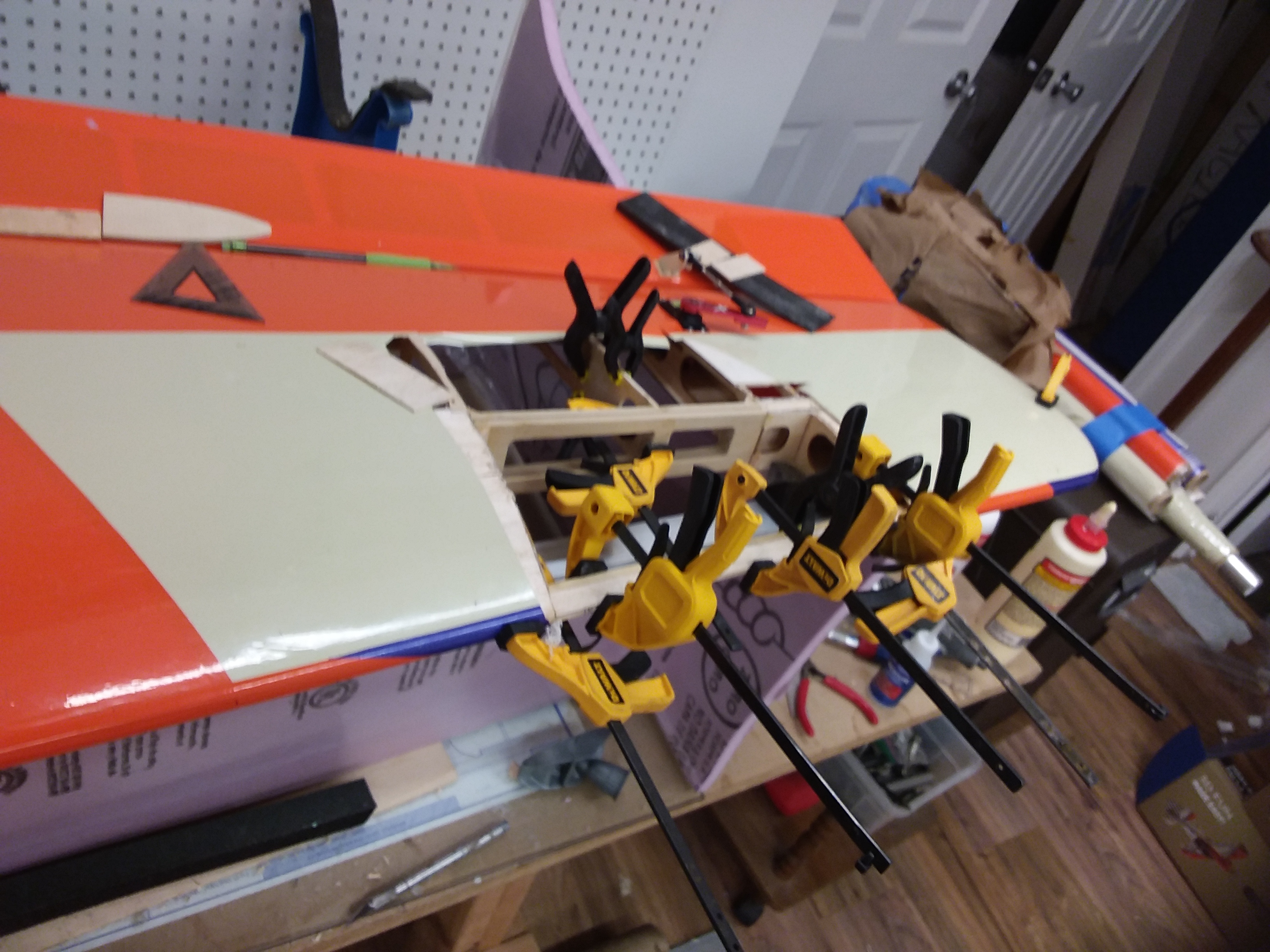

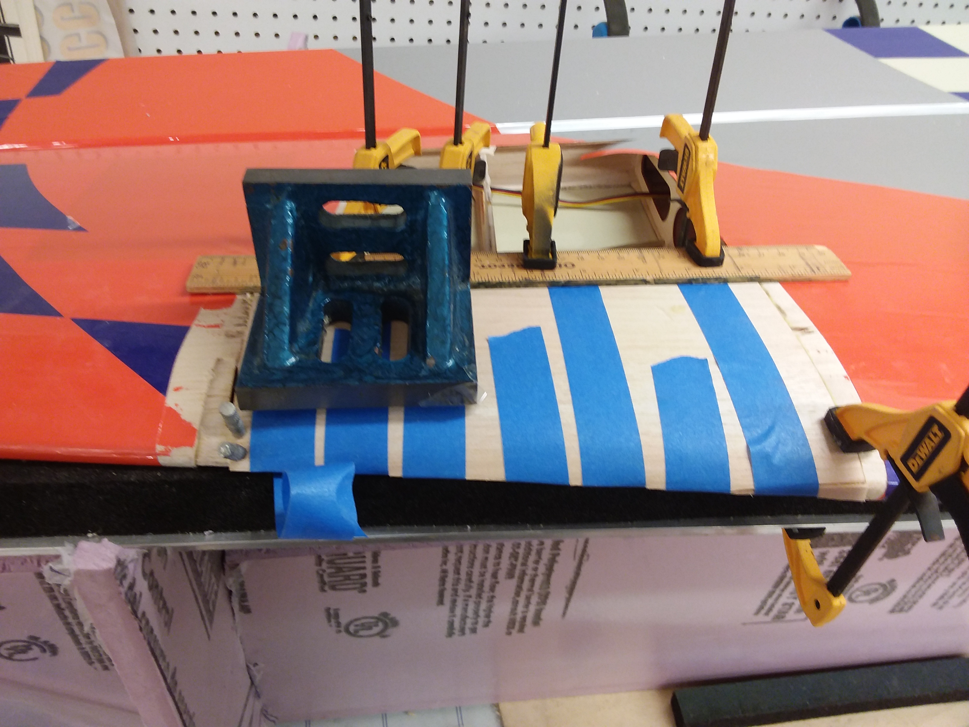

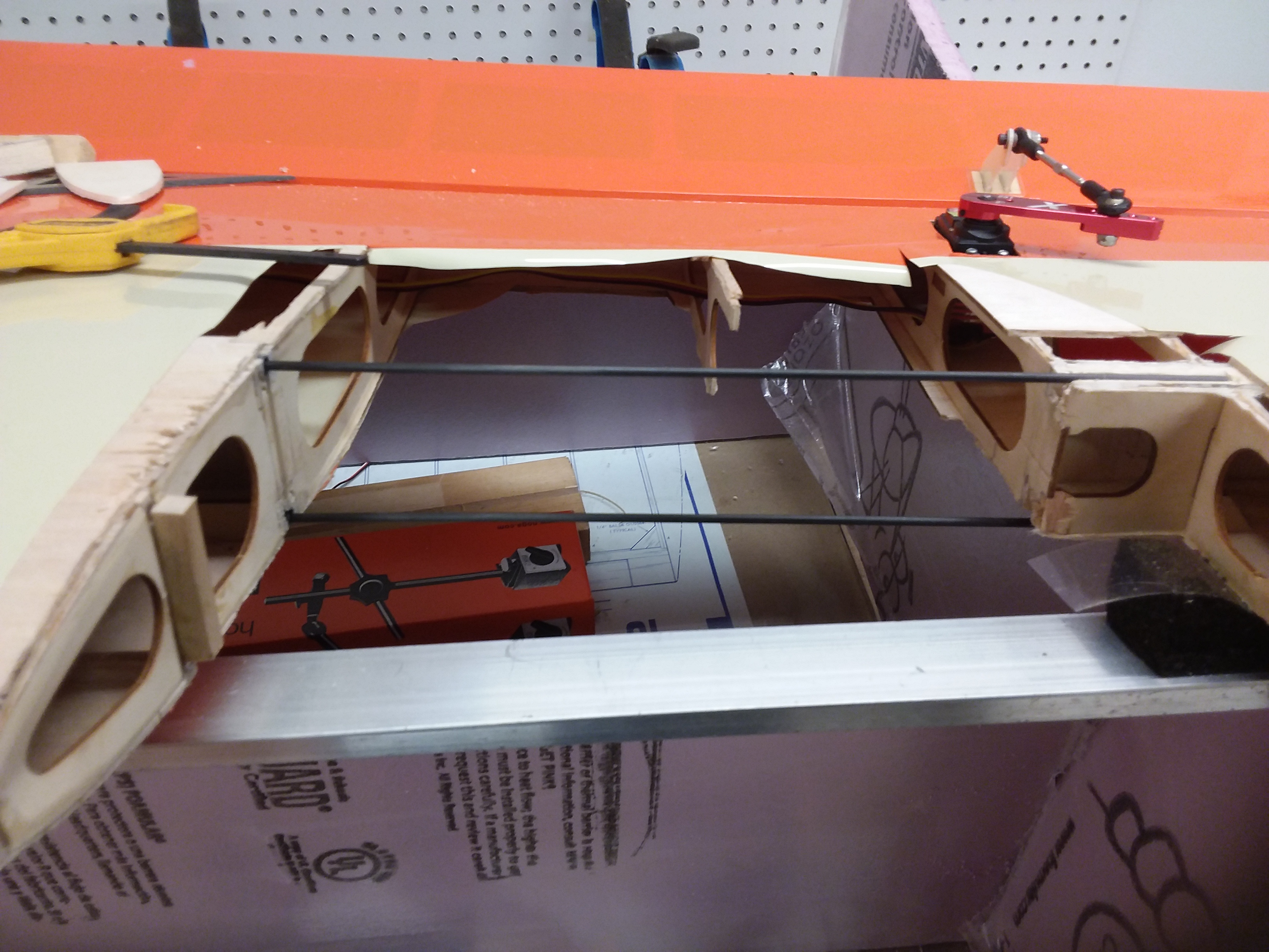

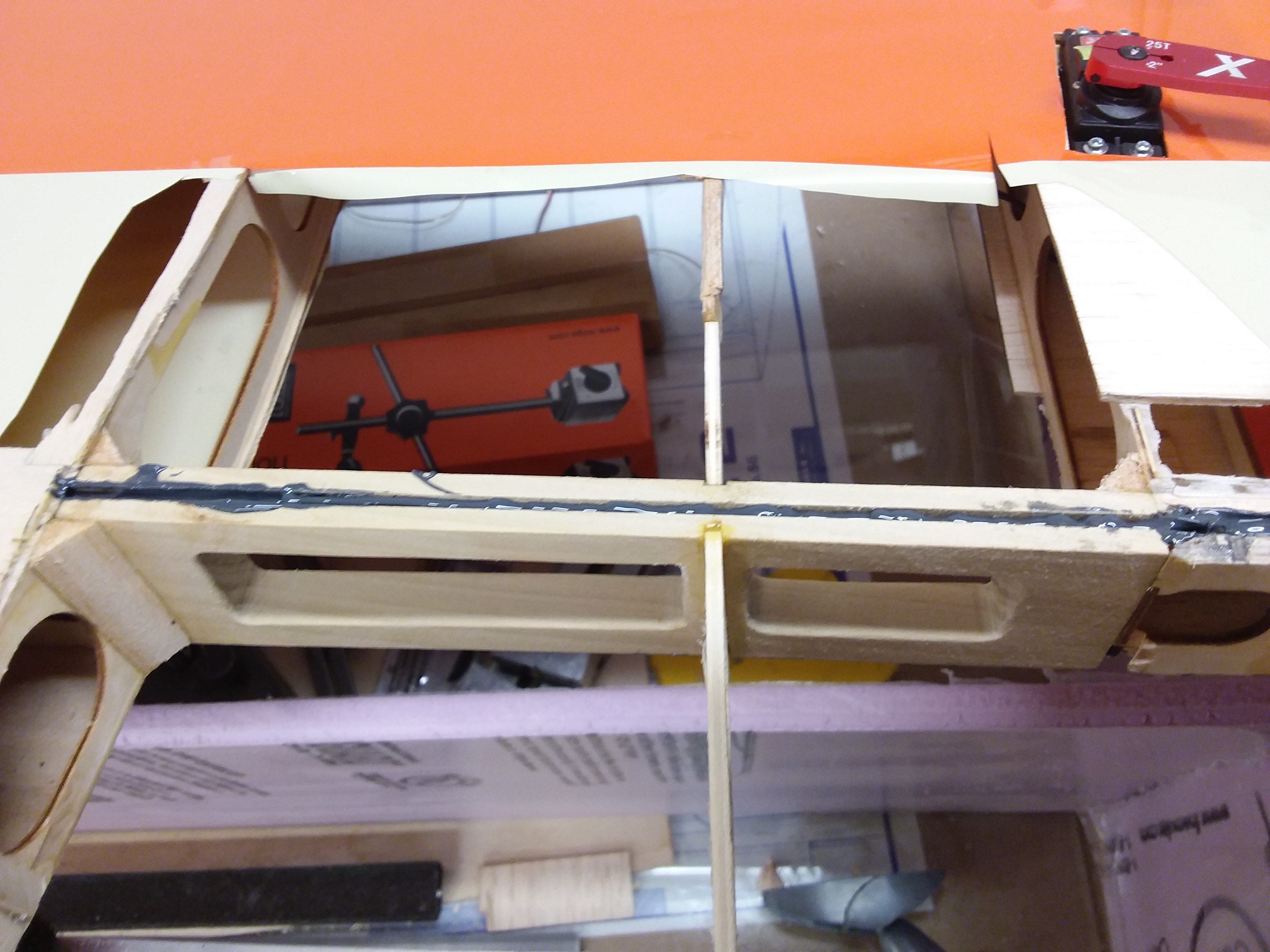

More. Unfortunately I broke the spar, fortunately there were carbon fiber tubes partially spanning the damage area. I inserted cf rods and extended the load across the damaged area.

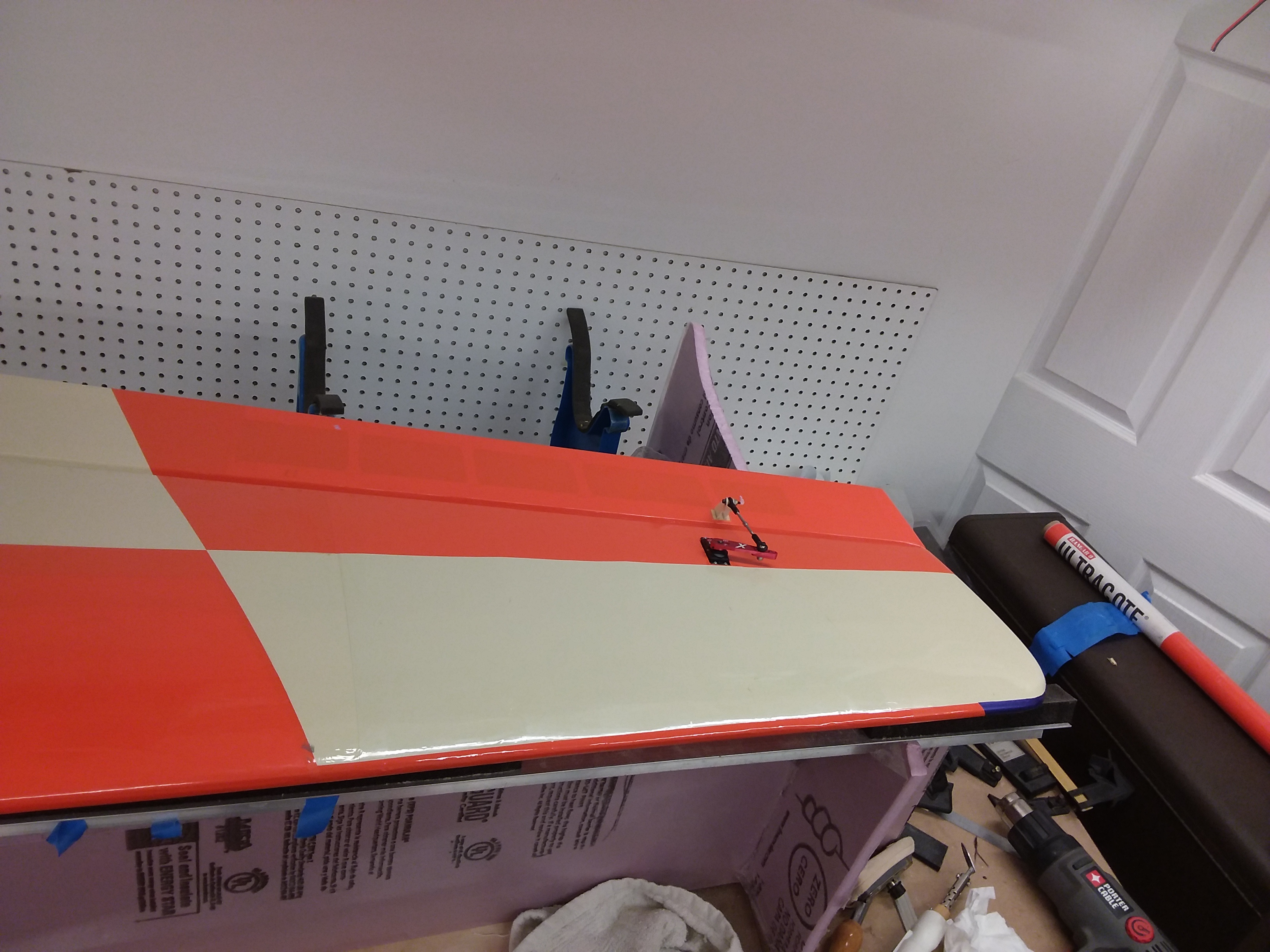

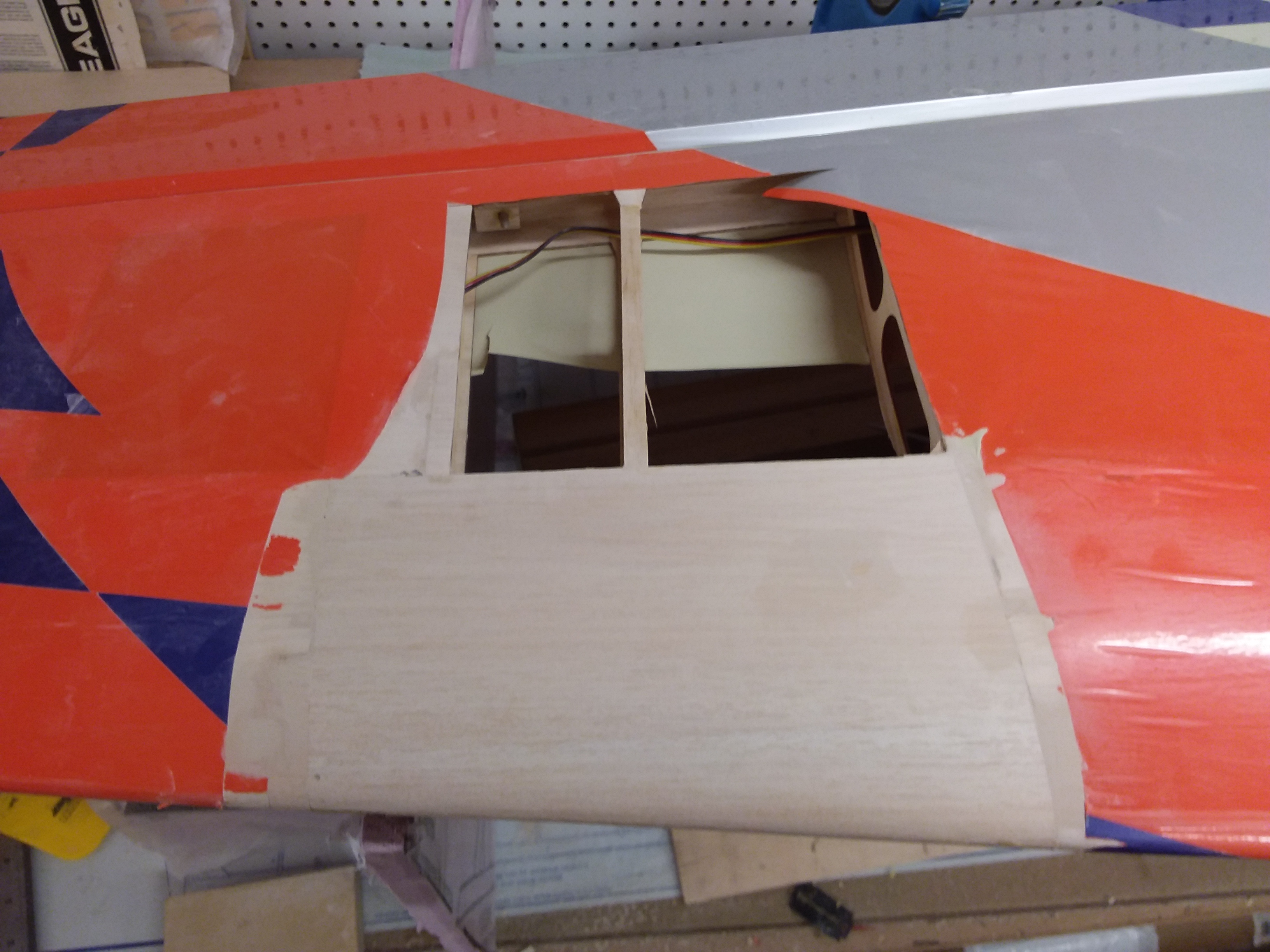

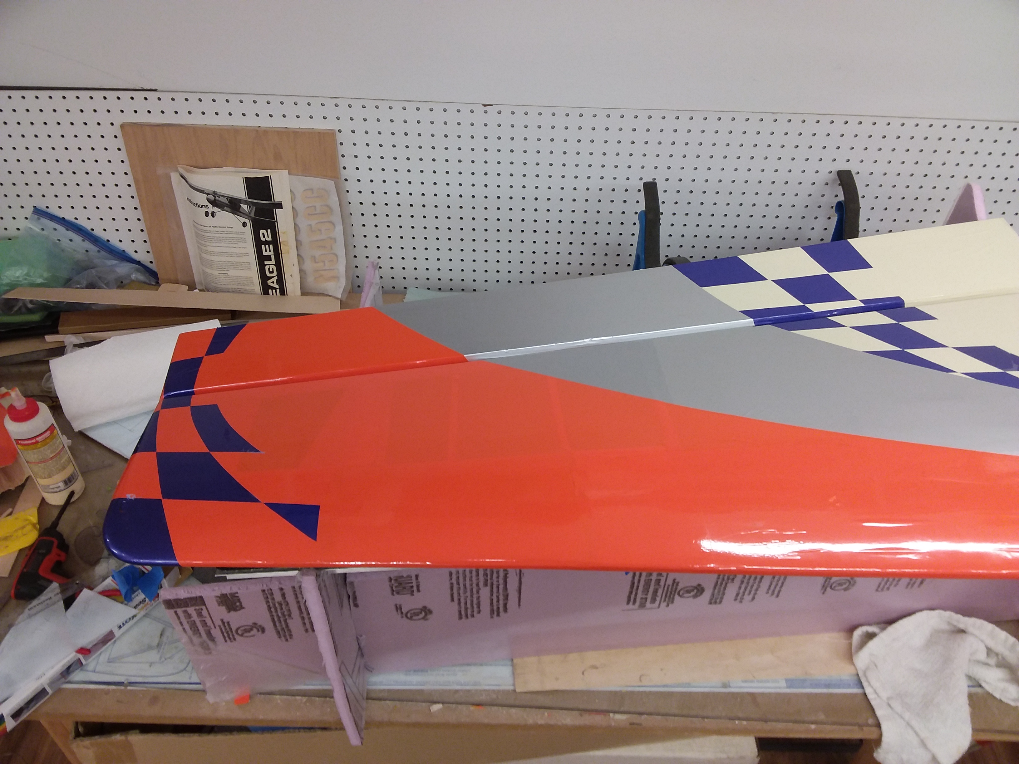

Just a puzzle for a couple of weeks. Almost ready return to the field. Watching Ultracote videos on YouTube tonight.
With Ultracote I usually go around the edges with an iron first. Once the edges are tracked down good I shrink it up with a heat gun and finish it off with the iron.
