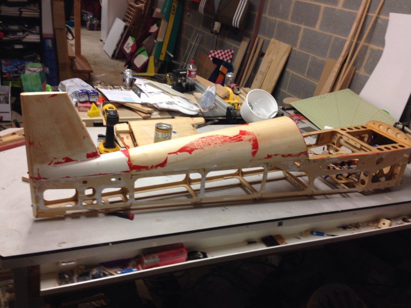

Good project! Since you have it all stripped down, might not be a bad idea to run some cross bracing in ur fuse. It will add tremendous strength with very little weight penalty.

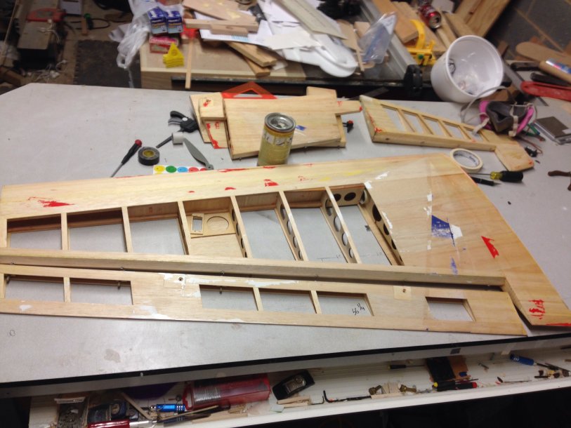

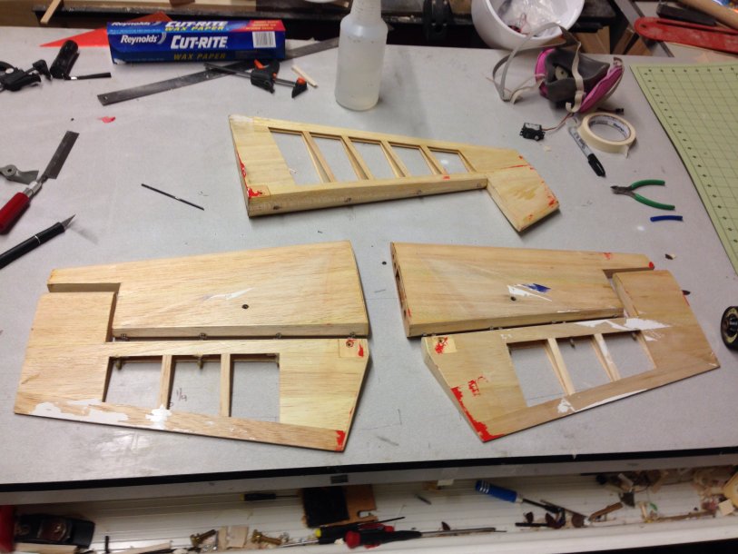

Well I got it all stripped down. Stabs and elevators are in great shape, wings and rons are as well other than a cracked piece of sheeting in one wing, fuse can stand some glue to be wicked in in some areas, but the rudder OMG. Can't believe the counterbalance hadn't fallen off in flight. Basically it's completely broke free on one side and the other side only a small amount of sheeting is still holding it. Amazing the covering could keep it all together. TE was cracked up pretty good as well but was fixed by wicking in some thin CA. Now on to melting out the hinges, drawing up my patterns for the covering and to start laying it down. Next week should see some color.
