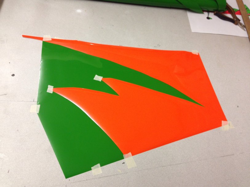

Started cutting some covering. The is the top of the stab. I think orange and green will go well together.
