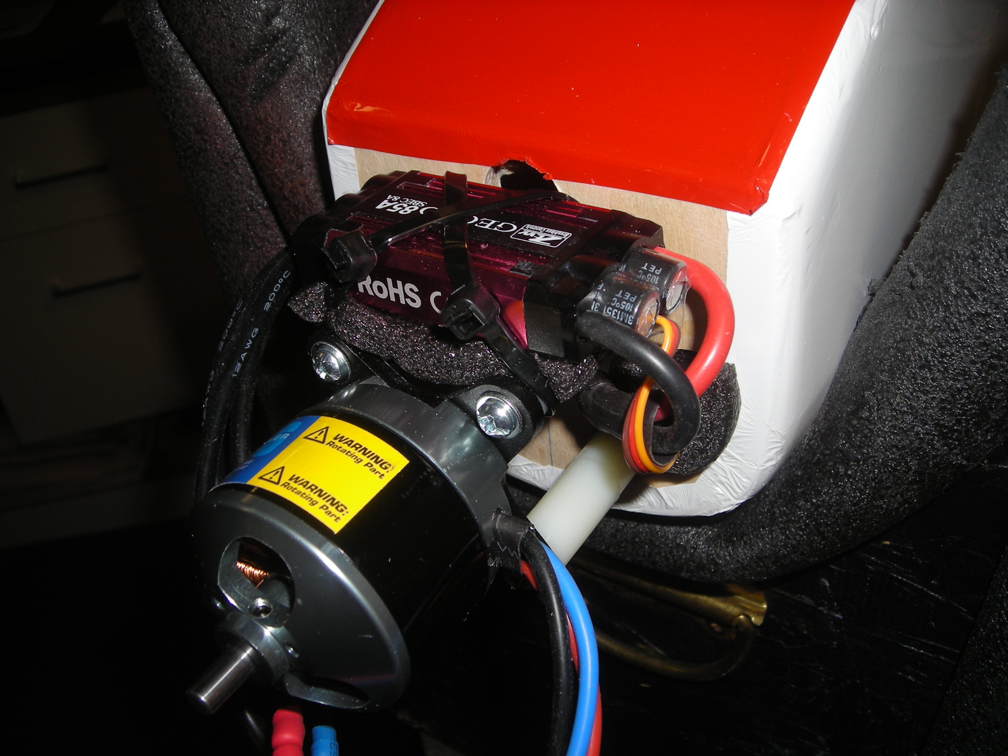

wow,what a bummer. i built a sig smith mini and have a build thread over at wattflyer. i used the ztw gecko 85ampesc with a eflite power 46. the motor cogs with quick motor throttle. i just purchased this ztw through altitude hobby and am glad to have found this thread when i googled "ztw gecko problems" and see they are actively pursuing a correction to the problem. i must say,if it has this on going problem i wish i hadn't bought in nov when it was not performing properly with the motofly motors.
add eflites to the problem. i really am glad when i first heard the cog during the second flight it survived for further bench testing. the gecko esc programing card works great. to bad it was another $16 expense i would have not needed if i spent the extra $40 to use a castle ice like i have in all my other larger birds in the hanger.....i just figured ZTW was worth a try. hope to hear a email reply from altitude monday. stu

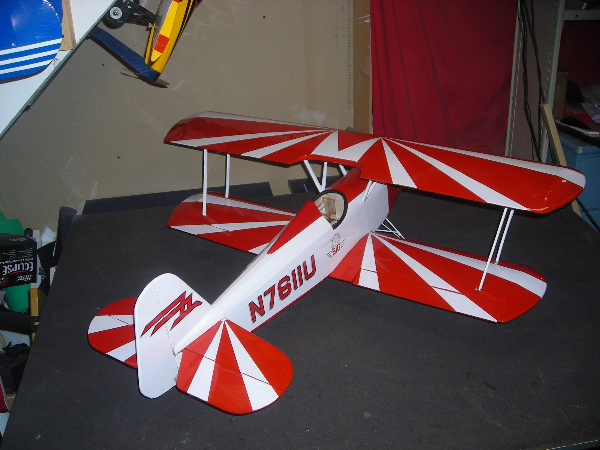

i have no worries garret will set things right. He has a good reputation both here at 3drc and wattflyer. i wouldn't care so much experimenting with programing this esc with new firm wear but the smith mini is an old style kit build and i spent the time to design her for light conversion to electric flight so i might switch out of another planes castle 100amp esc and install the hopefully repaired ztw in an arf.a few pictures of the mini and a couple of my more aerobatic birds i fly that let's folks here know i love 3d flying also.
