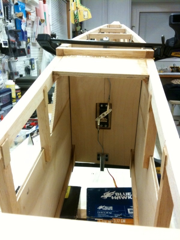

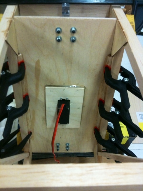

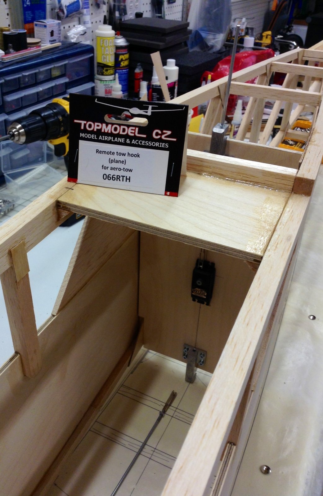

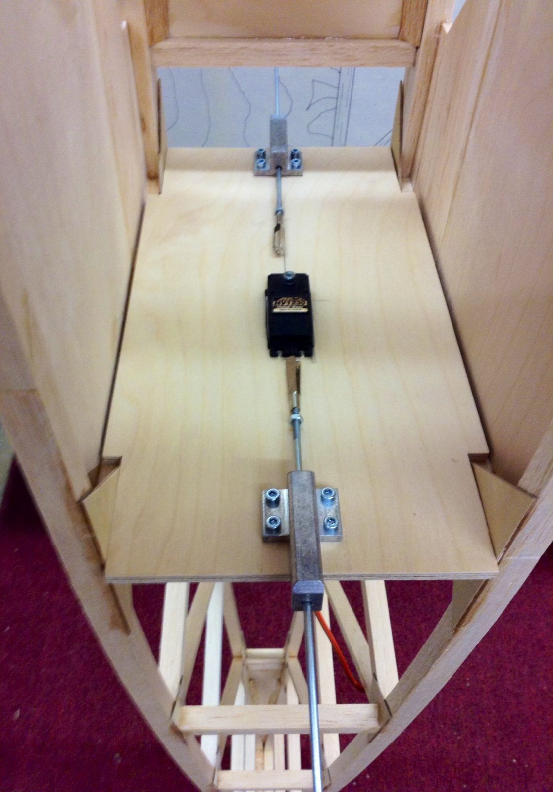

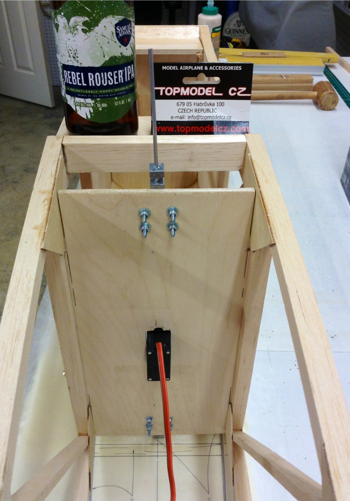

Started working on a double release mechanism tonight. Top release for aero towing and a bottom release for banner towing. I still have a few kinks to work out but I think I'll be able to get it to function properly.

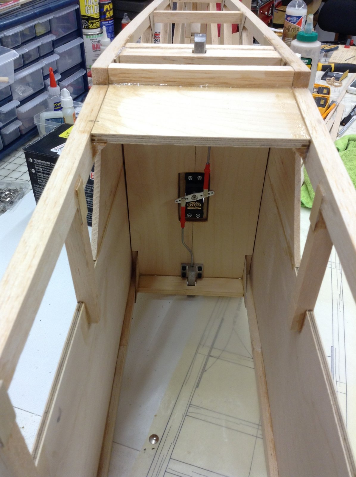

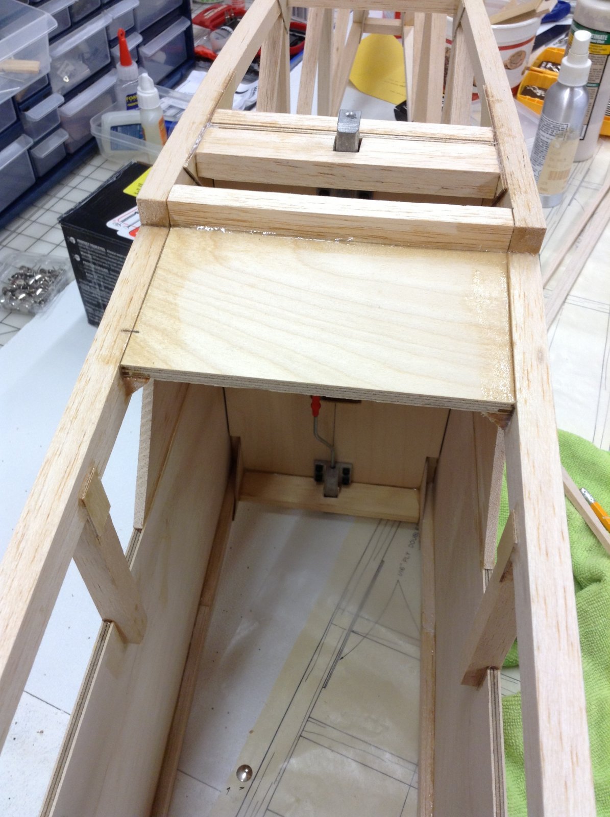

Finished up installing the dual tow release.

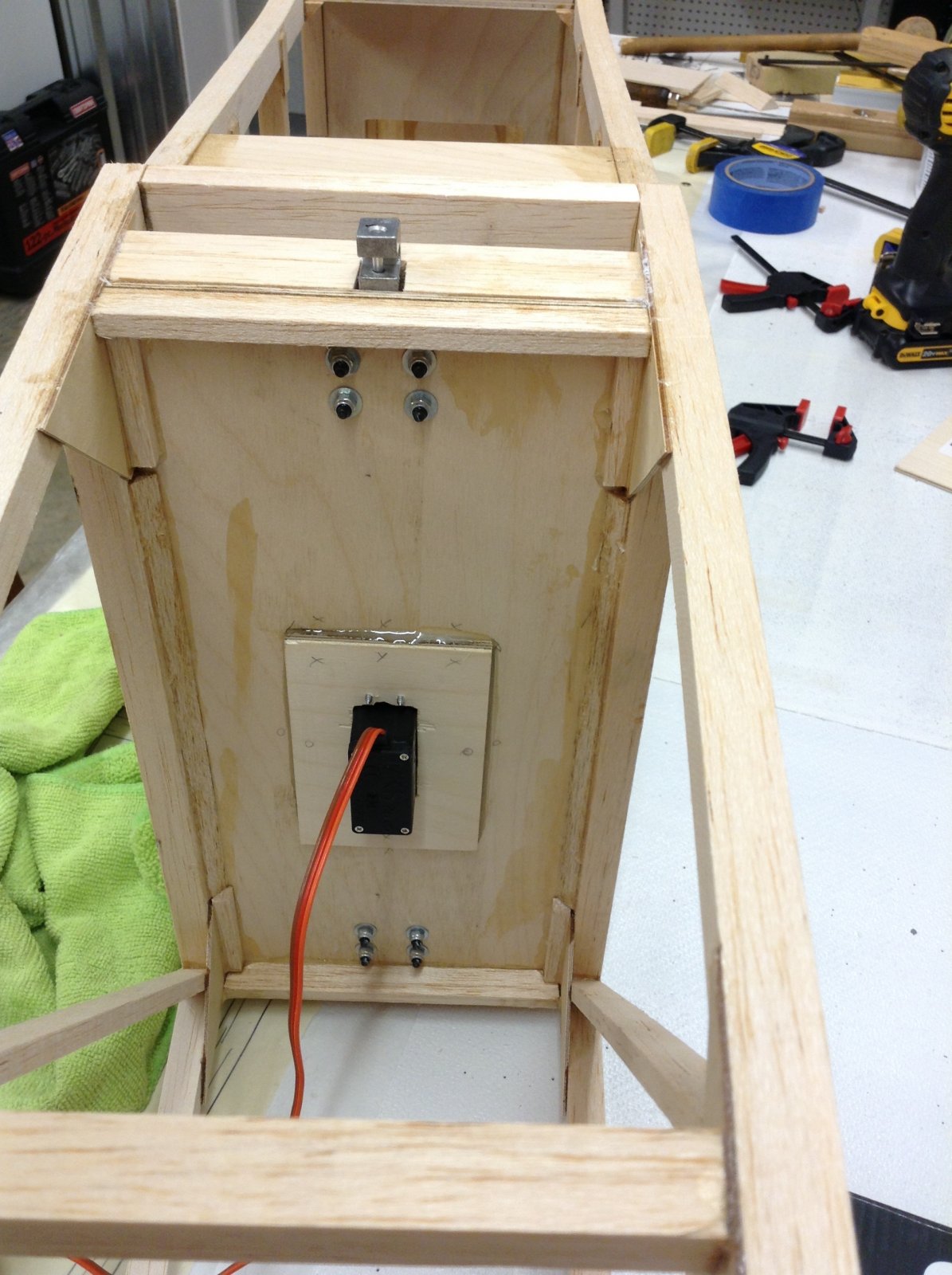

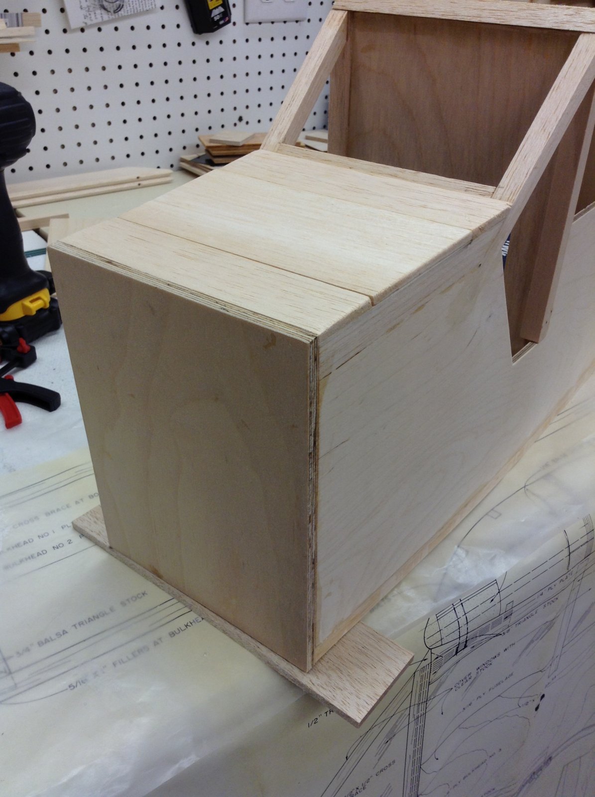

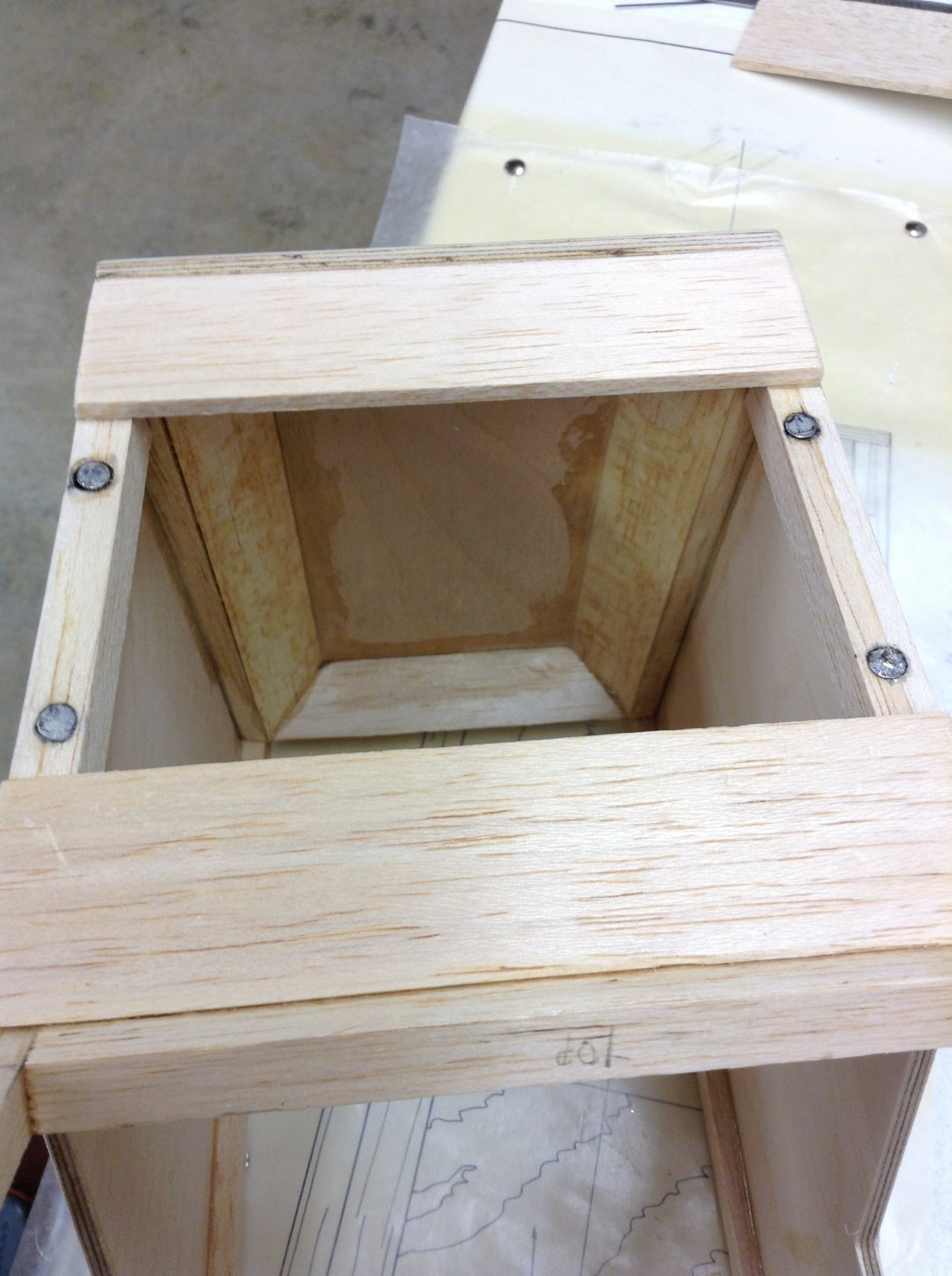

Then I finished beefing up the firewall with tri-stock.

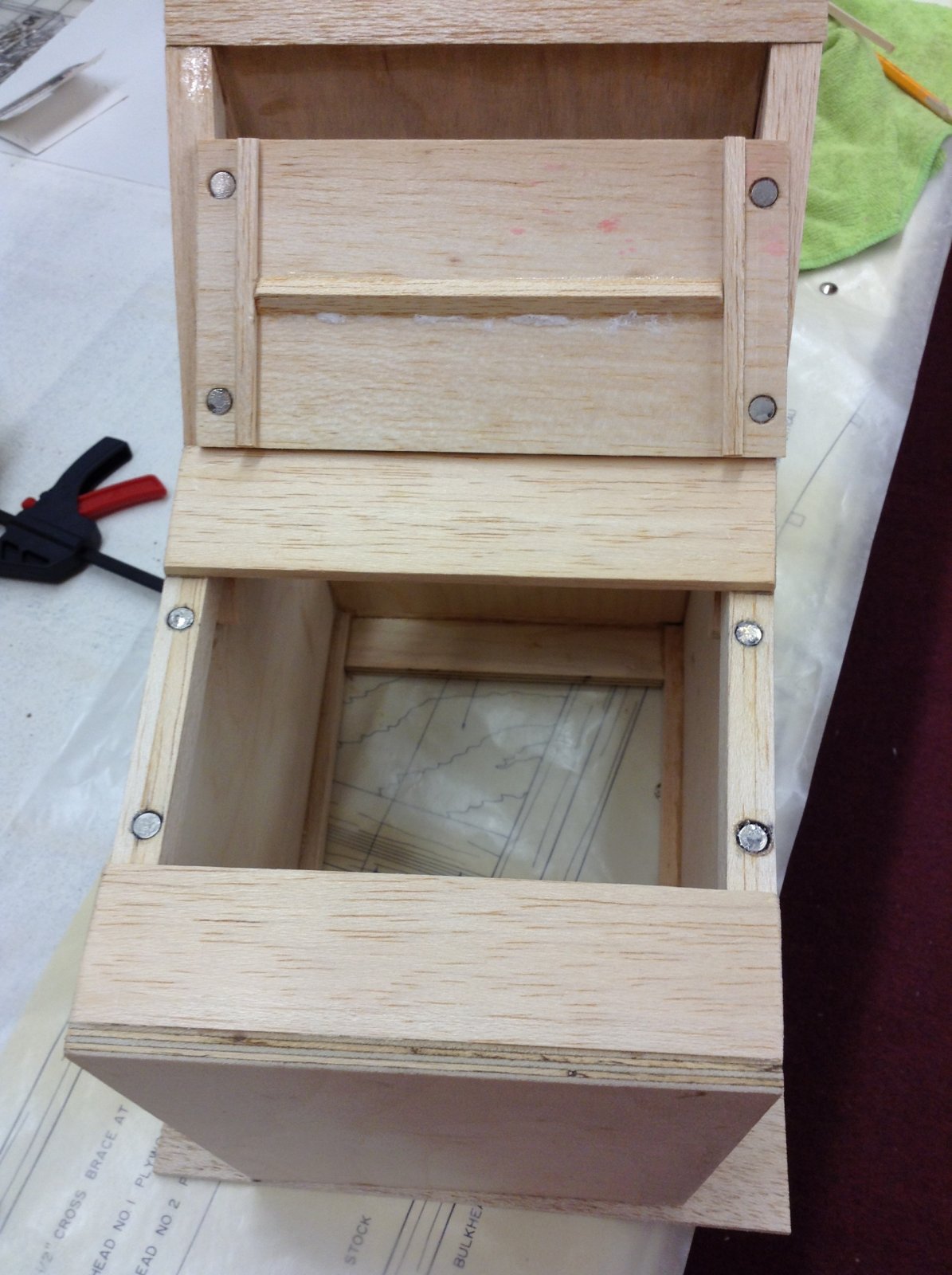

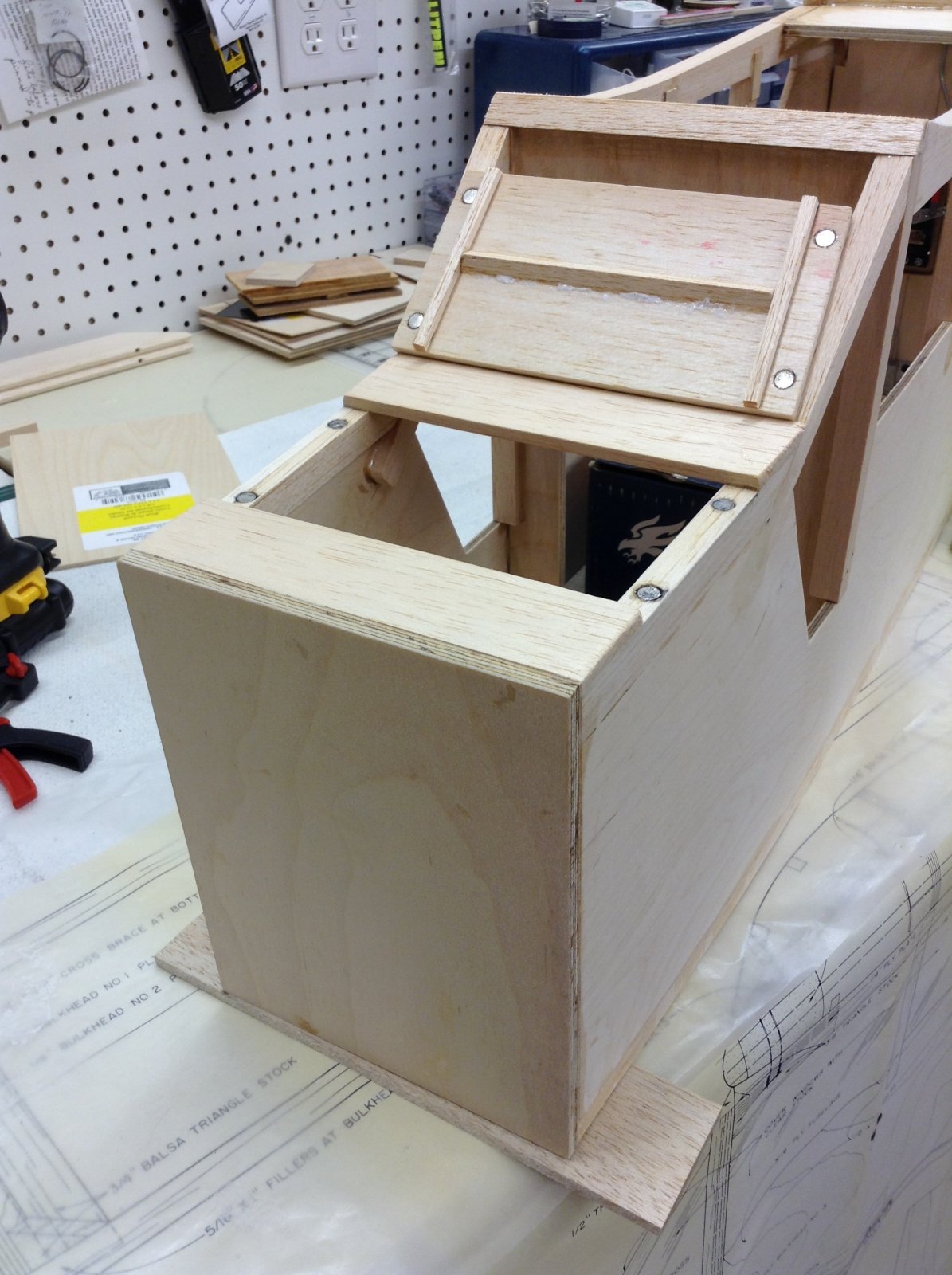

The plans called for a solid cover on top of the fuse from the firewall to the windshield. That would have made it a real pain to access the area behind the firewall. So I fab'd a magnetic hatch.
