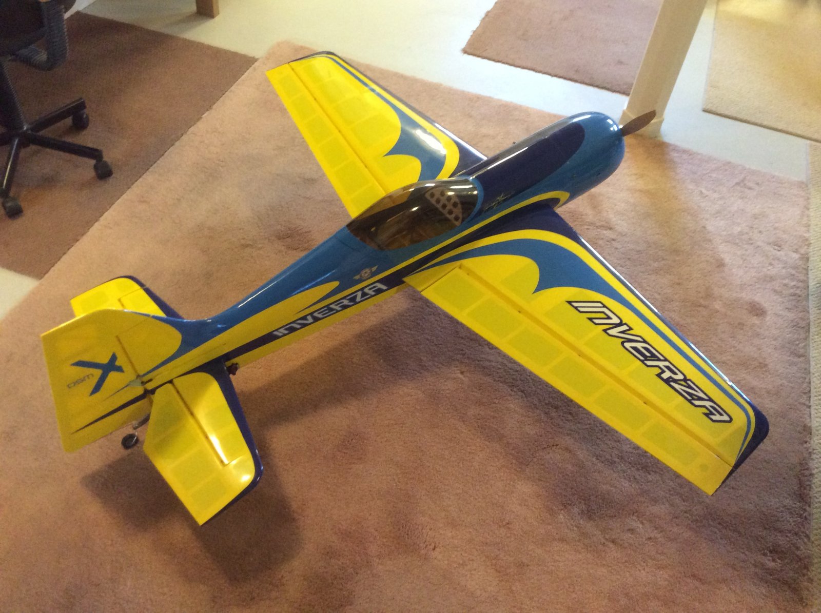

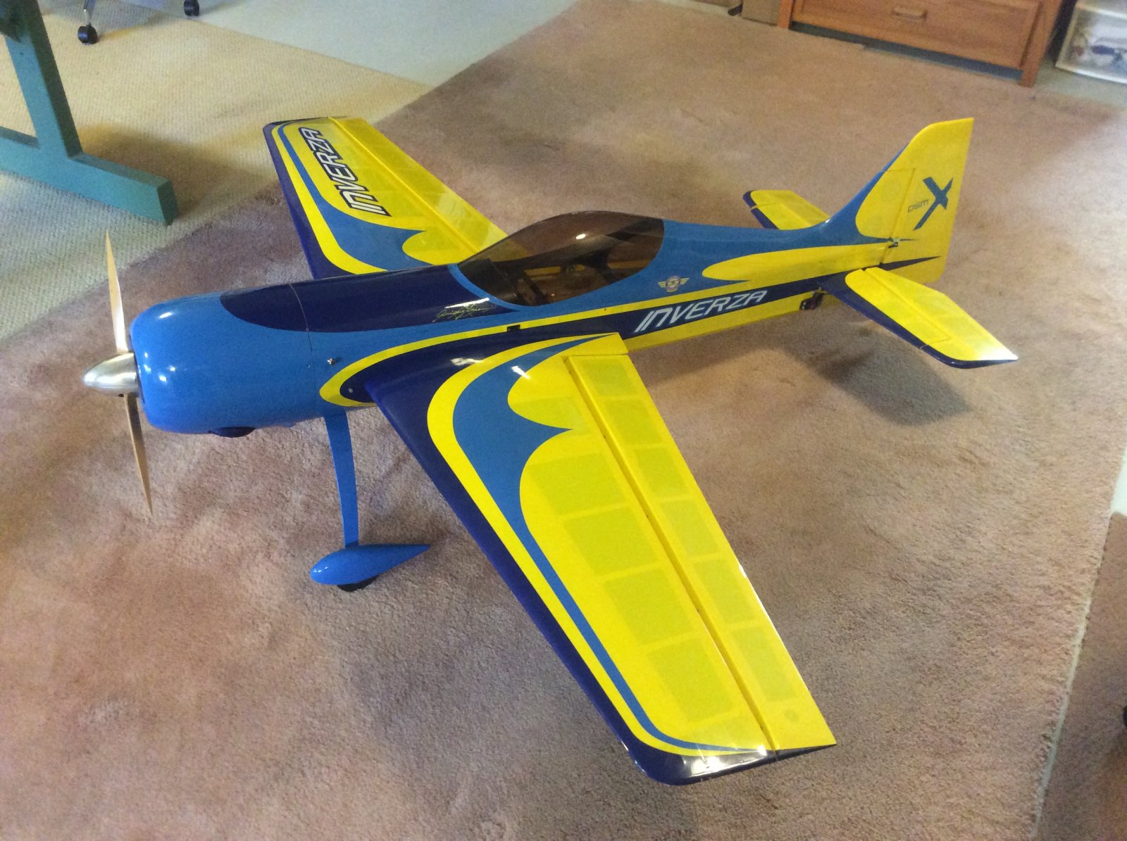

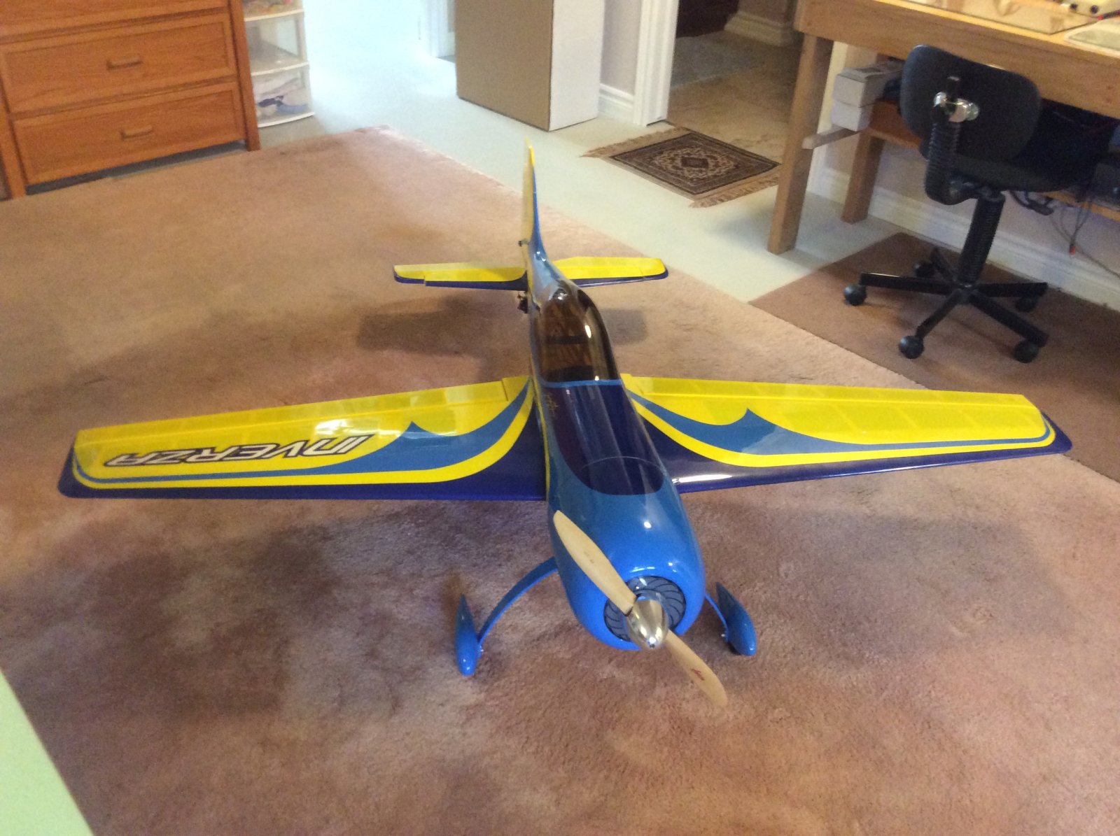

Well this is the plane assembled and the stickers are on. The only thing left to do is run the engine and setup the idle with the radio and check the gas tank to see how it fills and empties.
Checked the weight and it came to 12 pounds exactly I am pleased with that. So I have to wait for spring to fly the plane that is going to feel like a long time.

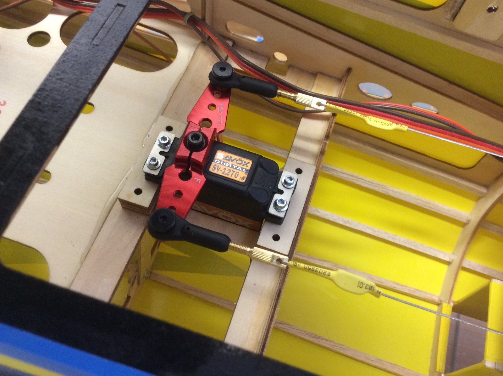

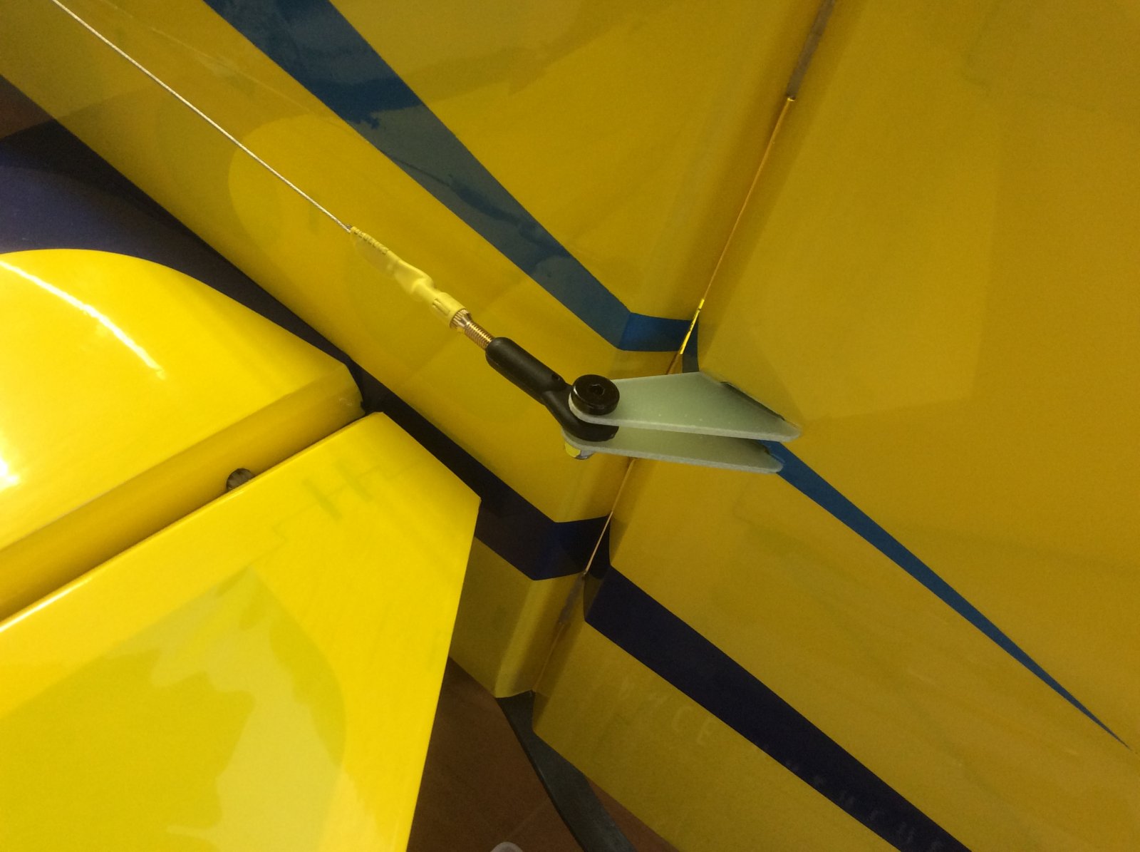

View attachment 93467 View attachment 93466 Finished off the rudder and the linkage and did the preliminary set and all the nuts and bolts tighten down. Boy as I was writing this a just remember that the rudder servo arm is not been bolted down with blue loctite..
I am curious what bolts you are using there? I don't remember seeing those before. I like the flattened and recessed hex head. Where do you get them?

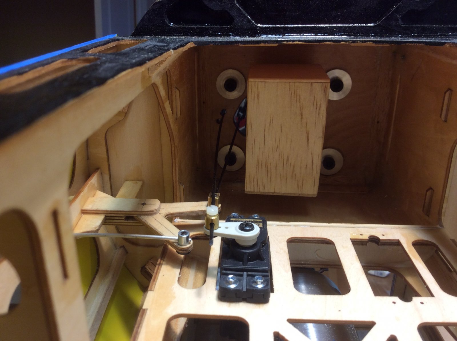

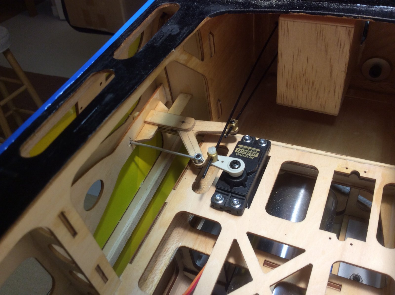

View attachment 93512 View attachment 93511 Got the throttle and the choke done the choke could not go through the front or the bottom so it ended up going back into the fuselage. And making a bell crank and then out the side just ahead of the wing.
That is a pretty bitchin' setup on the choke.
The standard screws with grommets work just fine. Just when you get into 400Oz servos you really start to crank down on the the servos to hold everything in place. What I find is that on the rudder with the plates on the servo is held better in place, less side to side movement and you do not have to tighten the screws down as hard.
I've seen those used a time or two, but really didn't see an advantage. I've never had any problems with the standard equipment that comes with even the 611 oz. 7980's and 611 oz. magnetic encoder 7990's. But I definitely do now see an advantage. I may have to give them a whirl.

1. The blots on rudder are neat I picked them at JoeNall a couple of years back and have never seen them again, if I had known how much I liked them I would bought a lot more.
2. The choke worked out well I was lucky that everything lined up and the support for the bel crank and fuselage lined up.
3. The little plates for the servo are great I only use them sparingly normally on rudder and sometimes on the elevators but that is about it. Try them you will like them when used in wright locations.
