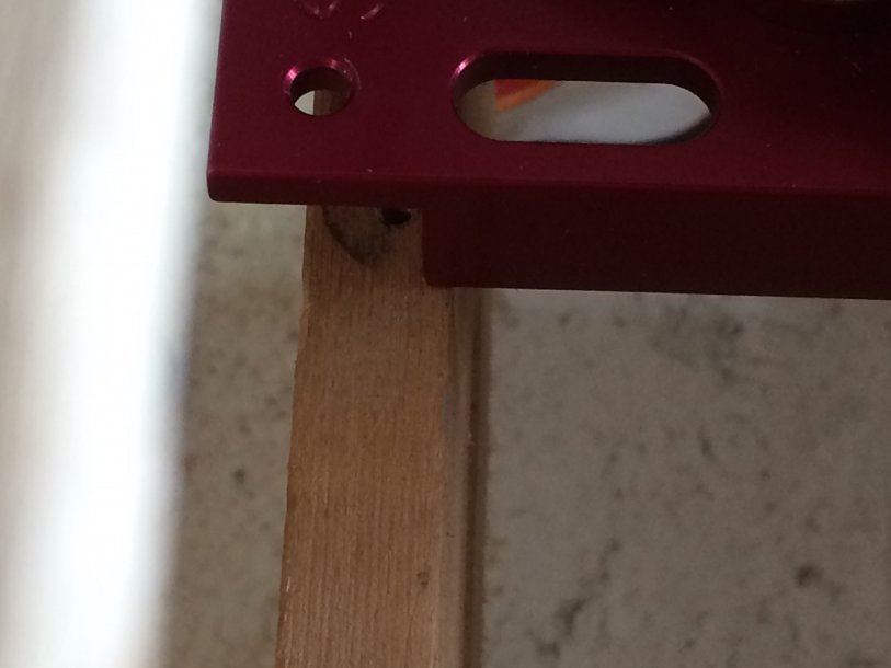

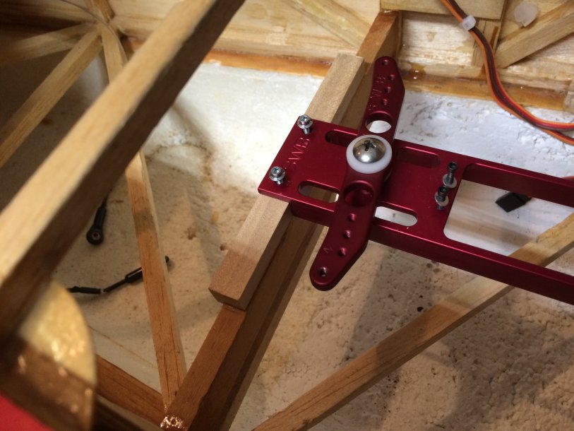

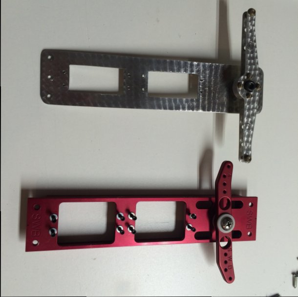

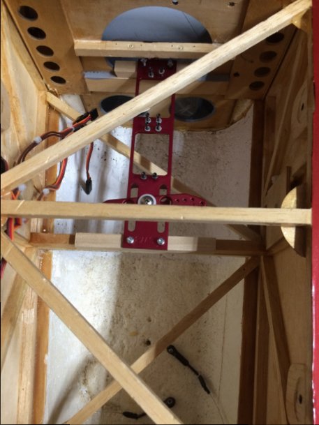

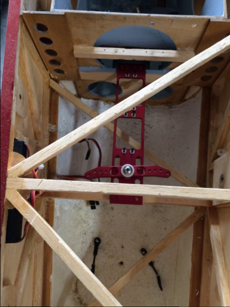

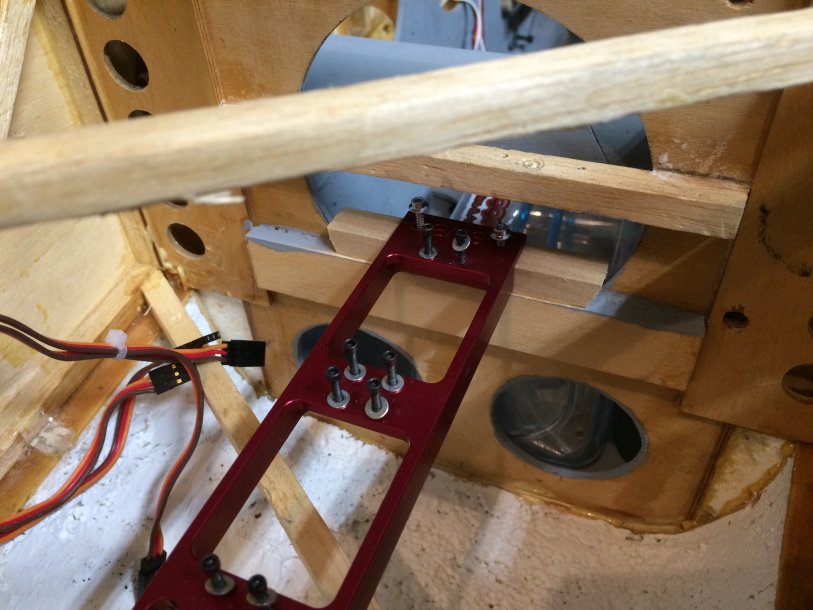

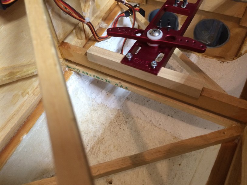

I Didn't care for the rudder tray that was in the plane, so I picked up a SWB tray. It is slightly longer than the one that I took out.

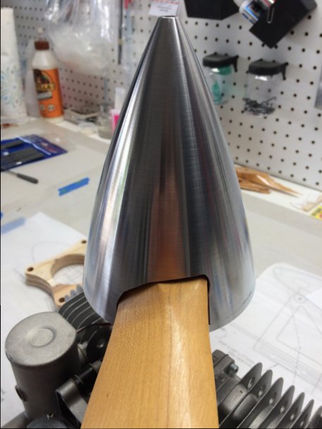

Here is my spinner all cut. This was my first one I've done, but I think it turned out good. Now I need to pick up a bolt long enough to hold it on.
