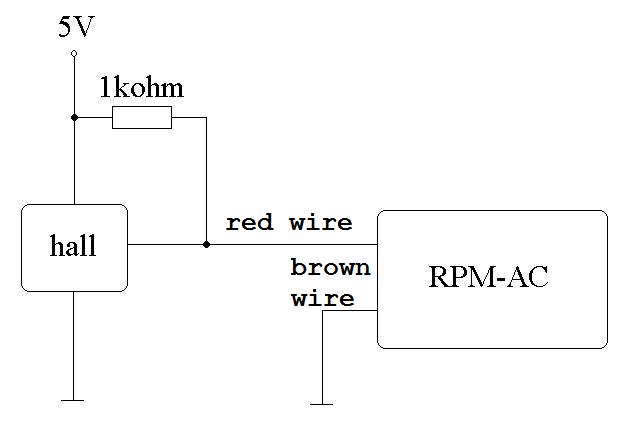

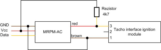

If anyone is interested in using the JETI MRPM-AC sensor for picking up RPM on gas motors, here are schematic mod's offering two options I received from the manufacturer in the Czech Republic. The ignition module option shown was with the intent of using DA's tach equipped ignition. It uses a 4.7k Ohm resistor minimum 100mW wattage. The other is for the blue hall sensor DA offers to mount to the DA-120. It uses a 1k Ohm resistor. If you have ever noticed the DA-120 has an additional set of tapped holes opposite the red inductive pickup. There you can mount their blue hall sensor. I never liked the idea of JETI's optical MRPM EX. To me trying to mount an optic to read rpm's off the prop as it passes by is just not the best idea. Not to mention trying to figure out how to mount such an animal.
These were MRPM-AC JETI BOX settings I received:
Number of poles - 2
Trigger level - 5000 RPM
Time Delay - 1.0s
Gear ratio - 1.0:1
I never received an answer on what to do with the n100W setting if anything. I have built the version for the tach equipped ignition module. When I finish my 3DHS Slick I'm going to try it out.
