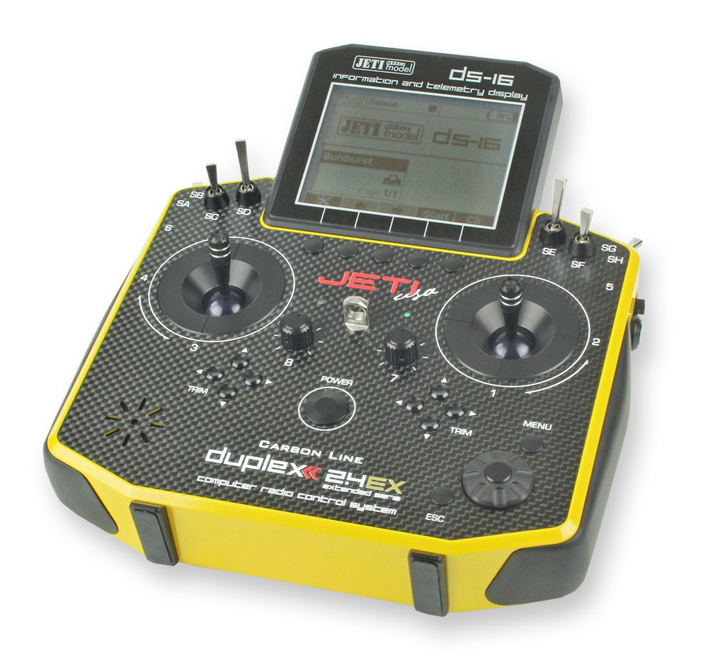

Well, I did it, I ordered my DS-16 last Friday, I'm so excited. Toughest part was figuring out what color I wanted but the kids voted and I ended up getting the yellow carbon. I got it with the free 7ch RX which will go in my Ultra Sport. I also ordered the CB200 for my 35% extra with the wireless switch, and a 12ch REX for my Corsair. I think I'm going to order a second 12 ch for the corsair I might need 14 channels. I also got the USB adapter for the firmware updates and some multiplex connectors for my batts. Soo, I guess I'm in Jeti deep now, but I'm really looking forward to it. I've never seen or held one in person but it will be nice returning to a high quality transmitter since I sold off my 12x a couple years ago. I've been reading all the manuals online and going through all the threads on all the boards. I took the free shipping deal they offered and they must have shipped it freight, says it won't be here until Monday, 10 days! Waiting....waiting...waiting...
