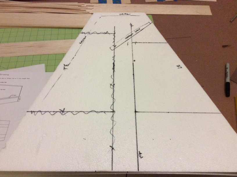

reinforcing with carbon is not a bad thing but as my Dad said, we have never done it on any of ours and have had no issues so far.
Alky6
Agreed. Probably not necessary (adding carbon), but will probably do it as I don't see any drawbacks. Also, if I do decide I want to add some lightening holes (I'll make sure I don't put the carbon in the relief holes) it will add some stiffness that could be lost during the lightening. Probably won't add lightening holes, but won't rule it out just yet either. LOL. Decisions, decisions....
Alky6
So this is what I have settled on for carbon on the rudder. Going to use 0.007" carbon laminate along the TE, top, and a 45 piece at the top of the hinge line where it meets the counter balance. The 45 piece is mitigation for any potential stress risers where the hinge line meets the counter balance. And yes, I did start drawing it in backwards. Measure twice cut once right! LOL

If your running the cf to the bottom of the te stop an inch short for rounding out the tip of rudder , if your going to round it that is.
Keeps the tip from being damaged in a steep take off.
