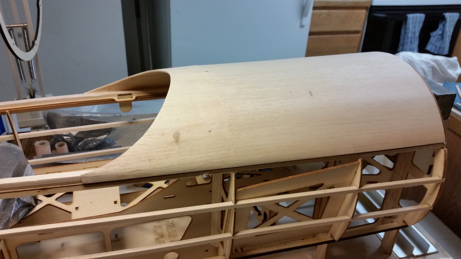

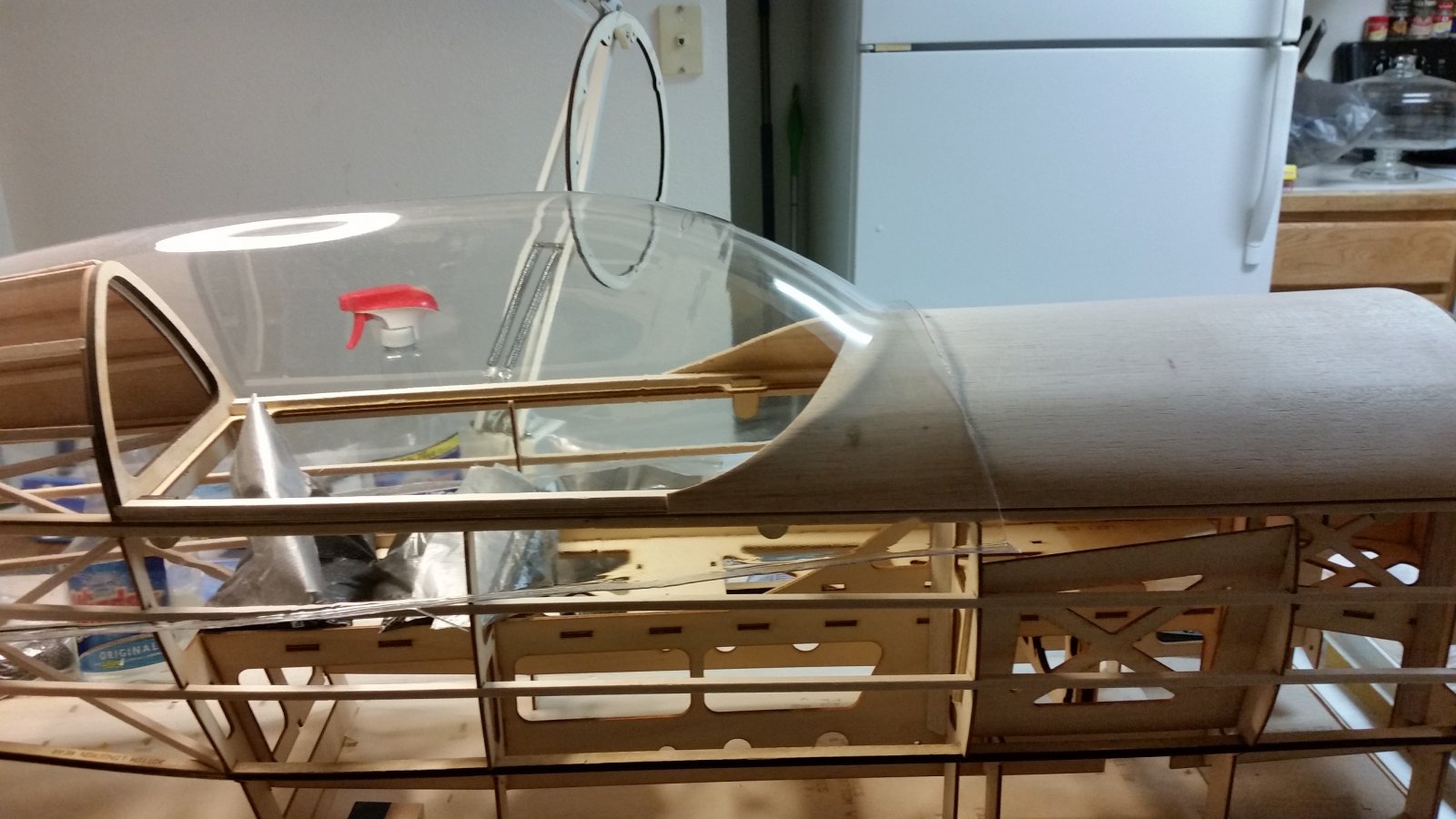

A little more work on the canopy before I call it a night. I looked at a "LOT" of planes on 2wings.com tonight to get an idea of the canopy/hatch area. I may need to adjust the radius and the overall length, but I think the arc is pretty close.

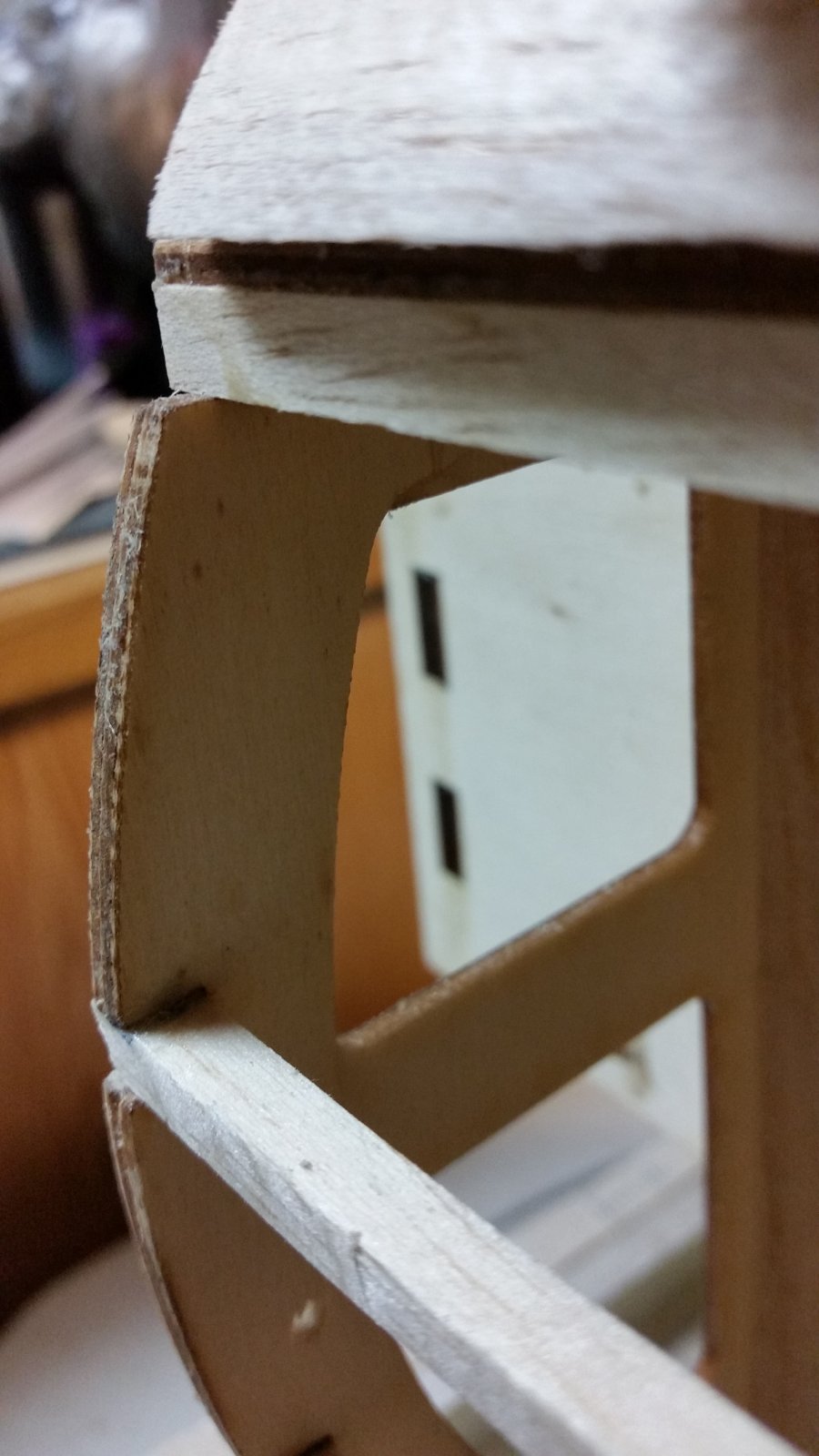

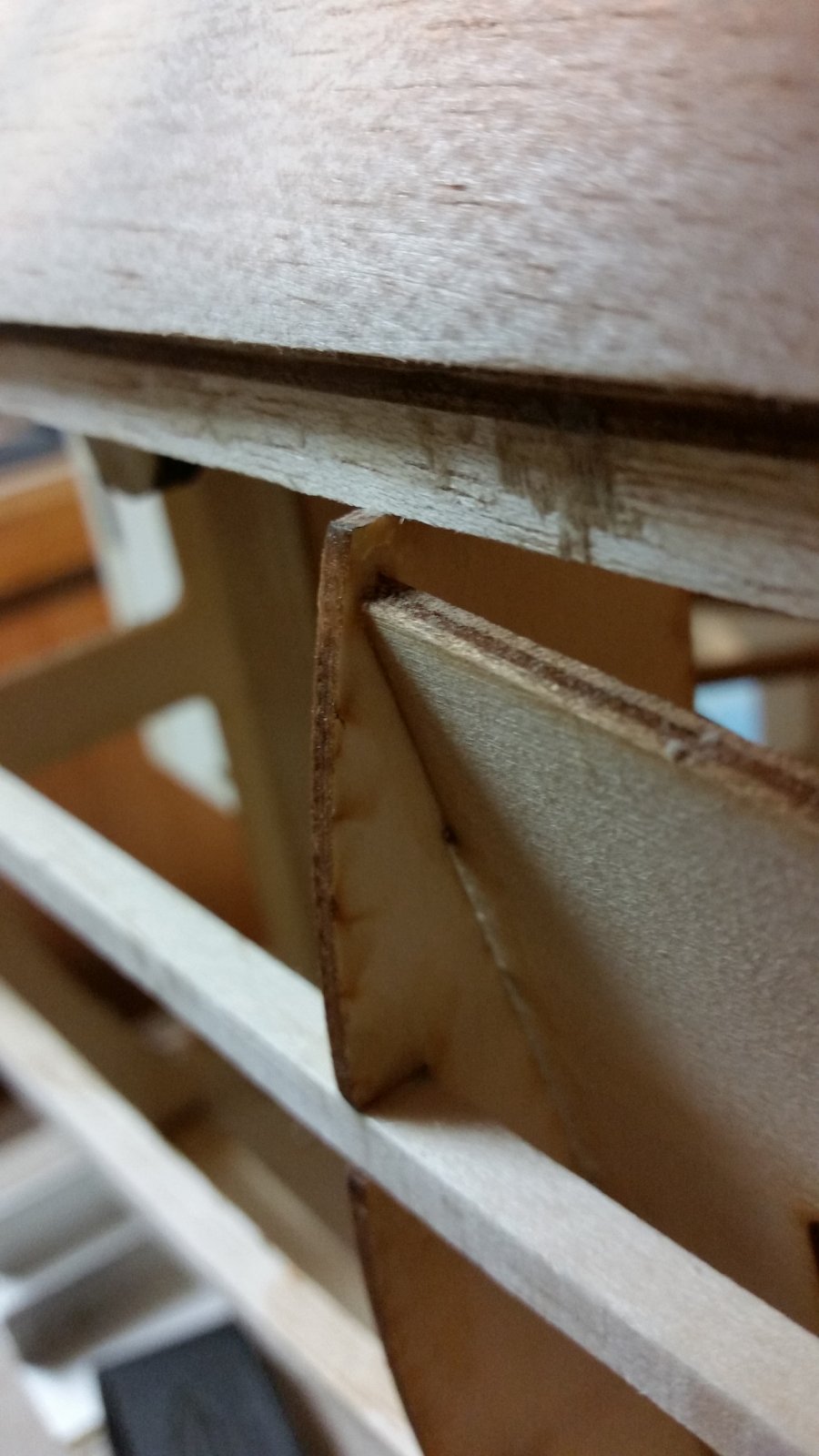

Rob,
If I am understanding you correctly the sheeting only goes to the top of the 1/2" longeron ( sits on top ) and then the longeron is sanded to shape to match the sheeting. The sheeting does not go over the longeron.
Actually what I was referring to and did not make real clear, (I am sorry I didn't explain myself better) is the F1, F2 and F3 formers at the top where the balsa longeron is glued under the laser cut lite ply longeron. According to the manual which maybe I misunderstood, it calls for 1/4" x 1/4" balsa to be glued underneath. But as you can see in the photos I have attached, there is a gap that when the fuse side sheeting is laid into place, there will be a point in which there is no contact with any structure. And to get perfect alignment with the top hatch, it may need to be in place when sheeting the fuse. Have I done something incorrect here? My resolution is to add a stringer from the front of F1 that will go the length past F3, then sanded and "feathered" in to match the shape of the rest of the fuse so that the fuse sheeting will have more "meat" to attach to. Hope this makes sense and is a better explanation.
