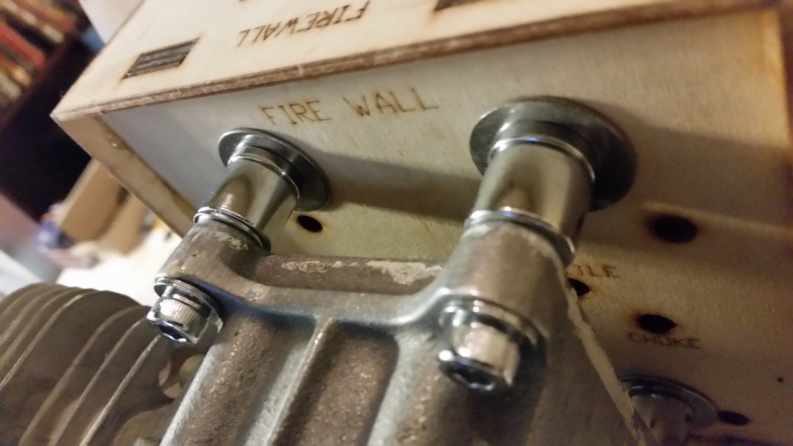

I think I have it figured out. It looks like there may be a variance in the materials that are accounting for some of the firewall thrust. I have different pieces of 1/4" birch wood here which are varying in thickness from .233 on up. So if that is the case in your firewall you may have had enough slop in there to add up thrust.
I did take your measurements and put them in autocad and it would be 4 degrees up thrust. So to correct this if you put a large fender washer (1/4" bolt size) behind the top two motor bolts that should get you pretty much back in the ballpark.
Kevin
Rob,
Kevin
Already done. Look back at first post page 33.

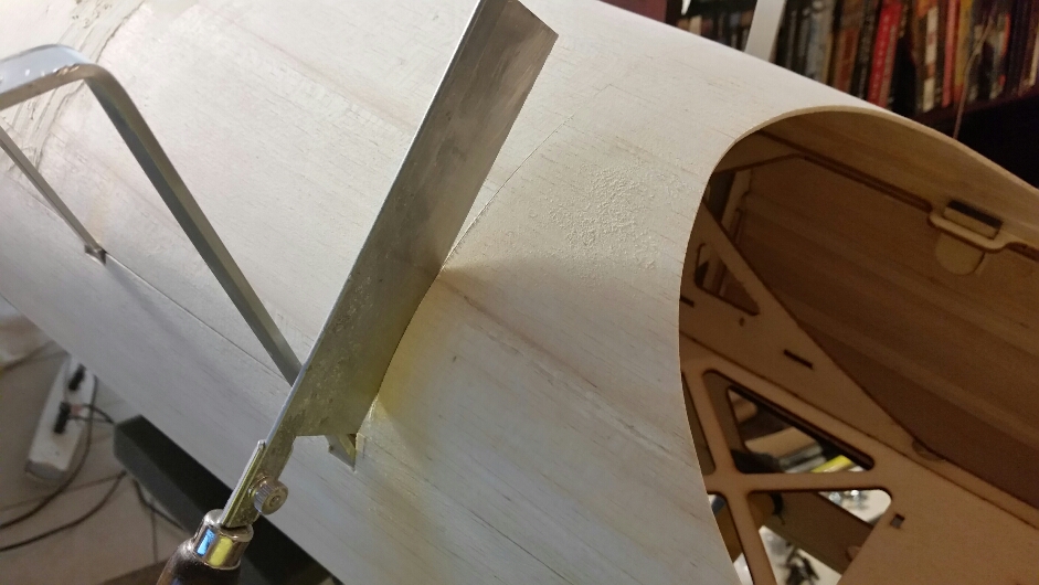

Well, here goes another spooky adjustment. The hatch was fine. But nooooo, I just gotta mess it up. I'm going to cut my radius cockpit opening out and extend the hatch. Why??? Cuz I want a single seater.

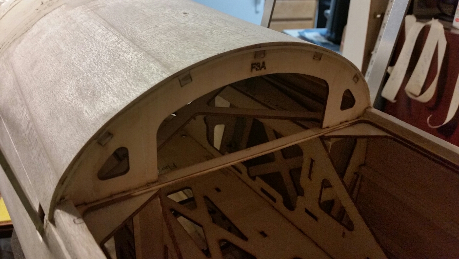

I figure if I'm going to do the scheme decided upon, might just as well make it match the full scale as closely as I can.
With the radius cut out, I can now construct a support and re-sheet the cut out area. I'll get some more photos posted once the hatch is done.
