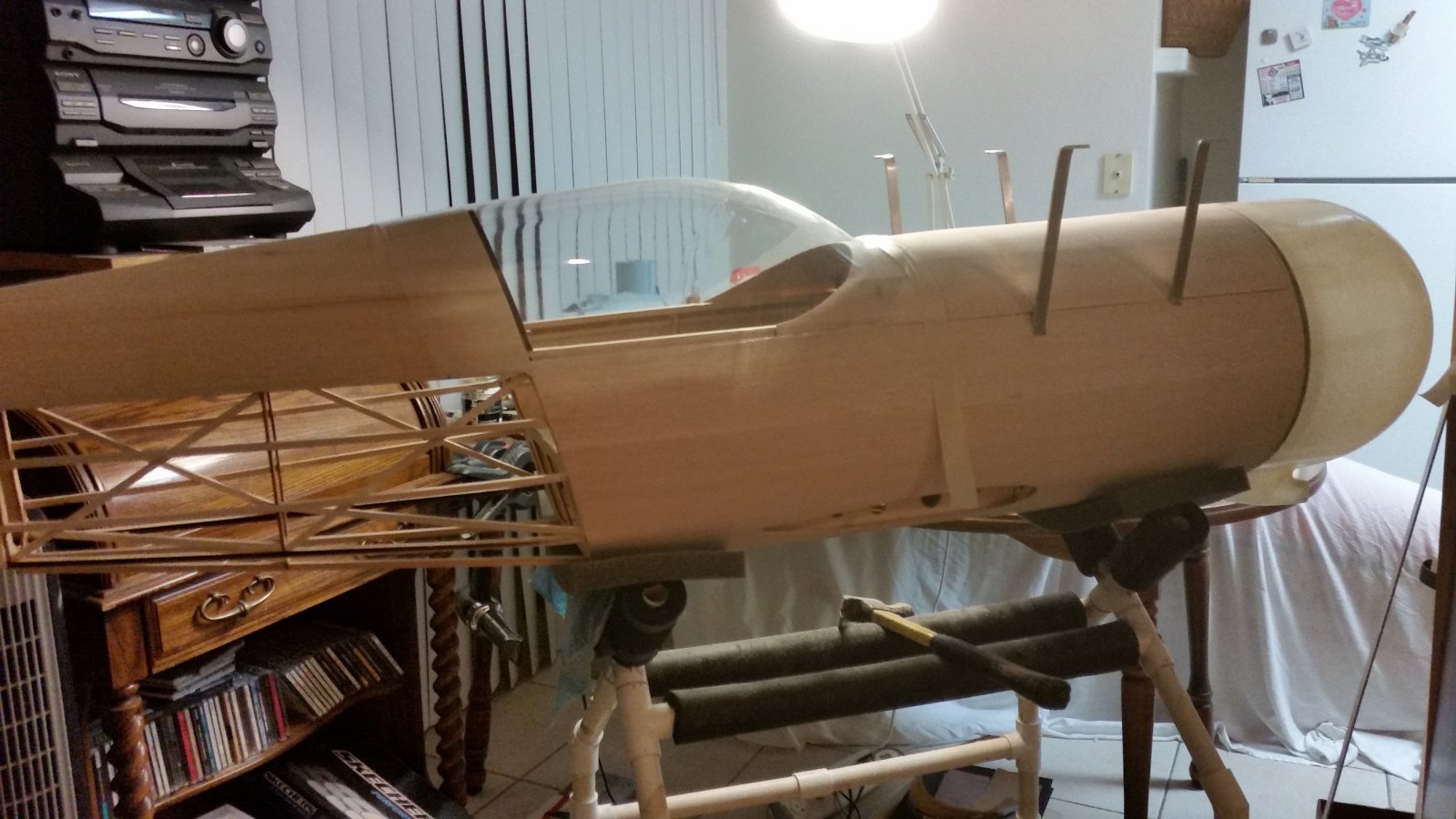

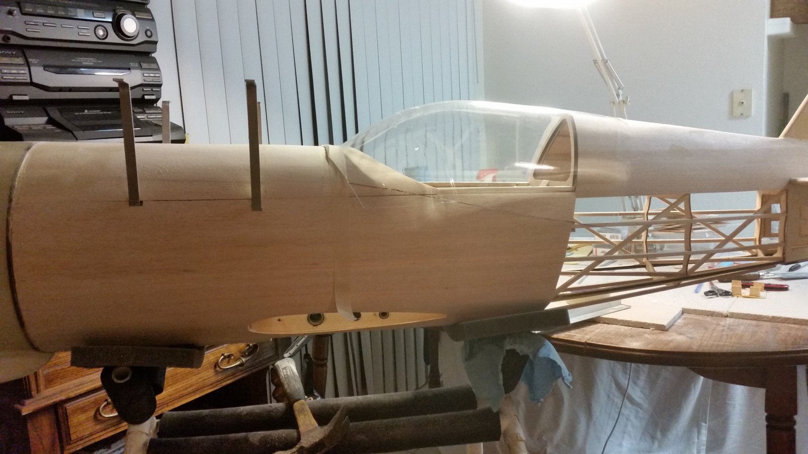

Ok everyone, I really blew it this time. I should have left well enough alone. Oh but nooooo....I just gotta go messin' wit stuff. LOL. Actually, I think it is going to come out looking pretty bad ass. I still have some sanding and some final fitting before I cut the canopy to fit the hatch. But if the finished product looks as good as what it looks like it will at this stage, I think I will be happy.

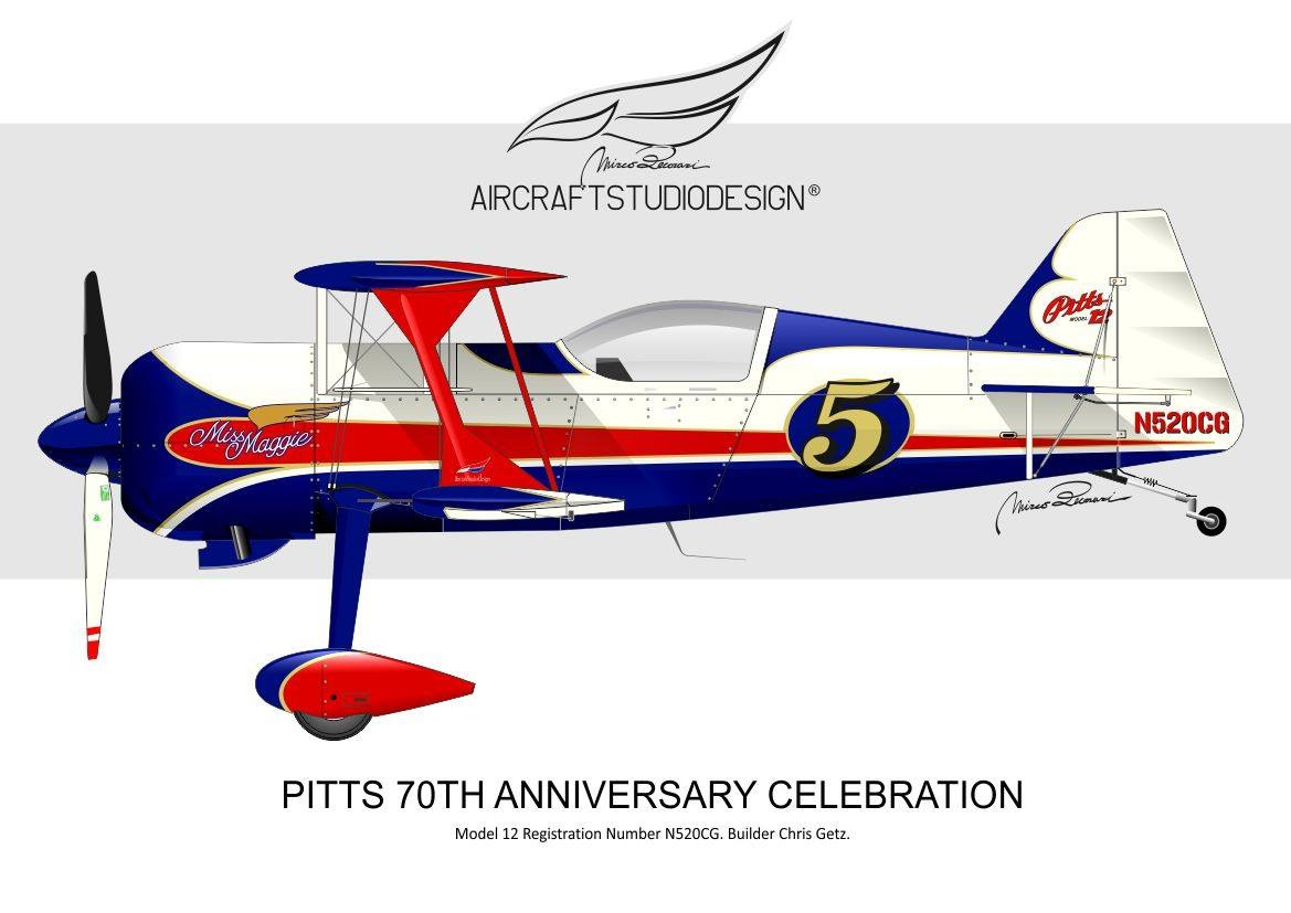

Full Scale Single Seater....
This is what I used for reference....

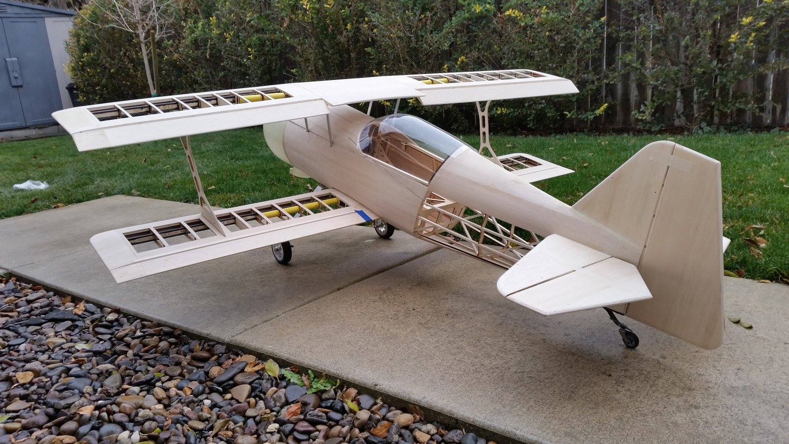

Aaaand....now what mine will look like as a single seater....

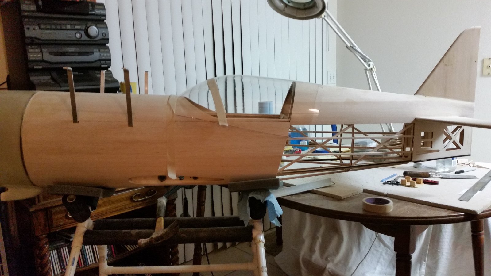

It looks like I can still move the canopy back just a little bit more to get the right appearance. I should be able to still move the canopy back another couple of inches. The tape on the canopy is to simulate where the frame work is. In all, I will be "chopping" off about 4 more inches to get the single seat version look. Of course by the time I get a "G-Force" pilot ordered from Northwest RC, (Supatim) and then build the dash panel...I think it is going to look pretty darned cool. Who was it that suggested I make this a single seater? Hee hee.... I like.
P.S. The claw hammer under the Pitts on the cross braces of the stand: It is my gentle but constant reminder to be patient and don't let it get the best of me. LOL
