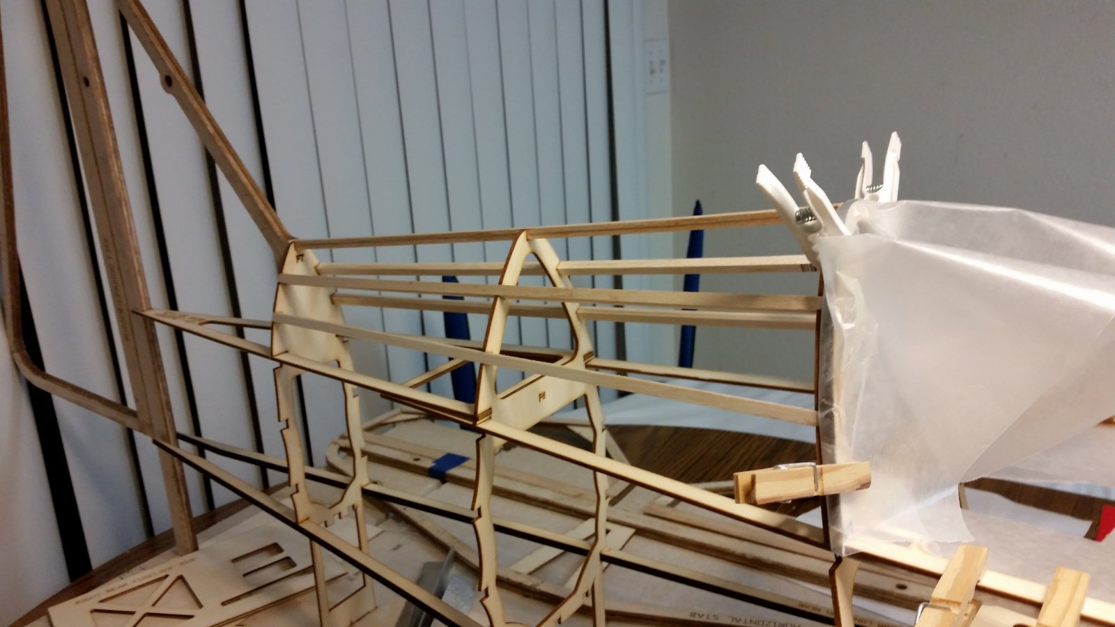

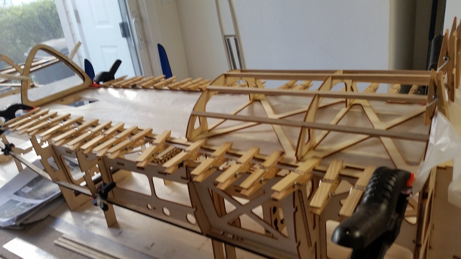

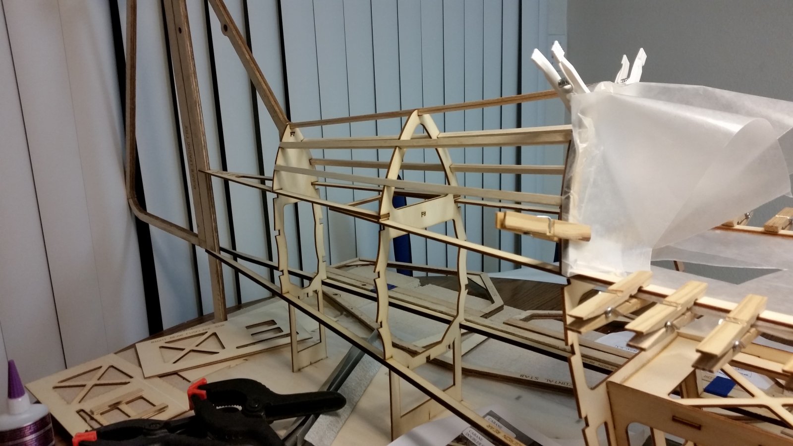

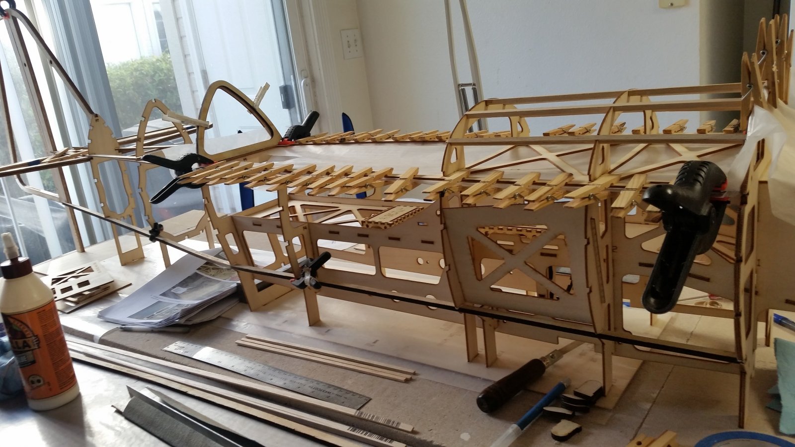

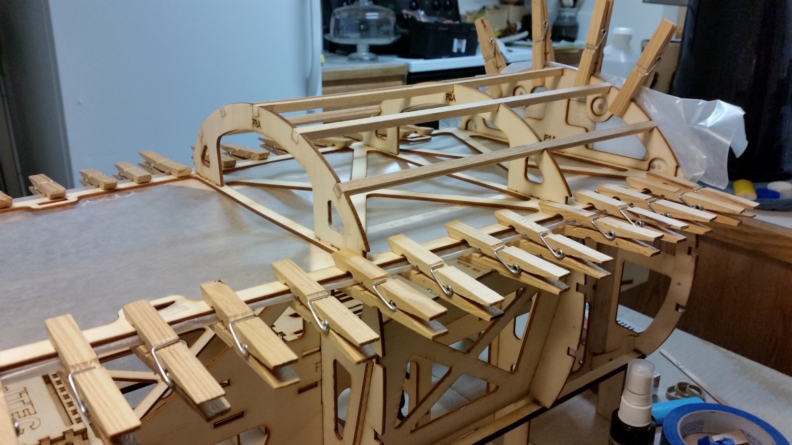

Just a couple of photos of today's progress. I will get more done when the rest of my stringers and supplies arrive.

The option is you can make it a single seat or two seater. As for the the canopy. clothes pins will help hold it to the former while the glue dries. At least thatss what I did when building mine.
The build looks real good. Your moving right along with it!!
