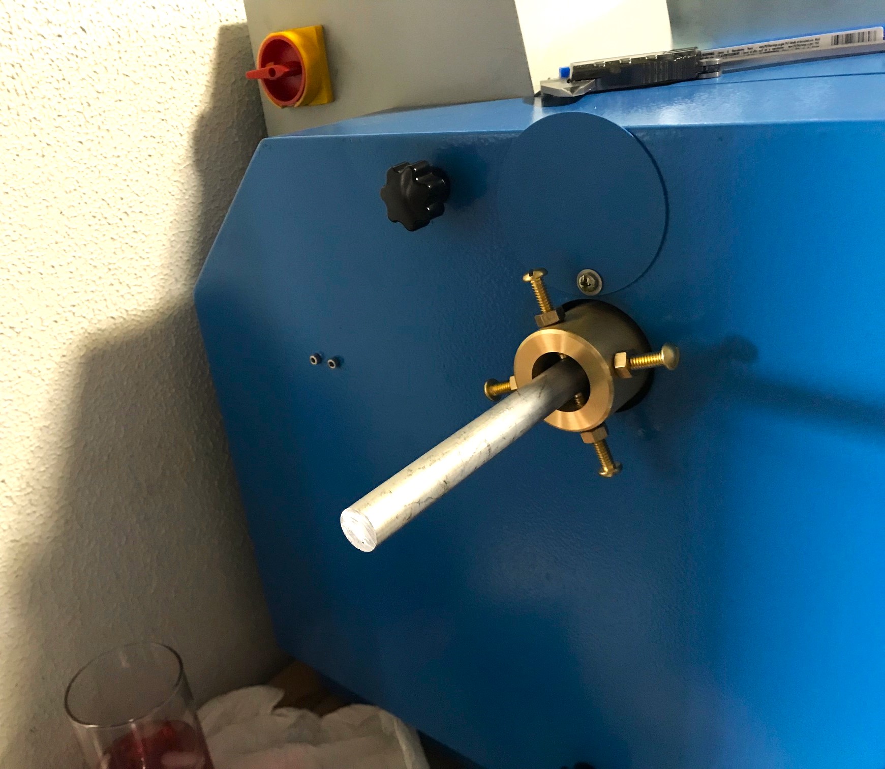

It's a spider for the lathe spindle. I have to make a bunch of sheer pins for work and the stock is 3' long. This will let me use the 3' stock without having to cut it down to work with.

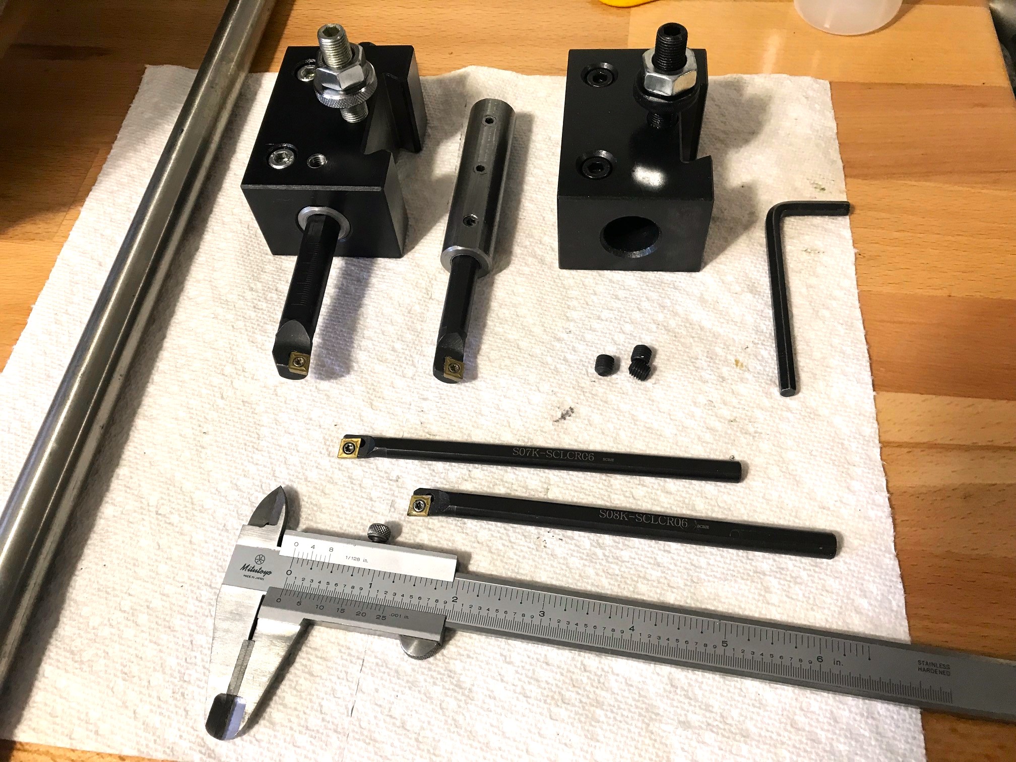

Made some sleeves for my boring bars. Still need to make a couple more. so far so good. For the larger bar, I had to run set screws down through the top of the holder. Took me a the better part of an hour just to tap those out due to the hardness of the metal.
