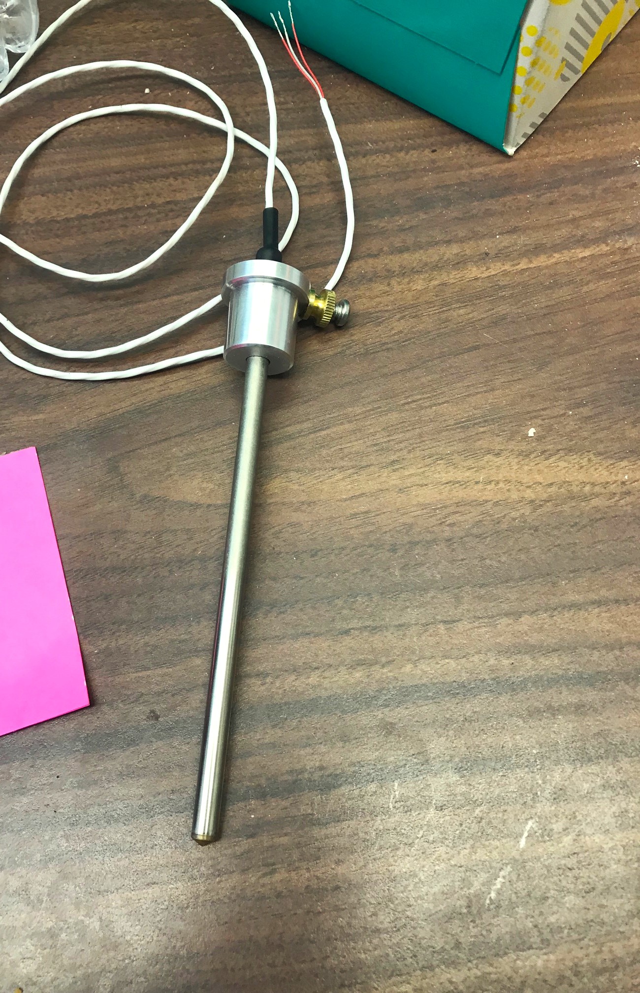

Built an rtd sleeve for work yesterday.
What application is this? I'm a plumber and curious.
We've got cooling water lines going to our journal bearings. The cooling water is hard piped into the tailrace of the powerhouse, but also travel through the sump pit that collects the shaft seal water. This RTD will drop into a pipe in the sump pit and monitor sump water temperature.
