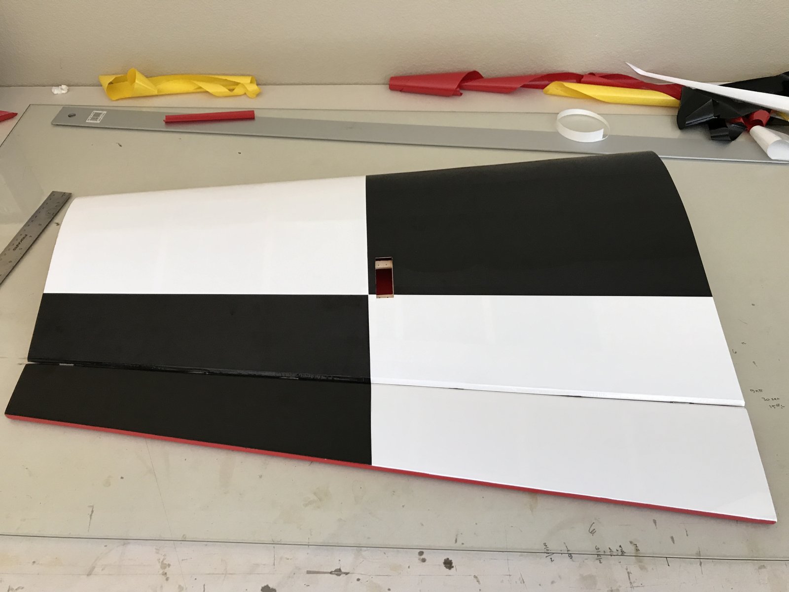

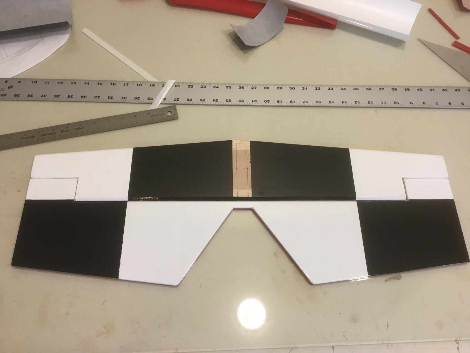

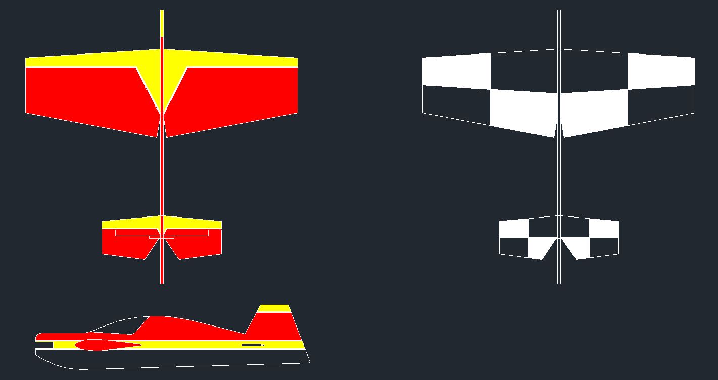

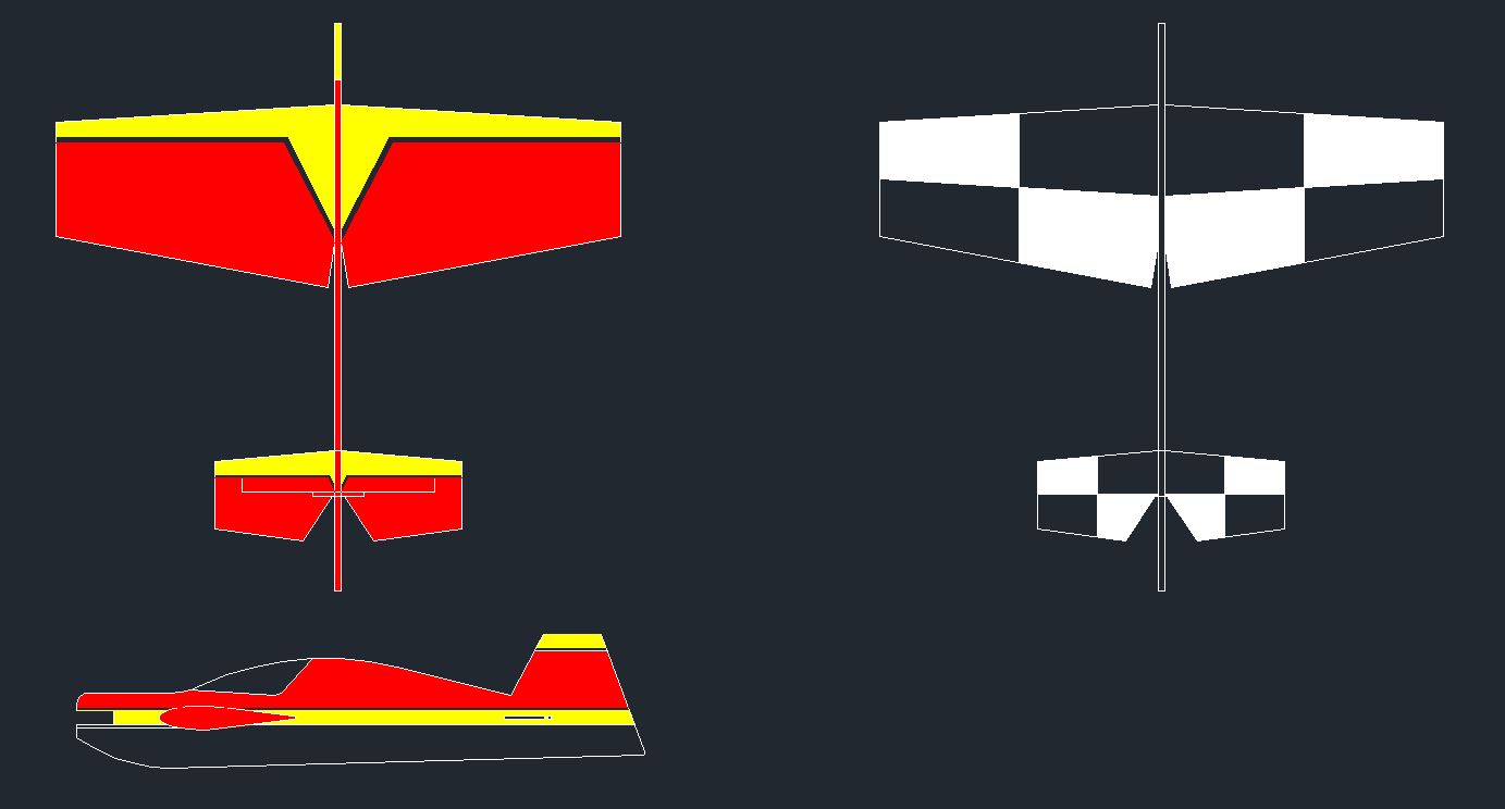

OK. Black stripes vs. white stripes. Black definitely makes better contrast. Might blend the two and leave a white stripe between the black and yellow on the fuse.
Alky6
I like it.

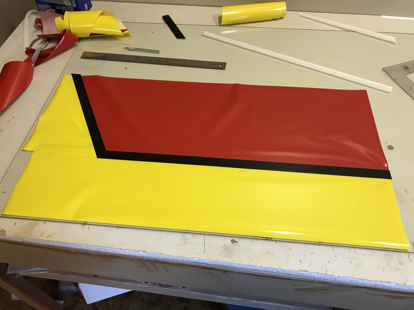

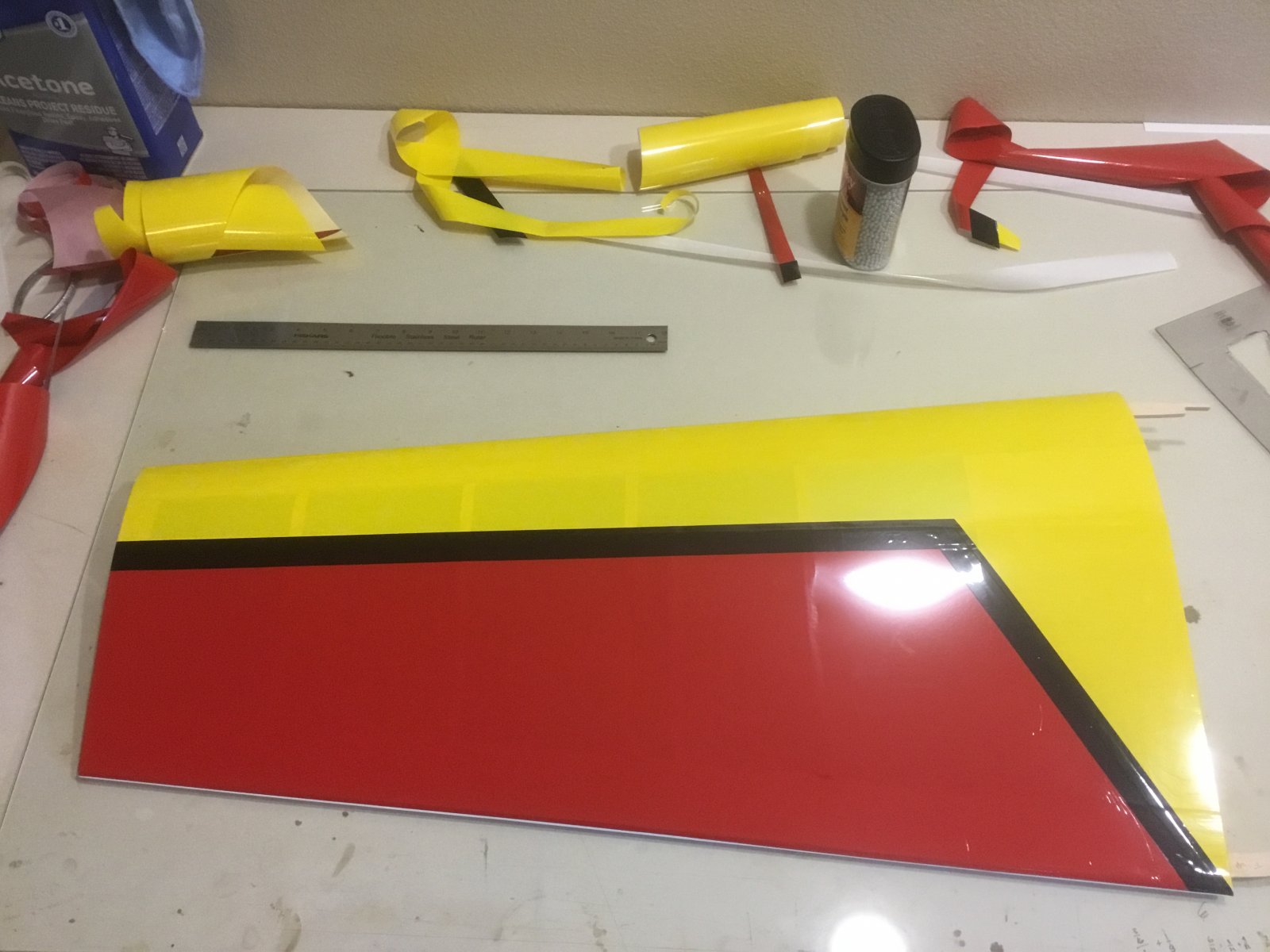

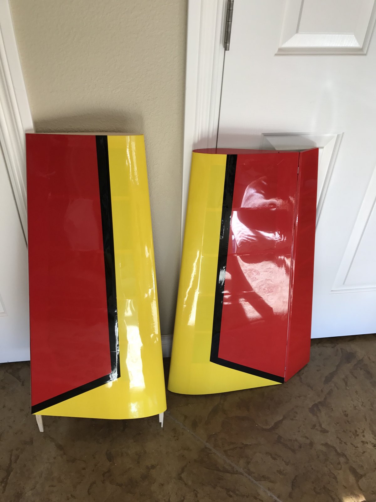

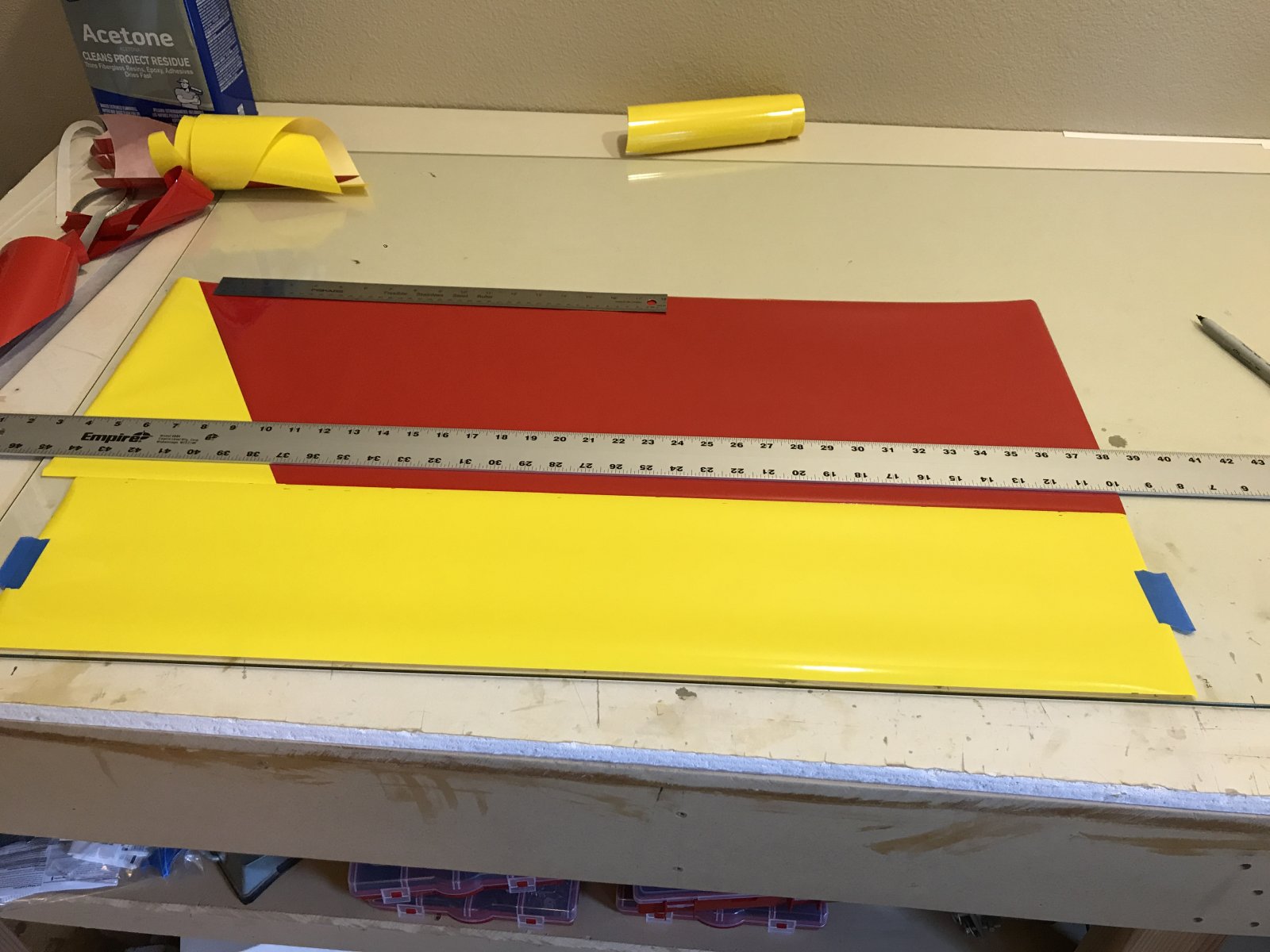

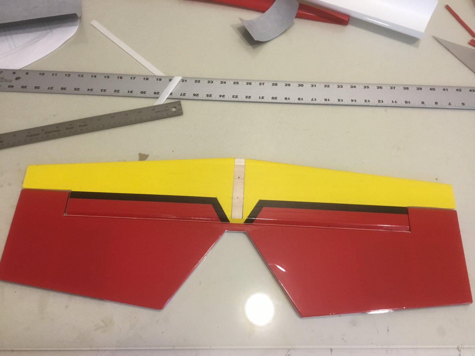

Using your technique to layer ultracote colors. Setting them up on glass then hitting the seams with the iron. Works awesome! On the next wing will have to take a bit more care to not get some wrinkles in it before setting on wing. Practice, practice. Below are the photos of the laying up the top of the left wing on glass, then the finished product. Really makes a huge difference on an open structure!!
