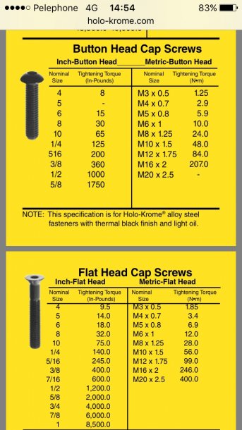

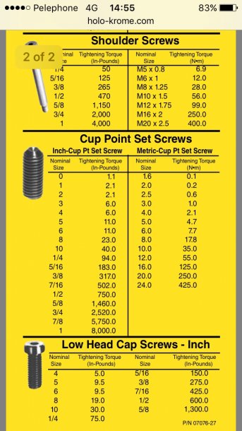

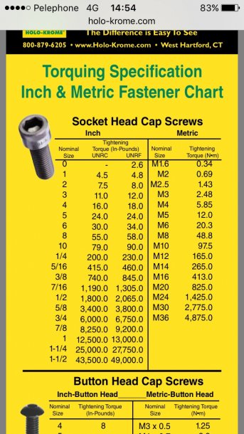

Is this a good chart ??

One action with several opinions, you just have to pick one and give it a try. I have always had great luck with my method without the first problem. Then taz says not to use gasket material. I'm not sure of torque will be the same if using gasket cause its squishy and gives to pressure.
torque value should be the same as the torque is dependent on two things
1, bolt characteristics: fastener diameter, pitch, and composition
2, attributes of the material the threads are anchored to
