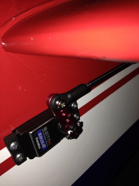

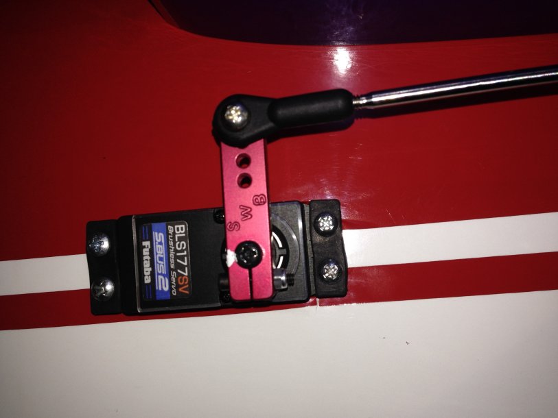

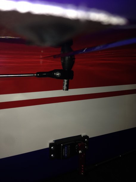

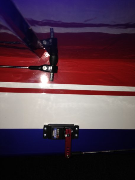

If you can, post a pic of your elevator linkages, I have a theory but want to make sure they used what I think they did on there for hardware.
To answer your questions, yes. You can always make the plane more friendly by adding a bit of weight but you do have some issues that should be fixed as well.
Here you go Terry. I was only able to take shots of the left stab-half, as I can only leave installed the one side in the trailer. Let me know what you see.

OK, there is part of your trouble with hunting for trim on the elevators. The part that threads onto the stud control horn is free to move and the ball link is also free to move. If the threaded clevis moves to the side and then centered again it will throw you off by a small amount It is best to put a threaded nut to lock that into position or even a dab of "Goop" to keep that from turning on the threaded stud. I actually just did that recently on a rudder that was giving me fits and it fixed it immediately.
Terry,
I can easily add a nut onto the threaded rod/stud and lock down the clevis. If there is any slop there, it would be very minimal and only left/right. I'll look to see if I can find a nylon nut to use, to keep the weight down.

Yup, and as that clevis moves left or right in shortens the distance between the clevis and your servo arm = trim adjustment issue. May or may not be it, but it fixed my rudder trim issue.
