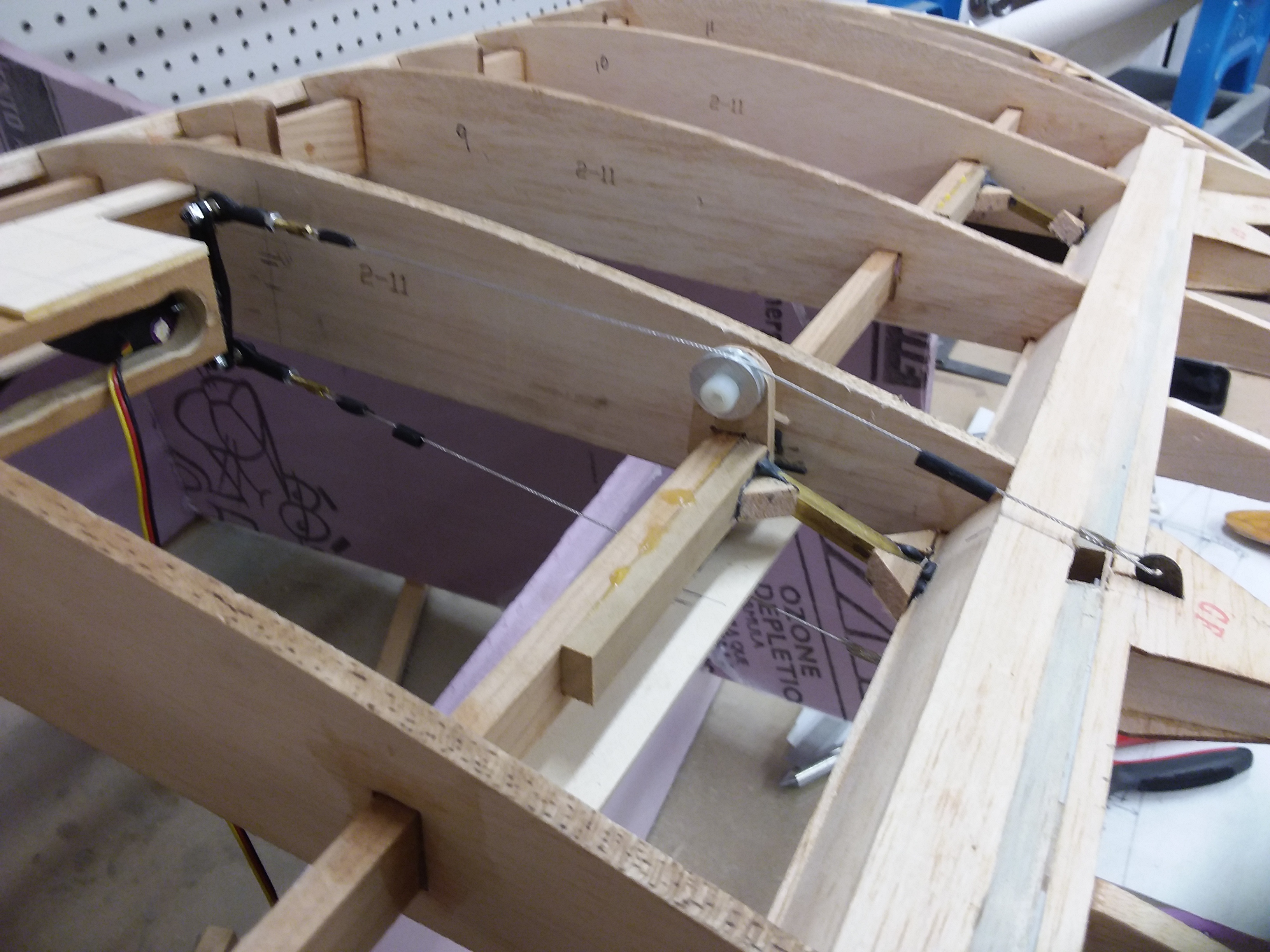

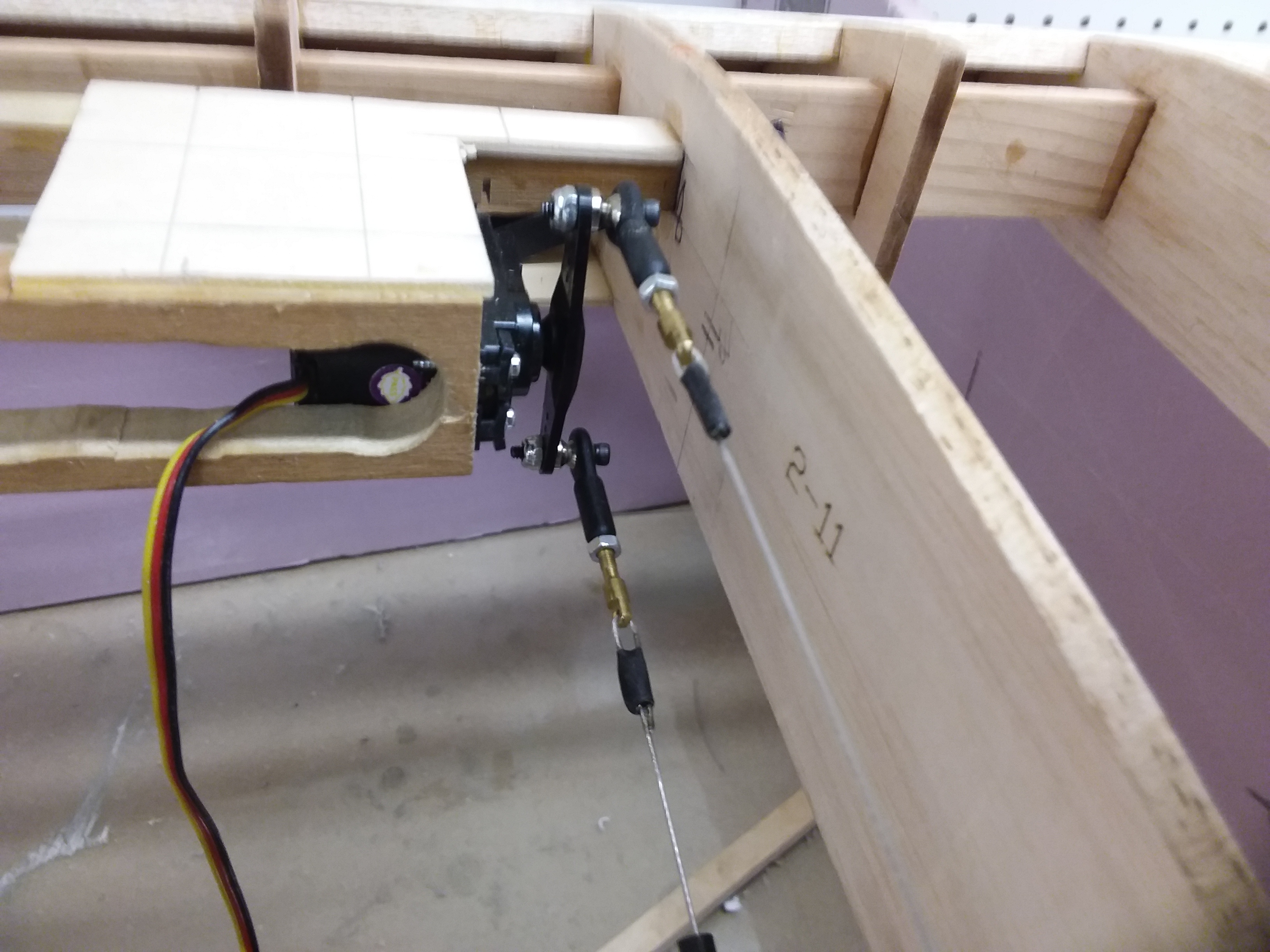

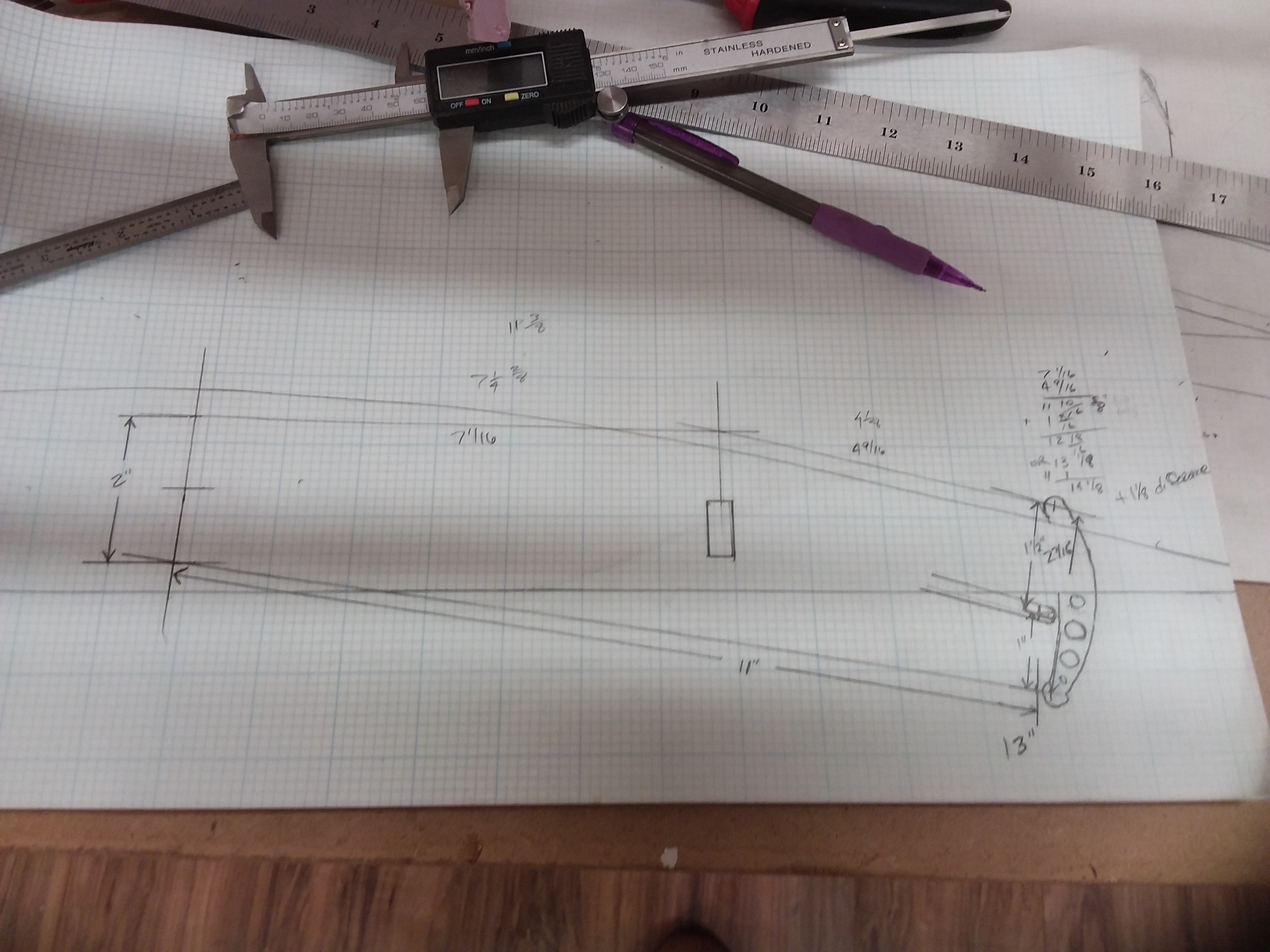

I like the nylon bolts too. Curious to see how the pull-pull system geometry does. Hopefully the wires remain taught. Otherwise, you may consider a little cable retainer so it doesn't de-rail. Your setup is going to look great! Fingers crossed mr. ackermann doesn't have to provide engineering here.
We were correct, the geometry doesn't work. At least initially. Over tightens in one direction and loosens in the other. I thought there was an issue with this setup but couldn't remember. Math isn't my strong suit.
At a minimum the pull pull cables should probably be the same length.

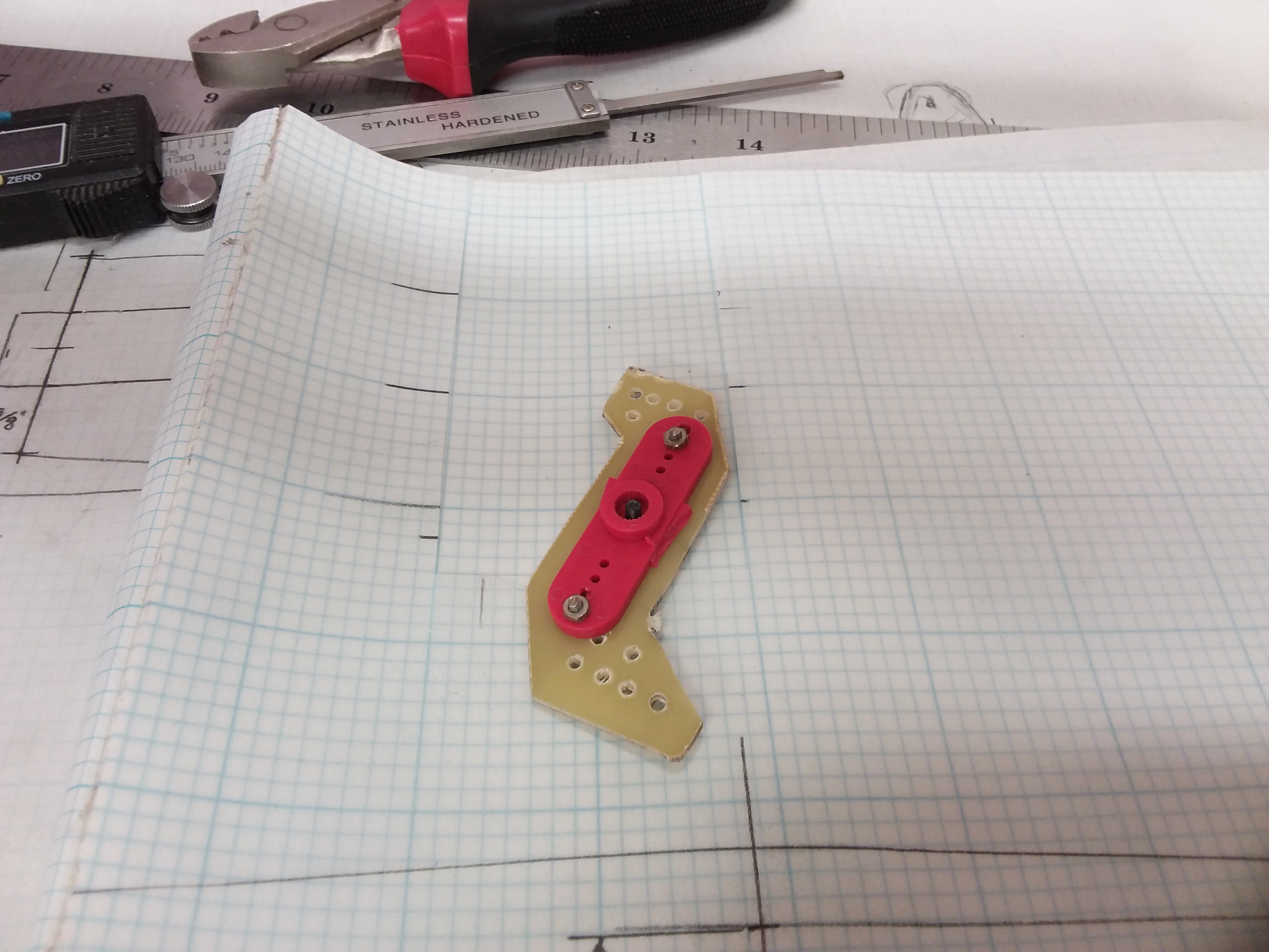

I think I might need to build a custom servo arm. Still thinking. My 84 year old uncle started aeronautical engineering before and worked on the Saturn V design then went onto stealth bombers, passenger planes and other areas he can't talk about. Good excuse to call him today, he got me into rc to begin with.

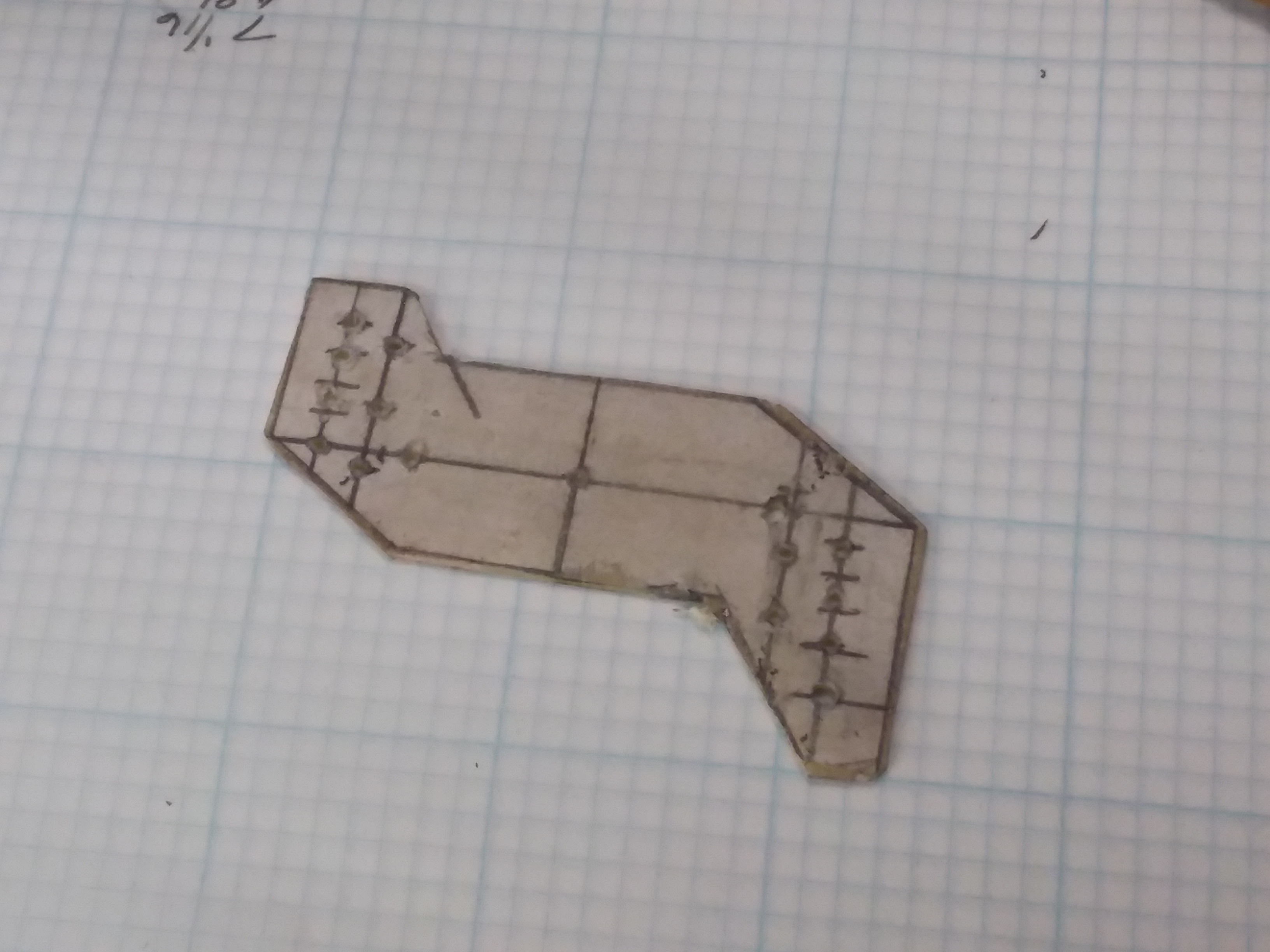

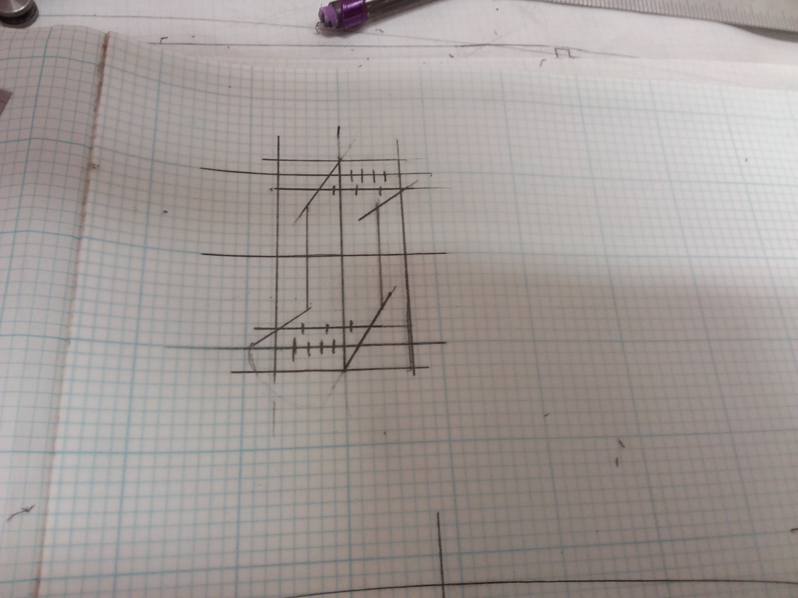

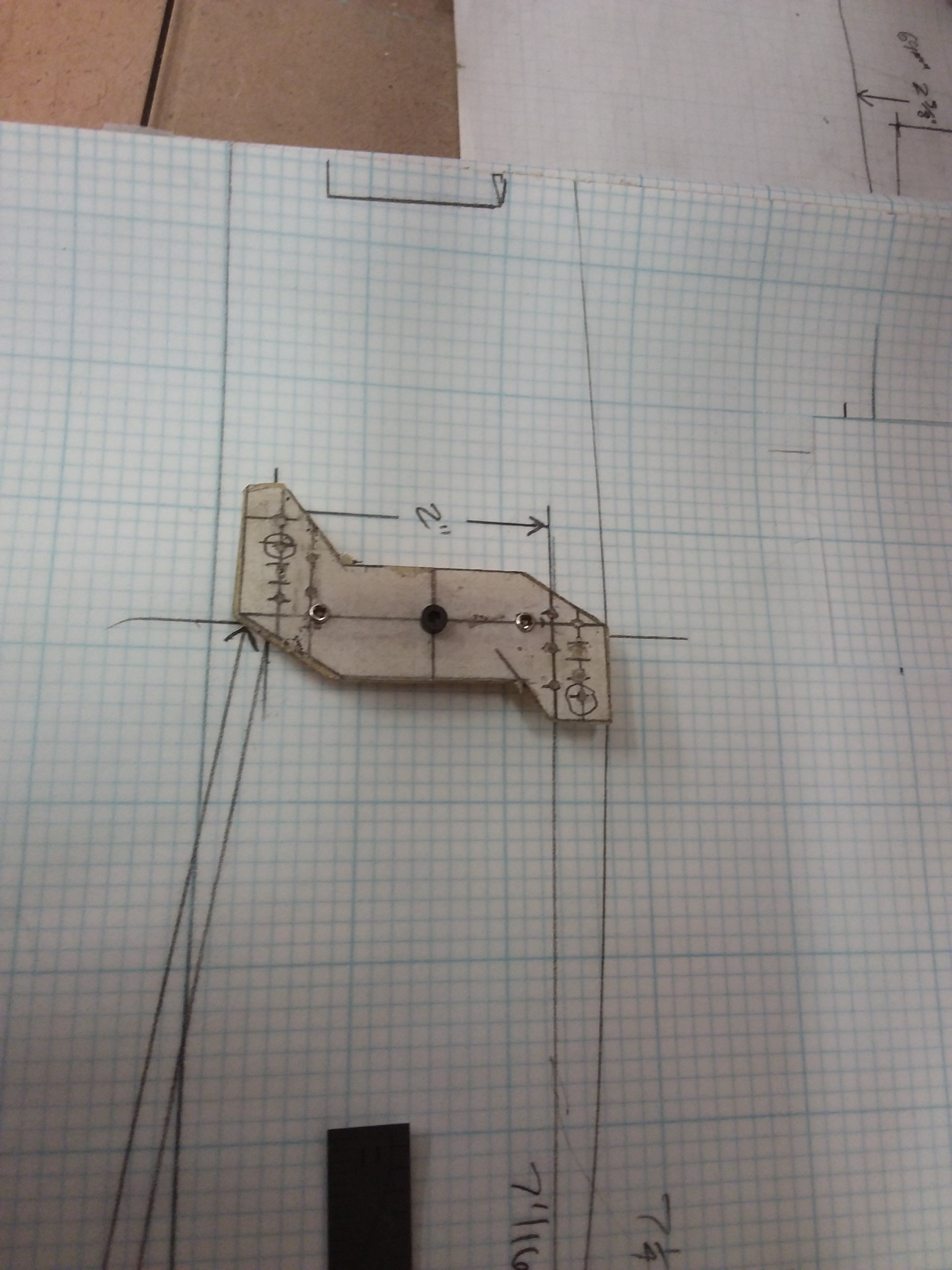

Offset servo idea by the step. A piece of G10 makes an excellent custom servo arm. No idea if this will work.
There's the 1" +/- difference.
