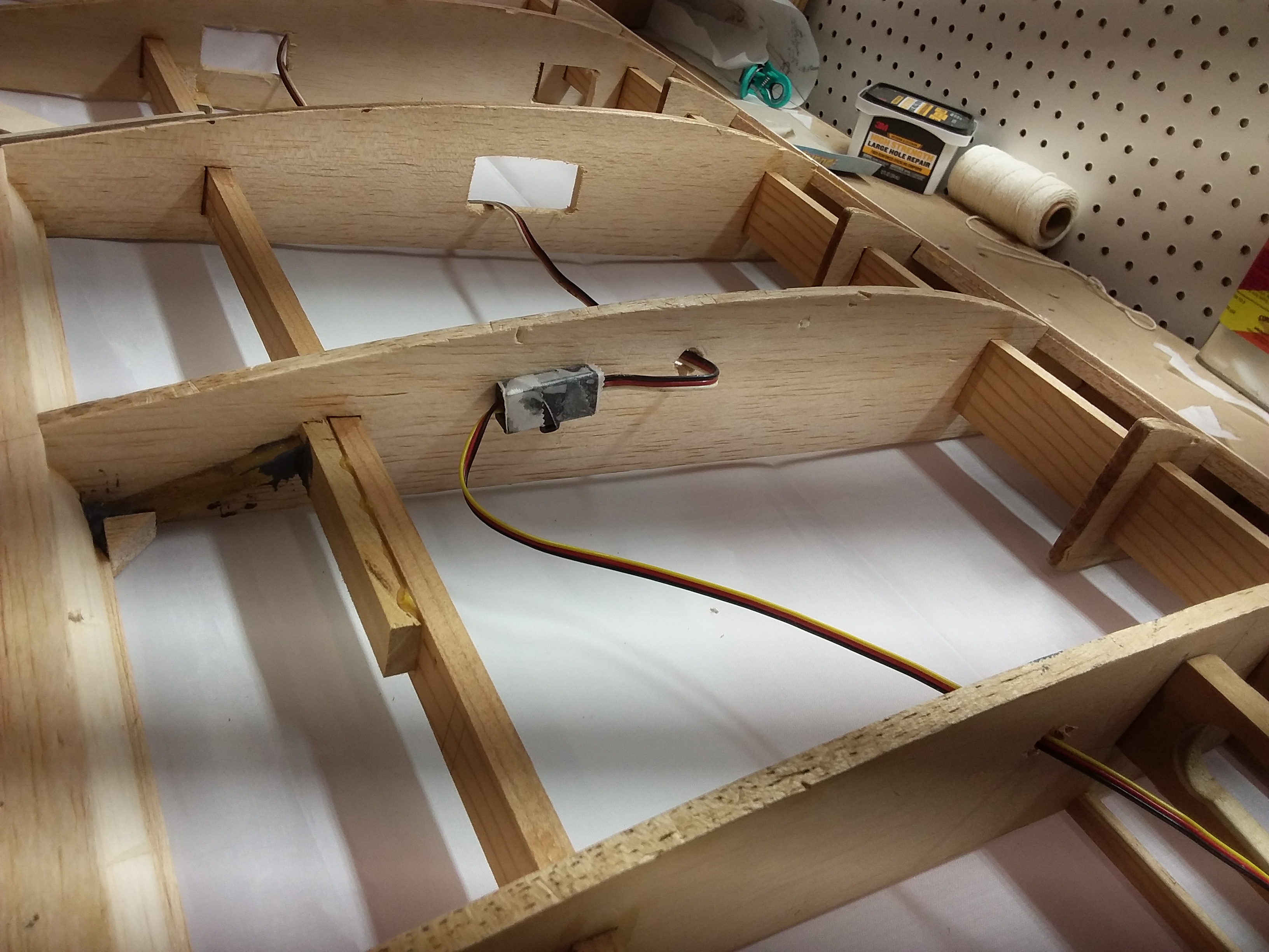

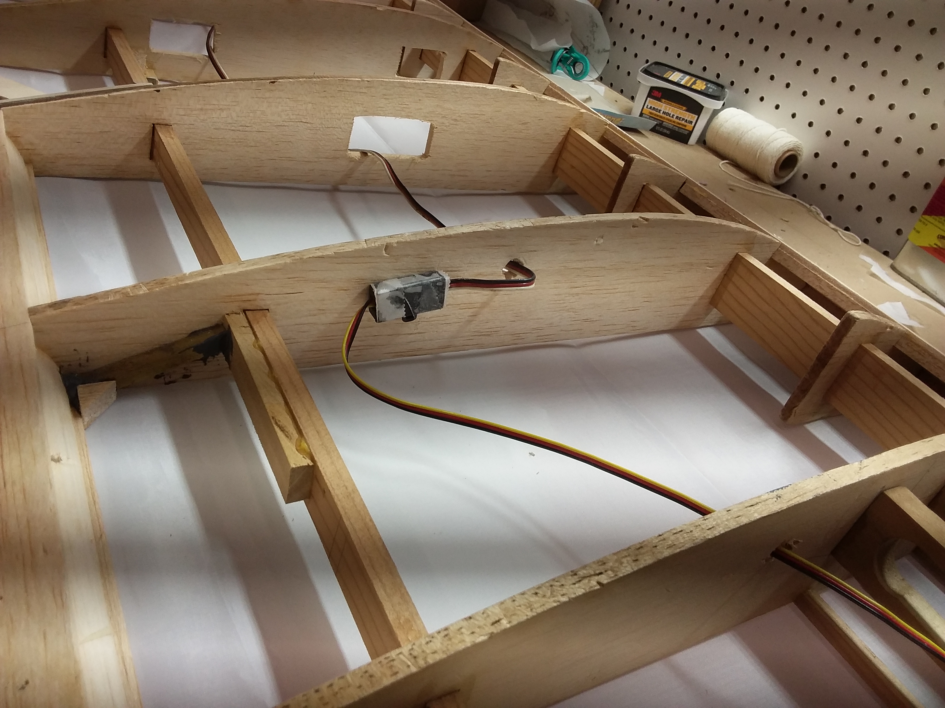

Just for future reference.

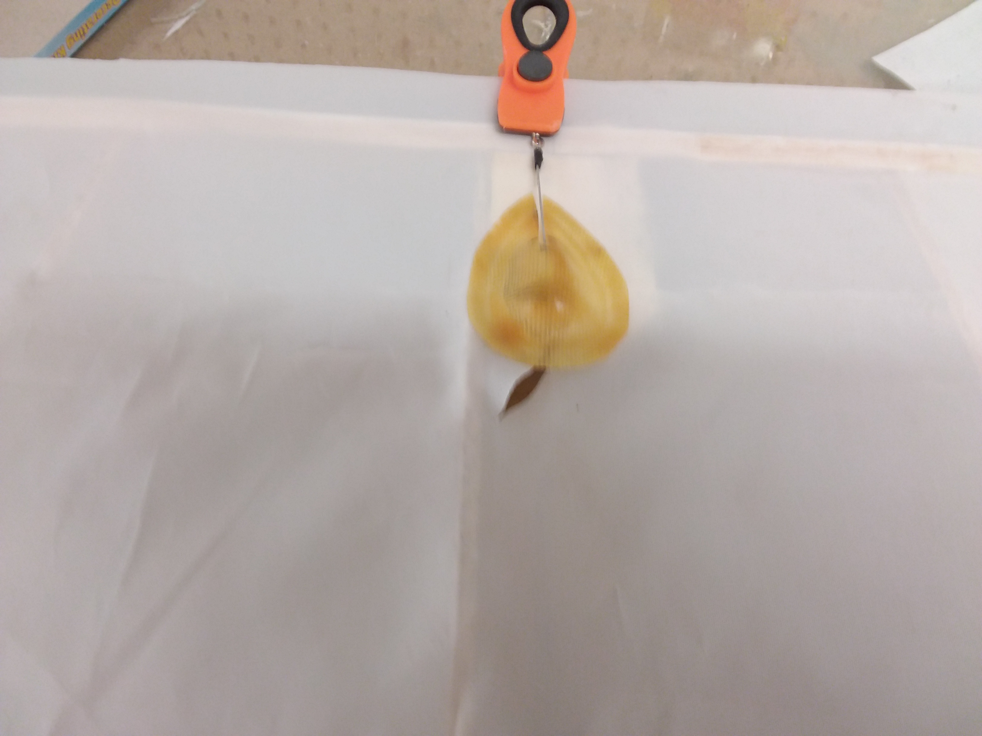

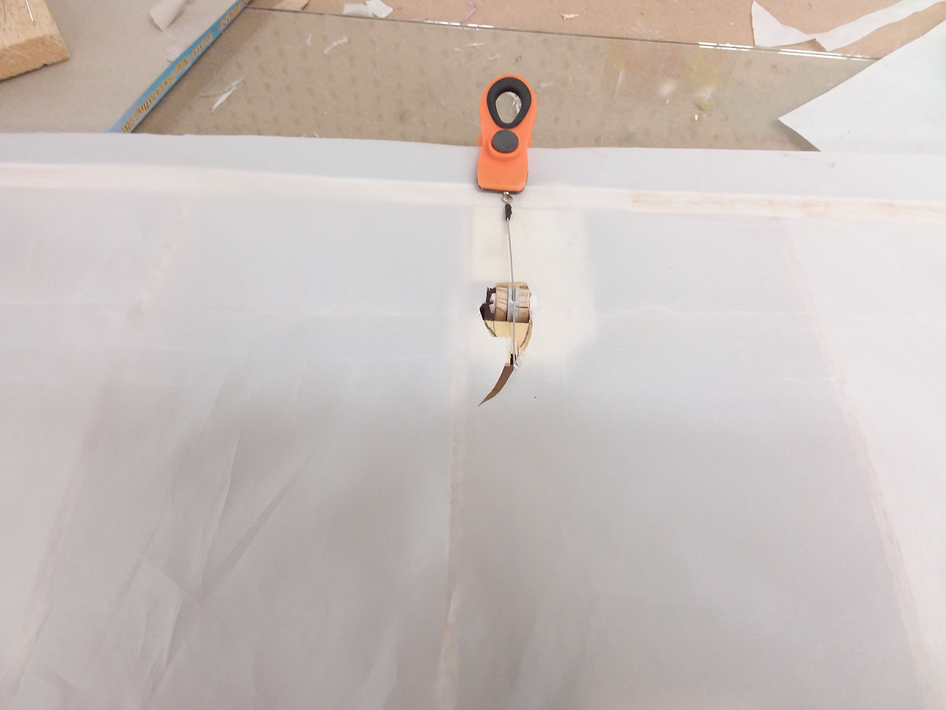

Well that sucks. Cutting covering for the aileron control cable and crap.......
Patch it or replace top piece?

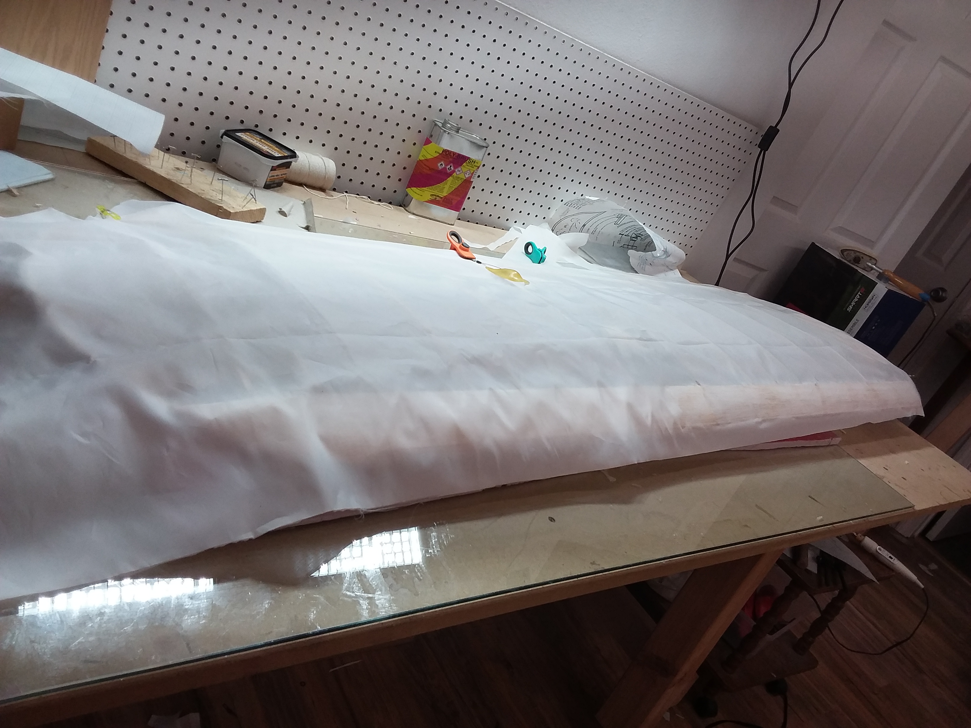

5 minutes of softening the Poly Tak with mek and the damaged top piece removed easily. Another 15 minutes and a new piece was underway.
