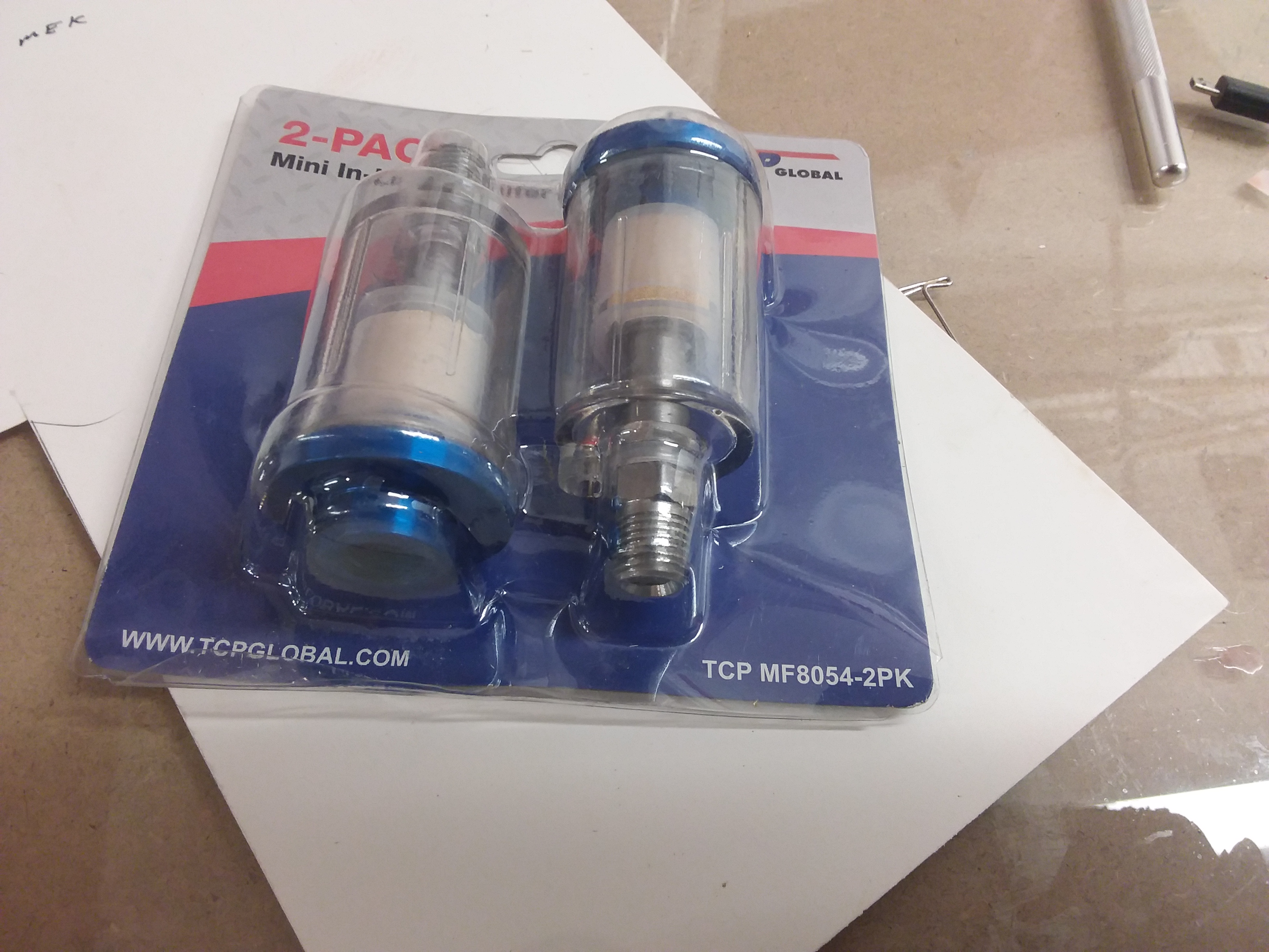

More minor content. Fresh filters for my hvlp spray gun.....

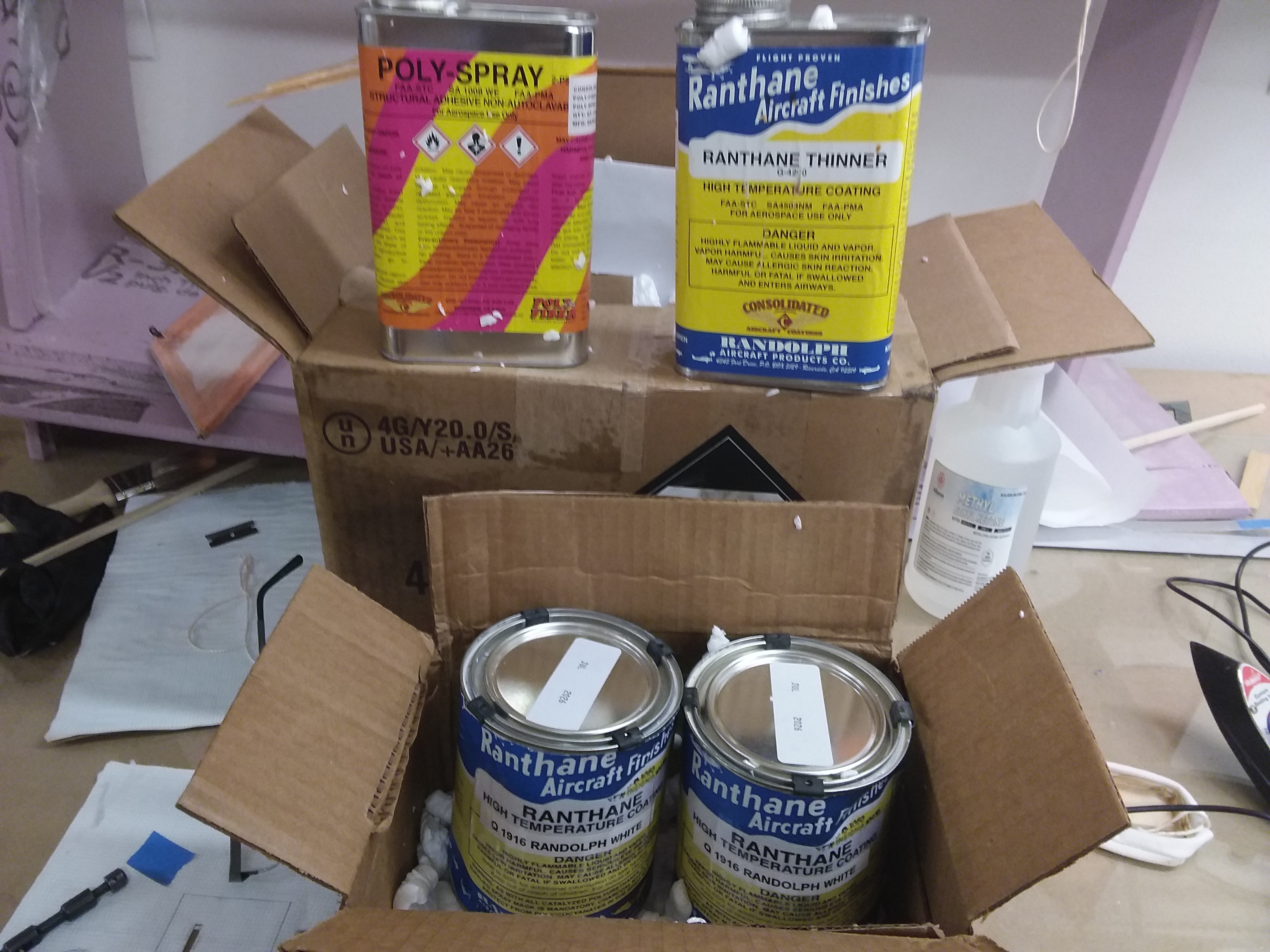

From Stits:
Quart Components:
  • One quart Ranthane polyurethane paint
  • One pint AU-2X1 Catalyst
  • One quart G-4200 Ranthane Thinner. These components will yield over two quarts of sprayable Ranthane.
I need:
2 (i hope) quarts of PolySpray @ $72 total
3 - Qt’s of paint (2 white and 1 red) @ $100 a qt = $300
3 - qt’s of thinner @ $72 total
1.5 qt’s of catalyst @ $150 total
Or about $576 plus tax/shipping……. :thumbsdown:

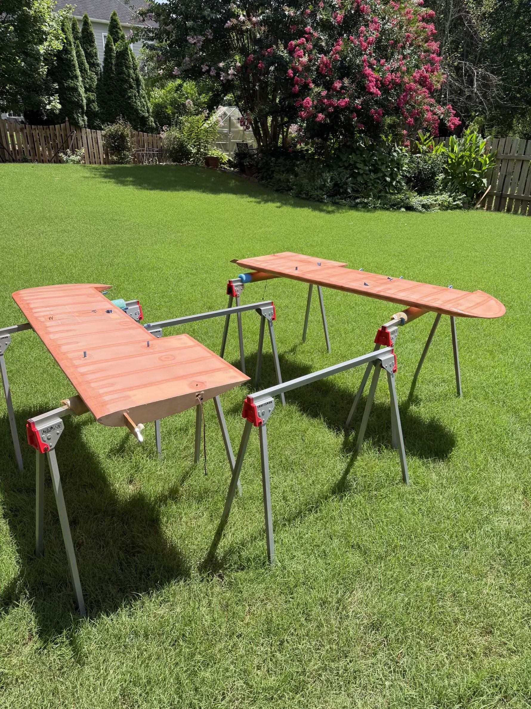

Rain canceled my day at the airfield. Again. Got in another round of Poly Spray though. Good practice as the Poly Spray can be wiped clean with MEK if I screw up. Mental notes for the upcoming painting were forming right and left. I think I can build a large sized spray room under my deck as a clean final paint environment is imperative. I’ve ordered more lights and a large roll of heavy plastic.
To be continued…….
You would not do that in the are I live in it would be covered in tiny little flying insects. They are just awful and will destroy a paint job in minutes.
You weren’t wrong Snoopy1. As the Poly Brush builds up the specks and dog hair does as well. It is time for a paint booth. Minor dust specks and dog hair can be cleaned now but not later…
