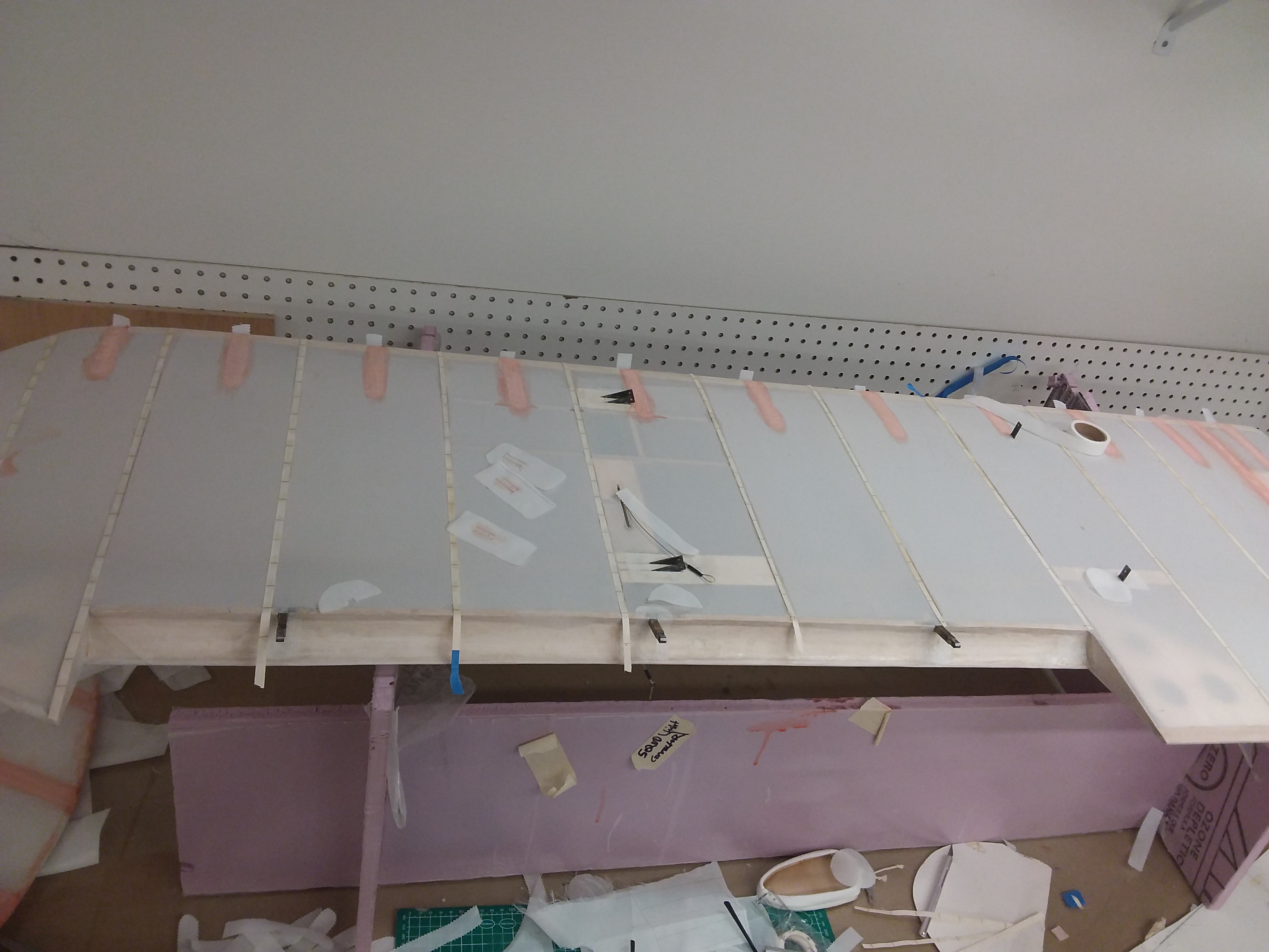

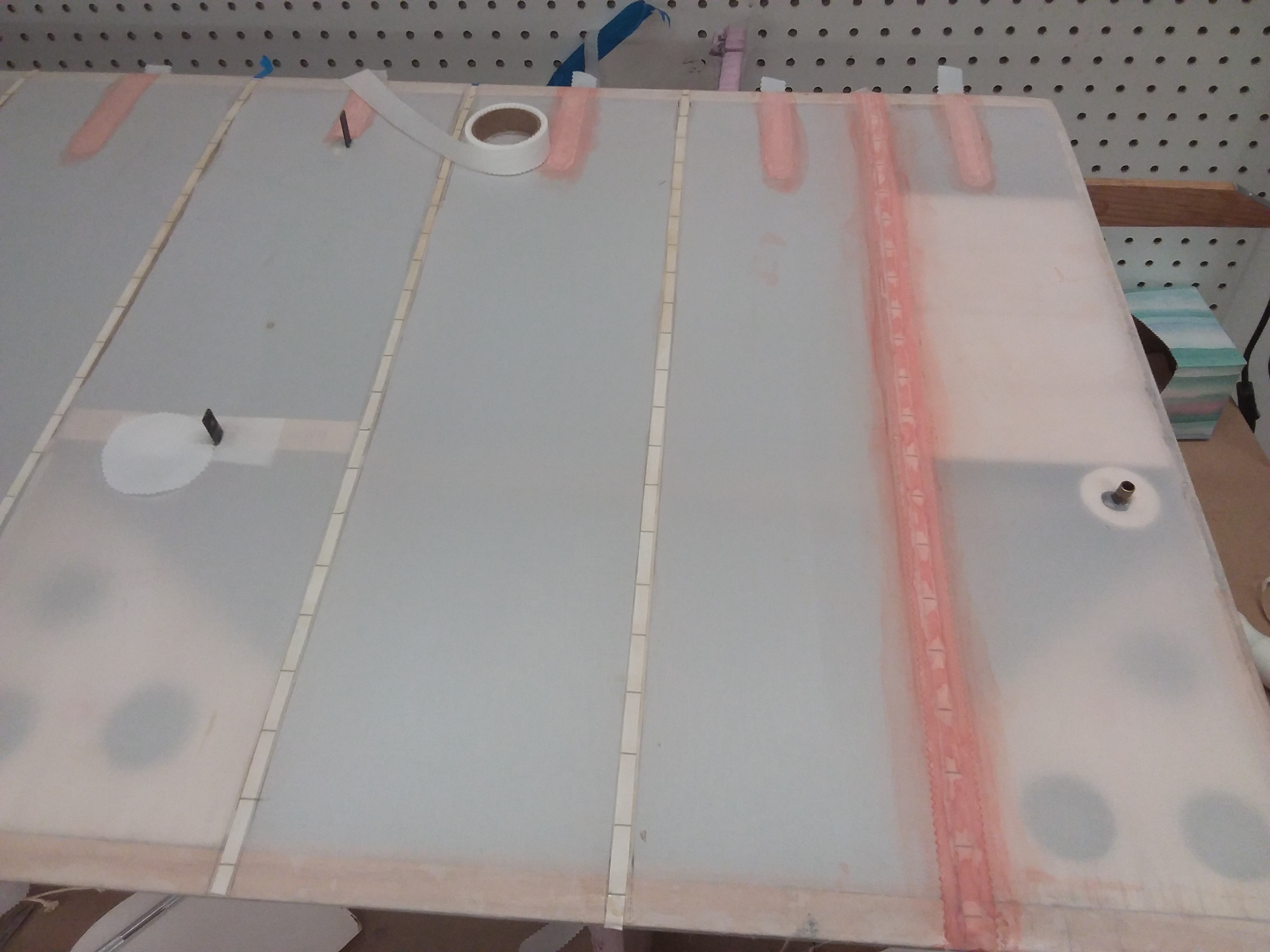

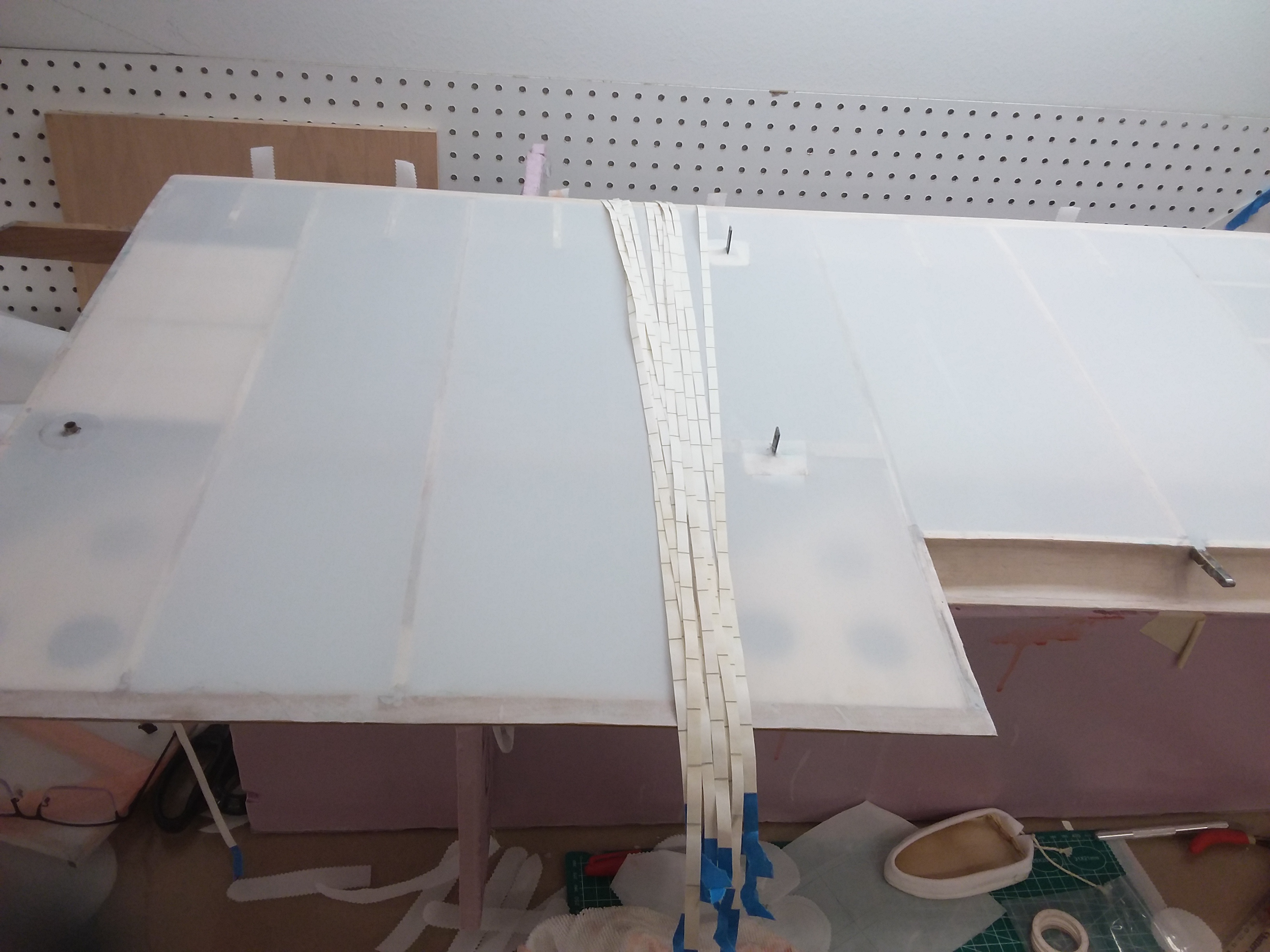

Agree on stitch strip width equaling rib. Still on the thread idea.
acerc

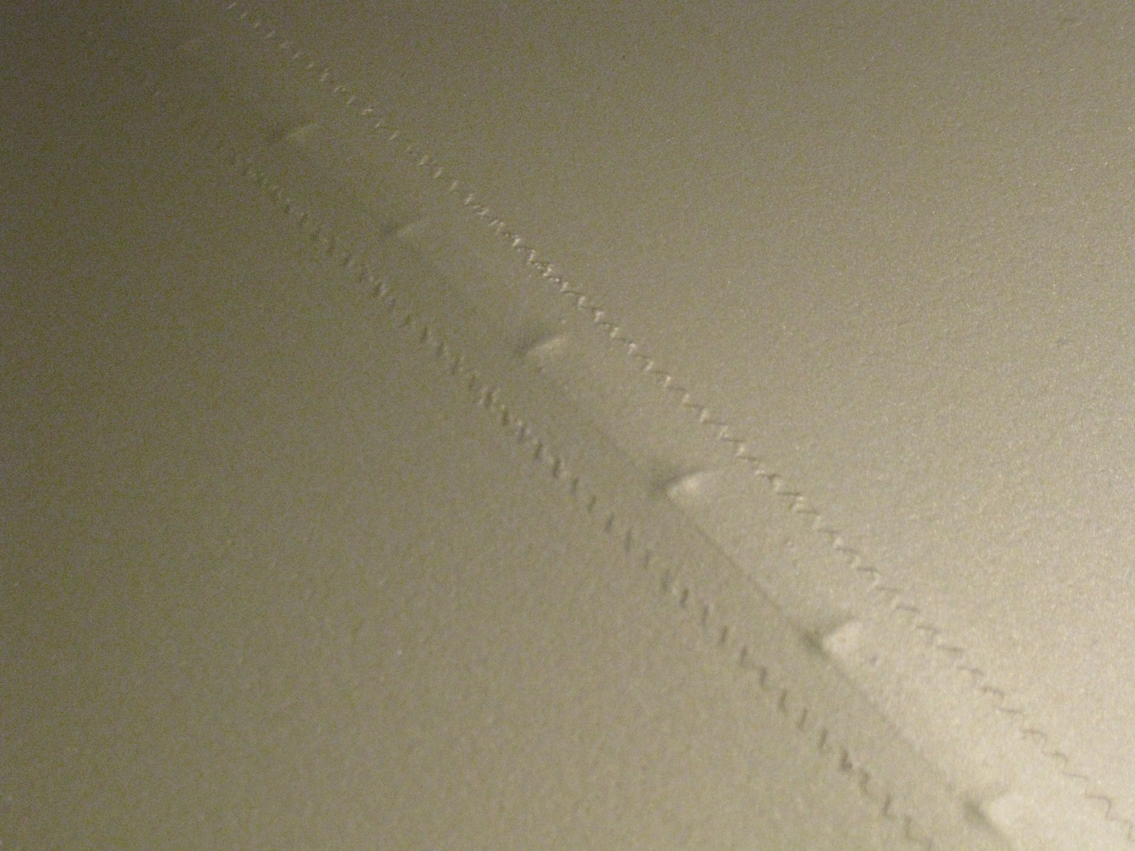

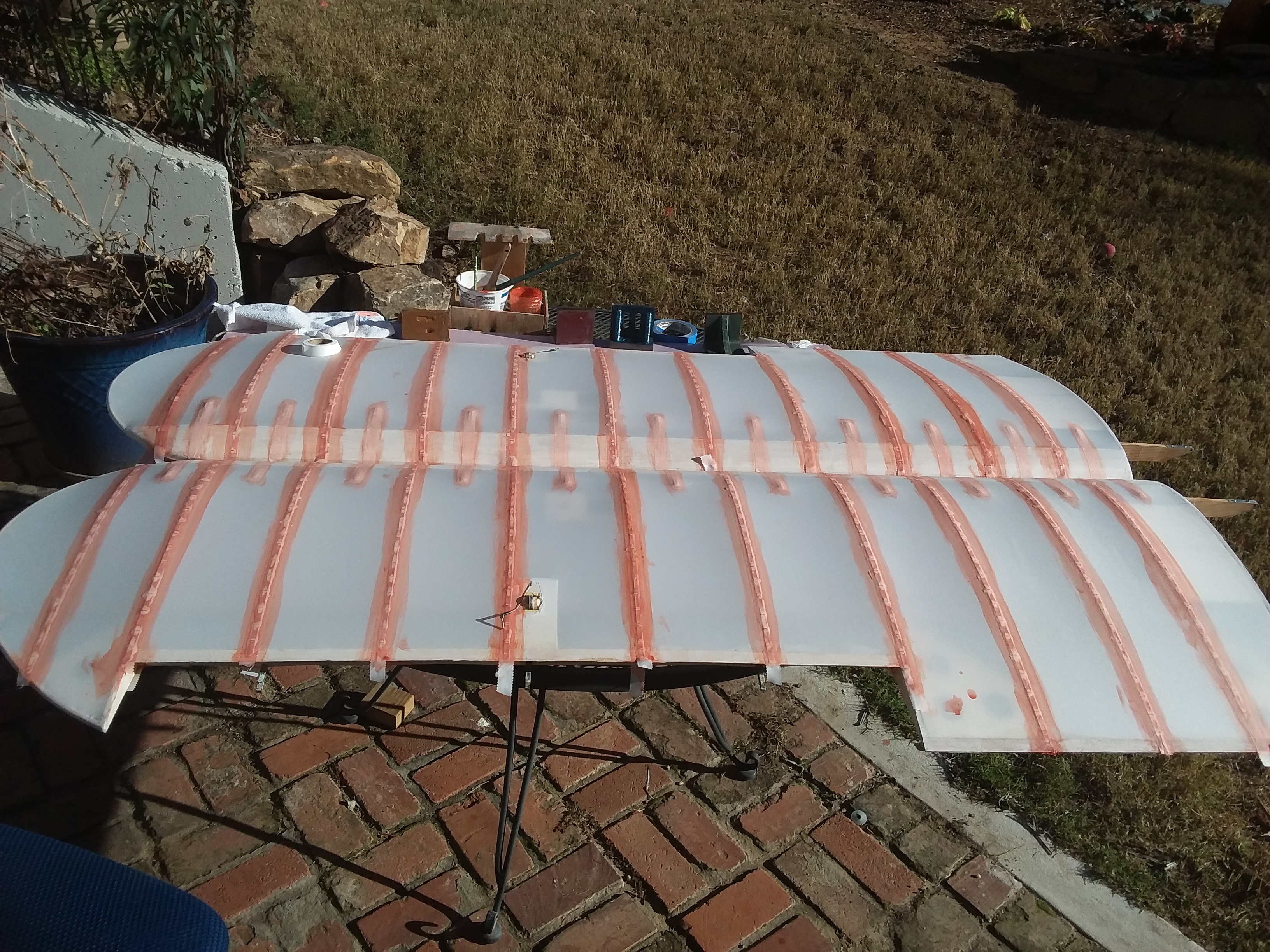

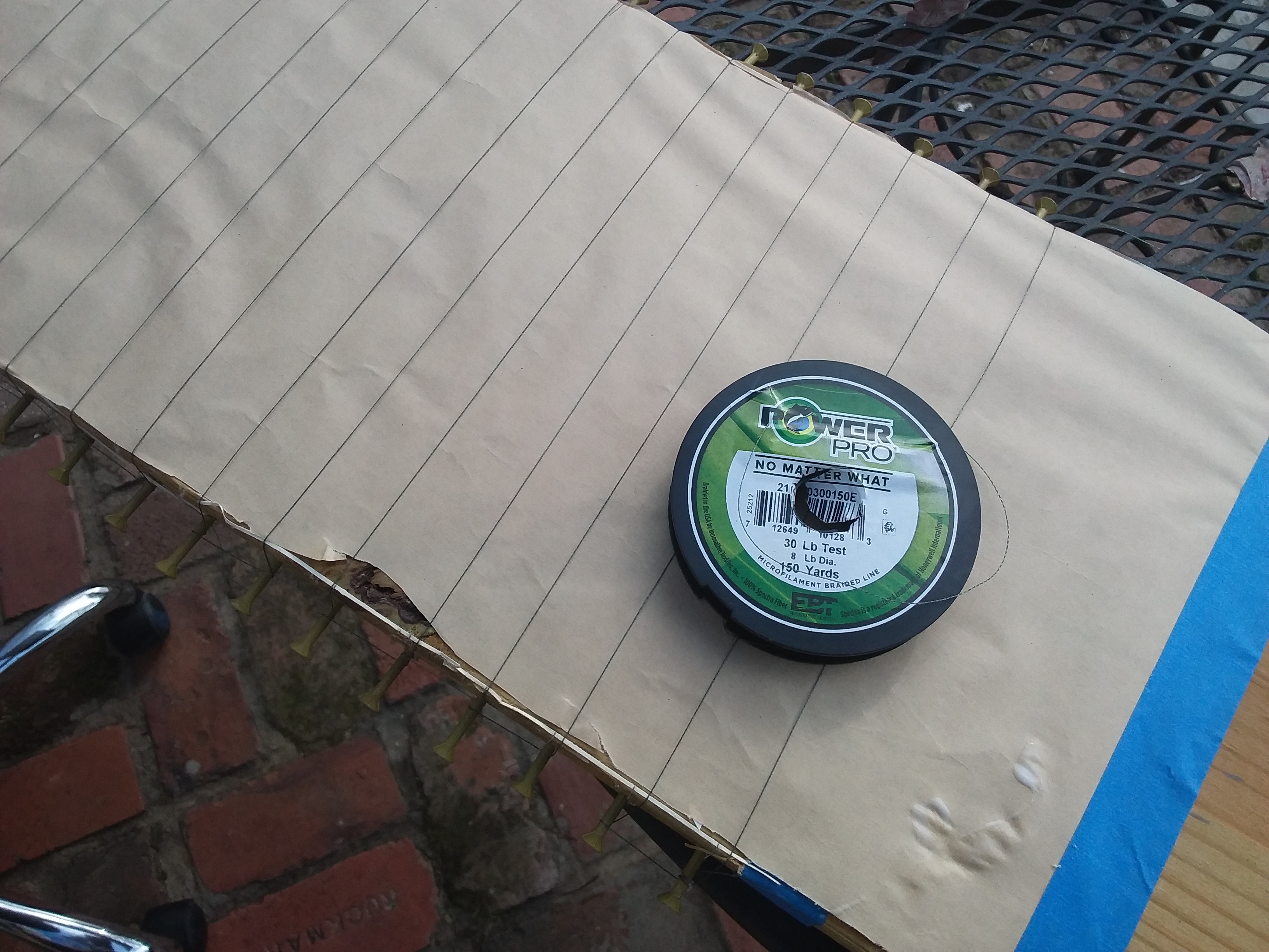

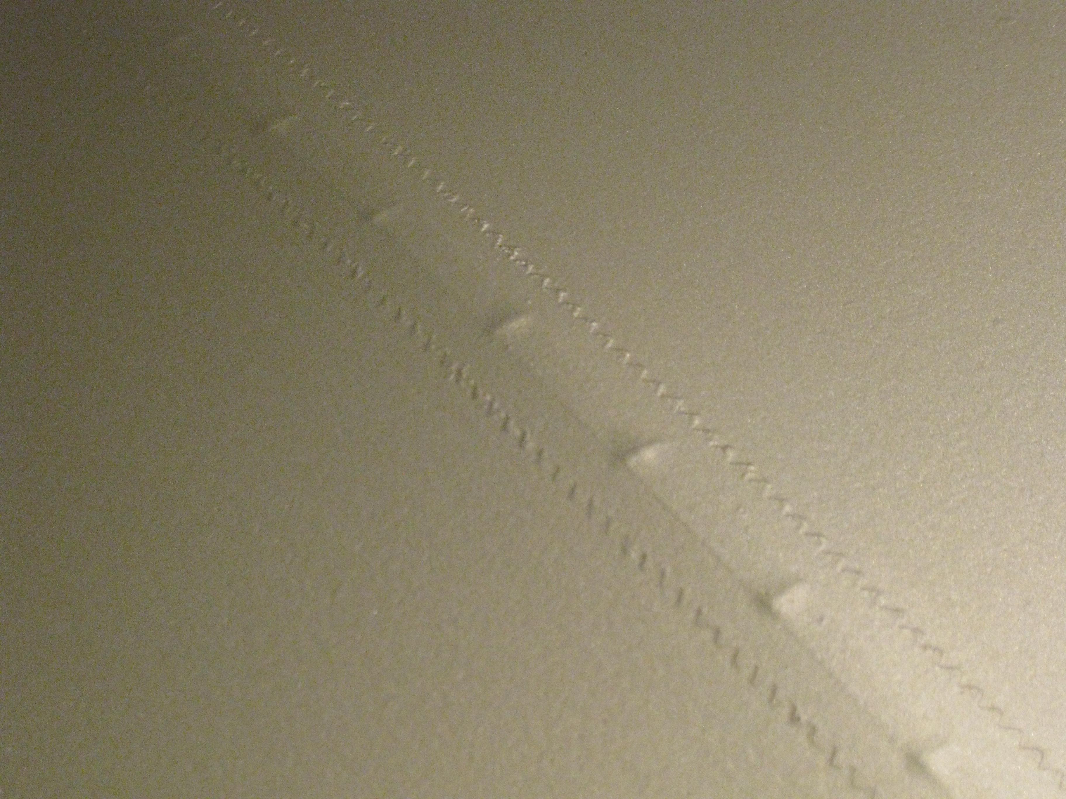

Back when I built the Pitts I went and learned the rib stitching process. I did that on the Pitts wings, and the stitch completely disappeared, like there was none there. Removed the covering and did it again with the fishing line method, worked perfectly. Have used fishing line ever since.

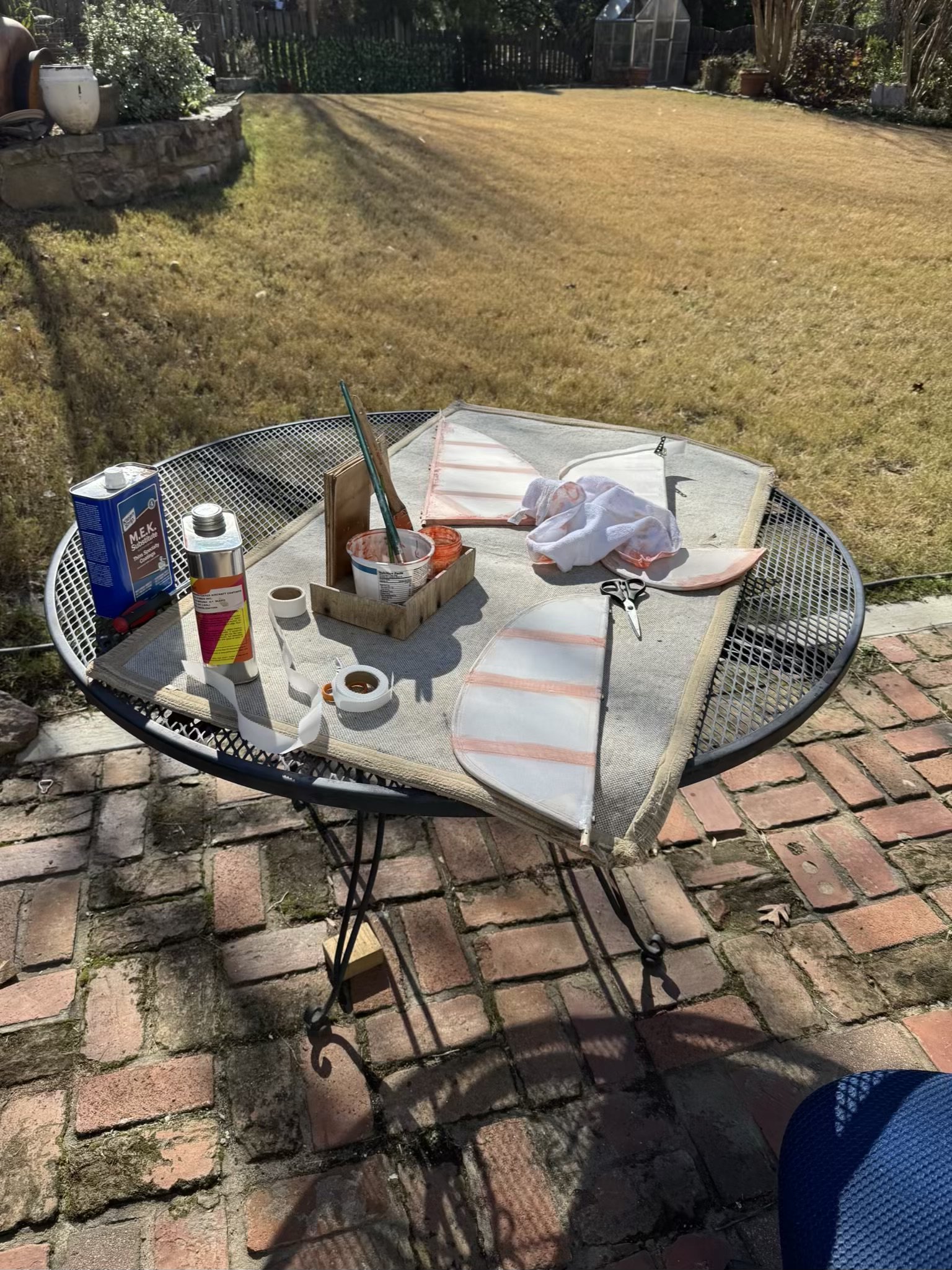

Weather is cooling fast. I couldn’t get the poly spray to stick as easily this morning plus is was windy. I think I will relocate the Cub to my shop hobby room this winter….
