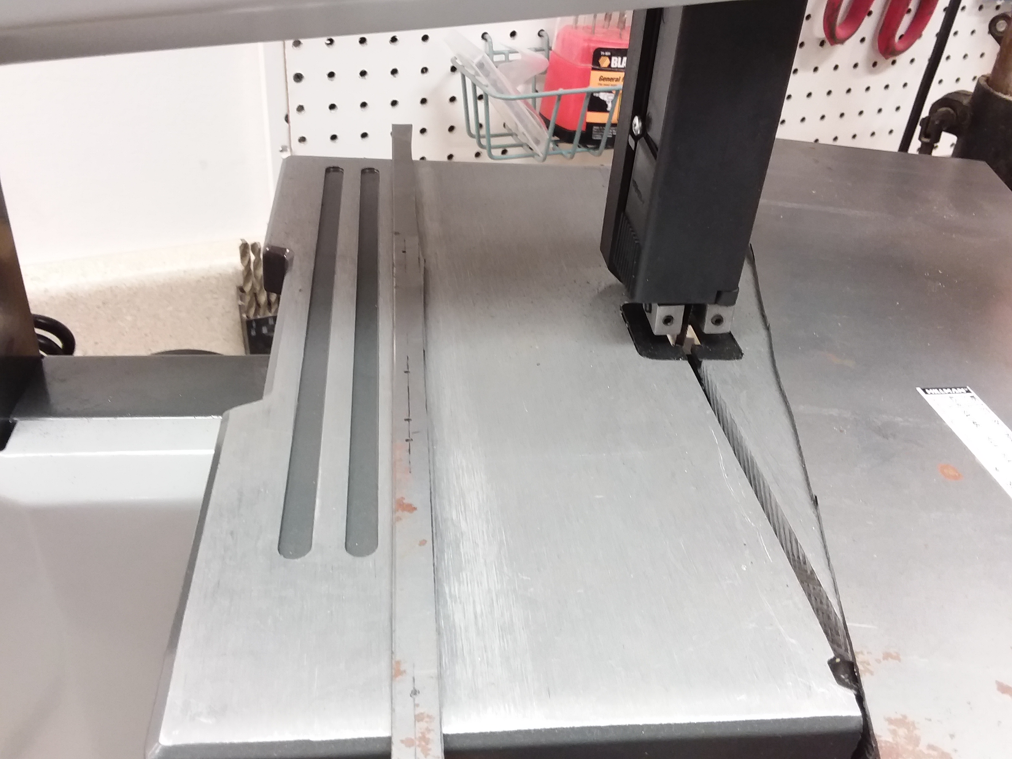

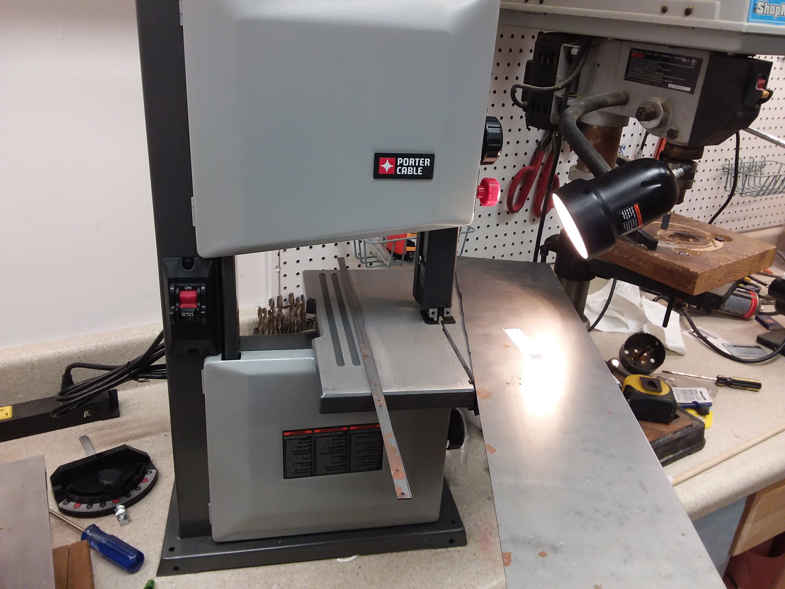

I bought a piece of junk mini bandsaw for a $110 and went to work. This thing won't cut straight for an 1/8".
If I may suggest if a band saw is not cutting straight it could be several things doing it.
1 the guides are not set tight enough. Top and bottom.
2 the blaze is to narrow . New wider blade
3 tension to low.
4 wrong blade for the material or blunt or just a bad cheap blade. New blade.
5. If it always pulls to the same side then the teeth are not set right. New blade.
3 tension to low.
Side guides are tight but slightly too far back, as far forward as I can get them.
Blade is 18tpi x 3/8" and brand new.
Tension is maxed.
Saw is cheap but I needed a saw today. Proxxon or other better saw another day maybe.
