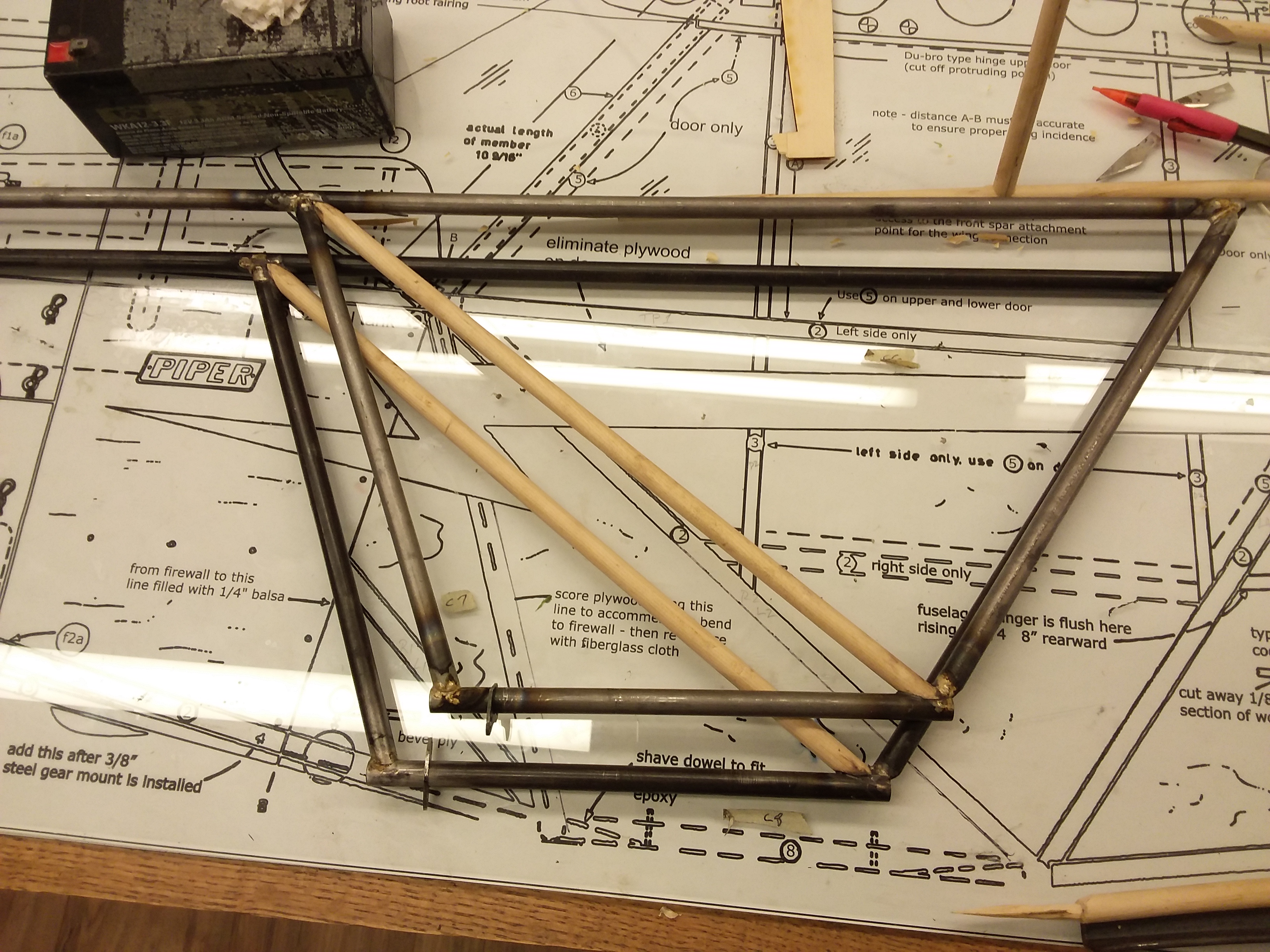

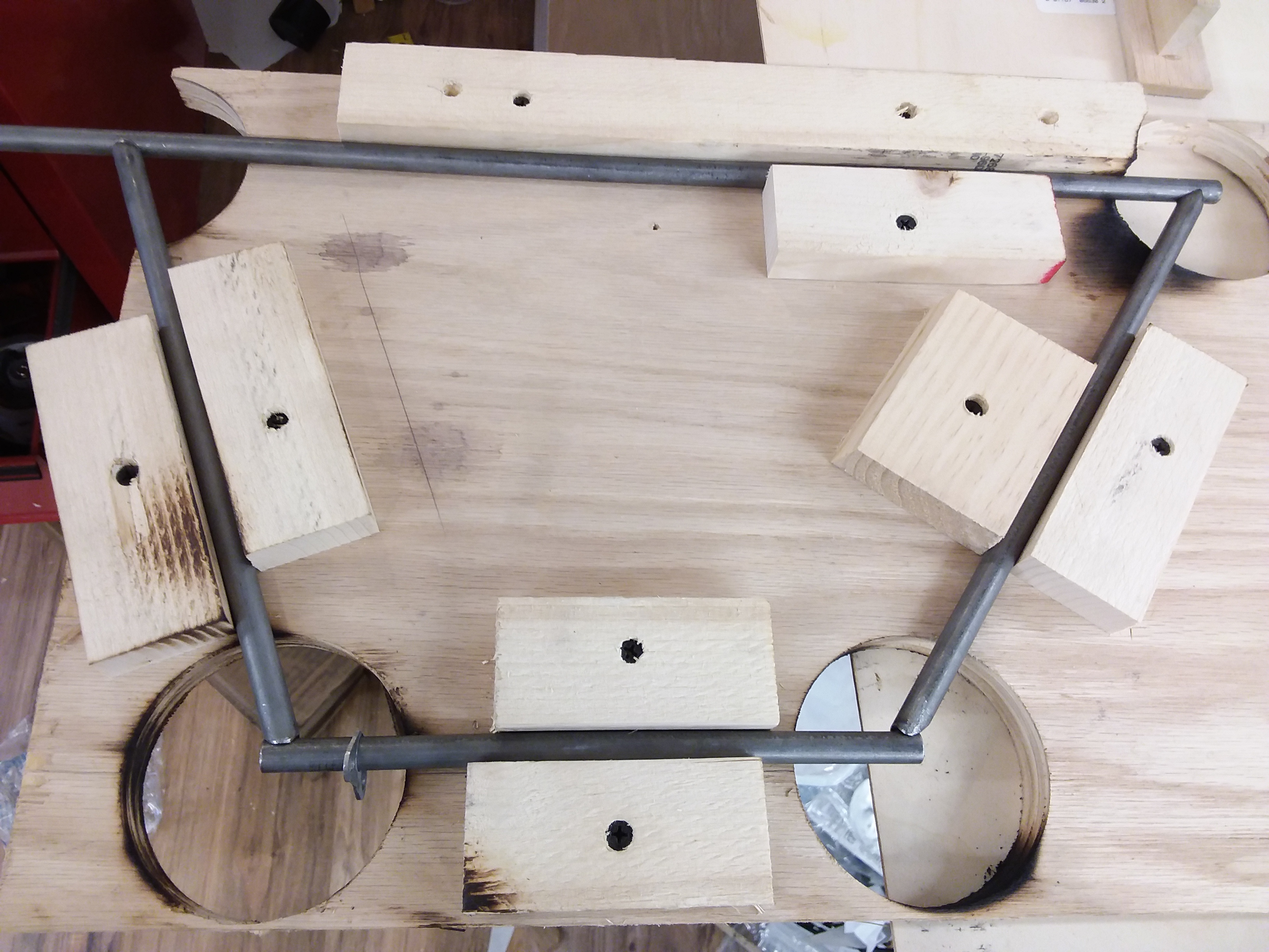

Agree on that get it all jigged together twisted straight and square then add all the gussets as required.

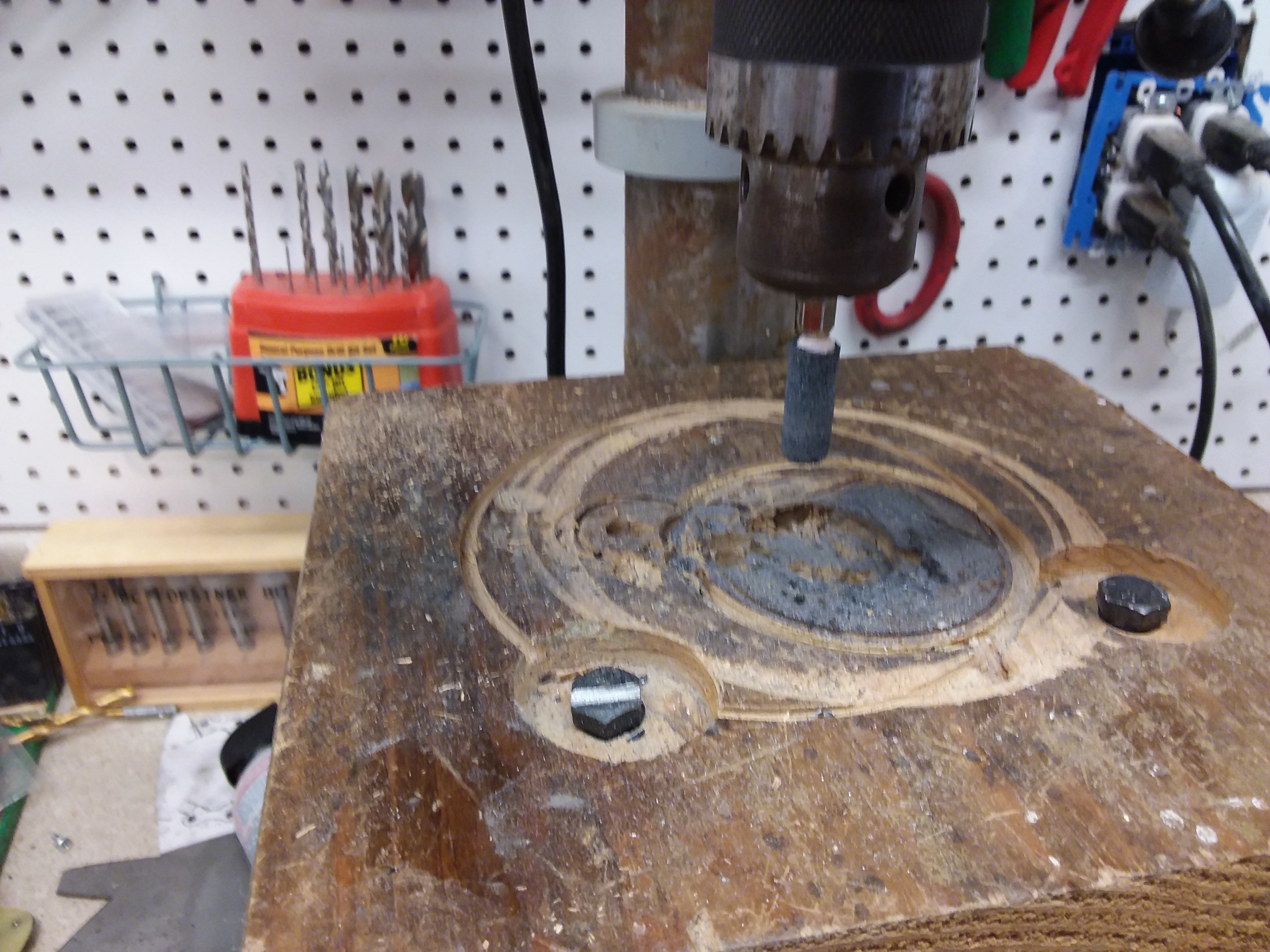

You are getting faster with coped ends, what process did you end up with?

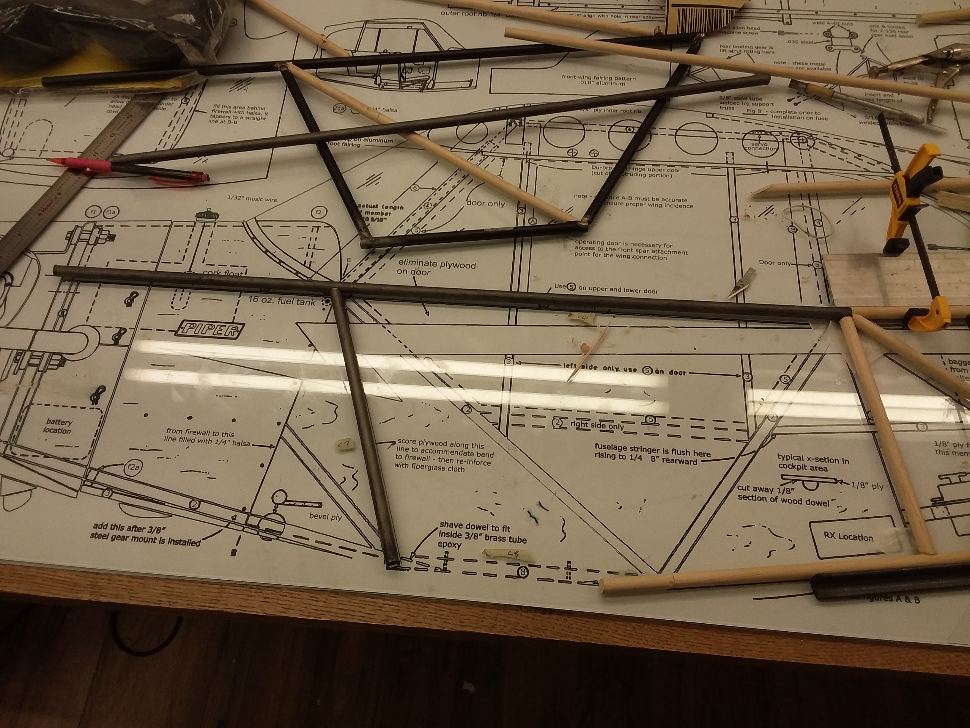

Both sides look the same, how about the door?
Tony, grinding a bevel in the steel then rounding it with a round grinder in my drill press.
