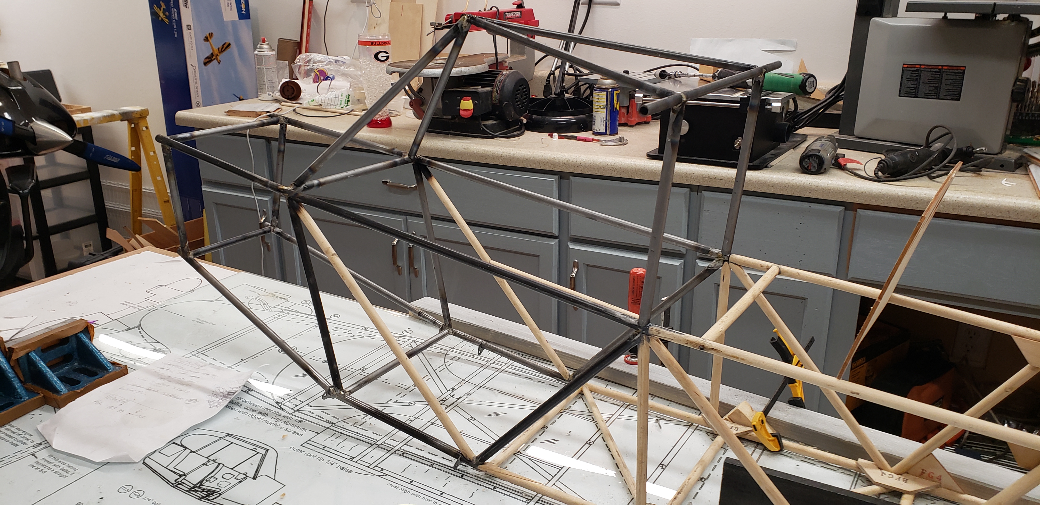

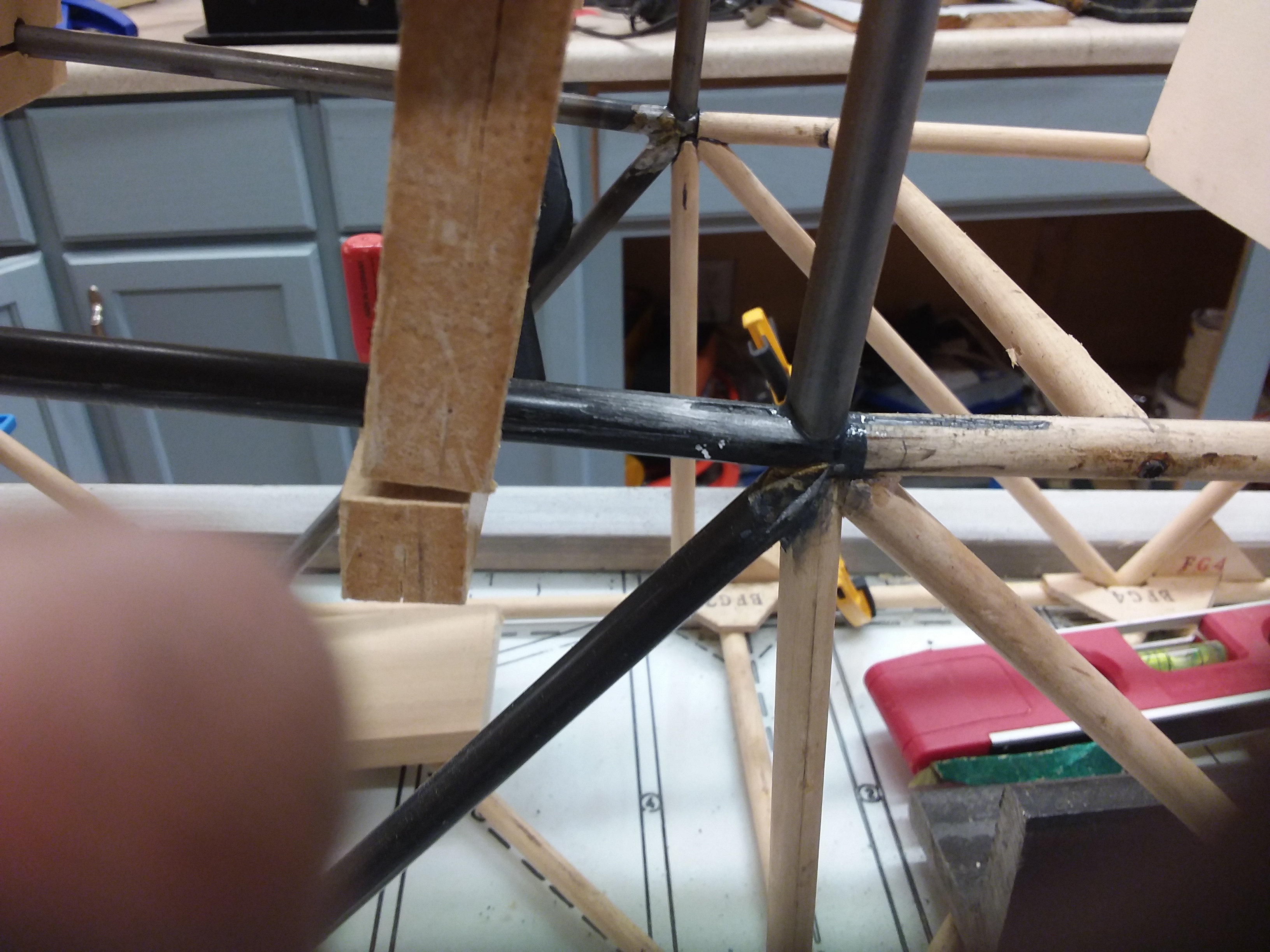

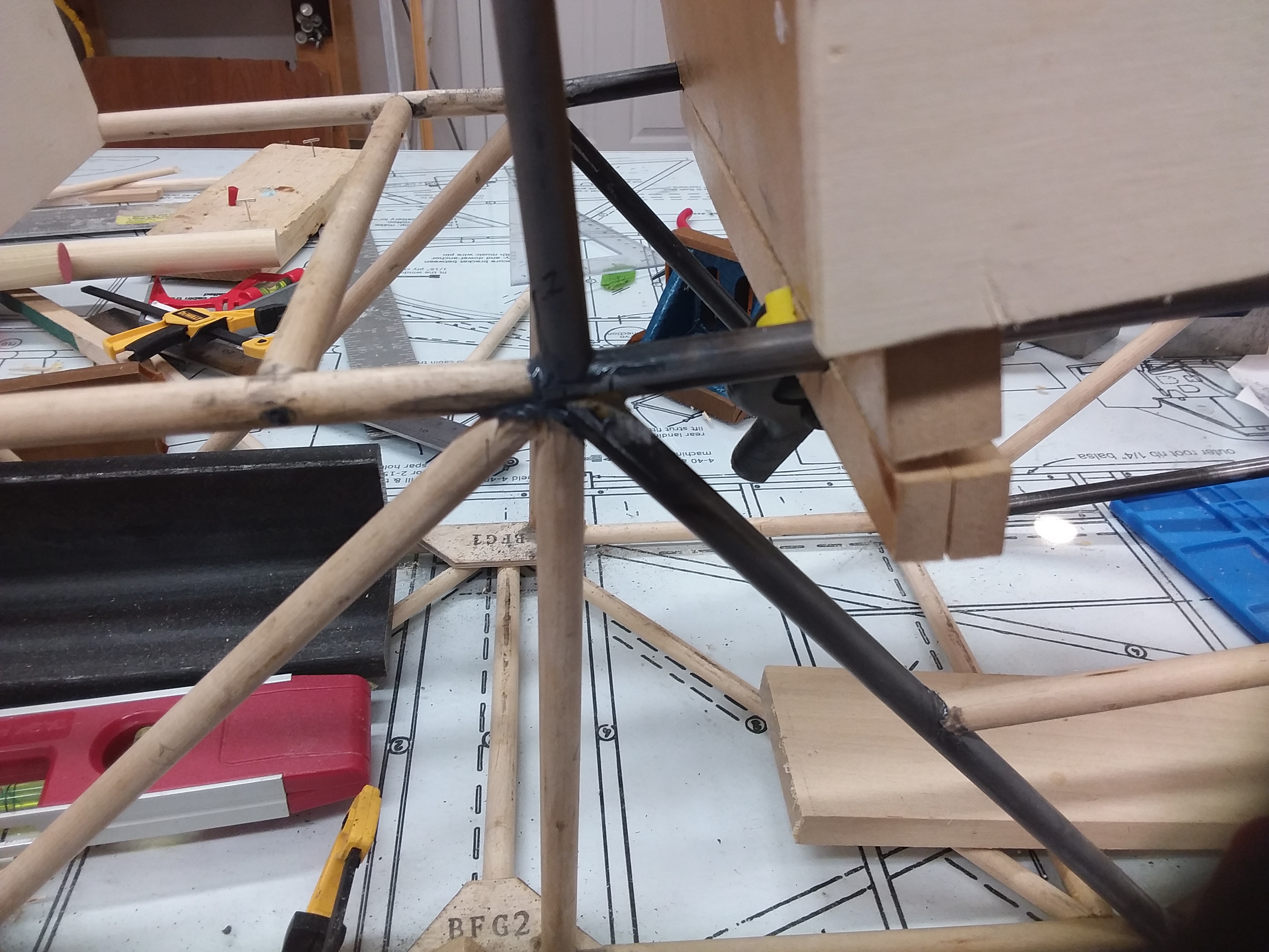

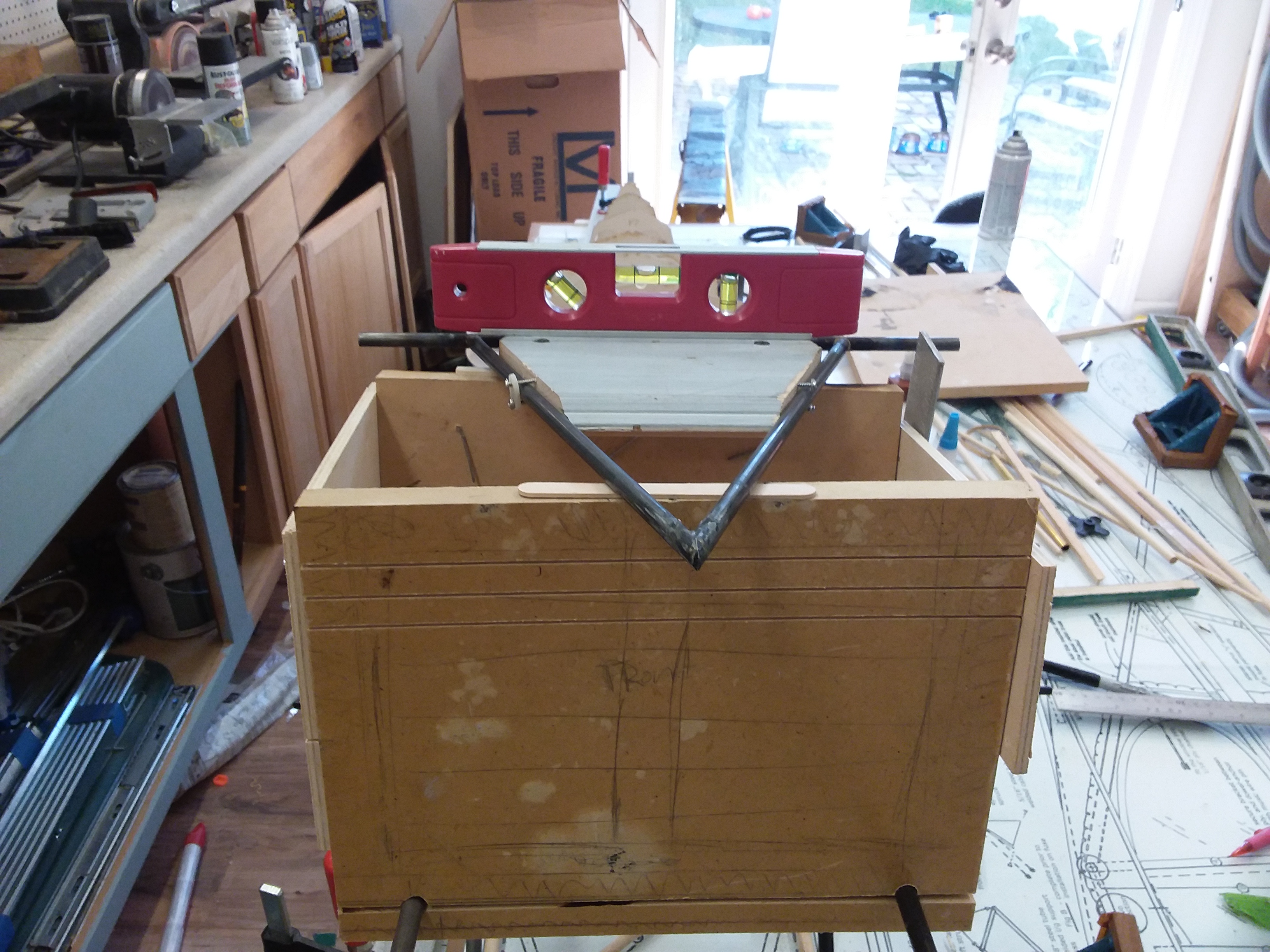

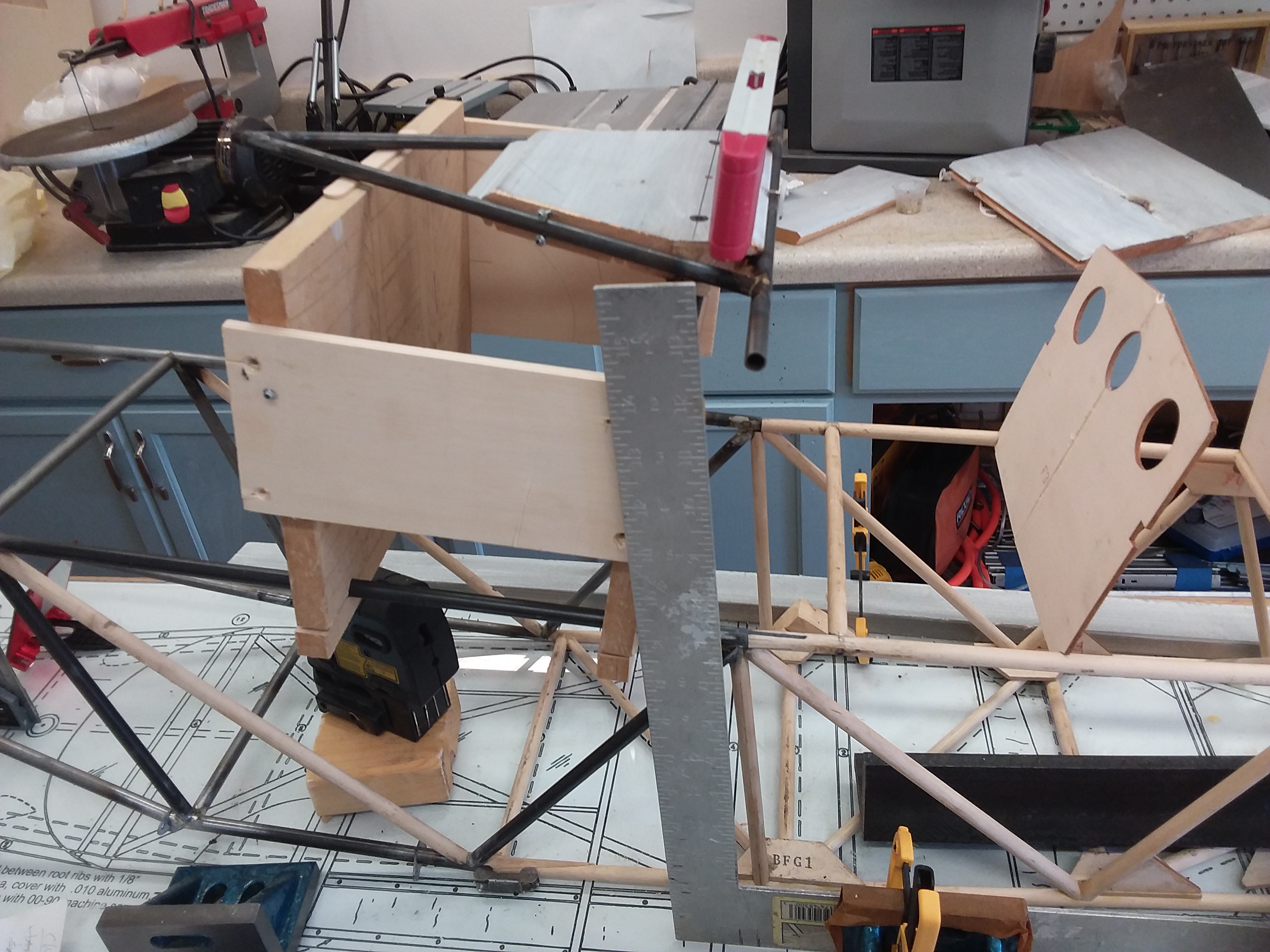

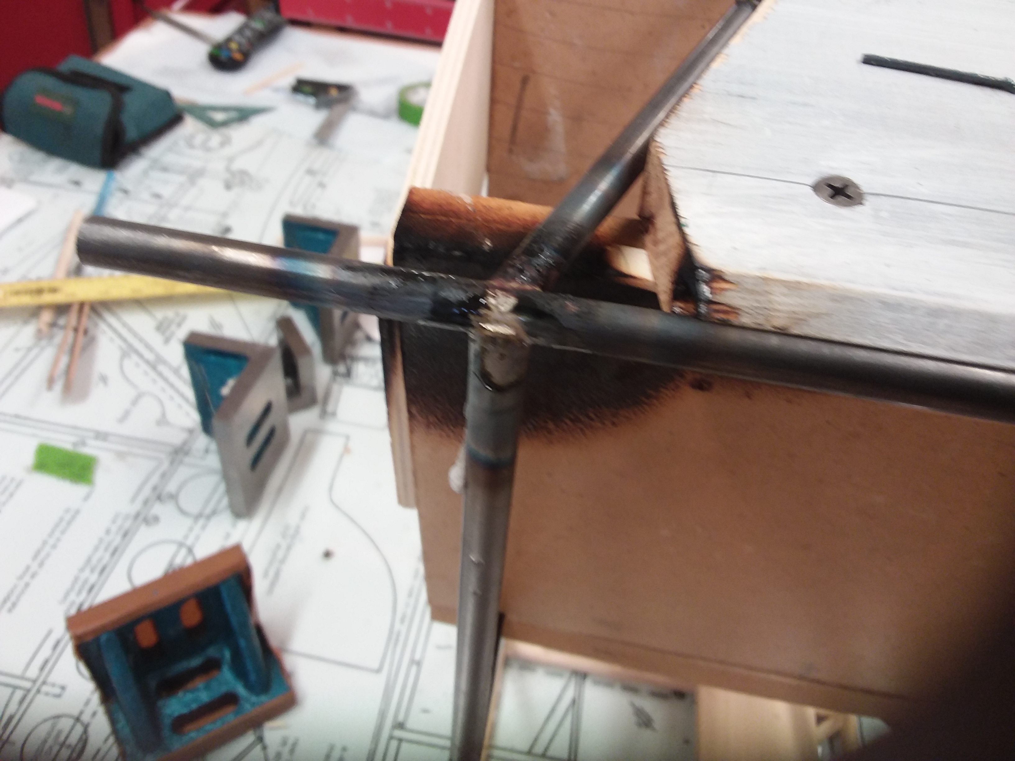

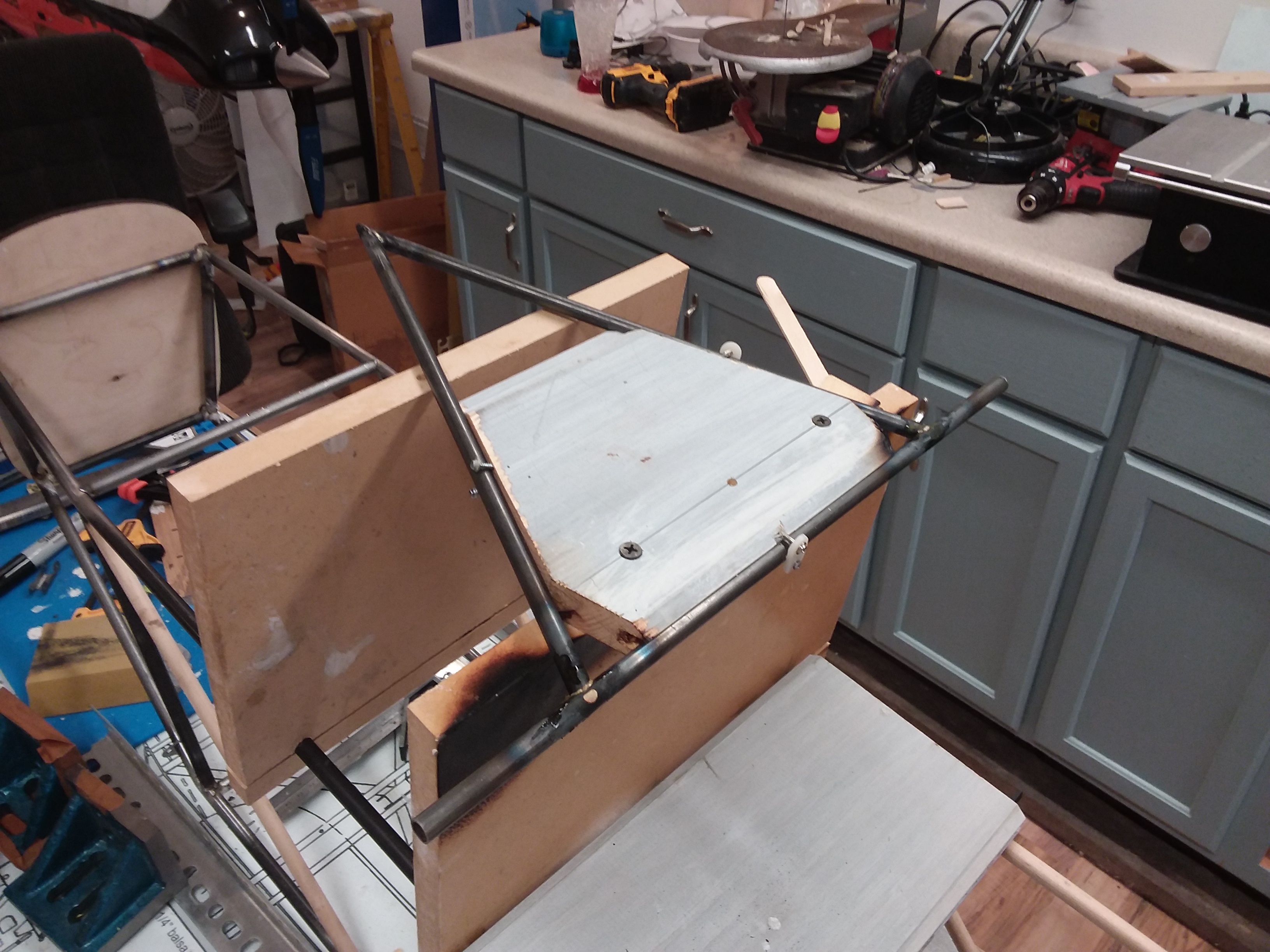

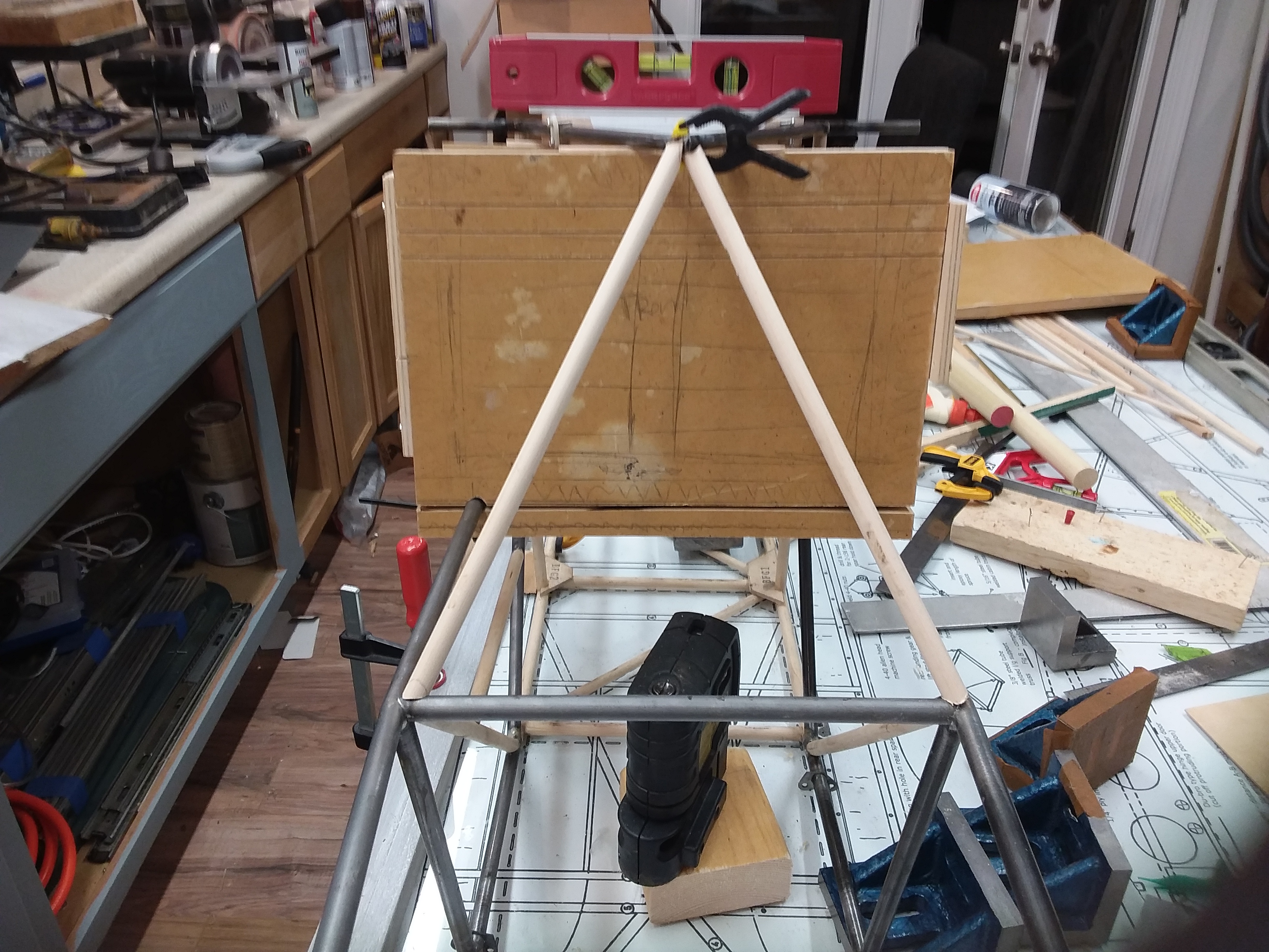

Trying to frame the entire cabin assembly all at once looked like a pain so soldered the 3 areas I had so far.

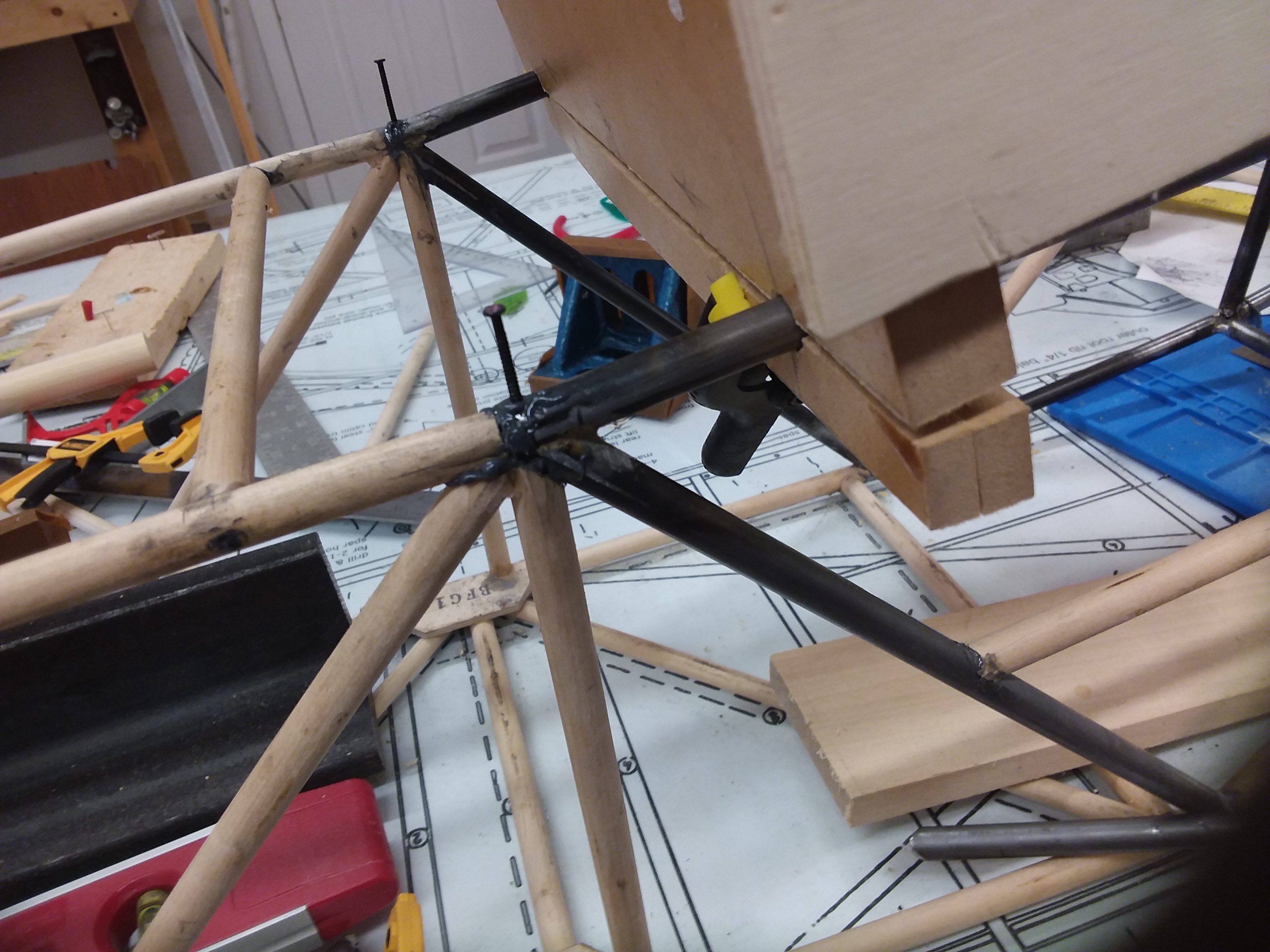

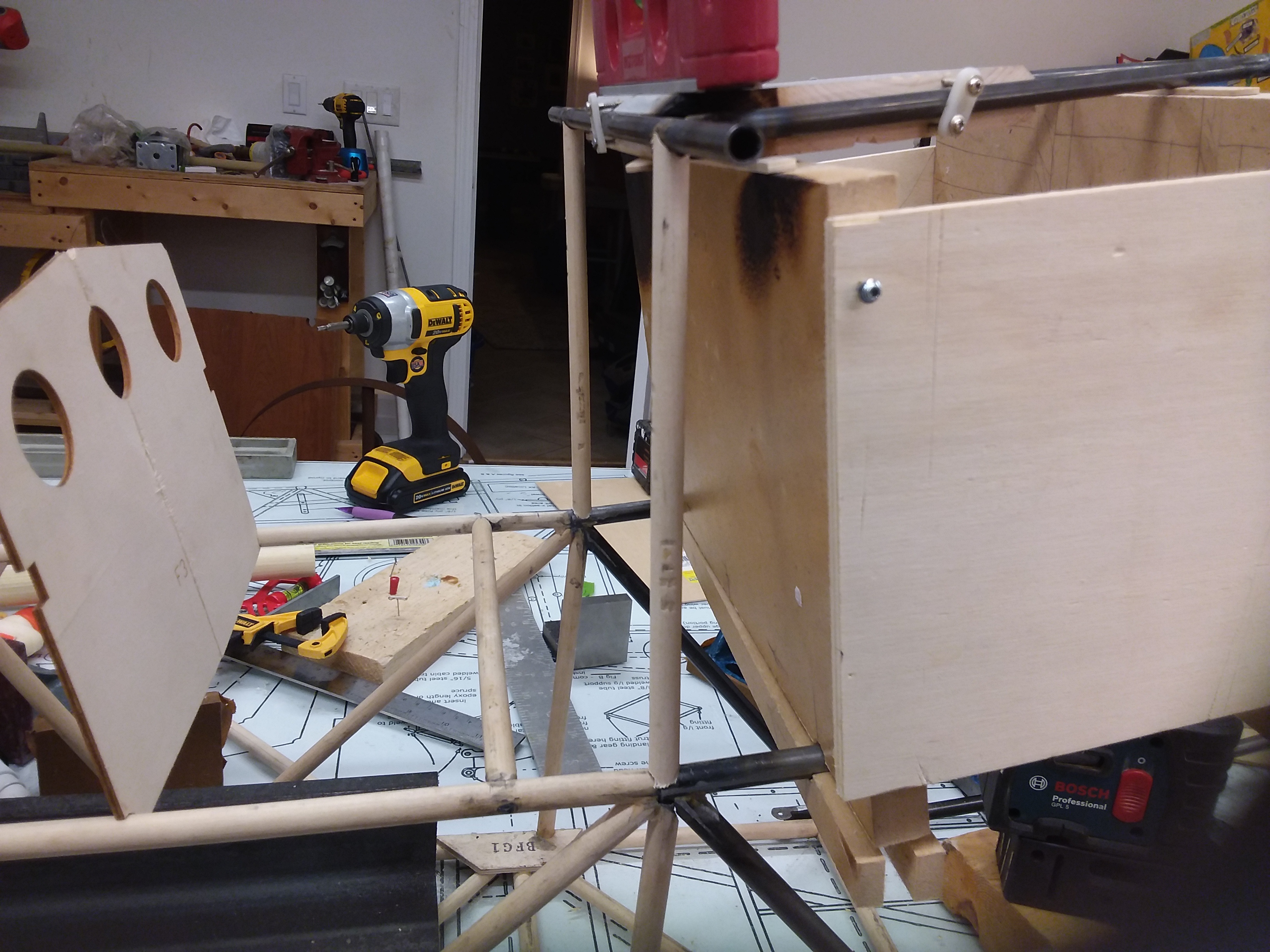

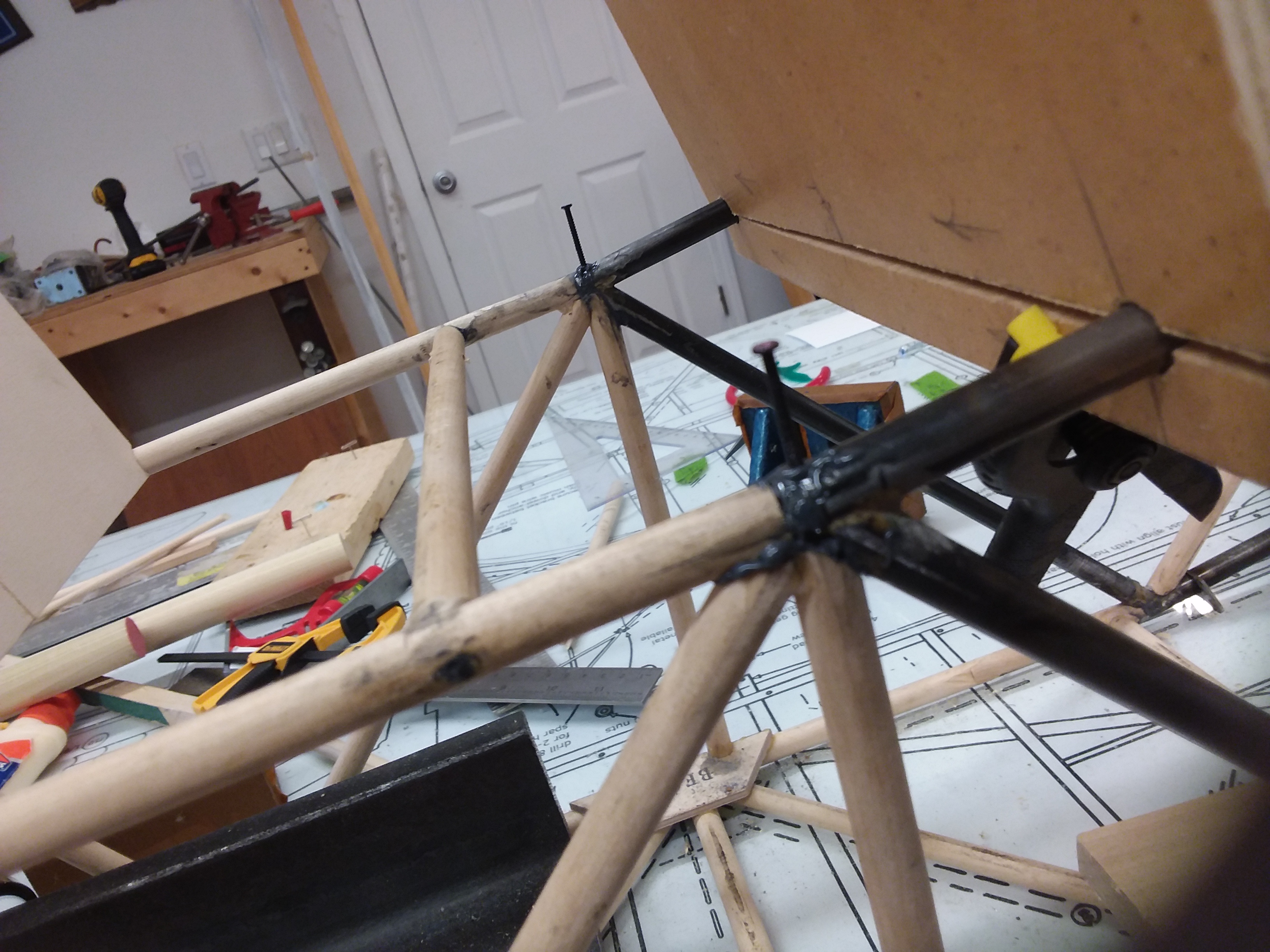

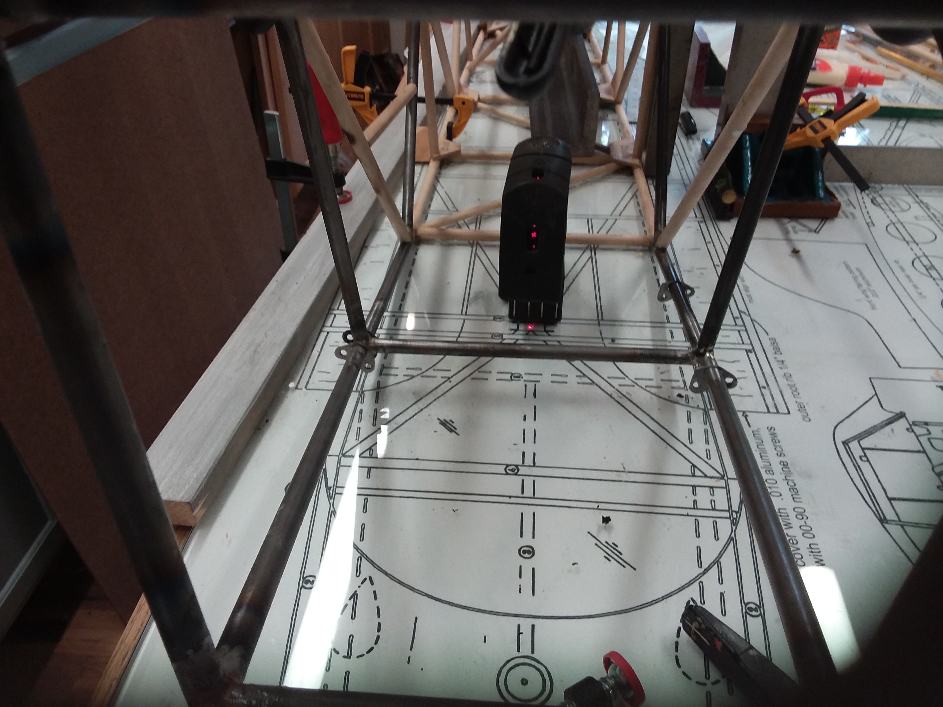

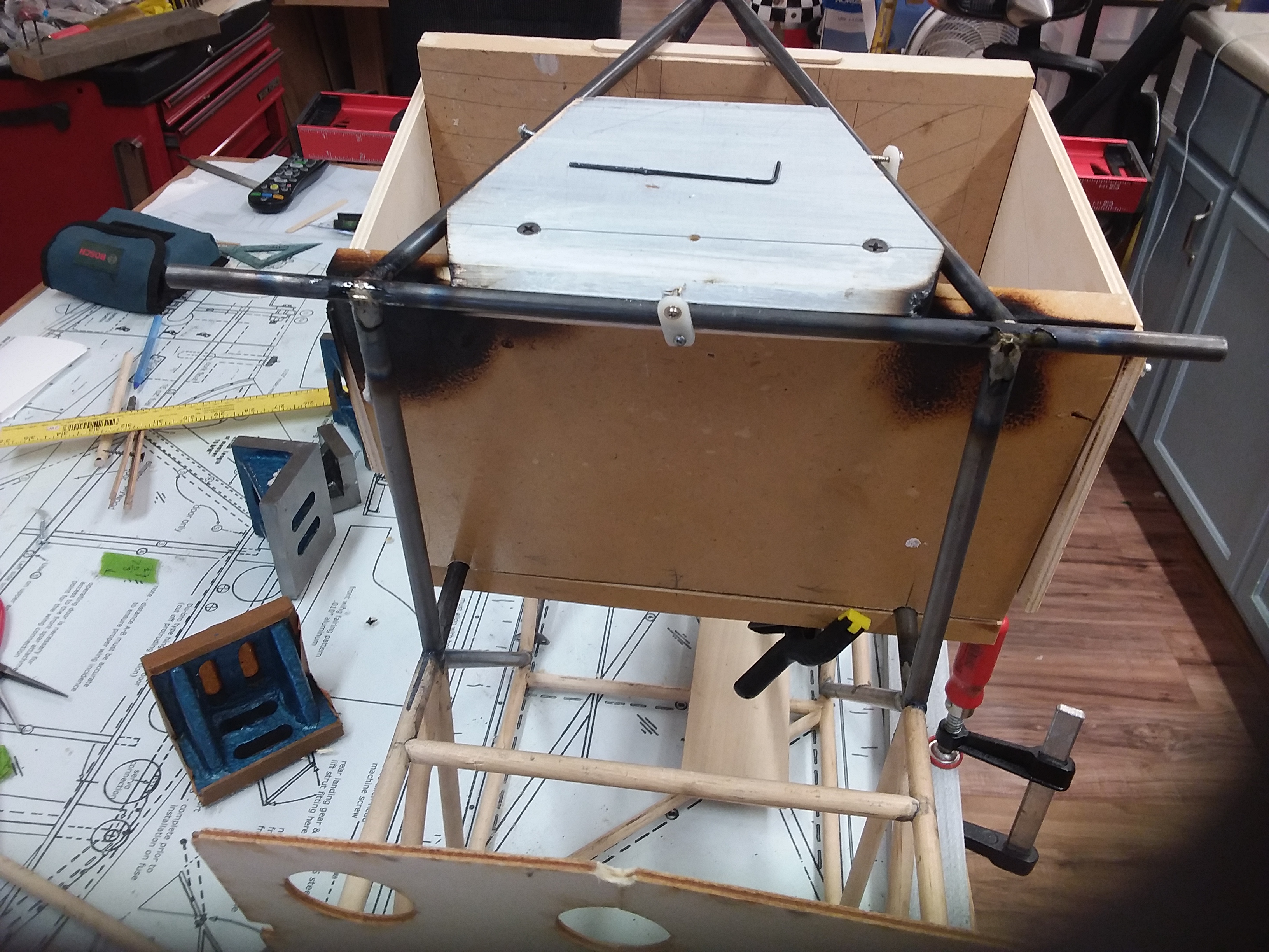

Cabin area steel tubing framing complete. Chose to anchor rear pillars in Hysol vs trying to solder so close to wood. I buried the ribbed nails deep in the lower frame in Hysol then filled the steel pillars with Hysol.
