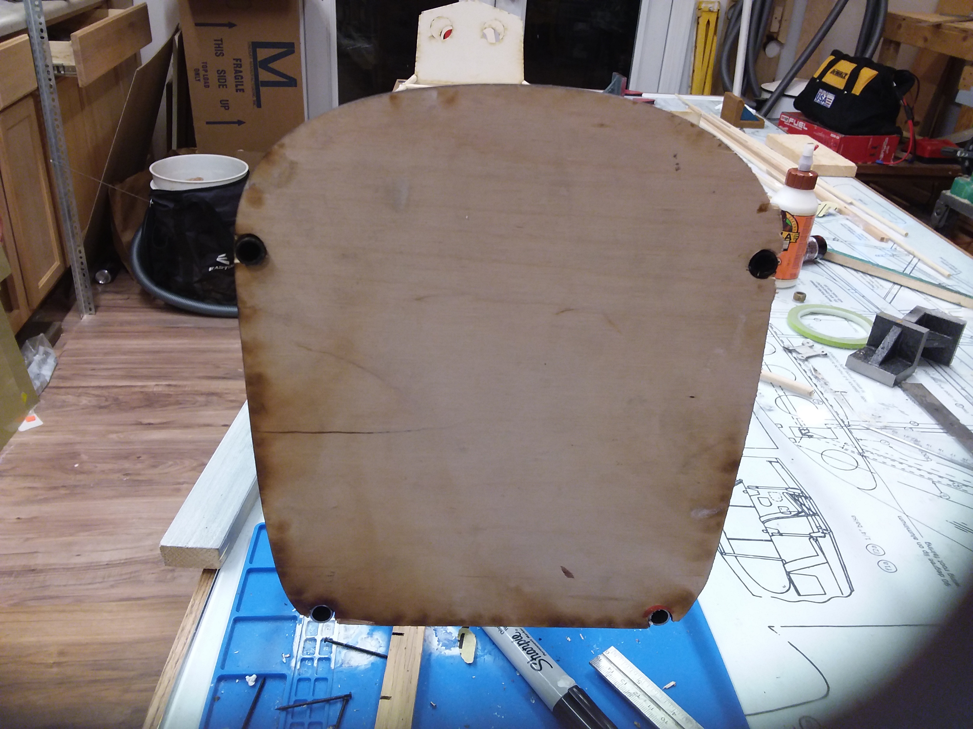

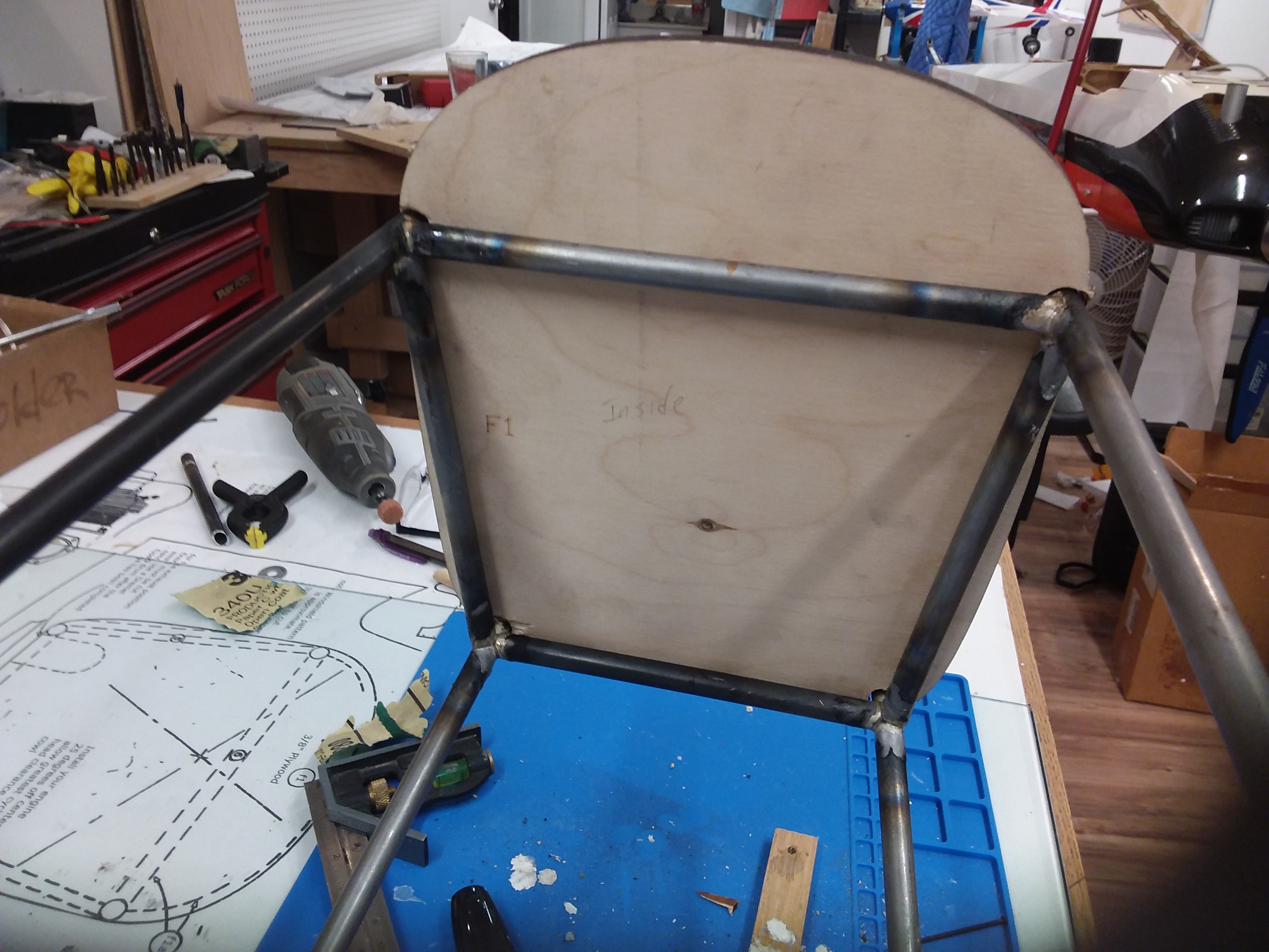

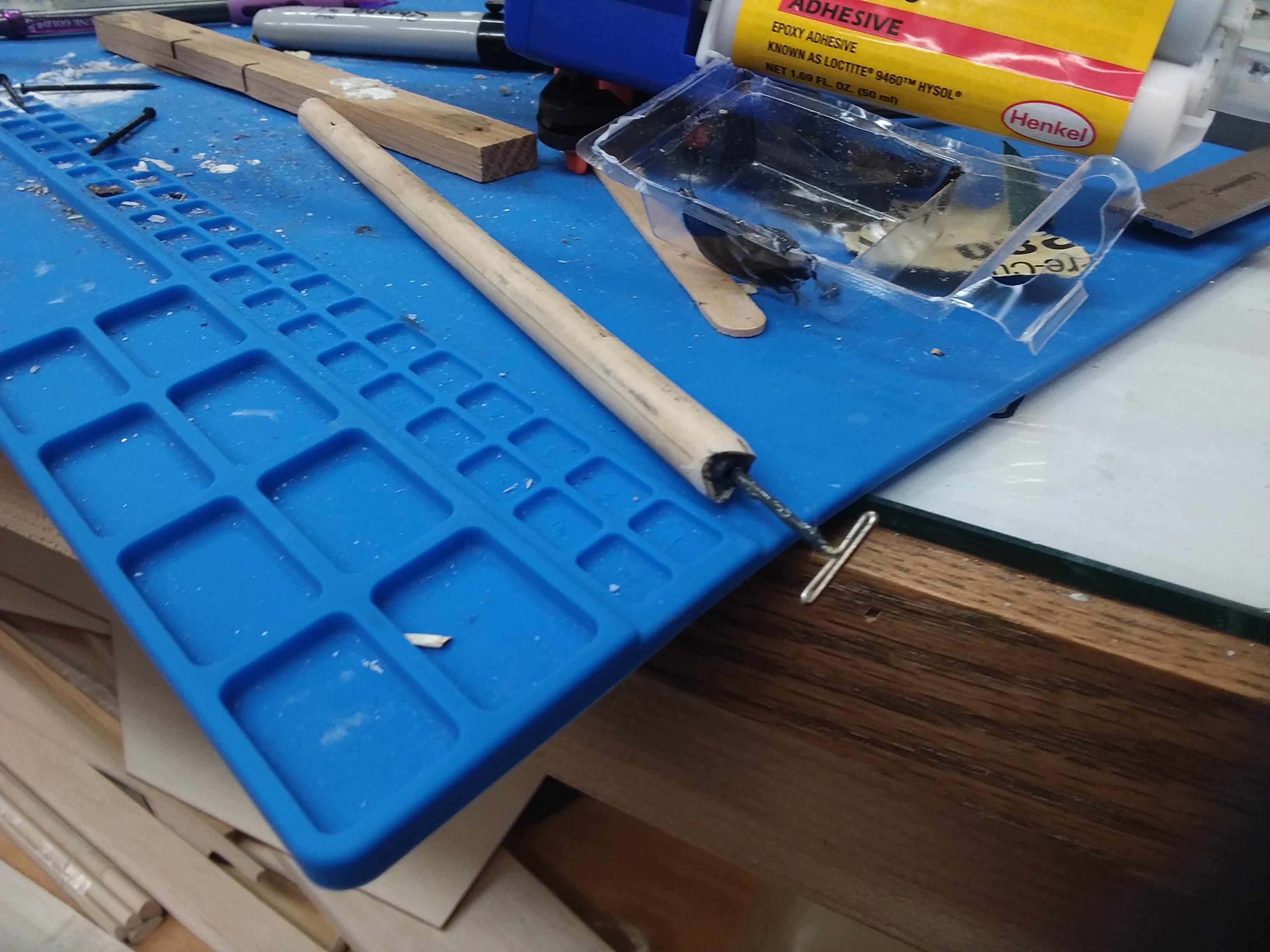

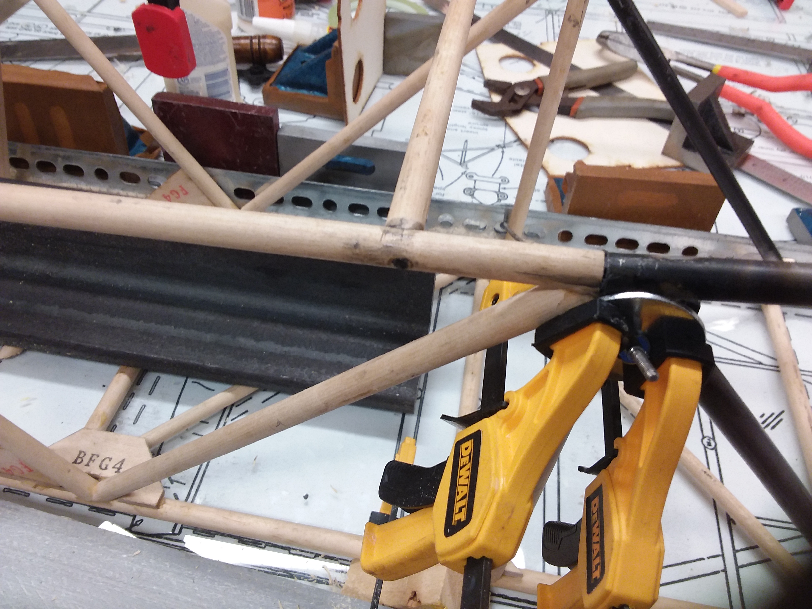

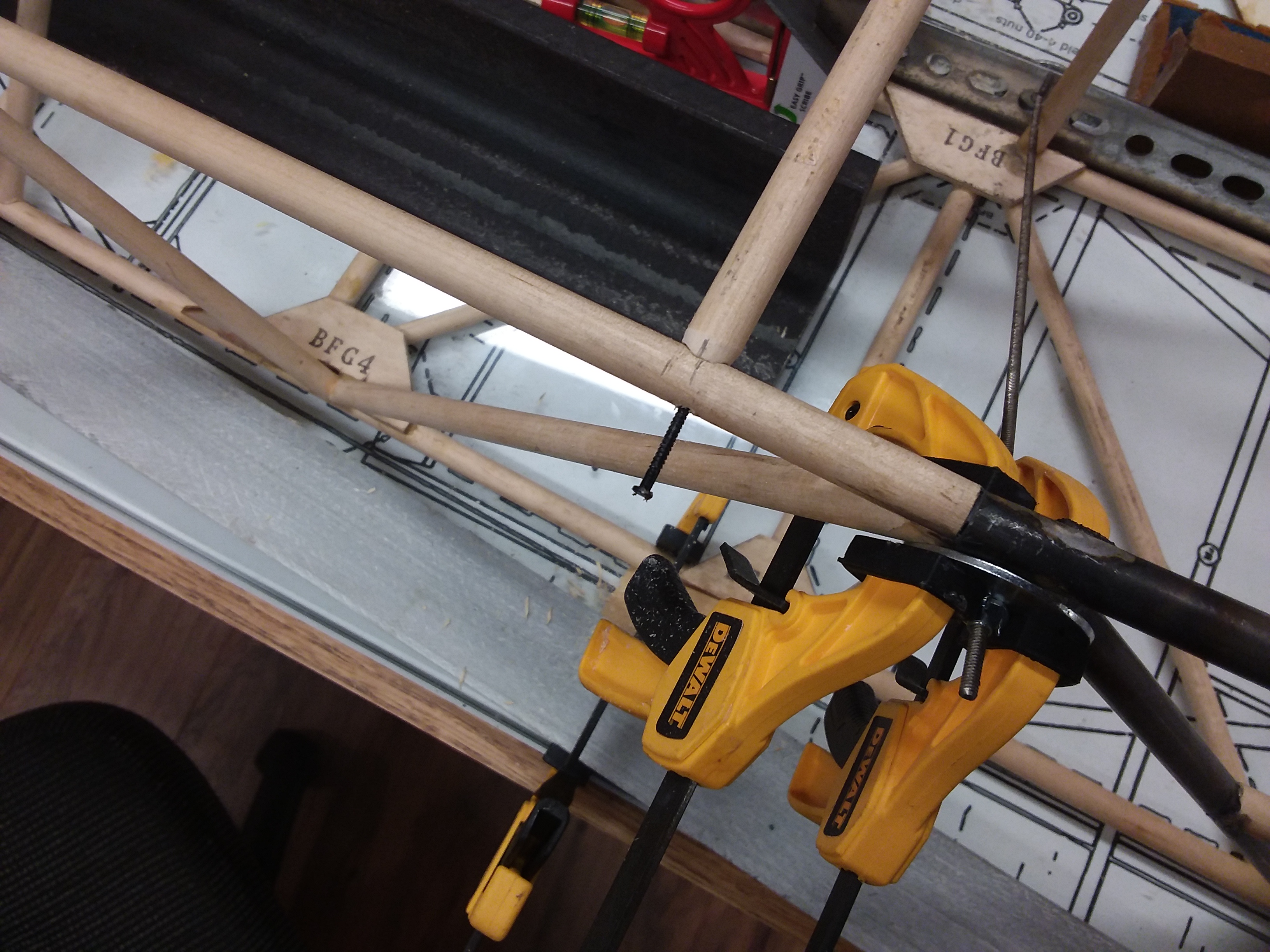

More. I suppose I will Hysol the firewall to the tubing behind. Maybe through bolt it to the tubing.

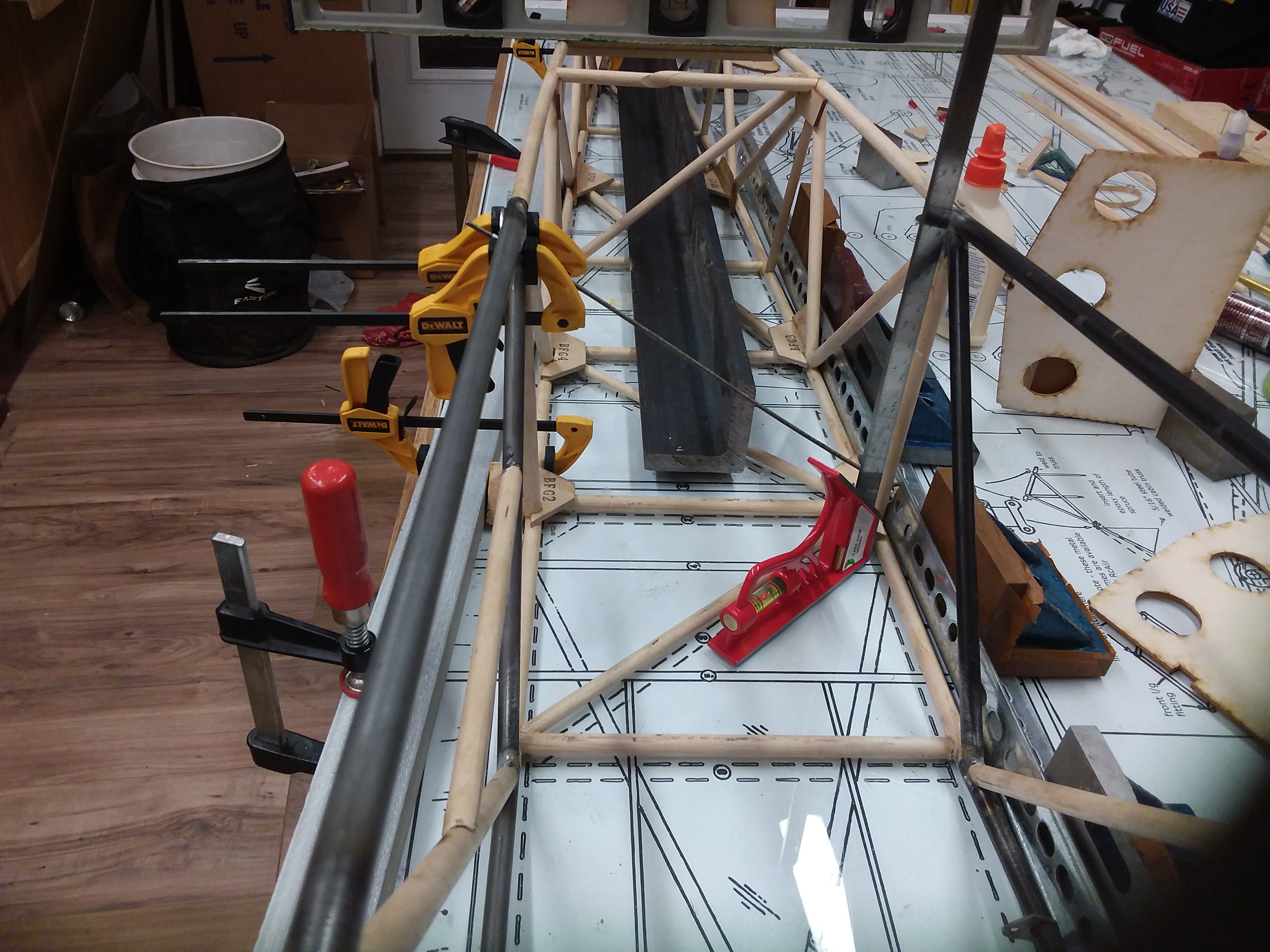

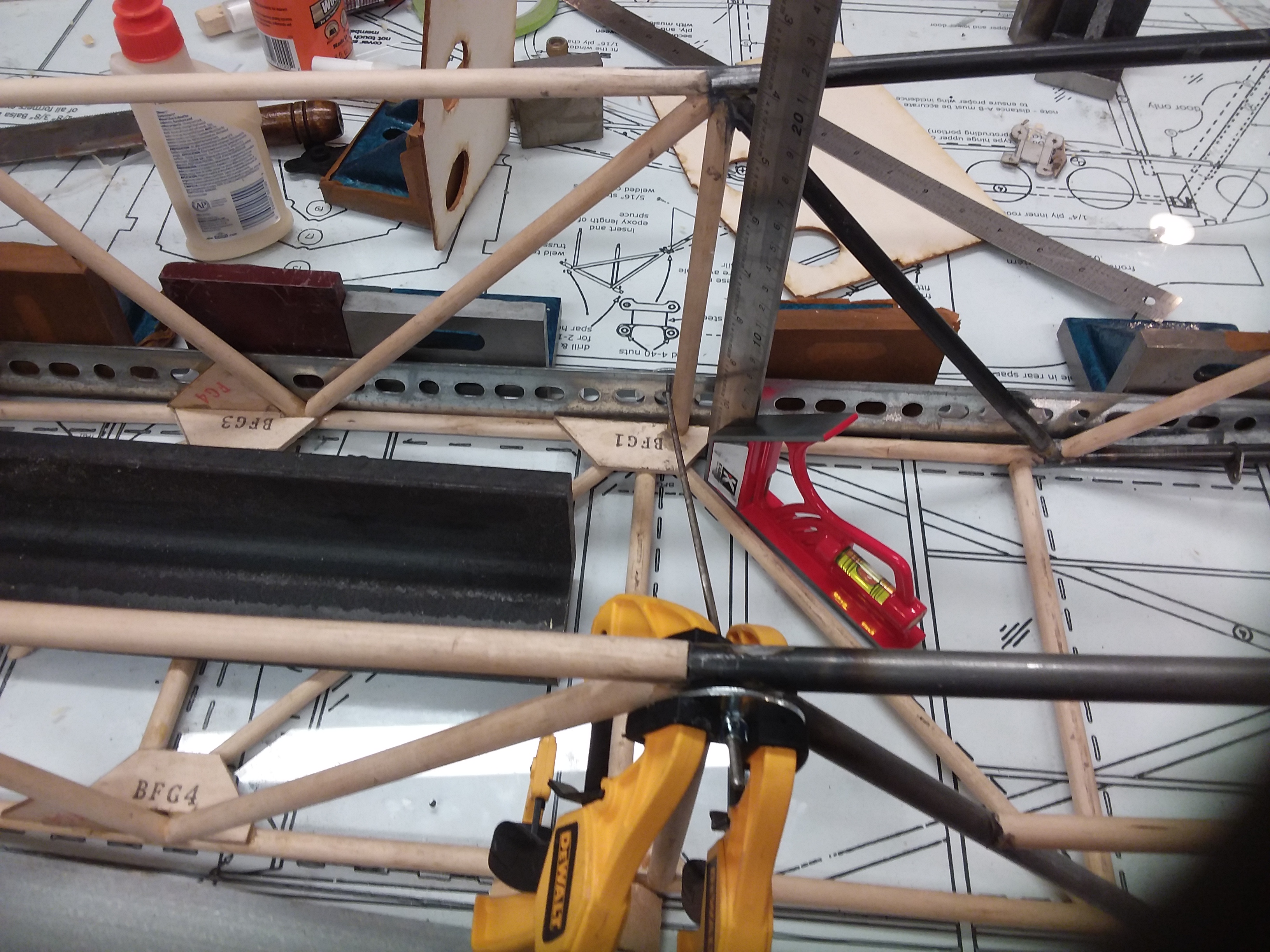

One side is leaning out a 1/4" or so and needs to be drawn in. Couldn't use the opposite side as its not strong enough to keep from being drawn in itself. Figured out a way pull it in though. All thread and washers make for a good screw jack.

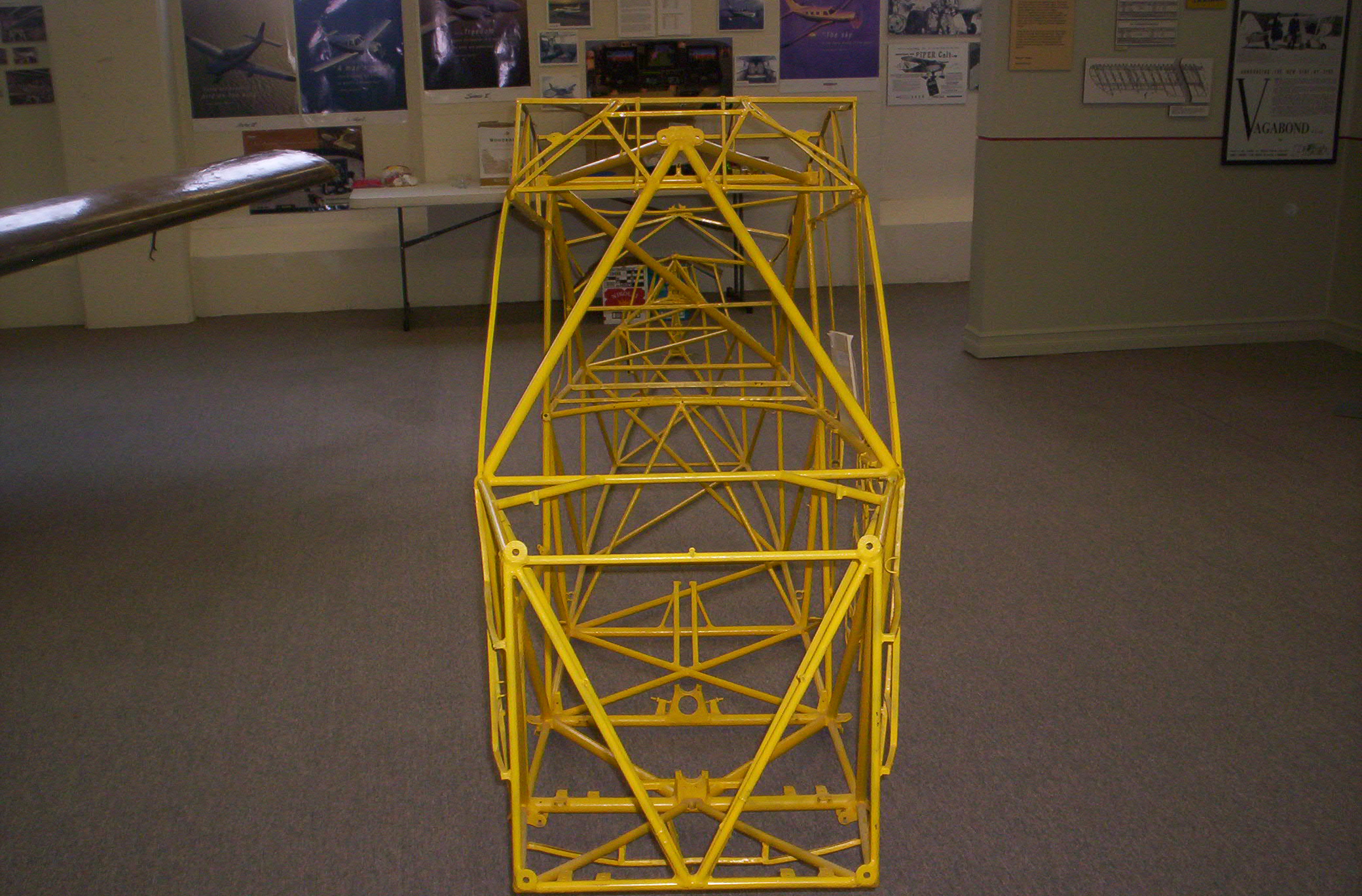

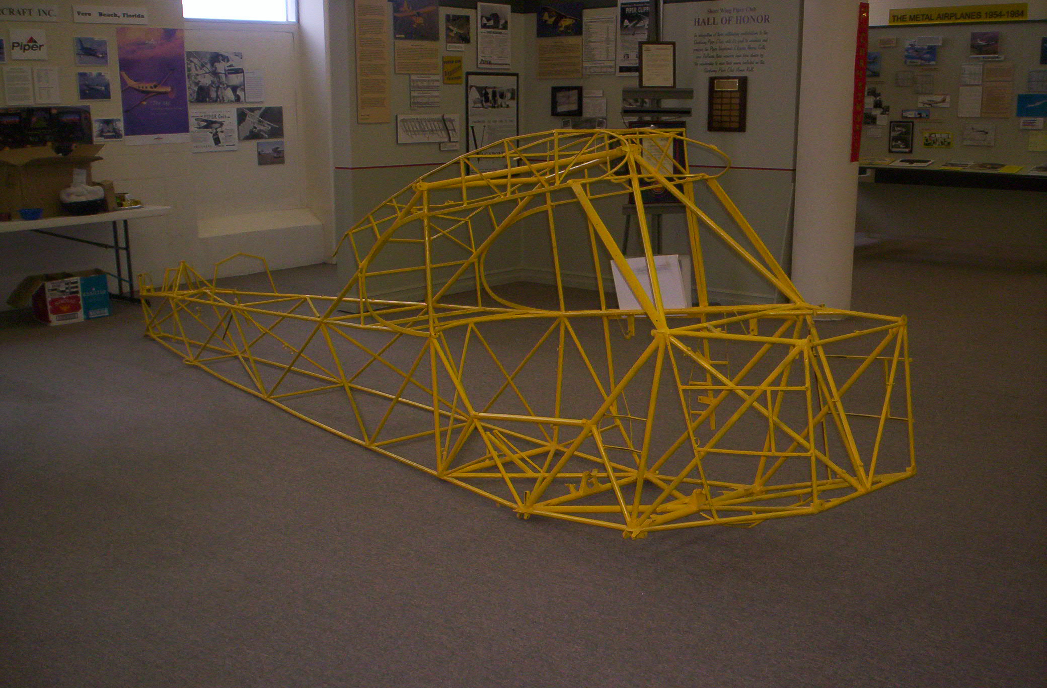

TonyHallo
A couple photos from the Piper museum in Lock Haven PA that may be of interest. Note the tabs for bolting the firewall.
