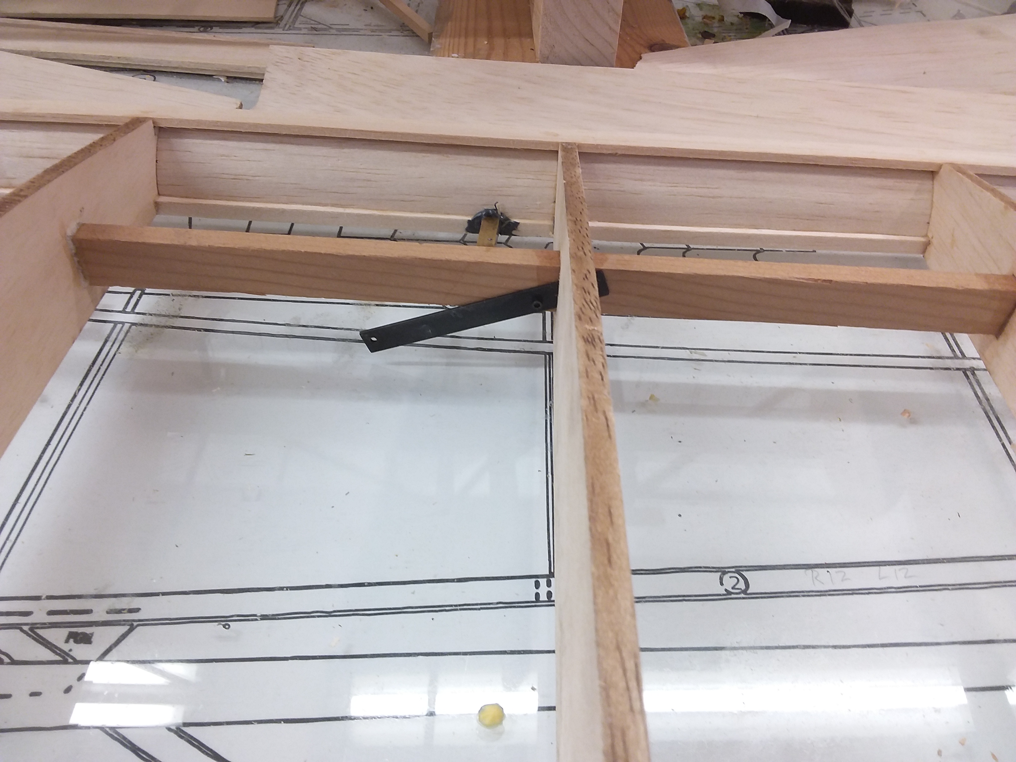

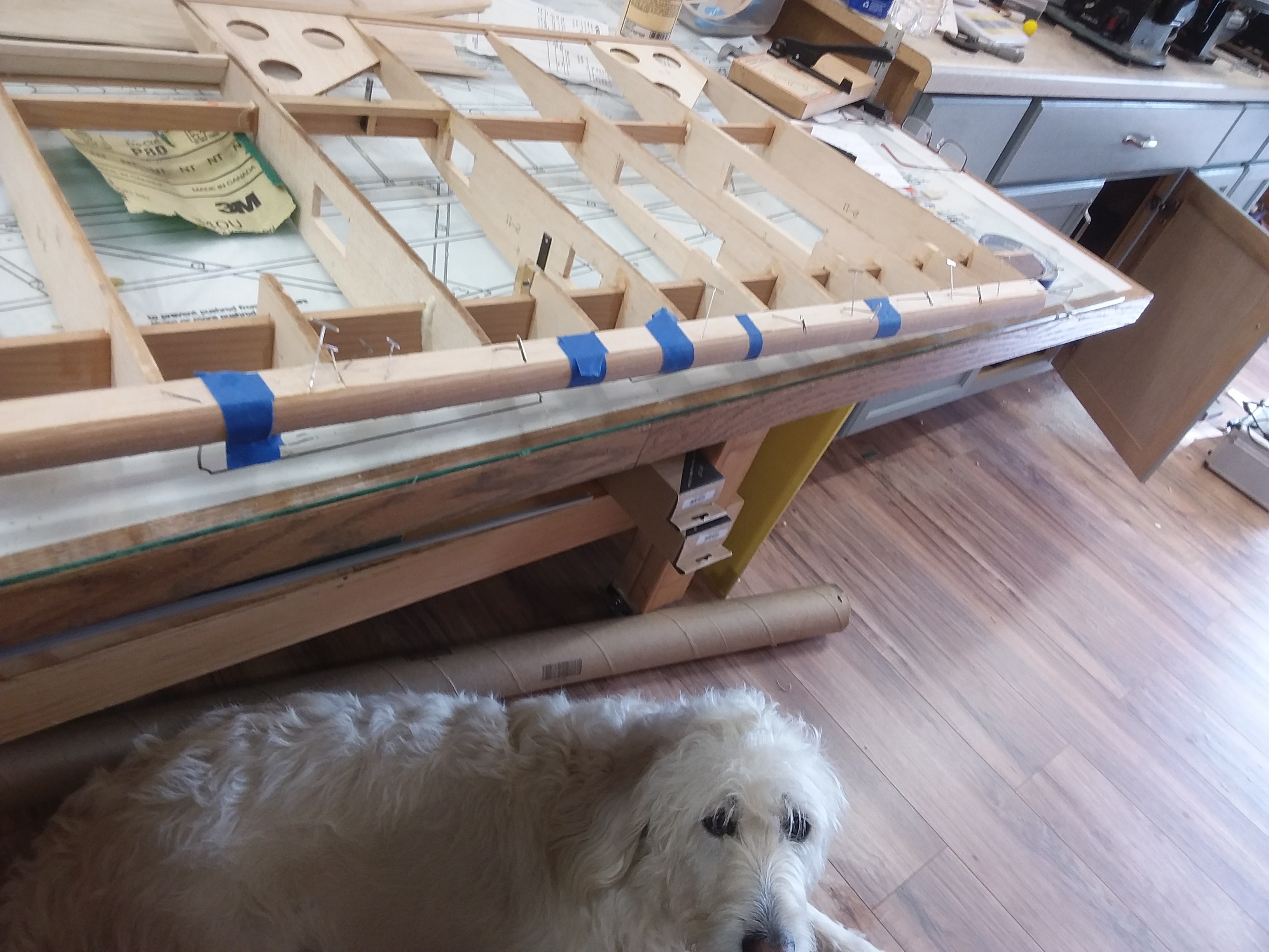

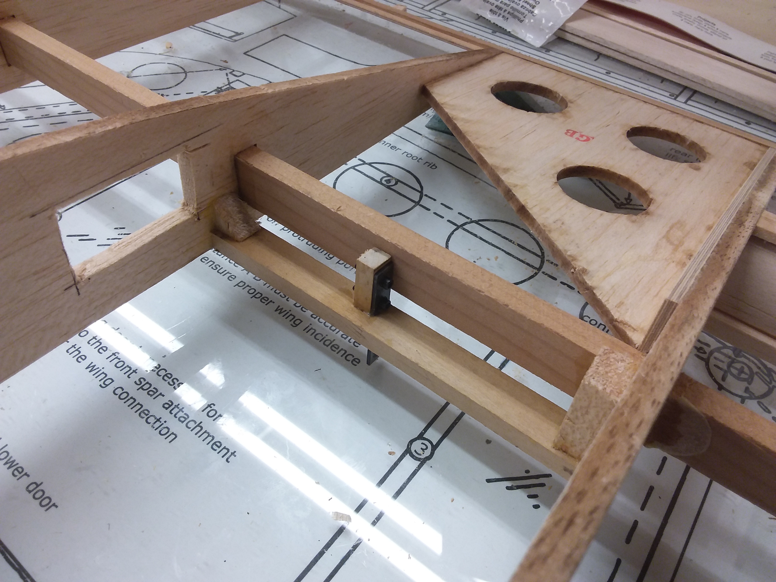

Balsa and Titebond! Great Christmas day! Finishing up wing strut connection points and balsa skins.

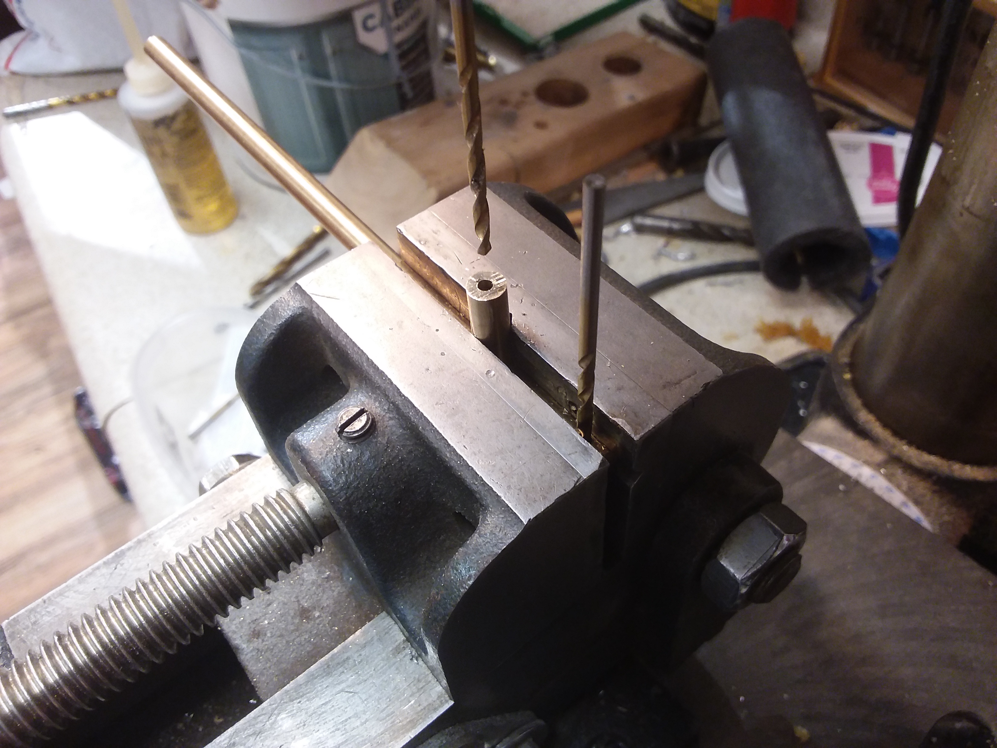

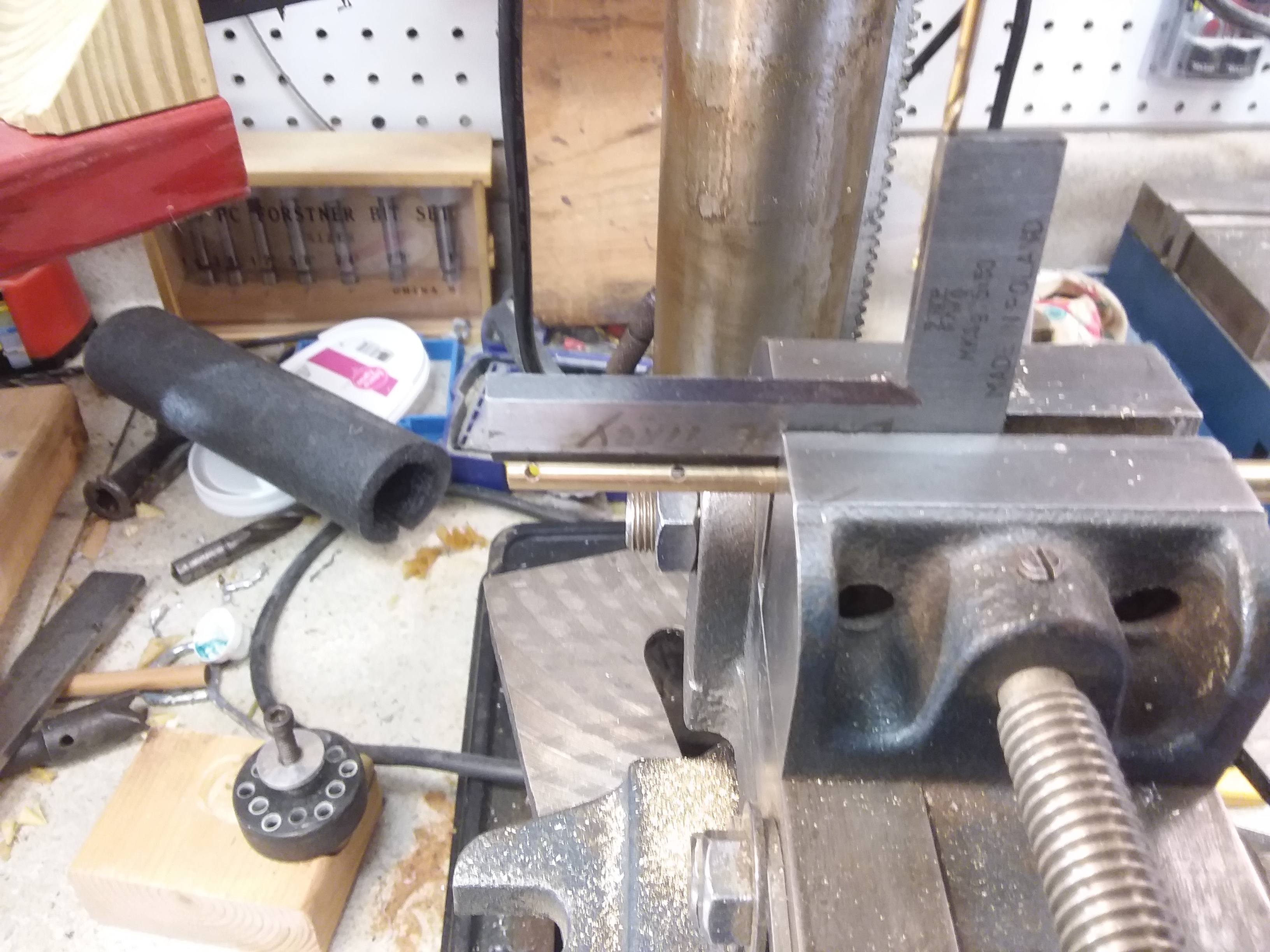

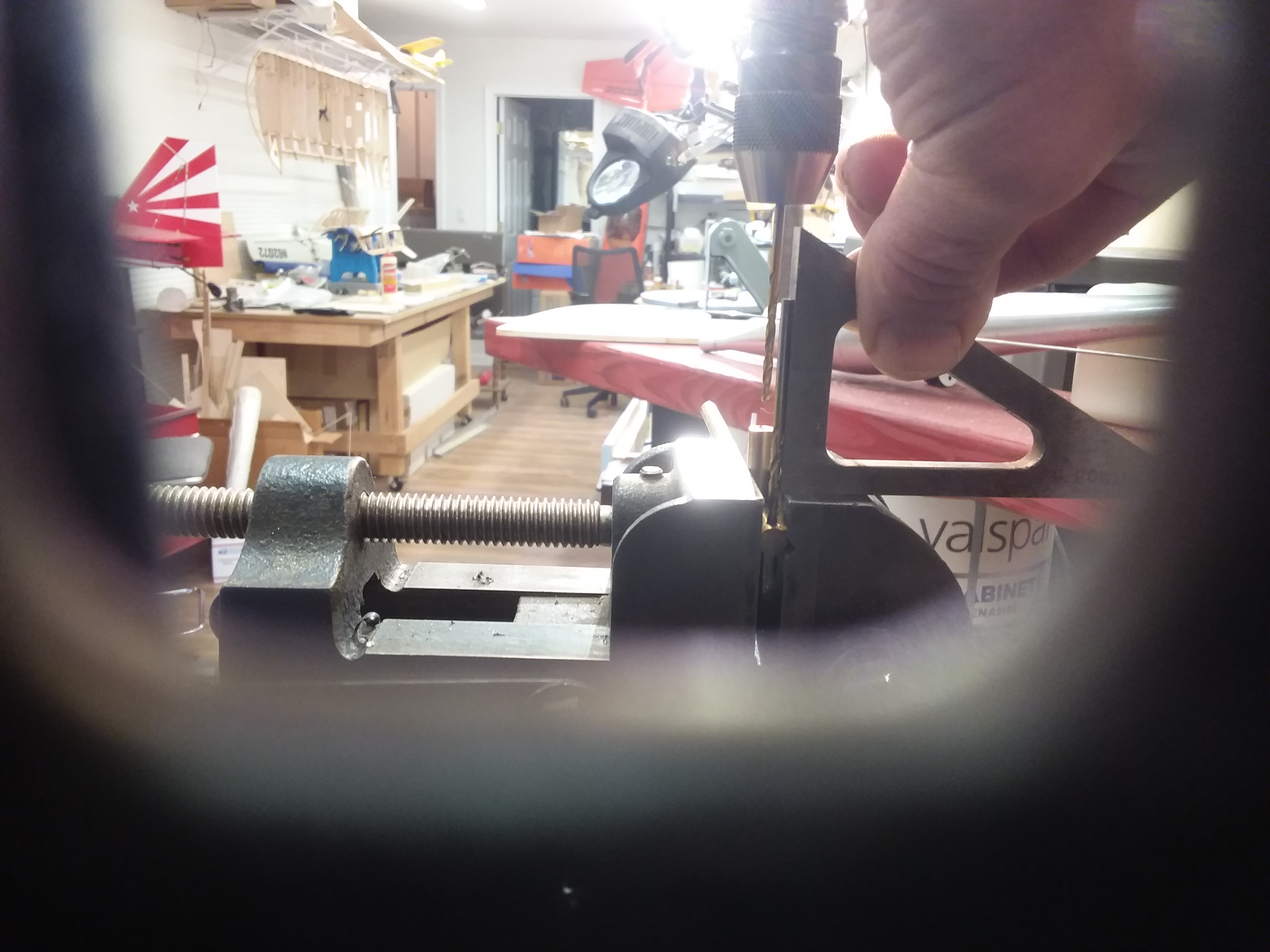

Pain in the butt to center drill tubing, twice and have the 2 holes parallel.
Even this isn't perfect. I used a center drill idea plus a square to try to line up the second hole with the first.

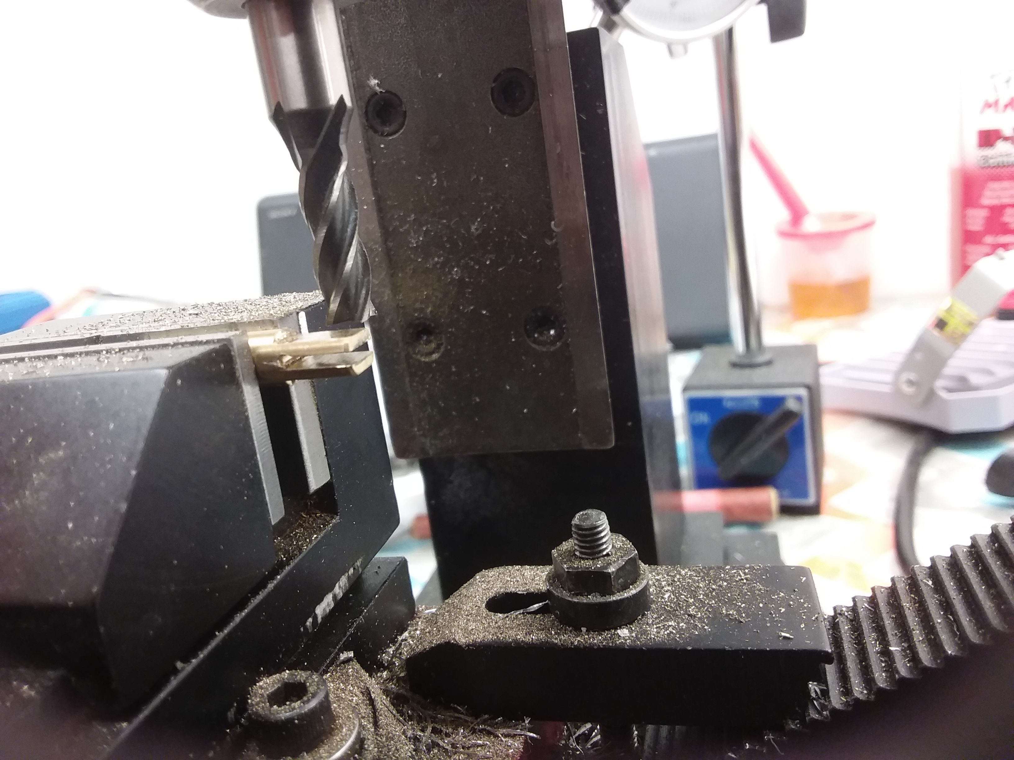

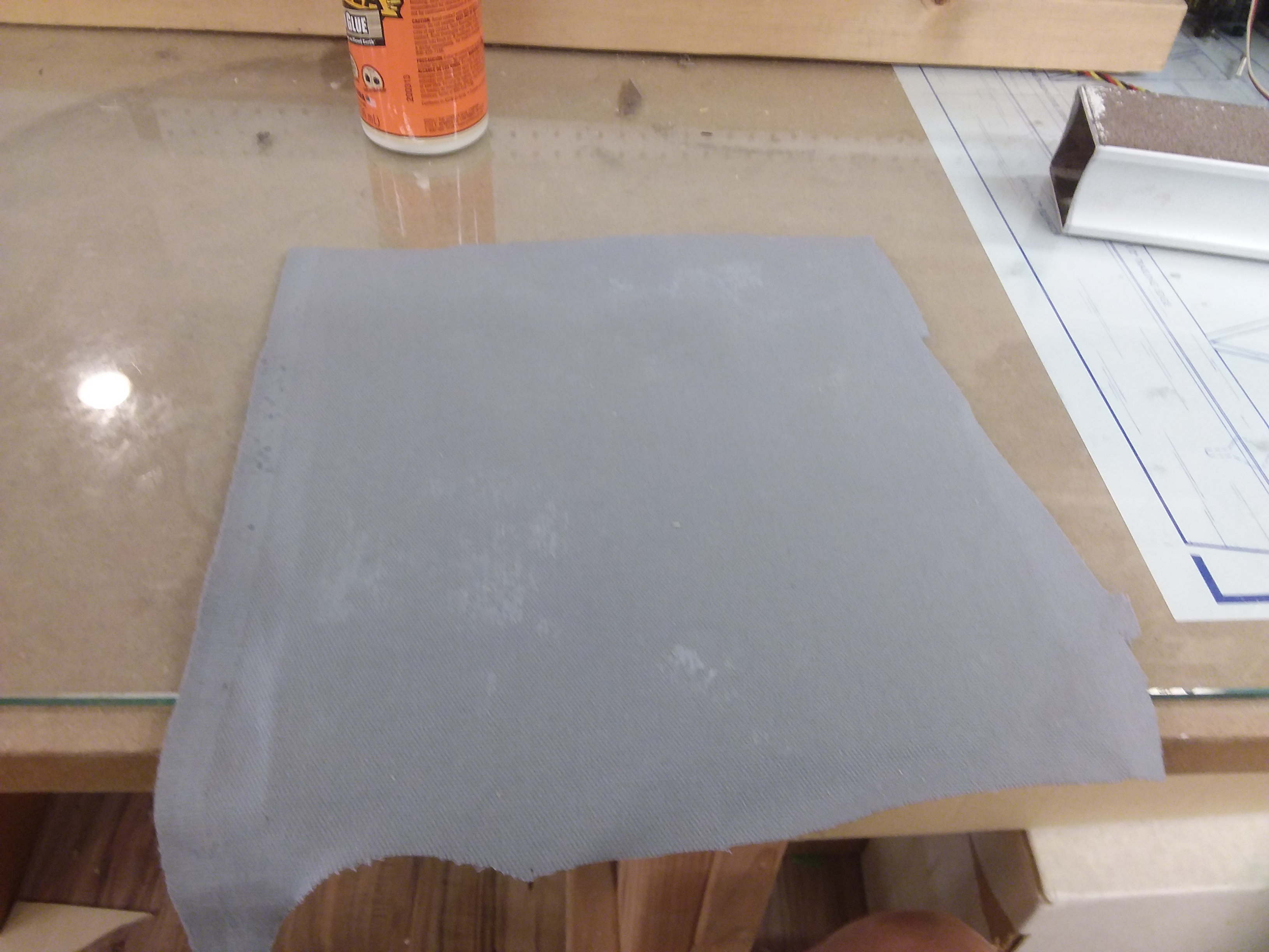

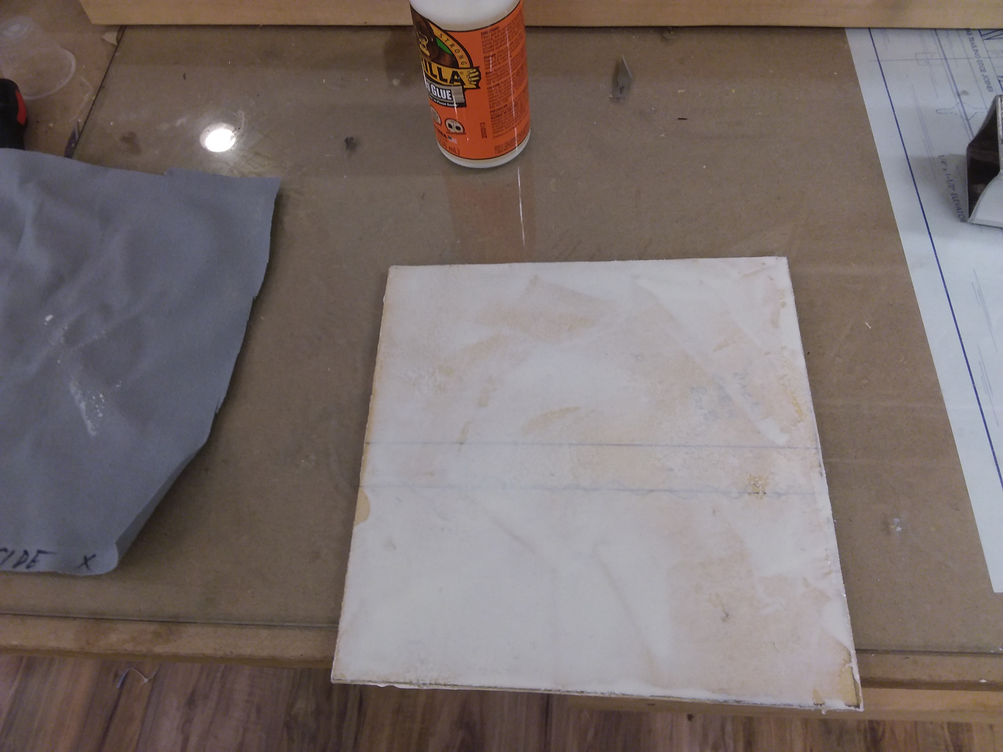

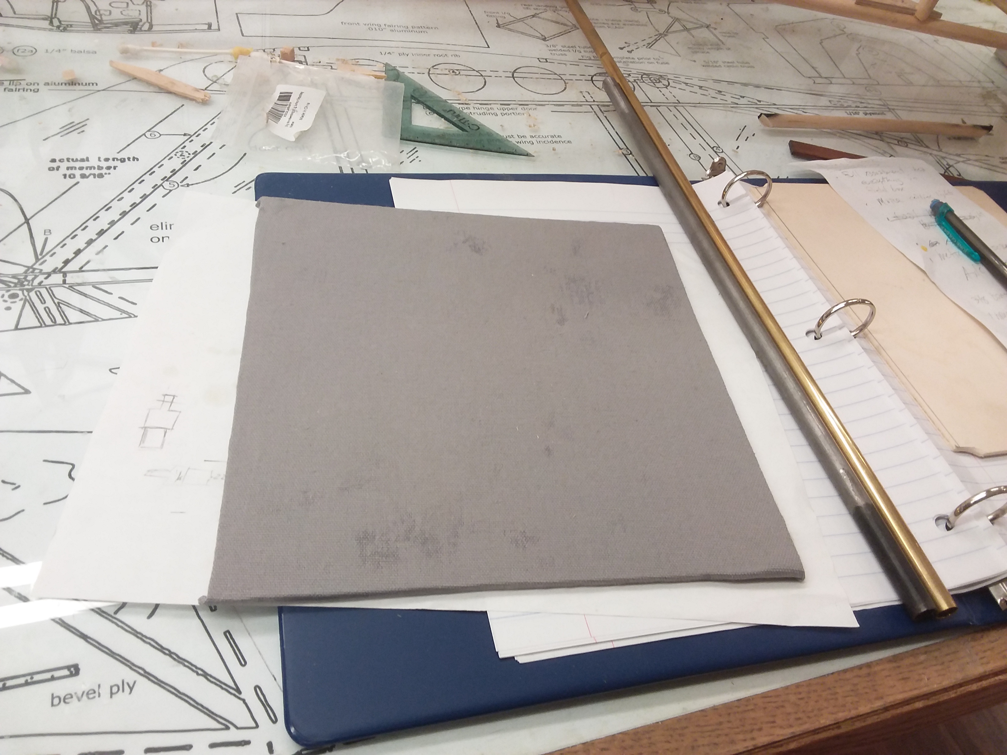

I need a thicker slitting saw for the brass connectors so shifting back to the fuse. Still trying to glue the interior cloth, found online using wood glue might work. A little bit of bleed through but we'll see once the glue dries.
