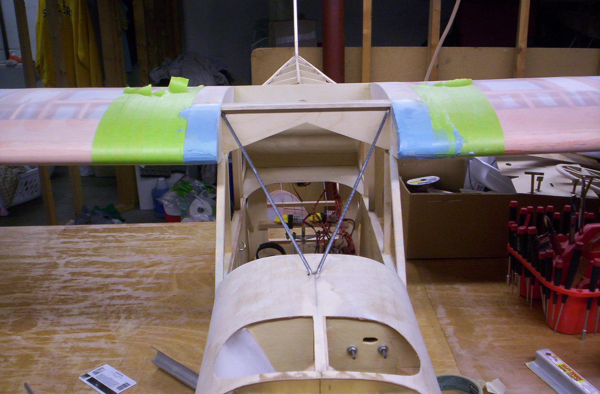

Any more photos of your wing/ upper cabin area? Project is stalled? I have a couple of those..........
I'm pretty sure the Super Cub was my first online post so I didn't take a lot of photos. It's a BUSA so the build is different as well, here the stub ribs are being matched to the wing with Super Fill.

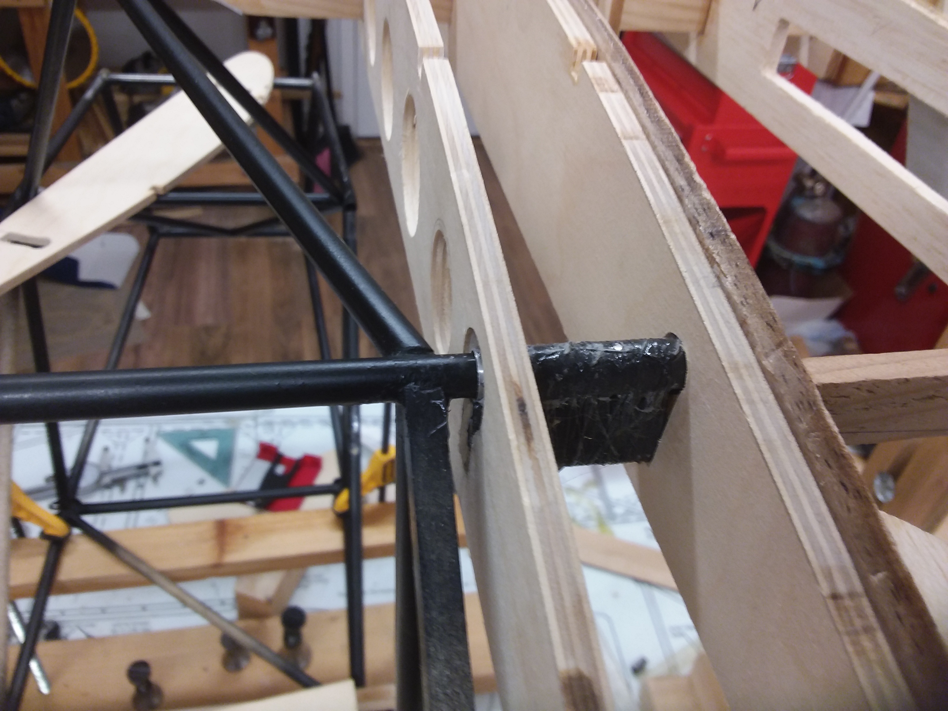

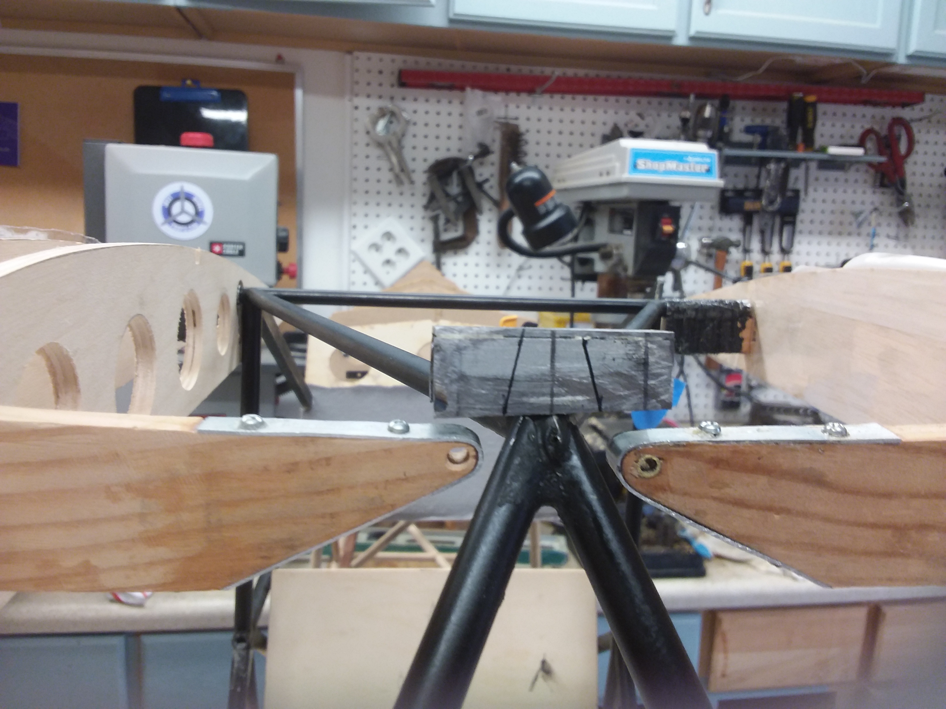

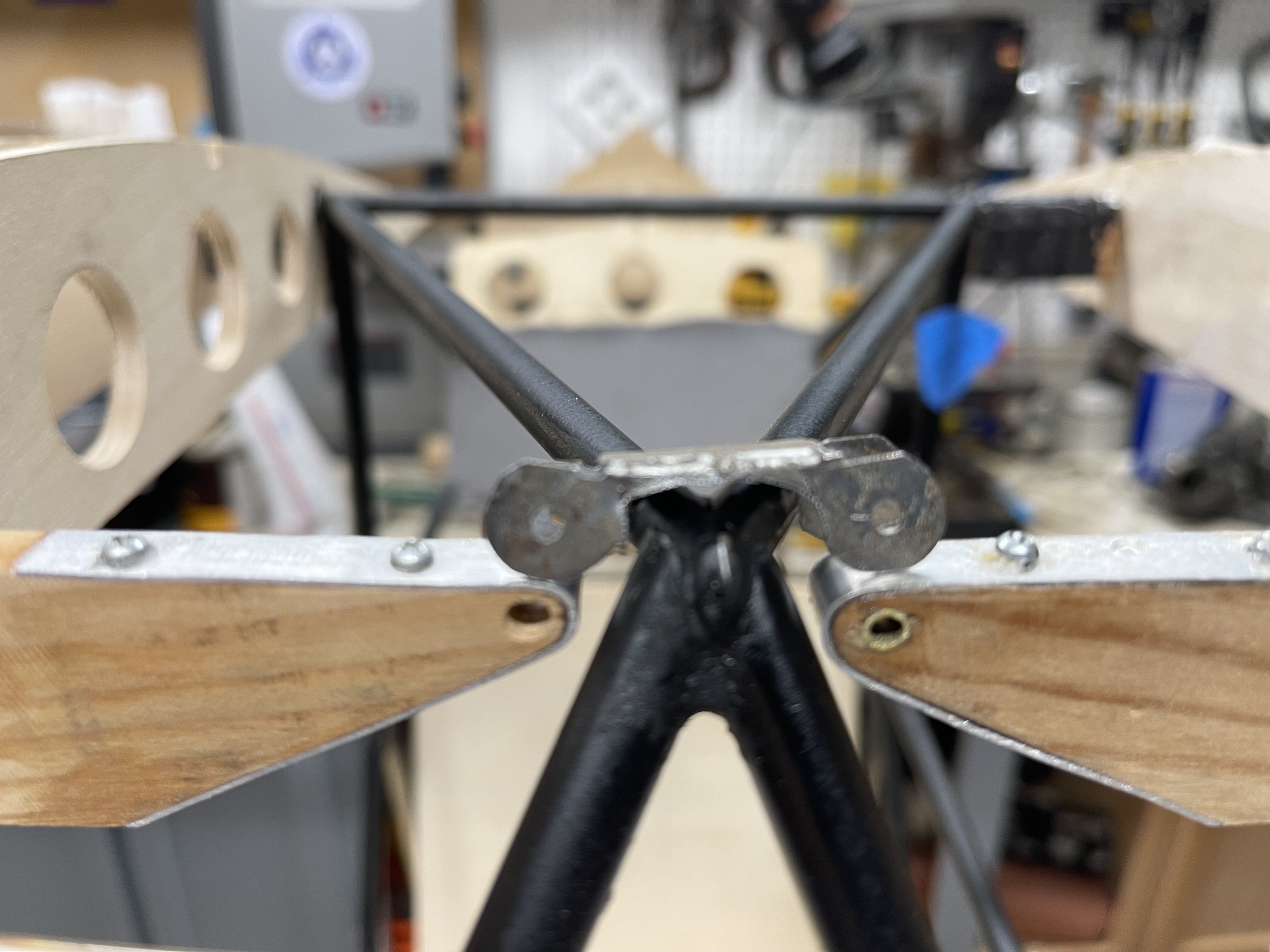

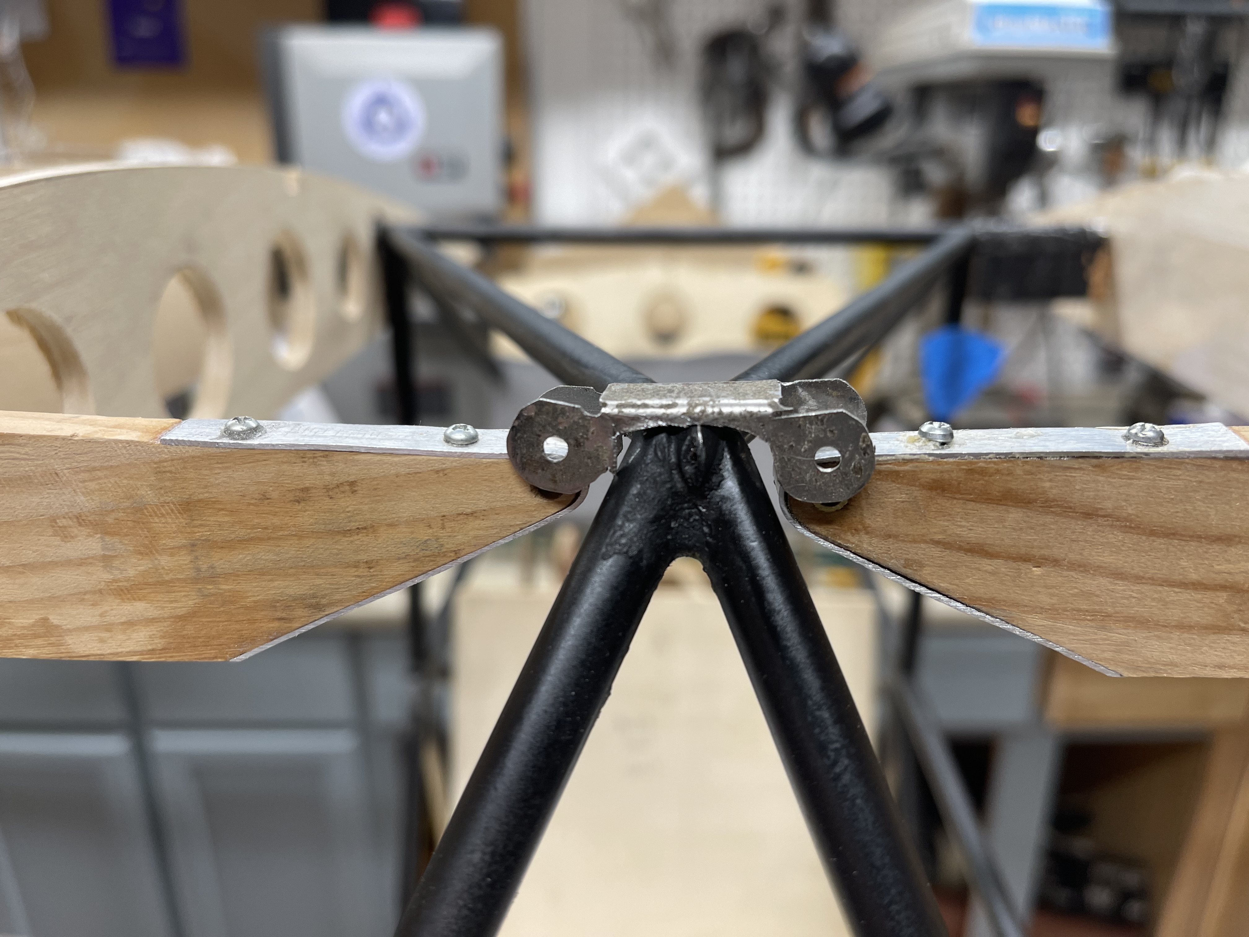

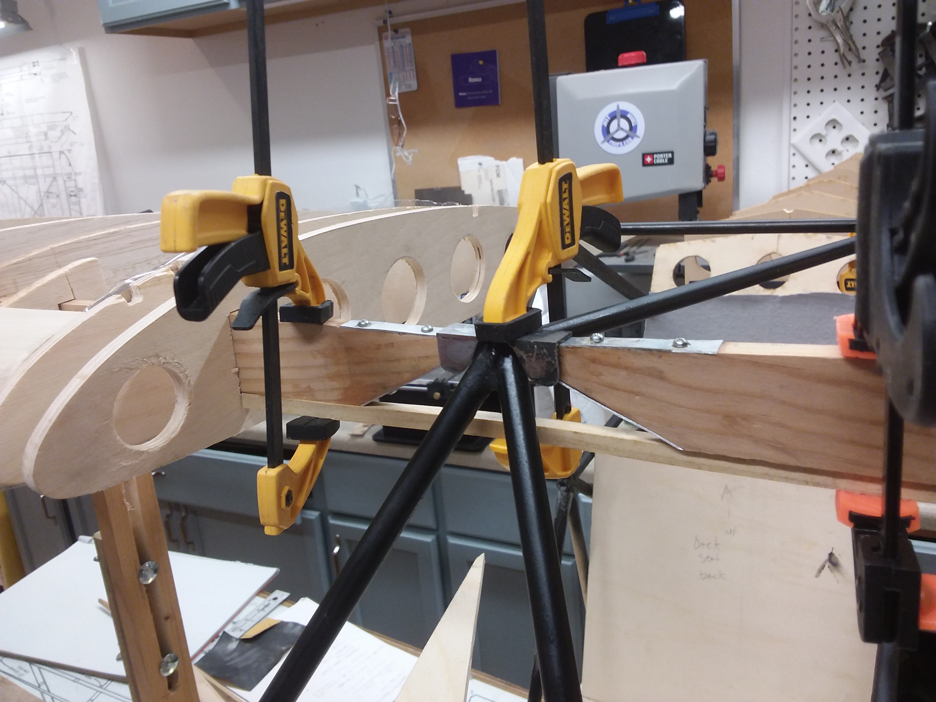

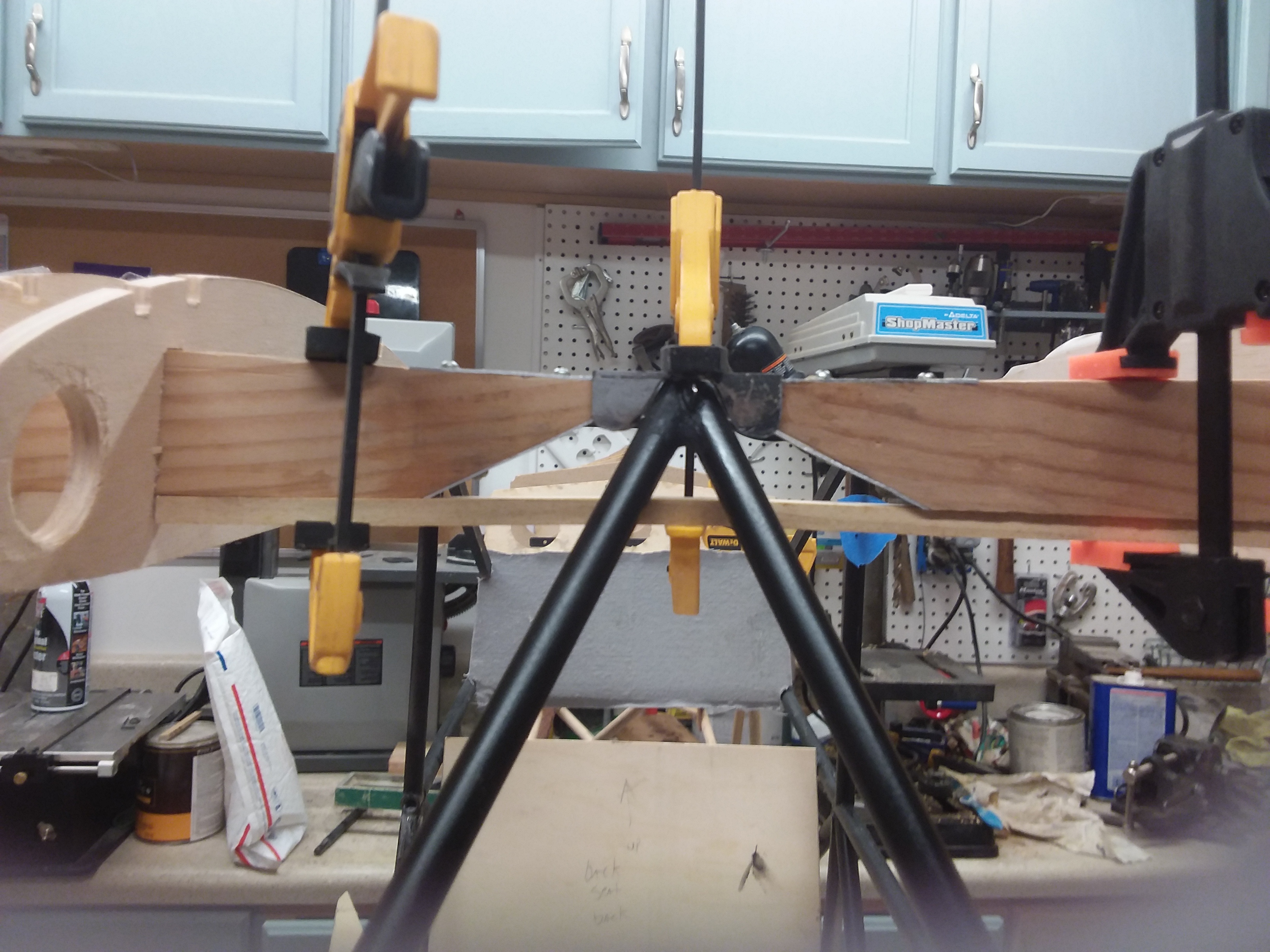

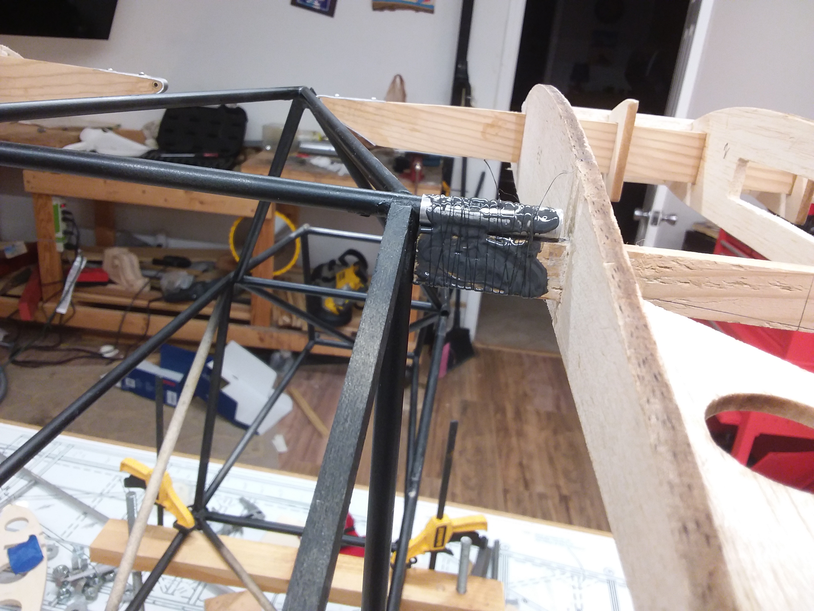

Working briefly on front spar connection tonight. Rough draft connector piece will be silver soldered but how high above the frame? Could make a big difference on incidence.
