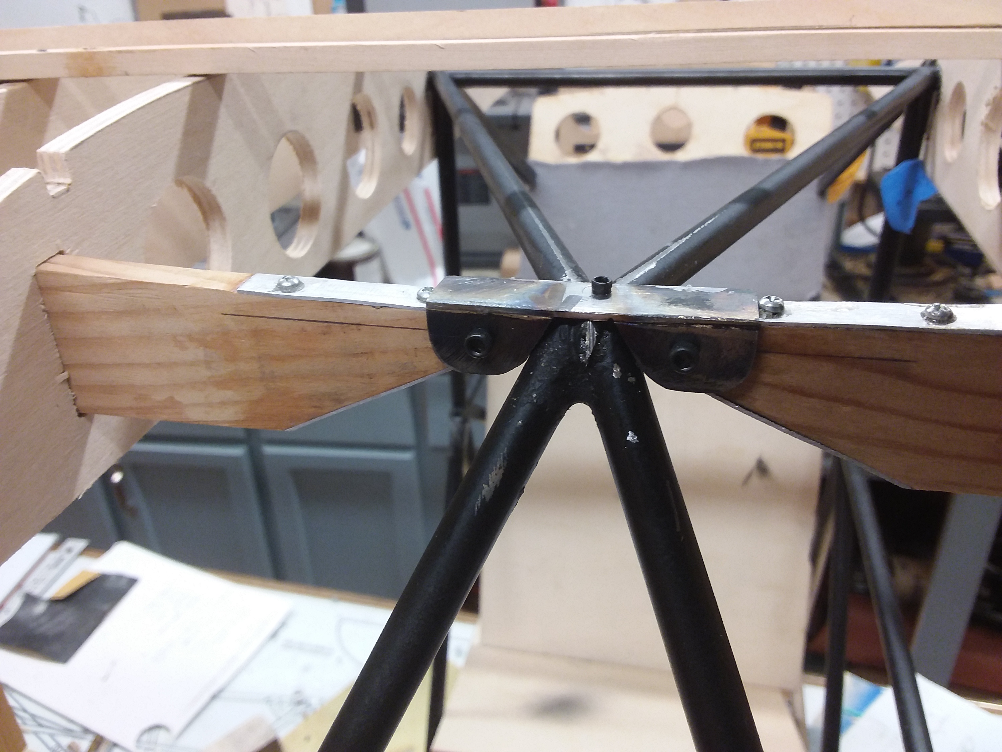

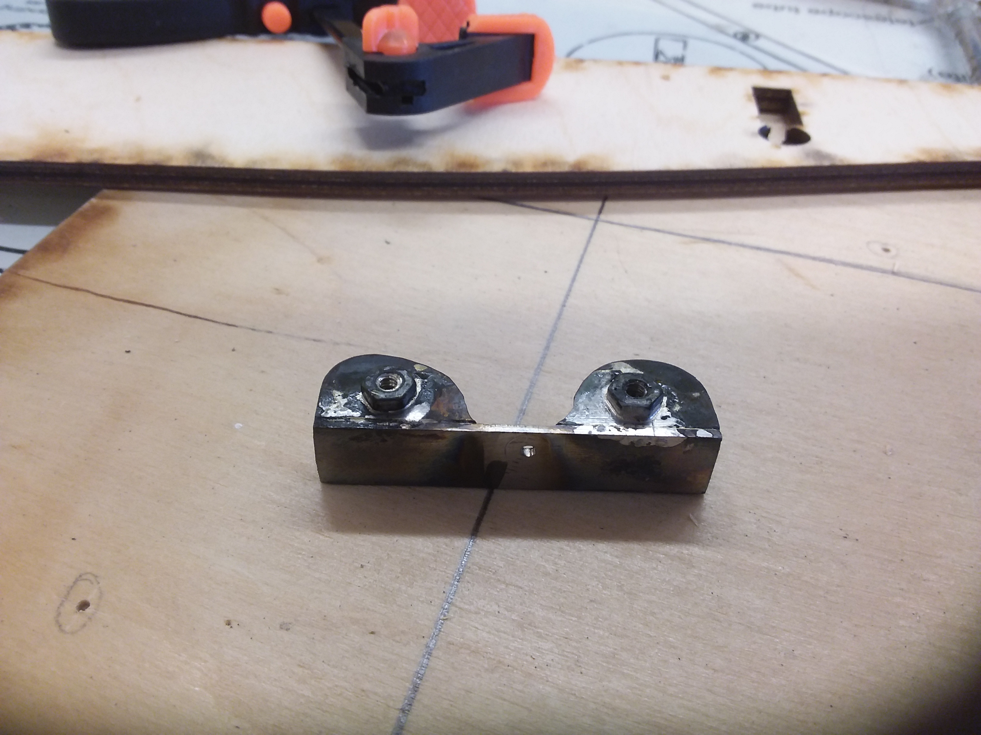

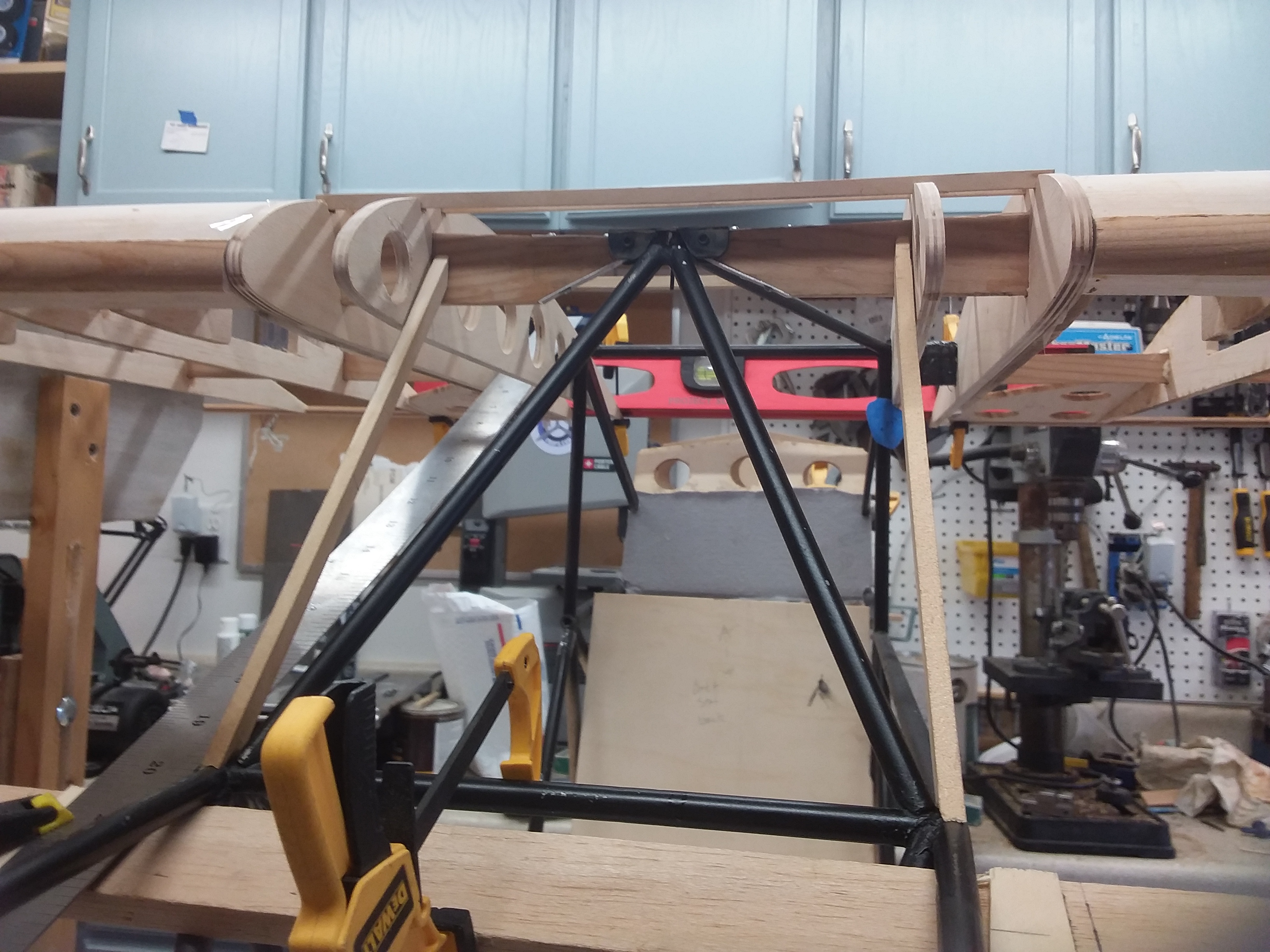

Retaining bolt nuts welded on. And first fit up with retaining bolts.

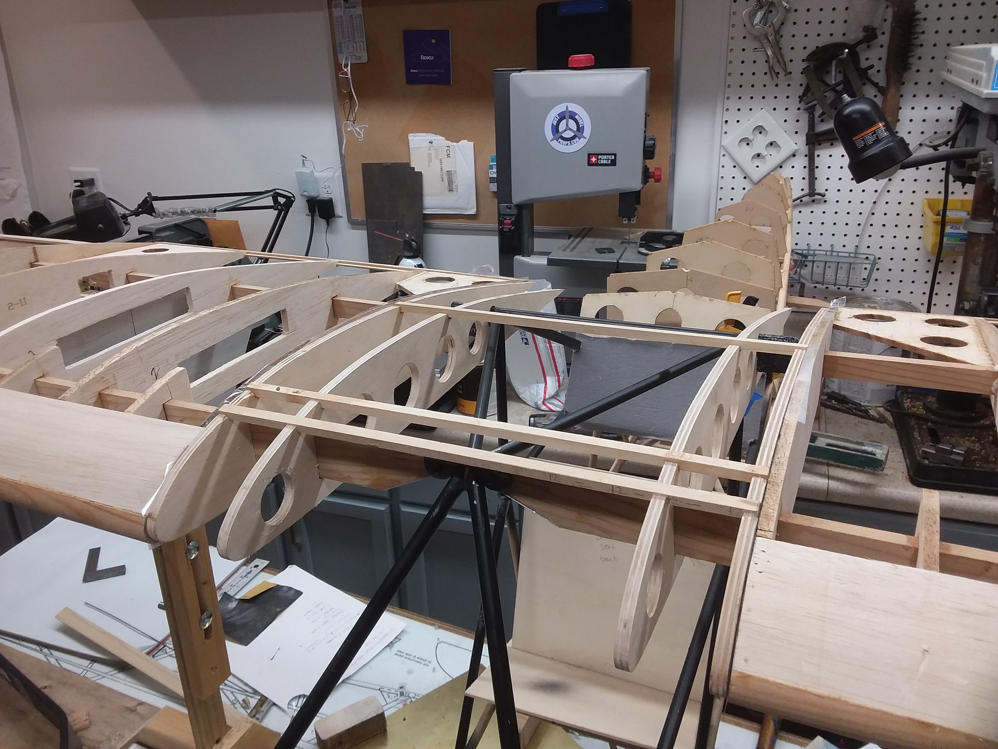

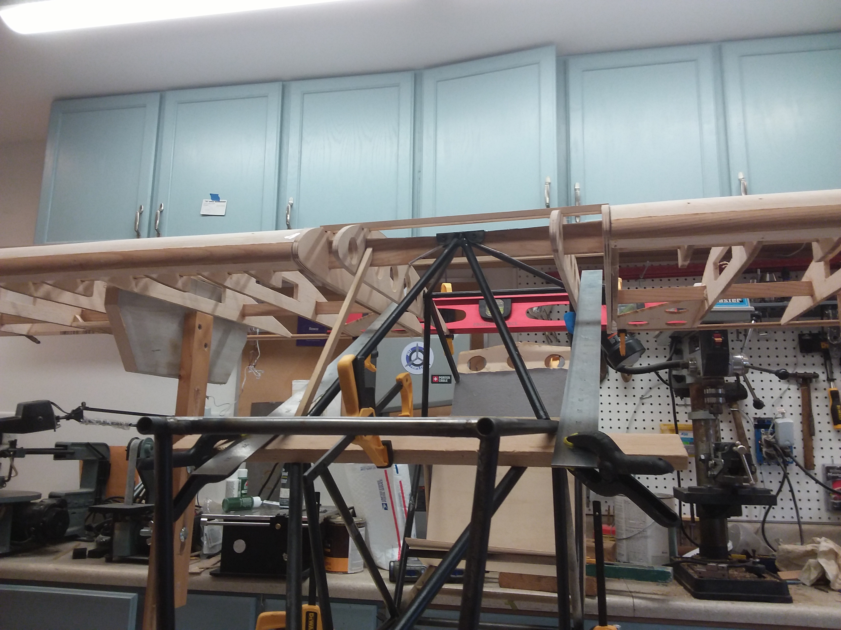

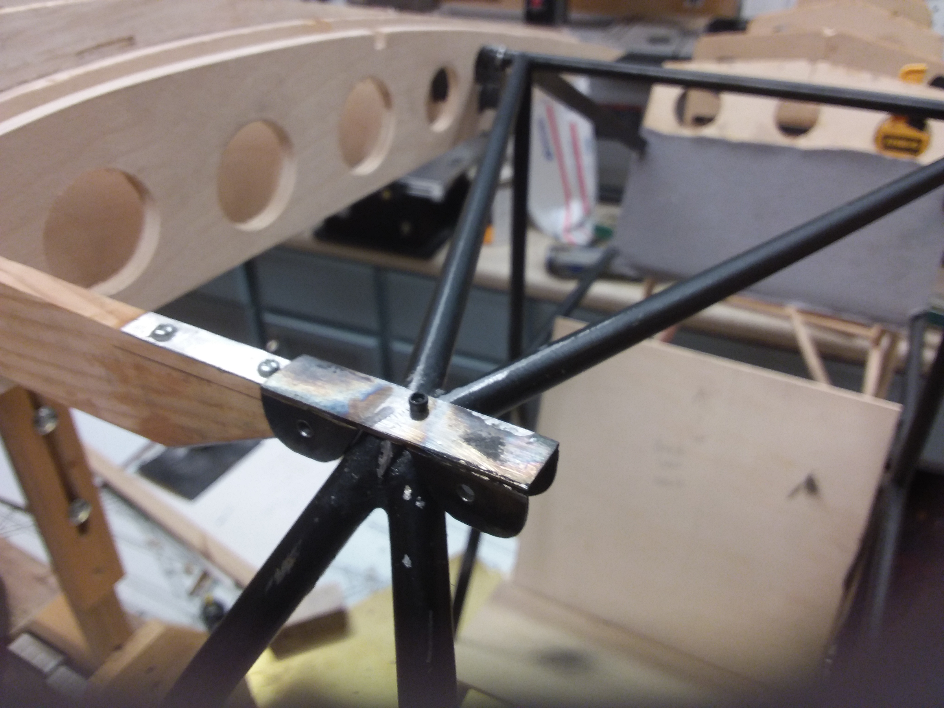

Ran a temporary 2-56 bolt through the main spar bracket, tightened with a nut and fitted the wings solidly for the first time. Just a tremendous feeling to get to this stage. I will leave the bracket temporarily bolted only as I work my way through this stage of the build.

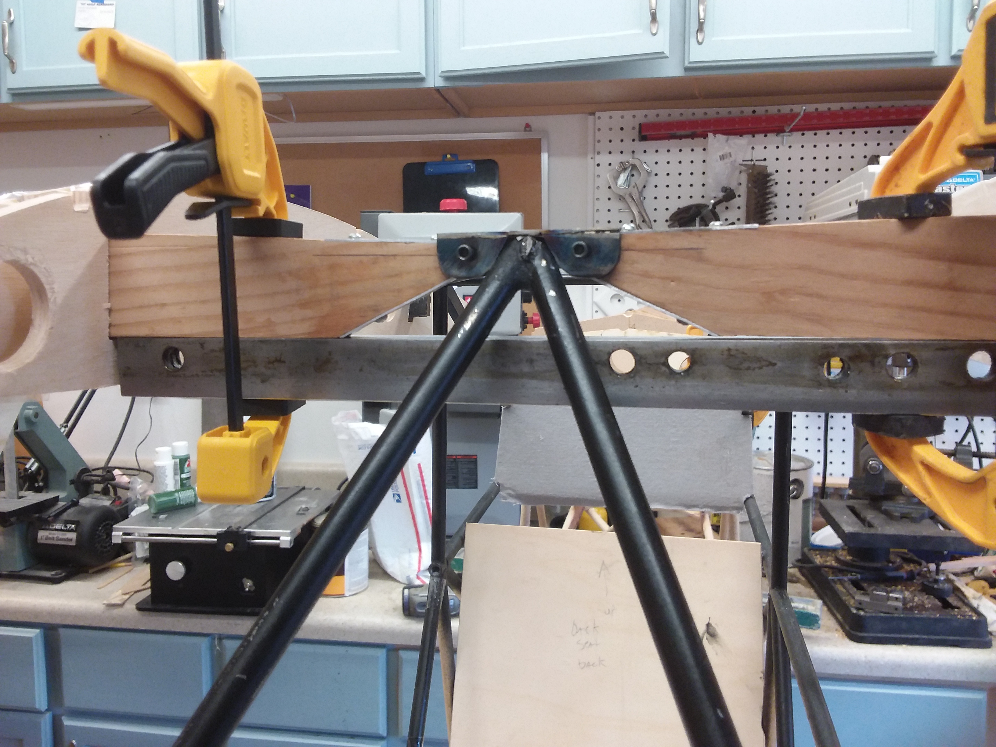

Test fitted some cross wood pieces.
Really good work there!
Would it be easier for the bolts to come in from the backside? Will you braze the mount to the structure, or goockumpucky it?
I think the bolts will have to come from the other side. Hoping I can make the top window an access panel and I could come from the front side but it doesn't look like I can.
Mounting bracket will be fine with a bolt/ screw(s).
