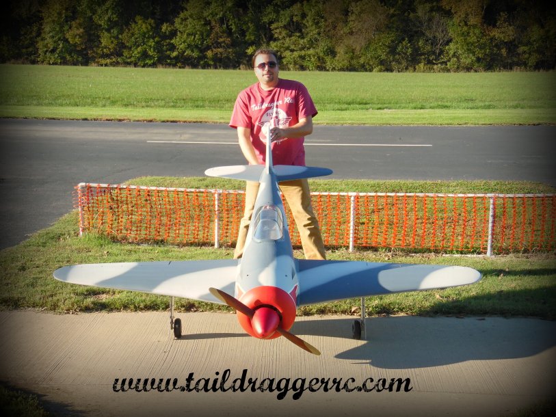

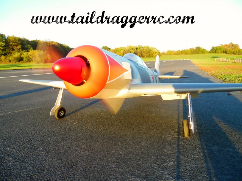

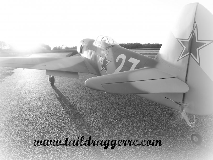

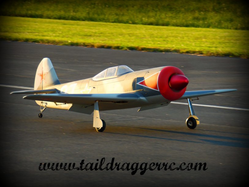

I talked with Chad over past couple of days.... He said that the maiden of the Yak 3u went good, with the electric power system, but it ballooned terribly on landing. He then told me that when he rolled it inverted, it climbed oike wild fire. Well, there if the ballooning on landing. He put 1# 8oz approx on the firewall, and flew it again last nite. He said it was 1 million times better than before. Floats in like a Kadet Senior with 6" of dihedral, if you built the kit, 25 years ago.
