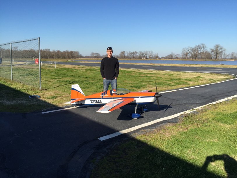

well, all i can say is what an incredible day i had today. One of the IMAC (few years back) Unlimited pilots from the Shreveport Area made it out to our club today, and he was actually flying this airplane back in 2006 and 2007 with Jonah, the builder. He has helped me completely trim this airplane now, to where it is a real IMAC monster. I have never flown an airplane this good. Before he left, i told him, you have to let me take a picture of you with this airplane. He is an awesome pilot, and he is also a real life pilot and he flies aerobatic (full scale) as well and performs in airshows...
