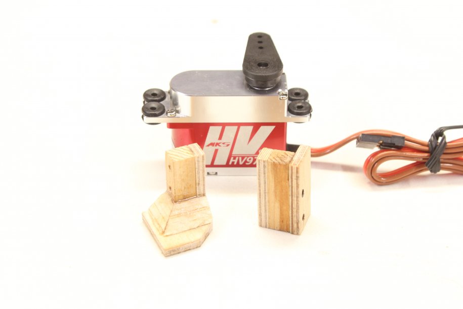

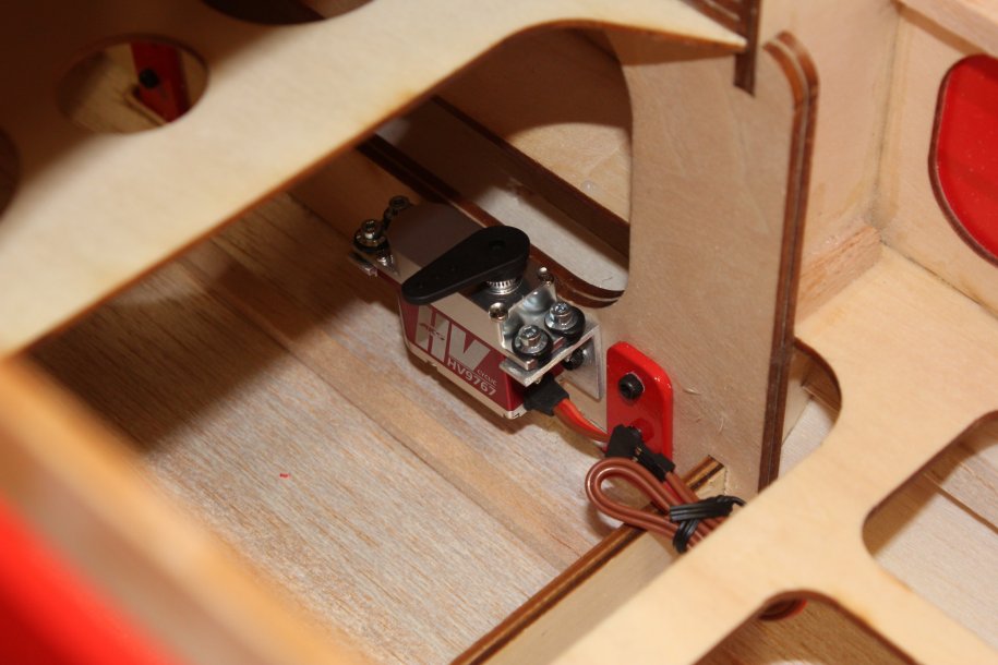

I made a nice little mount out of aluminum angle and mounted it only to decide I didn't like the location or geometry.

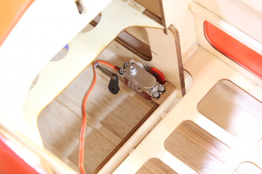

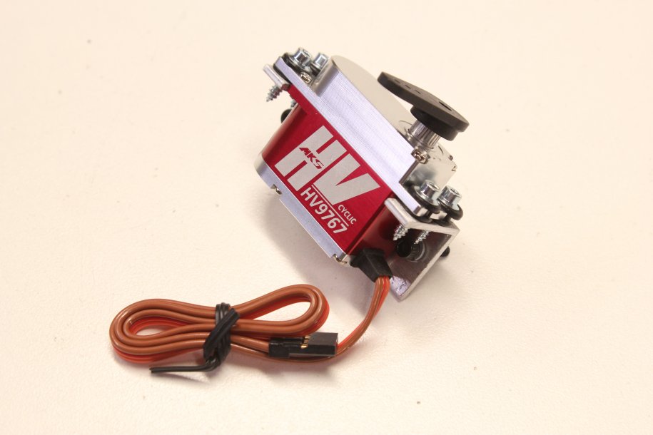

So I let it stew in my head for a couple of days while I was working on other stuff and today made a new set of mounts for it and epoxied them into place. The geometry is better, it will be a bit more out of the way for the fuel tanks, and I can get to it more easily. The last photo of the installed servo has the plane upside down so it's actually mounted in the upper left corner of the fuselage.

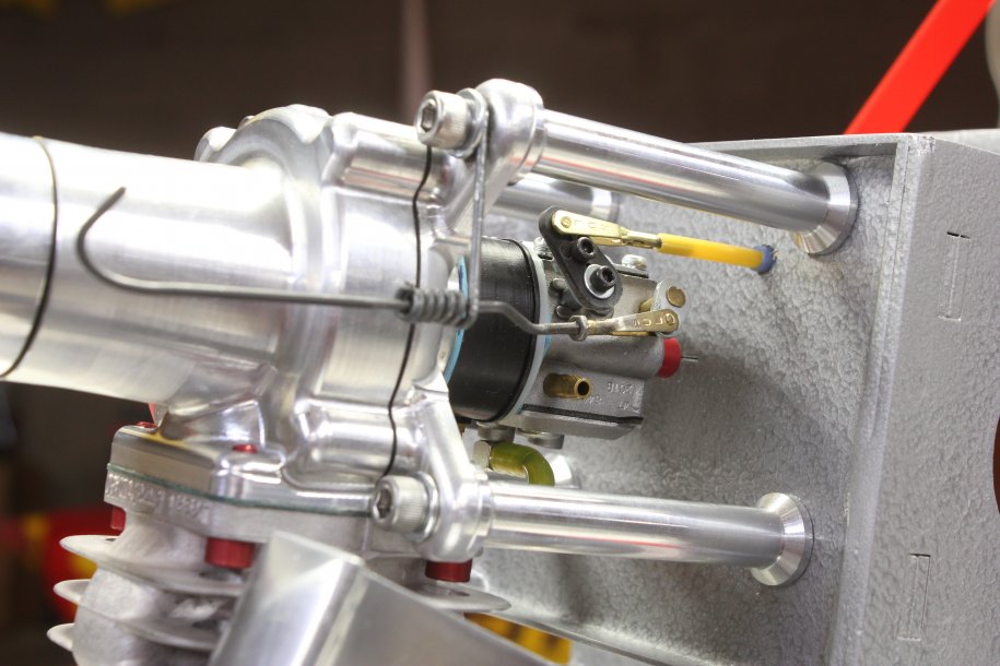

With the throttle servo installed I was also able to make a throttle horn for the carb and installed a choke-pull that I had made for another 50cc engine.
